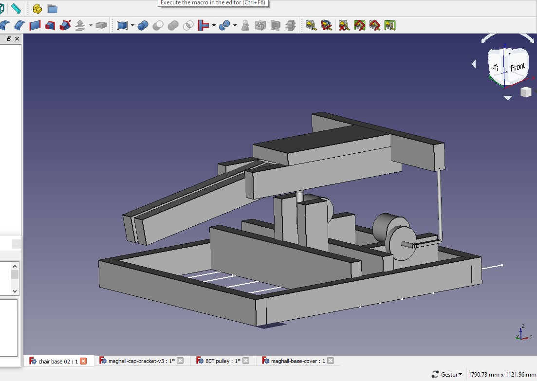

    So it's going to be a simple 2DOF job with perhaps a yaw axis added later. Made of wood and looking something like this:

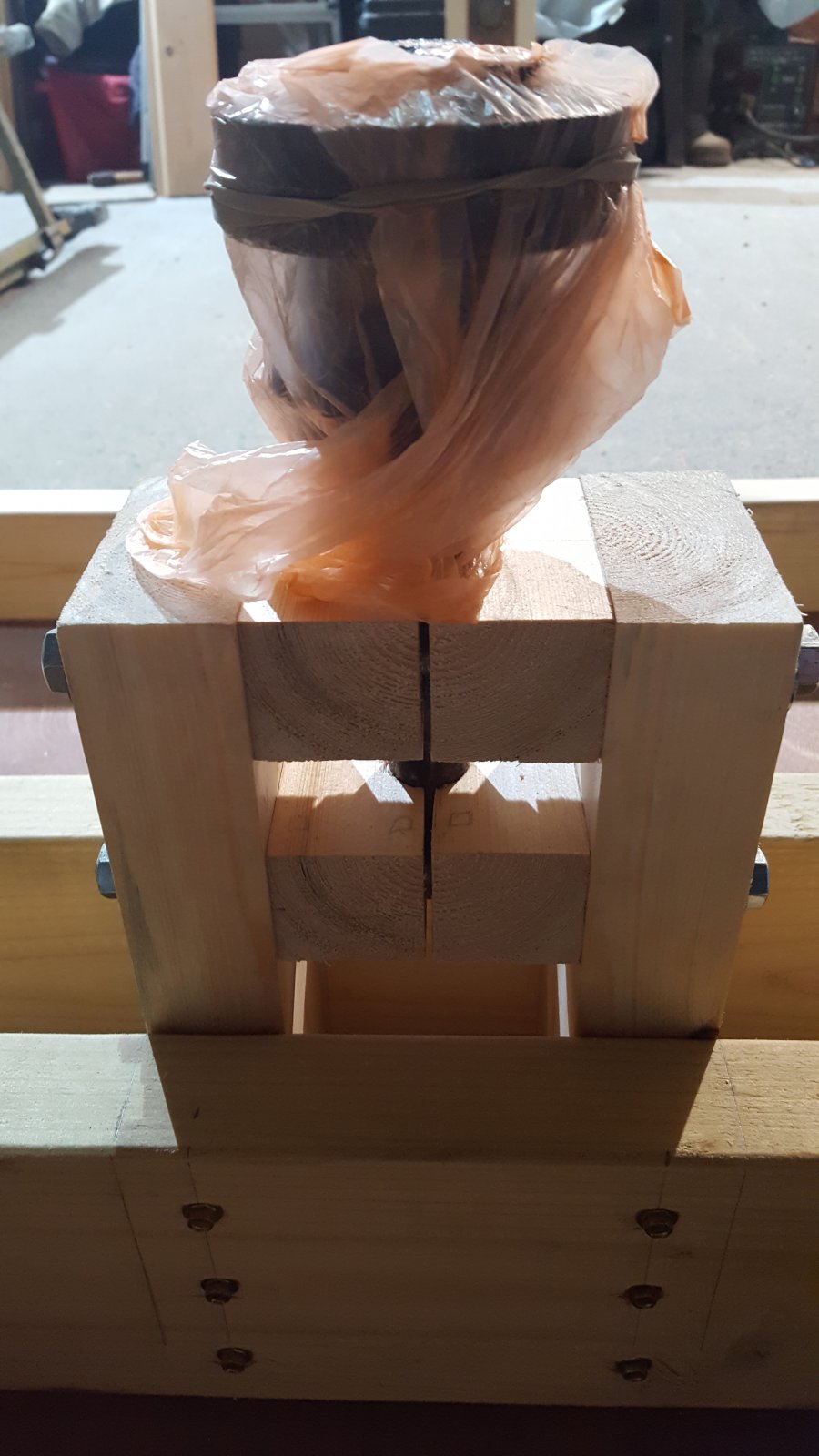

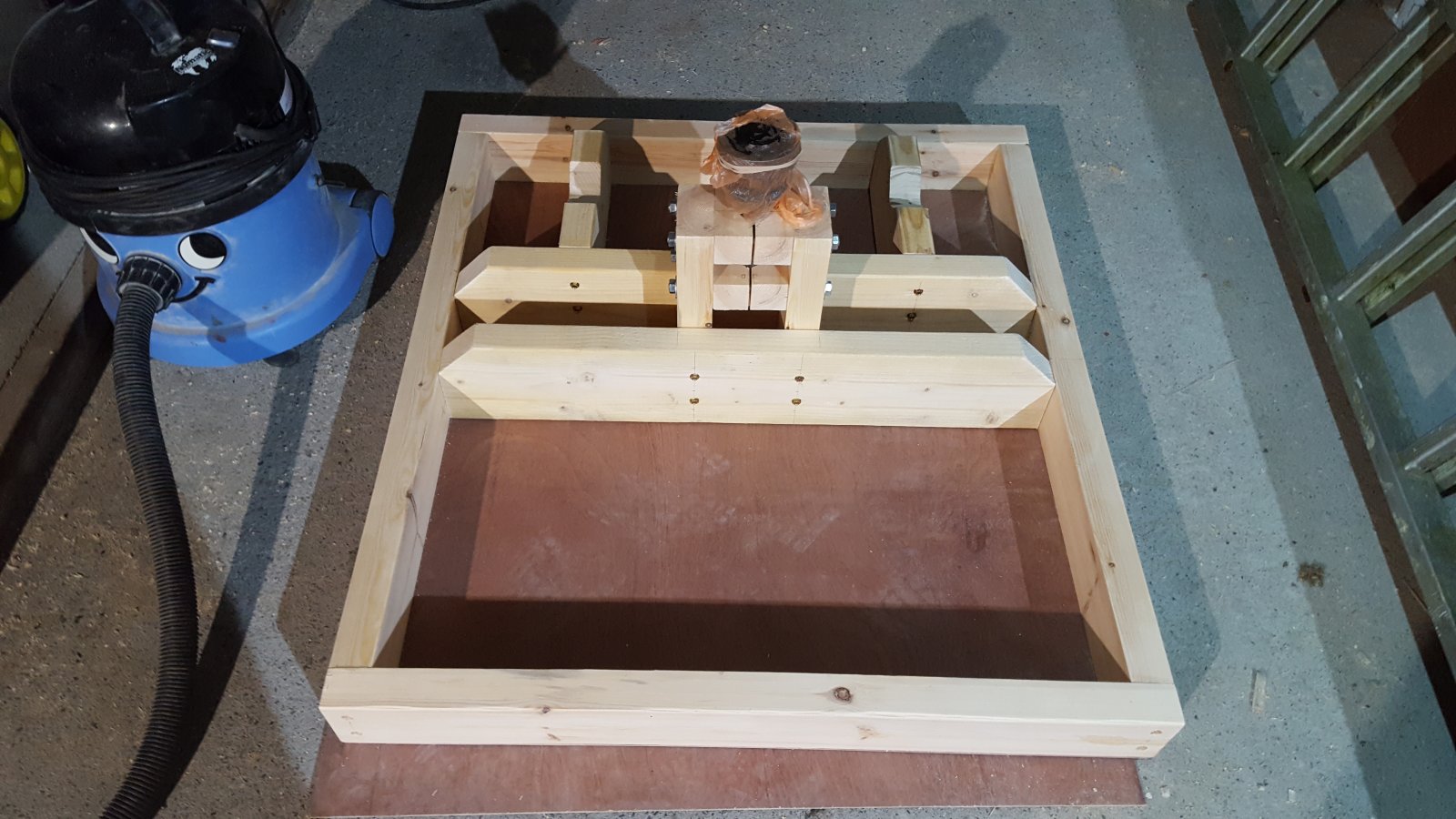

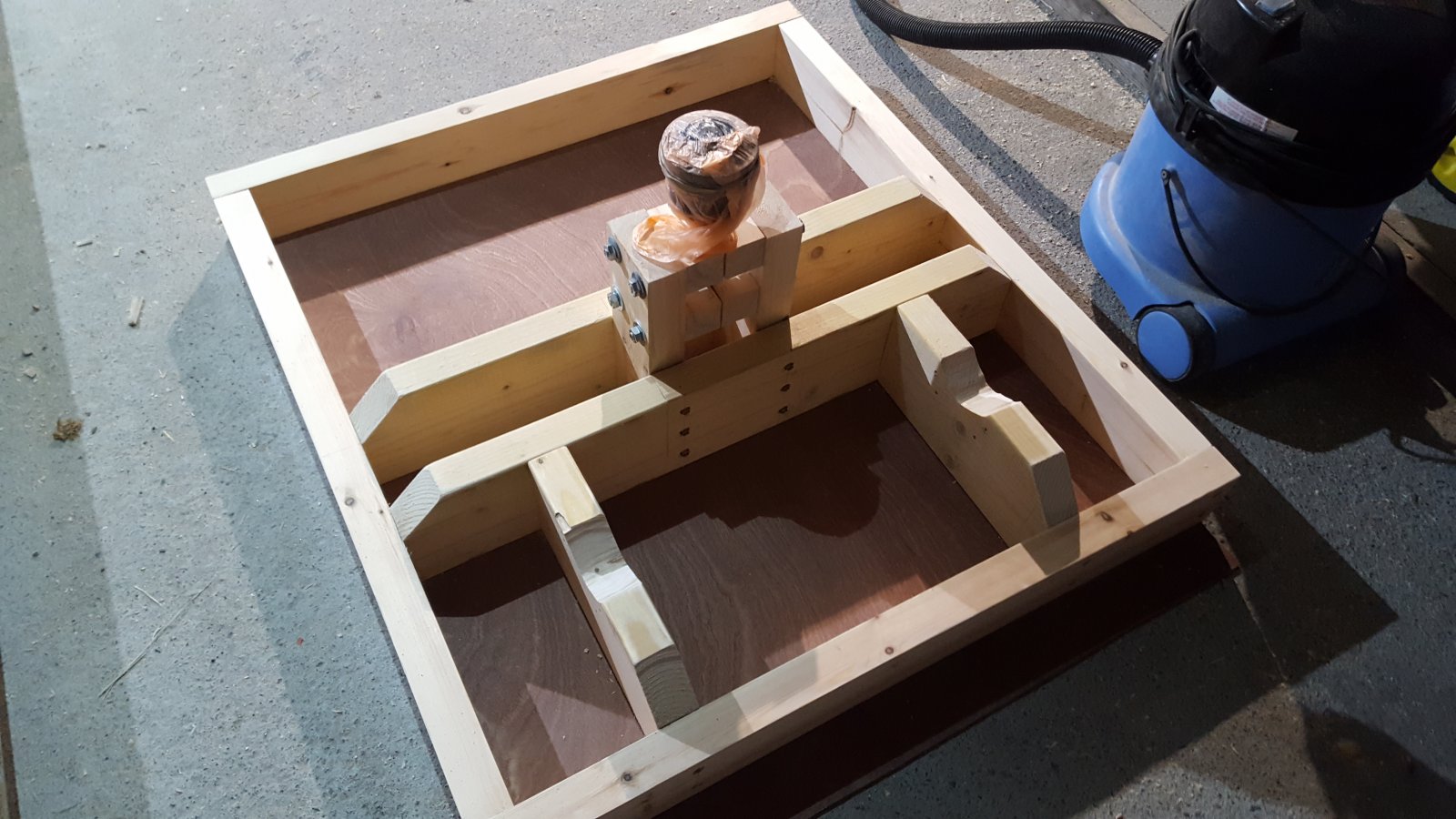

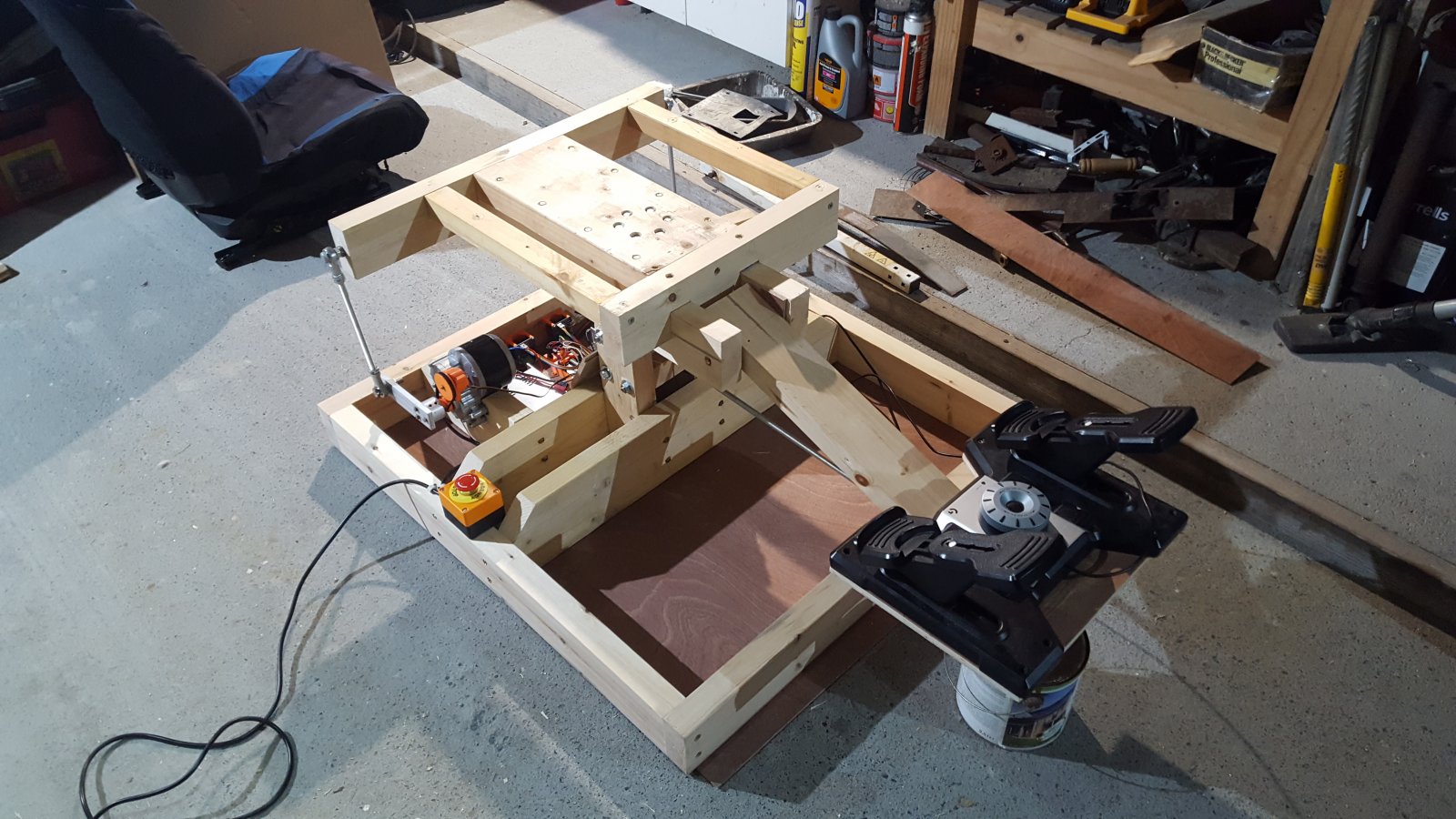

    And I've made the base! Timber is all 95x45 or 150x45 on a 4mm plywood tray. The motors are high enough for their levers to rotate continuously without hitting anything so hopefully I won't need safety stop switches. The joint in the middle is a drive shaft from a neighbour's scrap car. It's very greasy, hence the plastic bag.

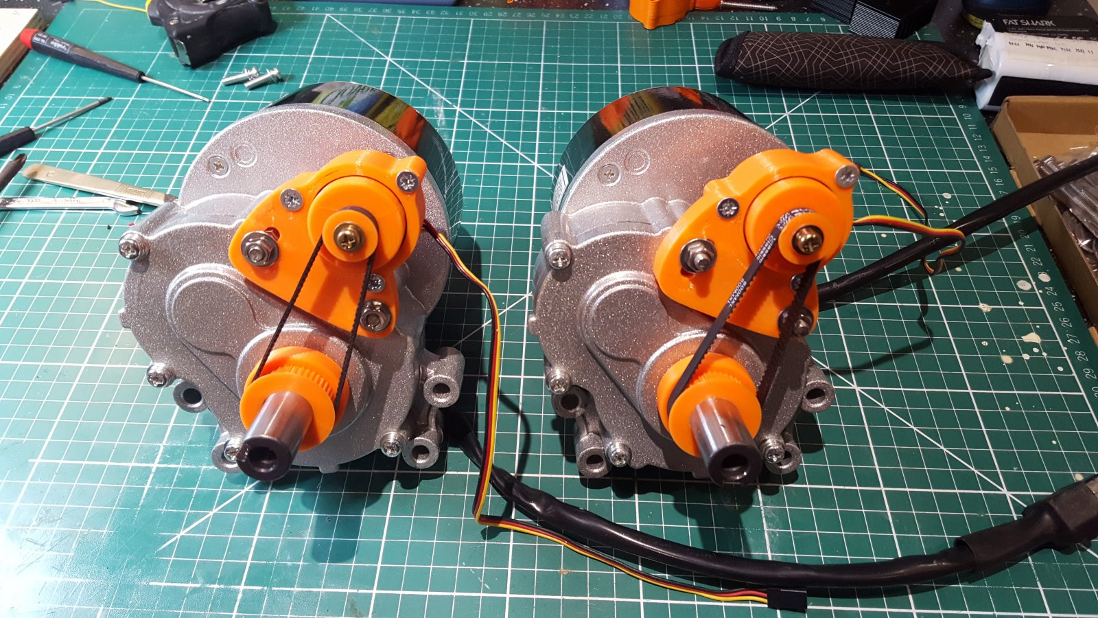

    These are the motors I'm going to use. They're 24V wheelchair motors that can be found on Amazon or Ali-Express. I've seen them used successfully on other builds. I made some 3D printed hall sensors for them. Don't know how well they're going to work yet but they look kinda funky.

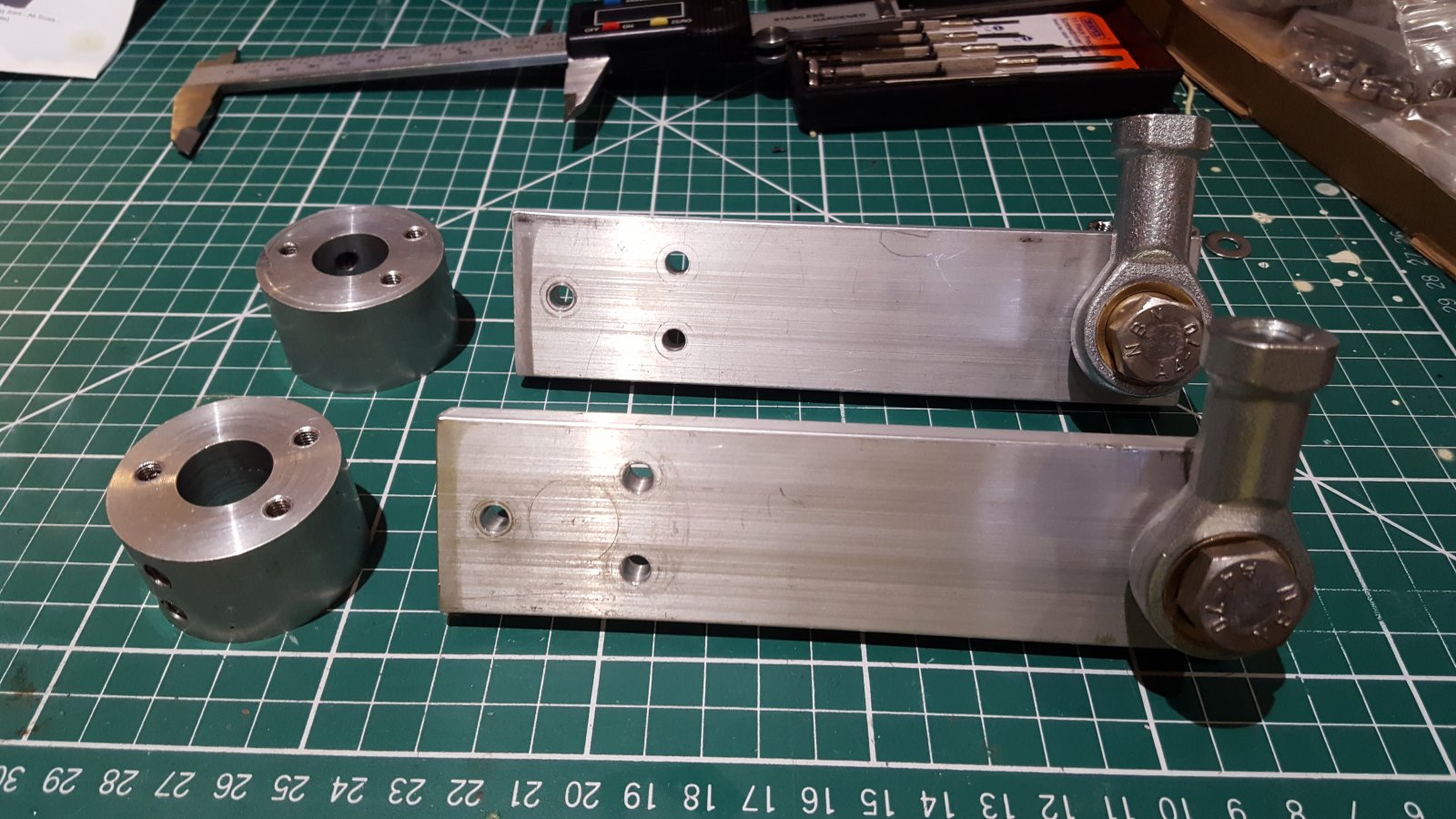

    My motors have a 17mm shaft with a 6mm keyway, not the easiest thing for a DIY constructor to make arms for. My solution: a hub to take two 6mm grubscrews to bight into the shaft's keyway and a separate bolt-on arm. Hopefully it will be strong enough.
    20,916
    147,212Coins
    +10,859 / 54 / -2
    What is the center to center length of the lever?

    Working on the assumption that it's easier to shorten the CTC than to lengthen it, I've started out at 110mm. I suspect I might end up somewhere around 75mm. The motors seem to have plenty of torque to handle the longer length though.

    A sensible approach, my guess is likely more like 60mm CTC, given a compact design, the upside is that movement is amplified by the height of the seat back:

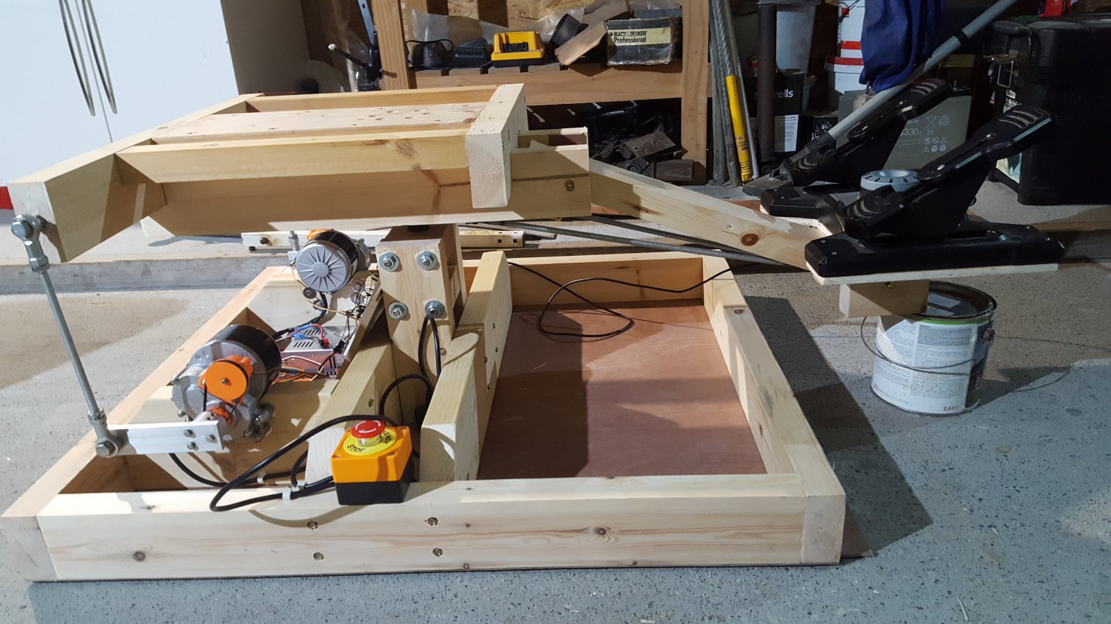

    Seat platform done. I'm pleased with how rigid the pedal extension is with the two metal stays on the bottom.

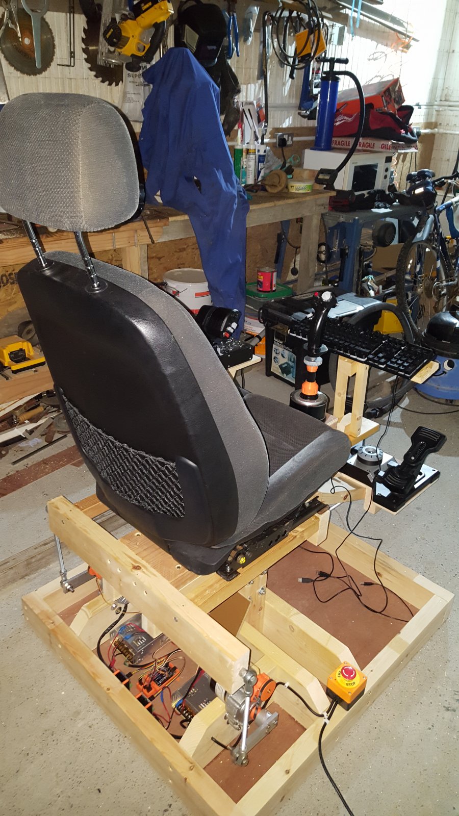

    So mechanically I'm close to finished now. Seat and controls all fitted and it's really comfy to sit in.

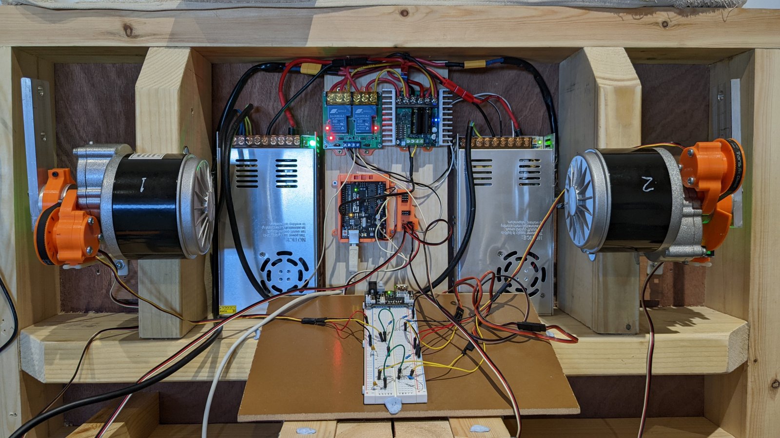

    So more progress made and I think I'm nearly done with the electronics.
    This photo is obviously before tidying of wiring etc but it seems to be working well. The mess on the breadboard in the foreground is mainly just a bit of RC filtering on the motor feedback. It's quite effective at quietening down grumbling and twittering motor sounds. Not so necessary with the new Sabertooth as it was with the IBT2s but still worth having.
    The usual Sabertooth seems to be the 2x32 but I couldn't find one those in stock locally so I bought a 2x25 instead. As the Sabertooth amp rating is continuous and the peak current is much more I think the 2x25 is well up to the job. However I made the incorrect assumption that all the logic driver stuff would be the same between the 25 and the 32. It's almost the same, but not quite. The 25's max baud rate is only 38000 which seems too low to use with the SMC3 packet serial version, so I'm limited to the simple serial but that's ok I guess.

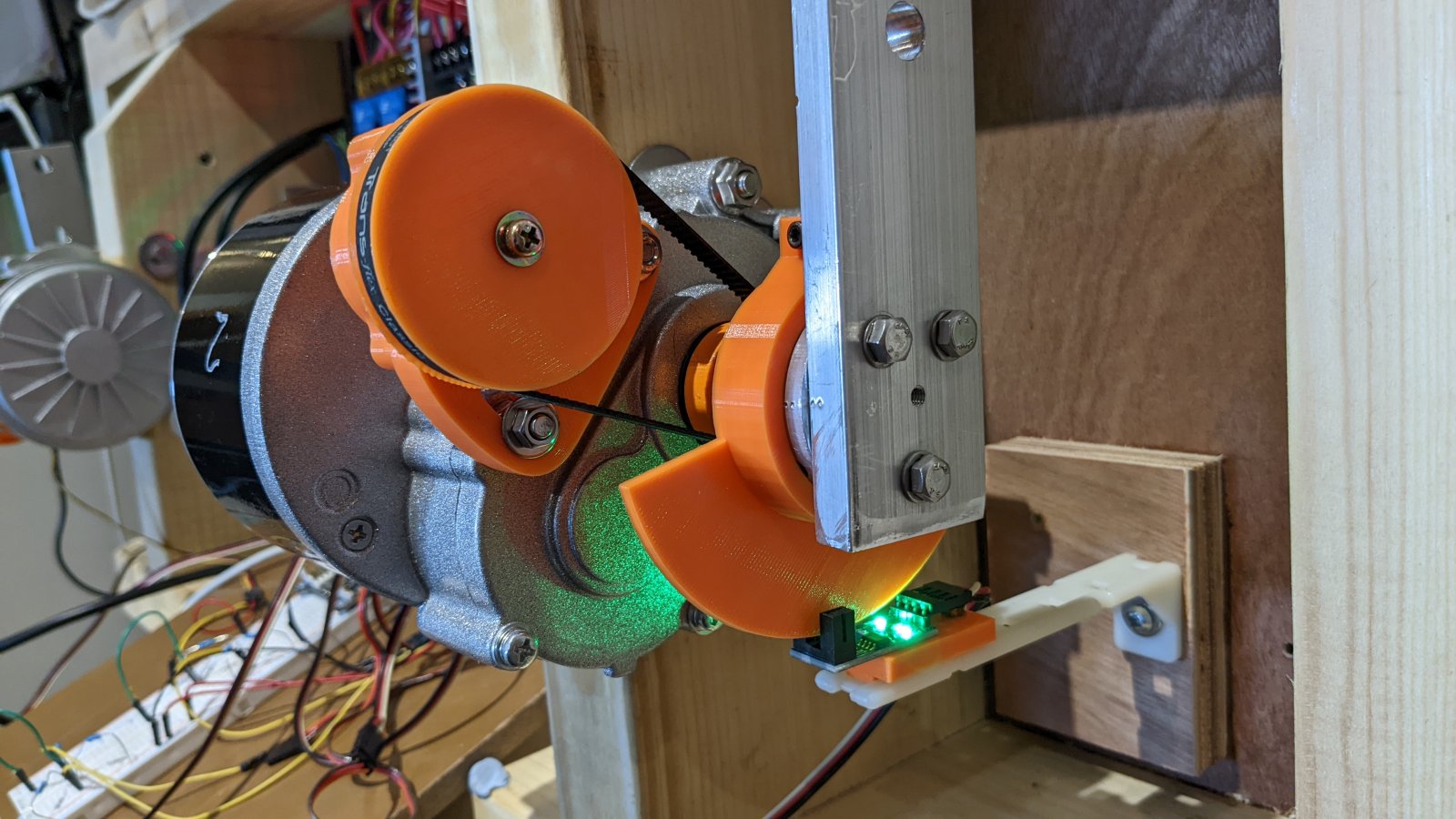

    Because of the apparent possibility of motor runaway with the simple serial I decided some ultra reliable end stop switches would be a good idea. It's quite hard to design a switch that can be hit by a runaway motor and survive so I went for an optical coupler arrangement.
    It works well. The coupler releases a relay if the orange quadrant stops blocking the beam and the relay not only disconnects the power but also shorts the motor winding to form a brake. It stops very quickly.
