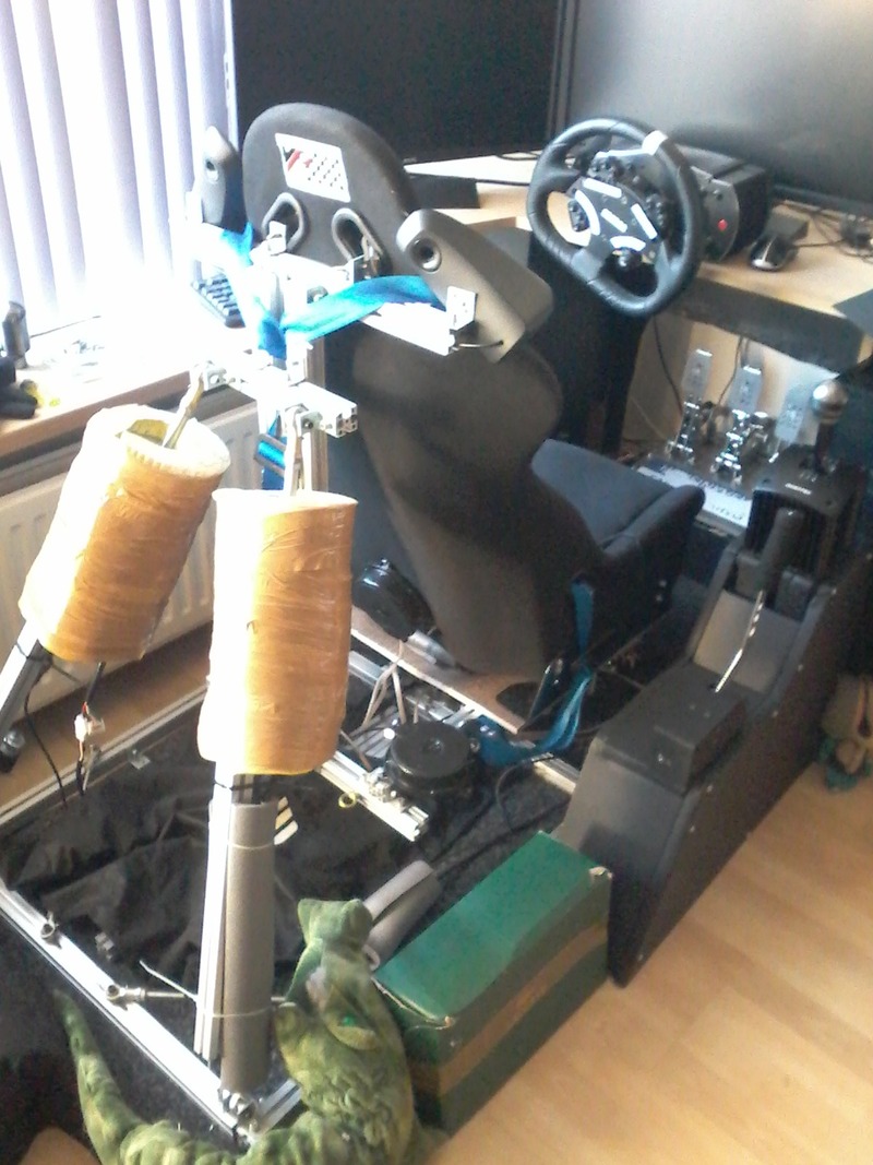

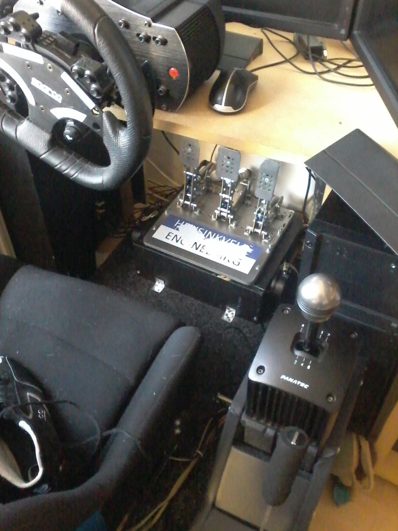

    Bought this Frex last week (was also on sale here) and finally got it installed, actually....twice due to everything being misaligned the 1st time.
    Downloaded everything (Simtools and AC plug-in) and went on track for the 1st time, only went forwards and backwards so some fine-tuning necessary but the little taste I've had so far are goooood :D

    it looks like your rig isn't stable on floor... the whole system is tilting, no?
  6. GTHQ_koop
    GTHQ_koop Active Member
    May 11, 2015
    115
    Something with airplanes..
    Lakehills Texas USA
    1,786Coins
    +65 / 1 / -0
    2DOF, SCN5
    Treu...I live on the 2nd floor of an apartment-complex and the whole base is sitting on 7cm thick damping-foam otherwise my bottom neighbours won't have anything in the closet anymore ;)
  7. RacingMat
    2,236
    20,963Coins
    +2,089 / 21 / -2
    I see! That's a problem as you loose precision and amplitude...
    You may find better results in increasing the width of the basement (even on foam)

  10. bob williams
    bob williams OSW sfx100
    Apr 18, 2012
    119
    IT
    Ermelo, Netherlands
    89Coins
    +45 / 1 / -0
    I also have a Frex setup. Does the wrapping make a lot of difference to the noise level? The connection rods at the top are pretty close to one another. Maybe if you spread them more the load on the scn5`s will be a bit less, as they can only handle 10kg.
  11. GTHQ_koop
    May 11, 2015
    115
    Lakehills Texas USA
    1,786Coins
    +65 / 1 / -0
    2DOF, SCN5
    No, it does not make a lot of difference...But very little improvement is a win in my case ;)
    I've also added 2 rubber steering covers (Renault) for the Whistling noise, also helps a bit.
    About the connection rods...It should be correct, the guy from who I bought, modified the Frex with a 4-way swivel (and Simtools) under the seat and used it for years like this because the motion would be better.
    I don't know who is right, I'm still a motion-noob :p

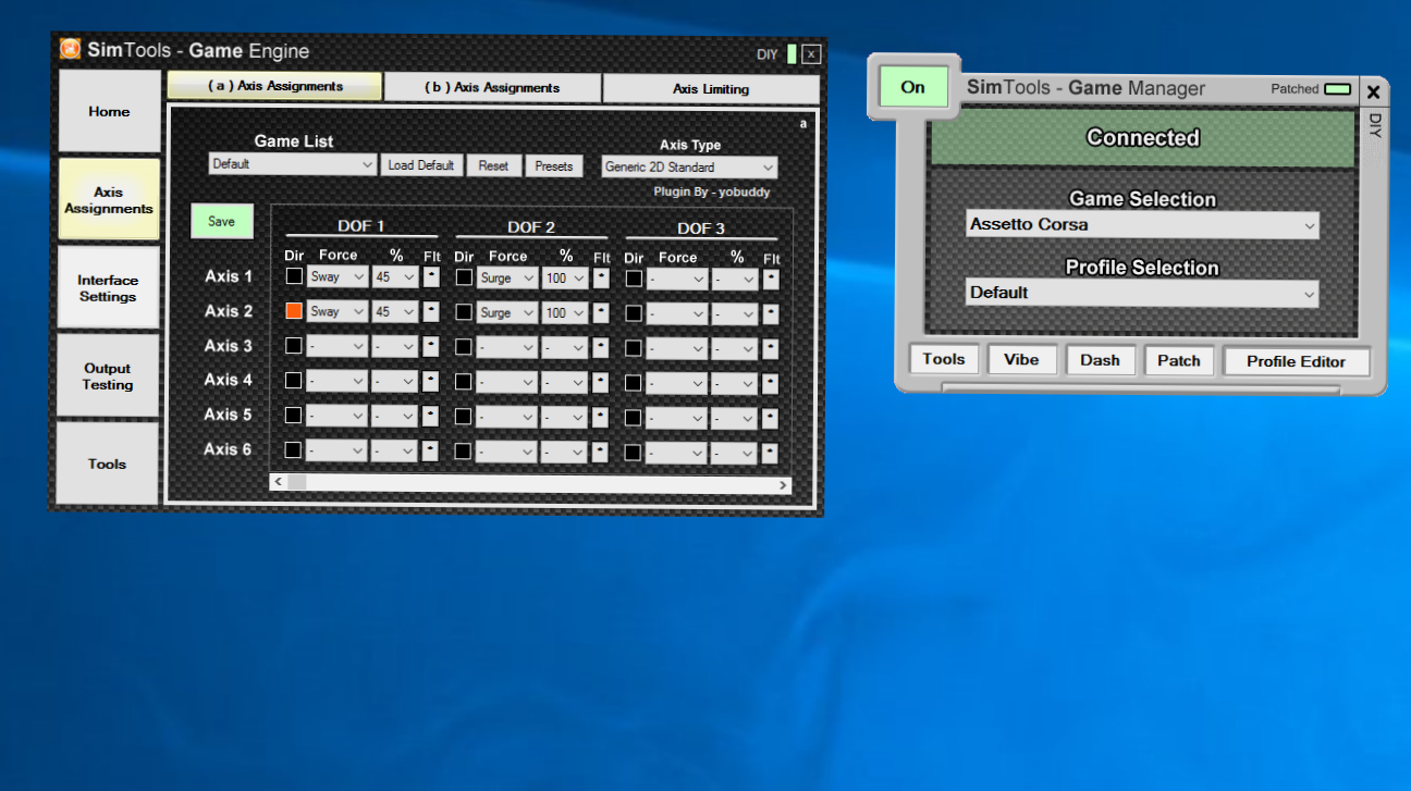

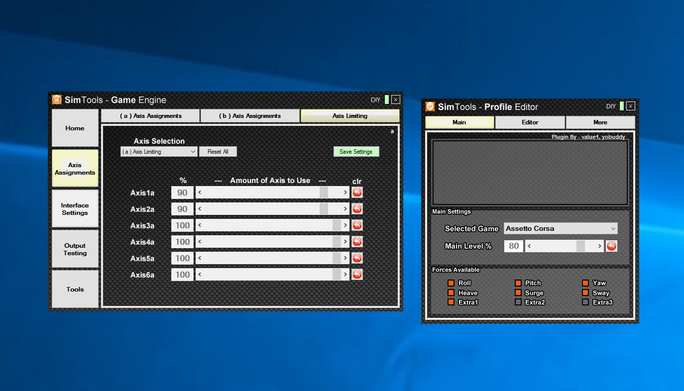

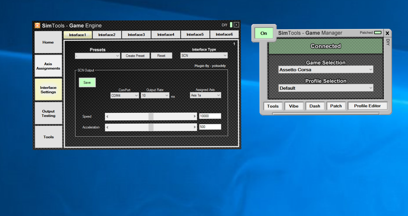

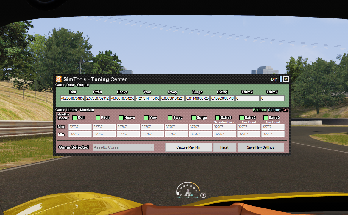

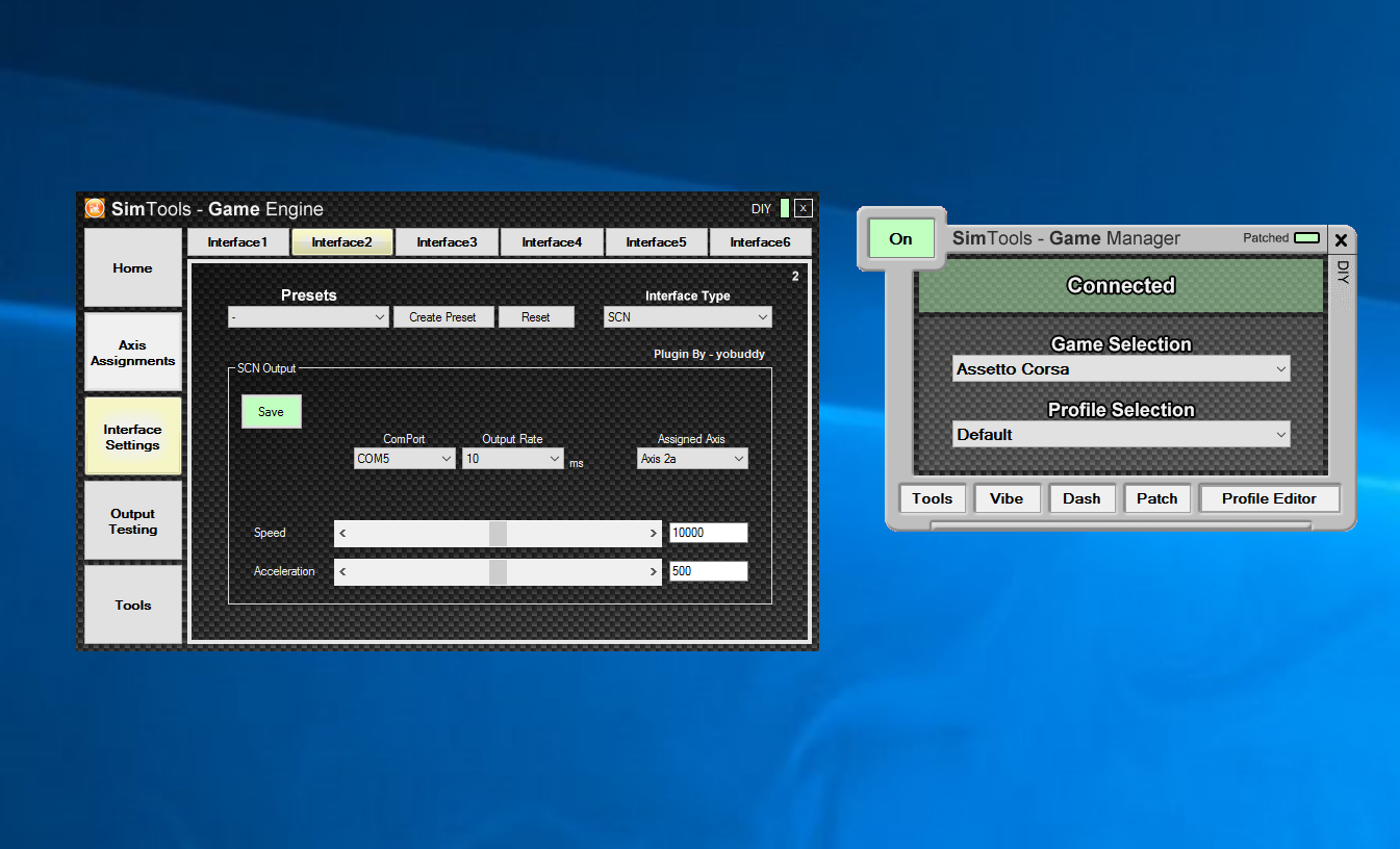

    Hi guys,
    Finally got everything set up again after my move across the ocean but struggling with the setup now..
    Followed all the steps again but can't get the motion going ingame..
    Game reads data as I see the tuning menu spit out values, id's are set to 0 and output testing works.
    Also tried re-installing the AC patch couple of times but no joy..
    Any ideas..?
    Here are my settings:
    Screenshot (5).png Screenshot (5).png Screenshot (7).png Screenshot (5).png Screenshot (7).png
