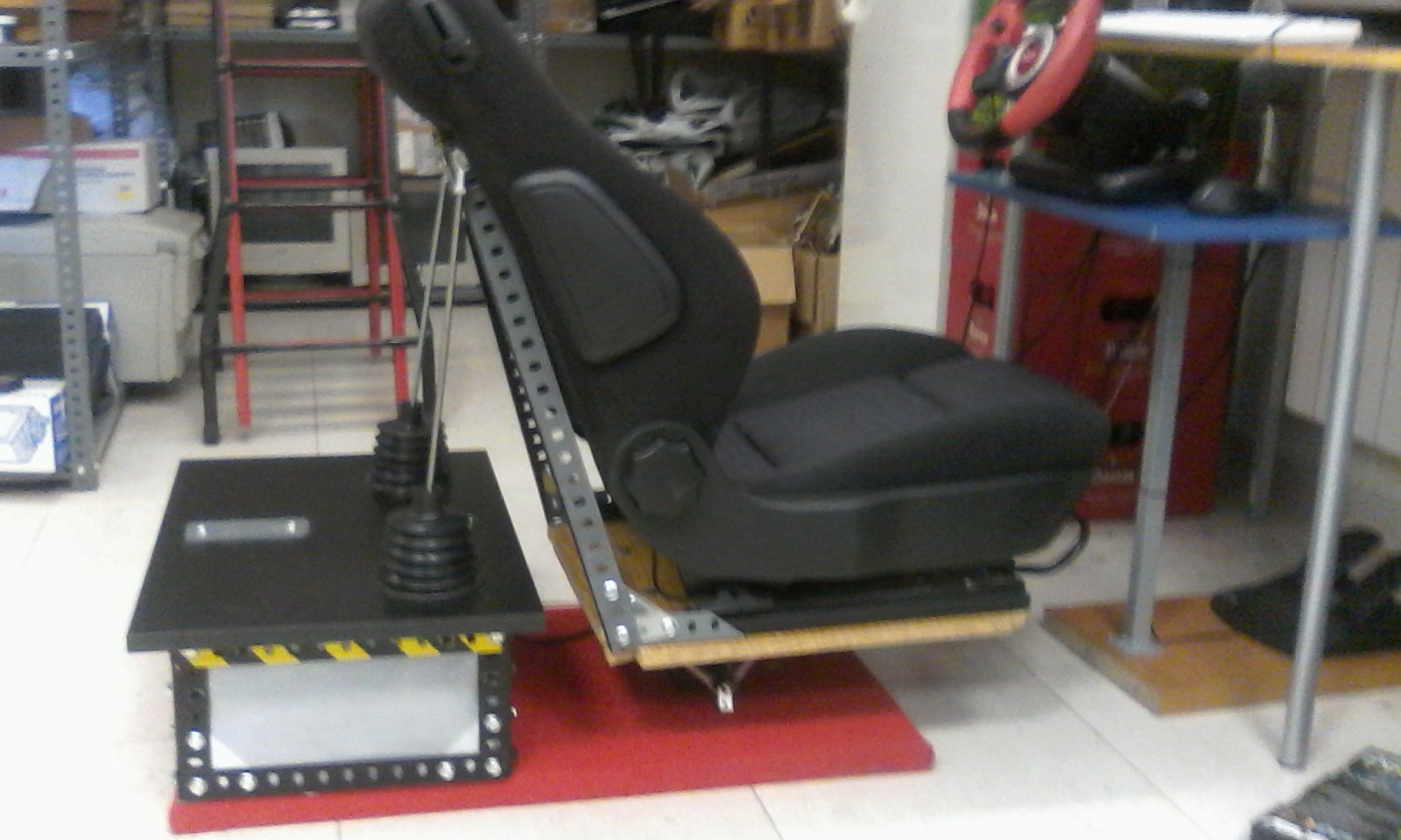

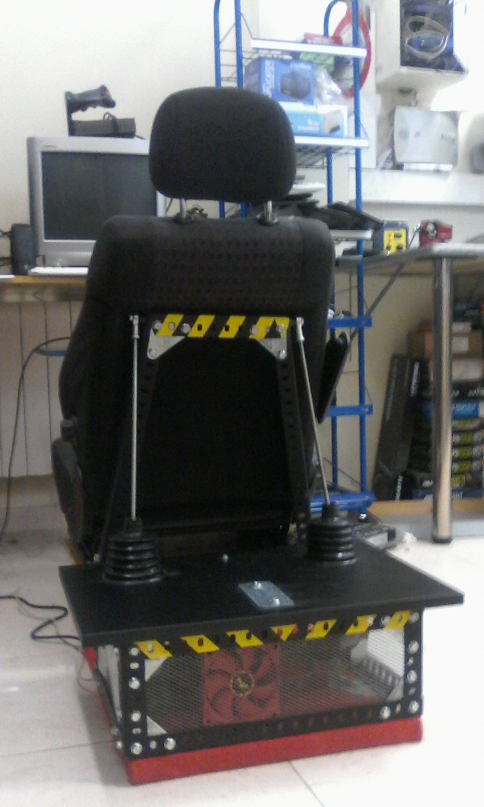

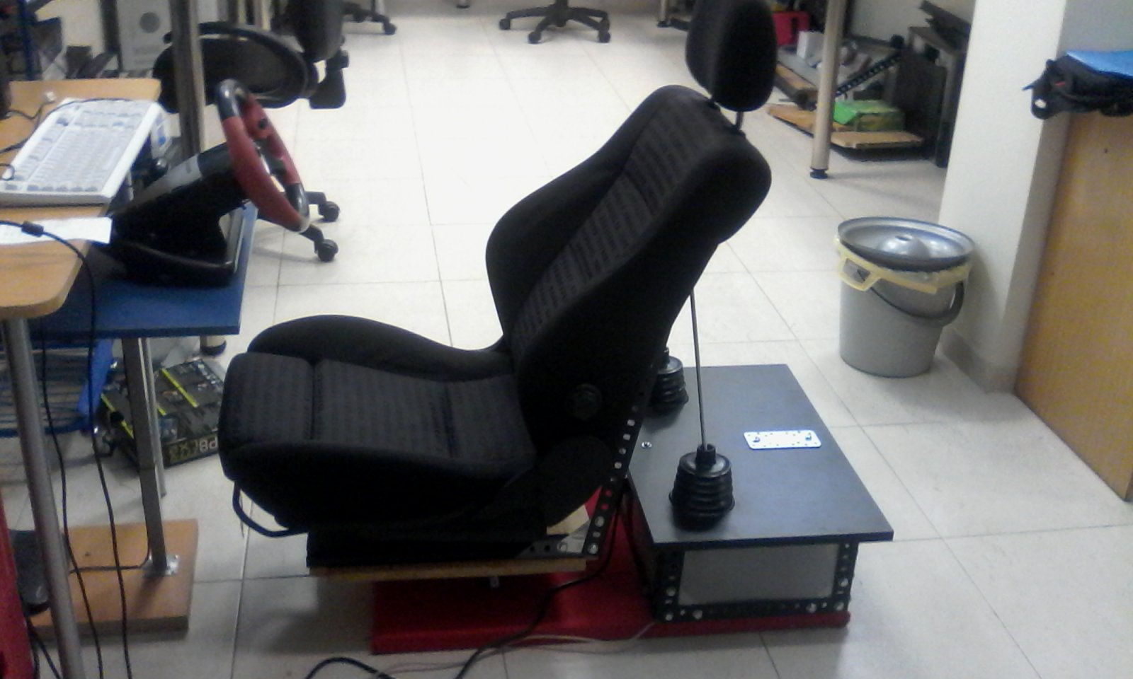

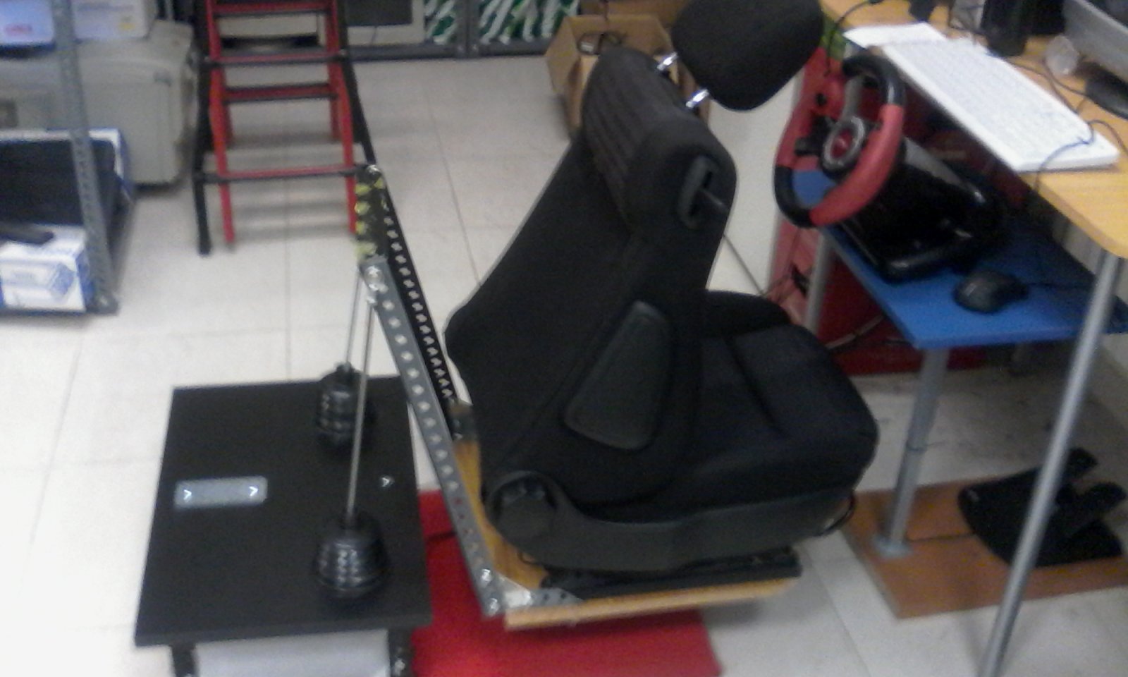

    Well here there are some pics of my racingseat: IMG_20160517_162356.jpg IMG_20160517_162424.jpg IMG_20160517_162444.jpg

    Some parts are still provisional, like the table under the sit. I´m thinking about puting a bigger one for locating a joystick with acelerator in both sides.

    The seat is reclinable for adjusting the height of the system with 2 screws. IMG_20160517_162529.jpg

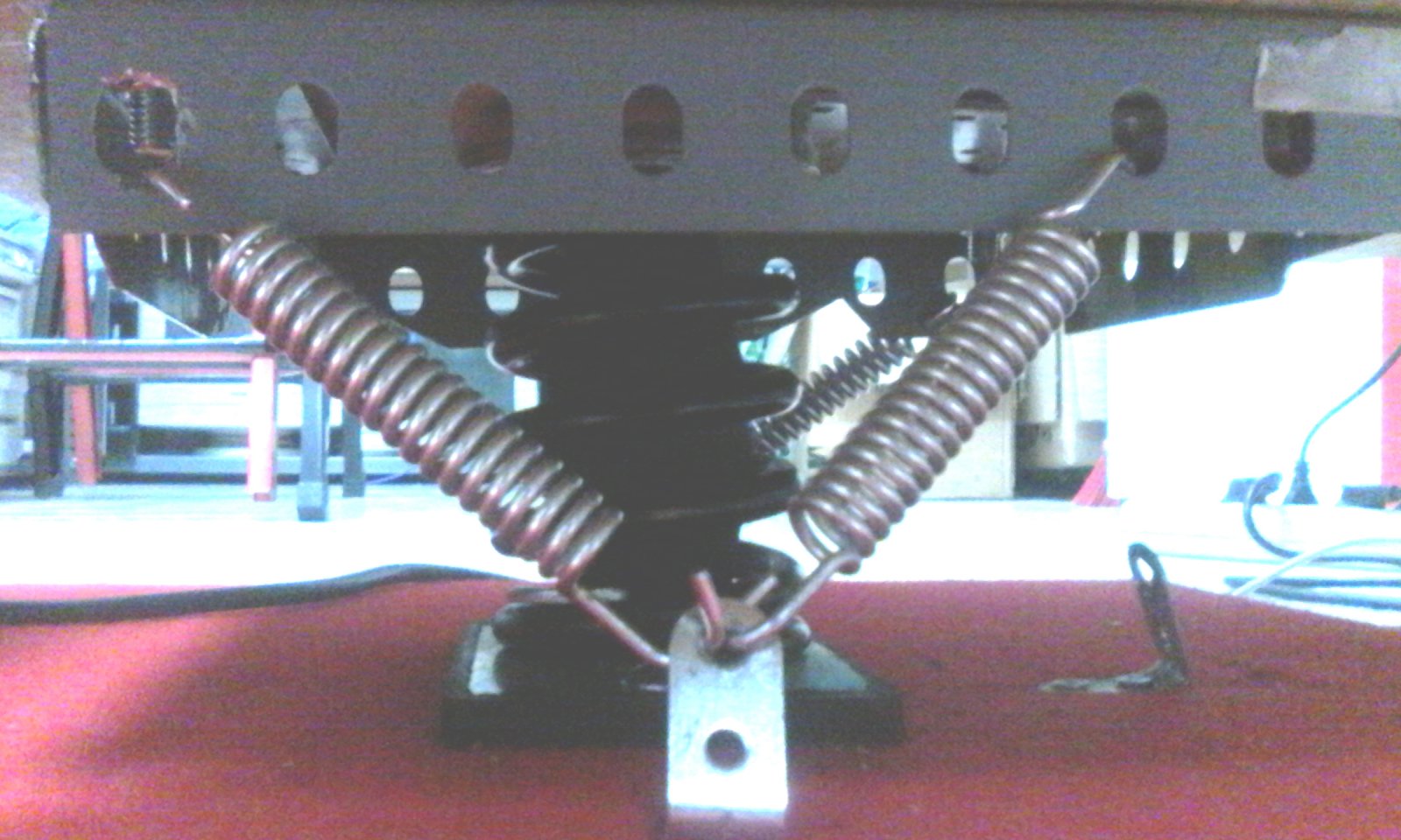

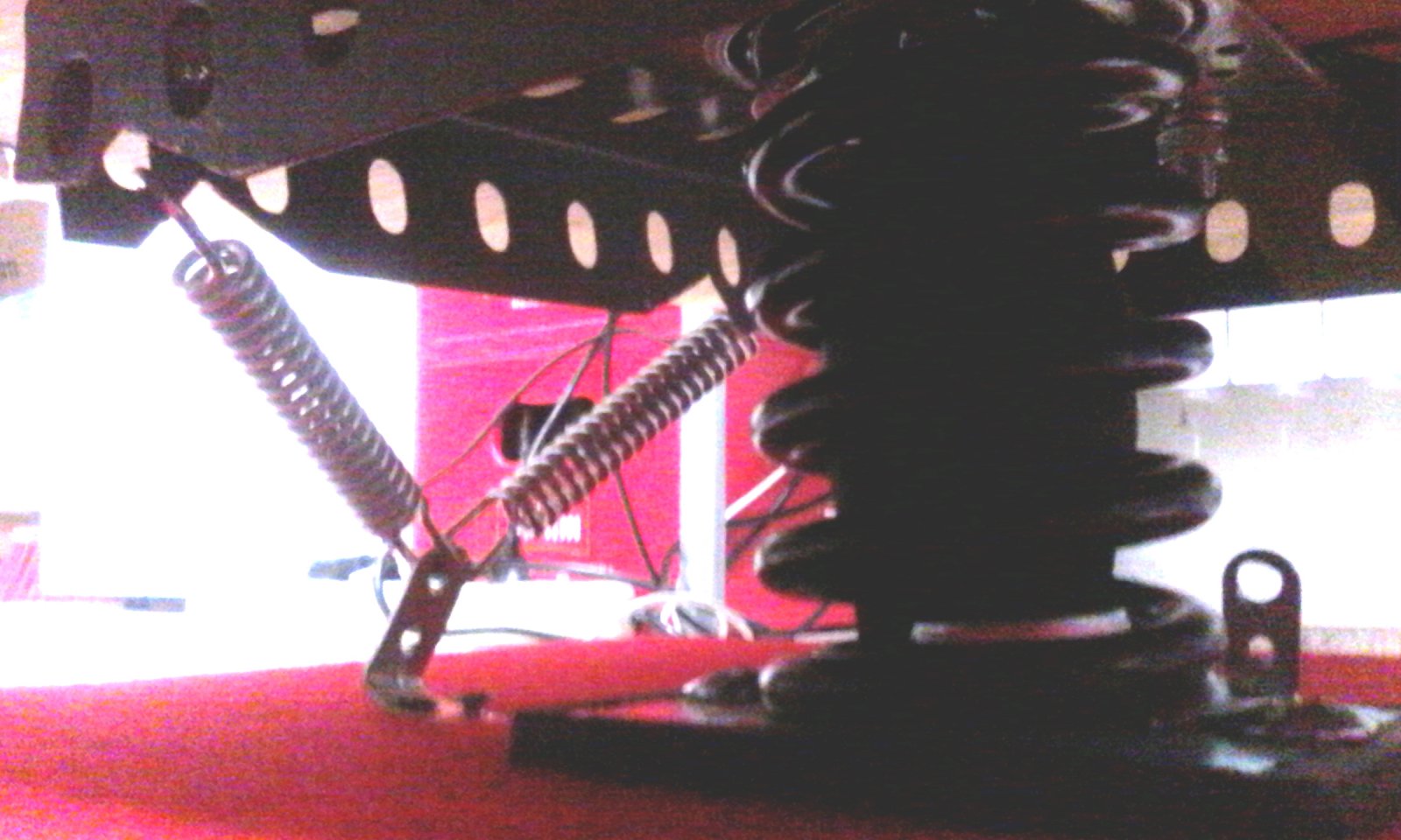

    This is the system I used as principal axe for th seat. It´s a springed silentblock capable of 150 kg weight. IMG_20160517_162501.jpg
  9. chu
    chu 2dof racingseat
    Dec 2, 2015
    149
    tecnician
    VITORIA
    937Coins
    +34 / 0 / -0
    As you can see I use 4 springs more for giving more stability. Thye make also the function of anti seat rolling, cause they are always in tension parallel/ IMG_20160517_162510.jpg longitudinaly to seat.

    i like the use of the CV boots for the rods.

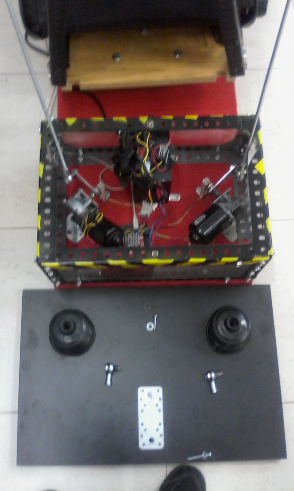

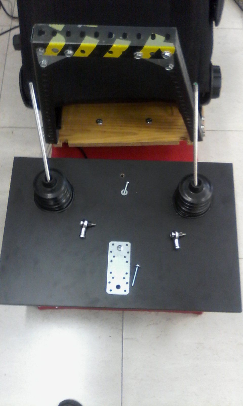

    Here is the motor case. Only puting out 2 screws and the 2 ball joint, is easy to get into the mechanisc for repairing etc...

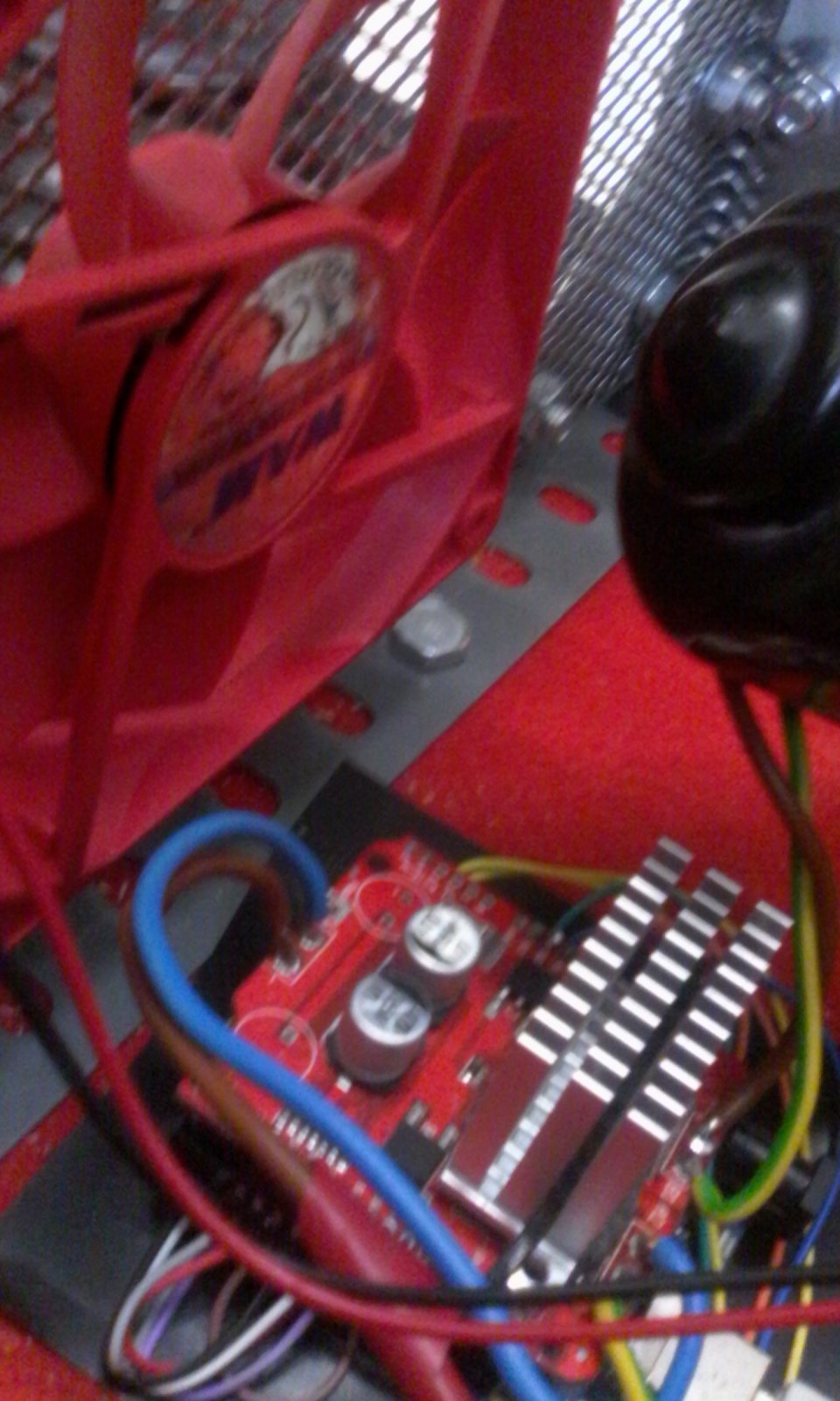

    Here you can appreciate the arduino with teh monster on top. And the cooling fan for the monster and left dc motor. IMG_20160517_170309.jpg

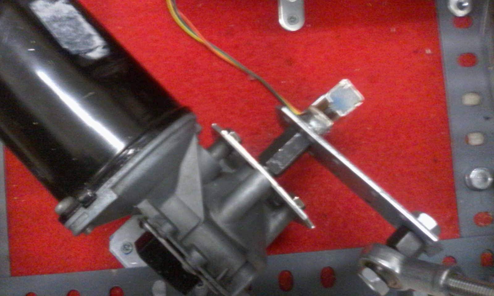

    The conecting rod is orientated for tihten the screw by the weithg of the seat. This way I prevent for screw off the rod

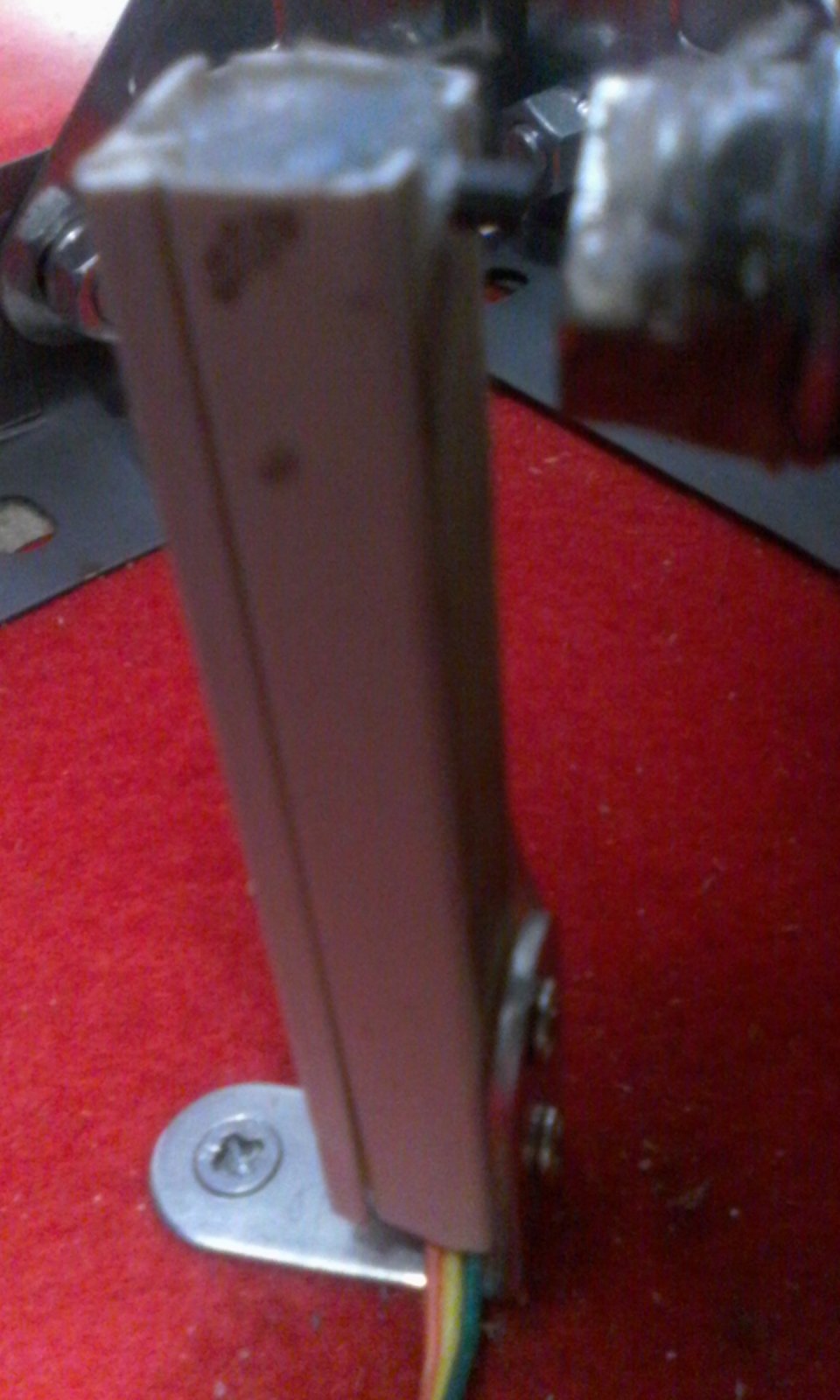

    Here is another picture of hall sensor. is very simple and without any scraping

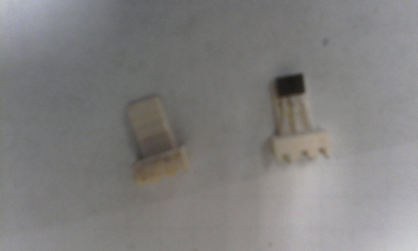

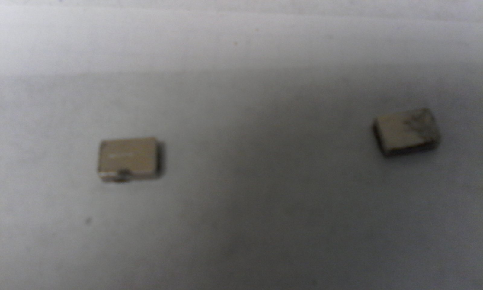

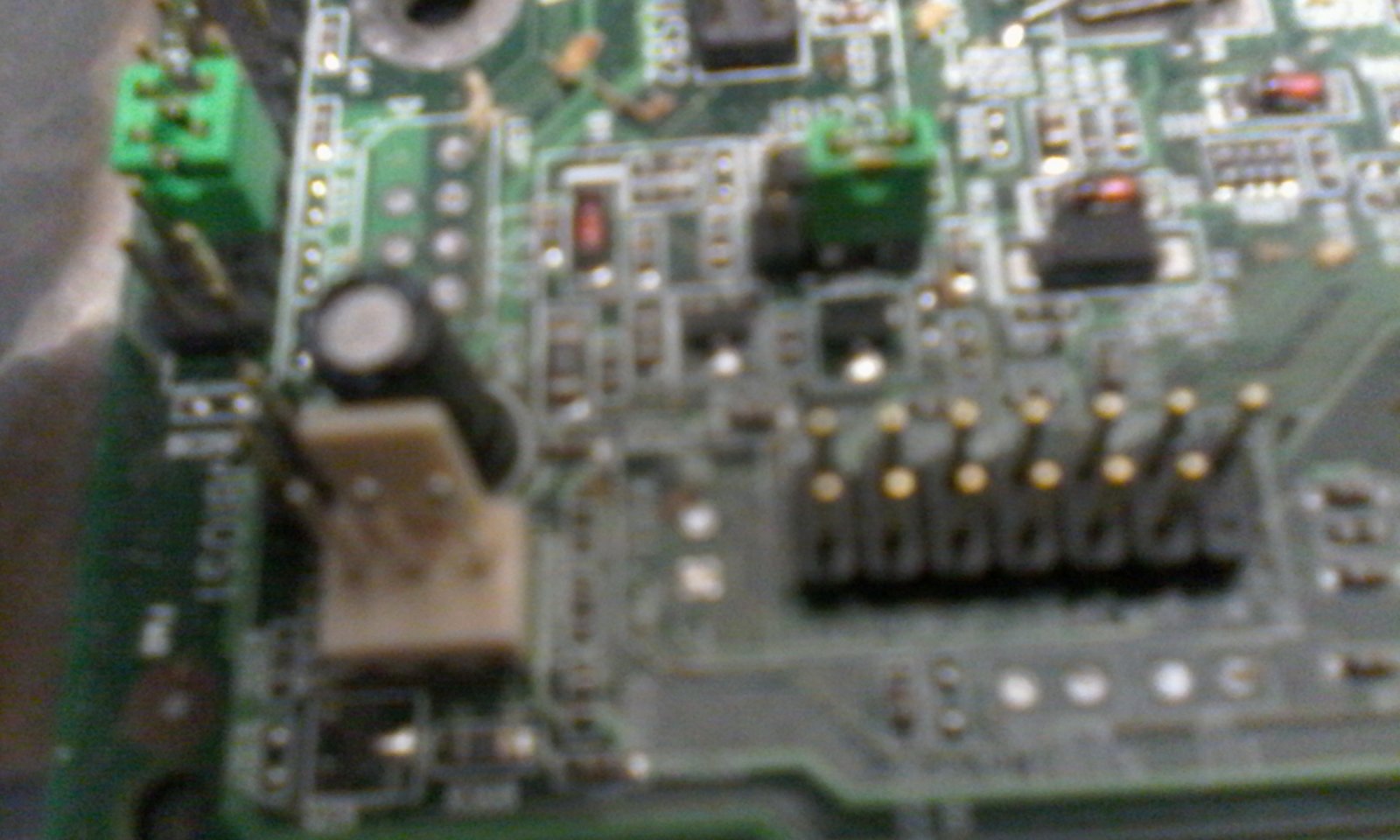

    here they are the componentes for making the hall sensor (1 per motor):
    3 cables from the arduino
    the hall sensor with a three holed plastic and 2 neodim magnets united and a capacitor.

    another picture for the magnets (5mmx7mmx2mm) 2 for each sensor IMG_20160517_174520.jpg

    +34 / 0 / -0
    And here the three holed plastic taken from an old computer main board IMG_20160517_174623.jpg
