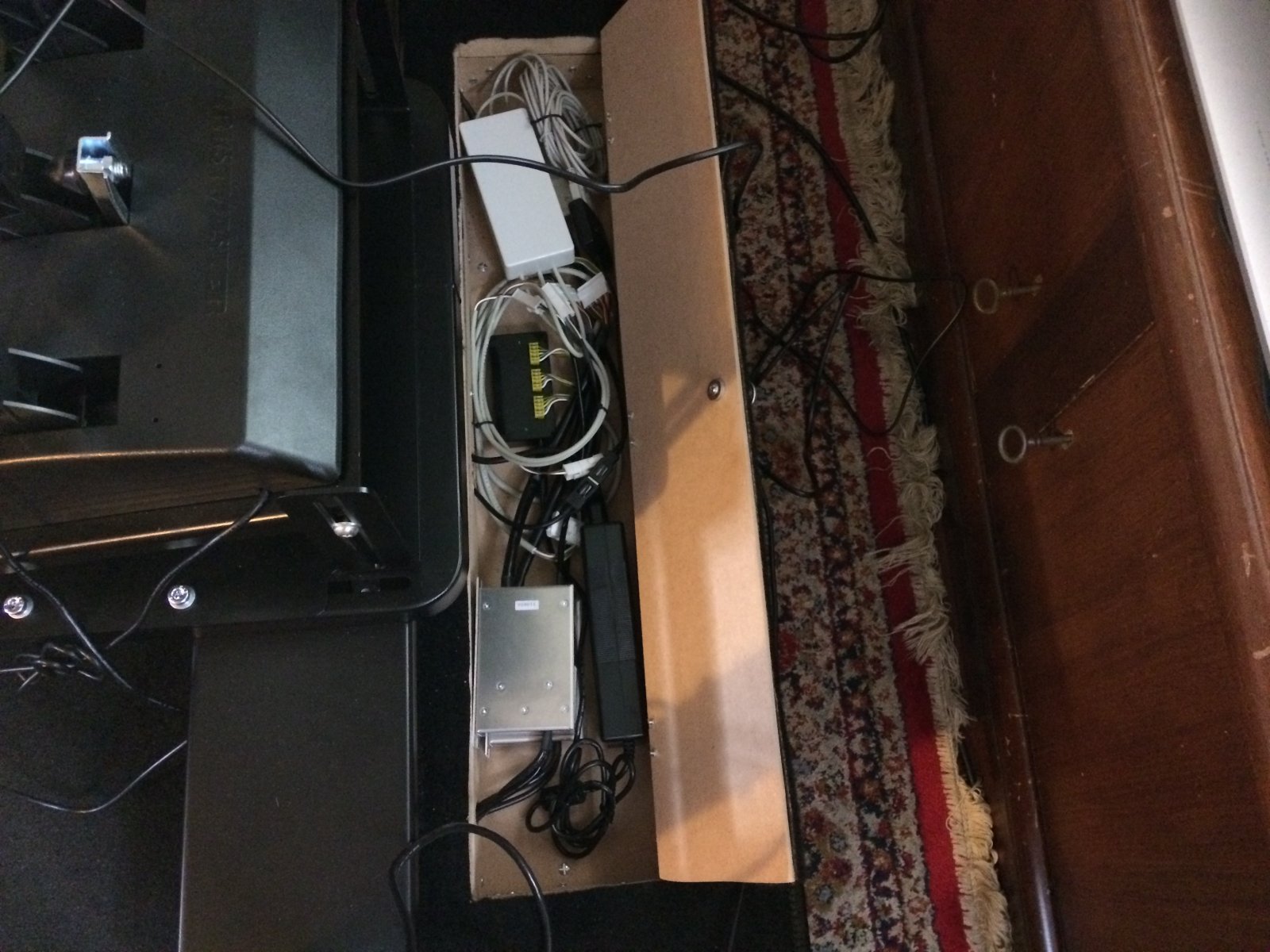

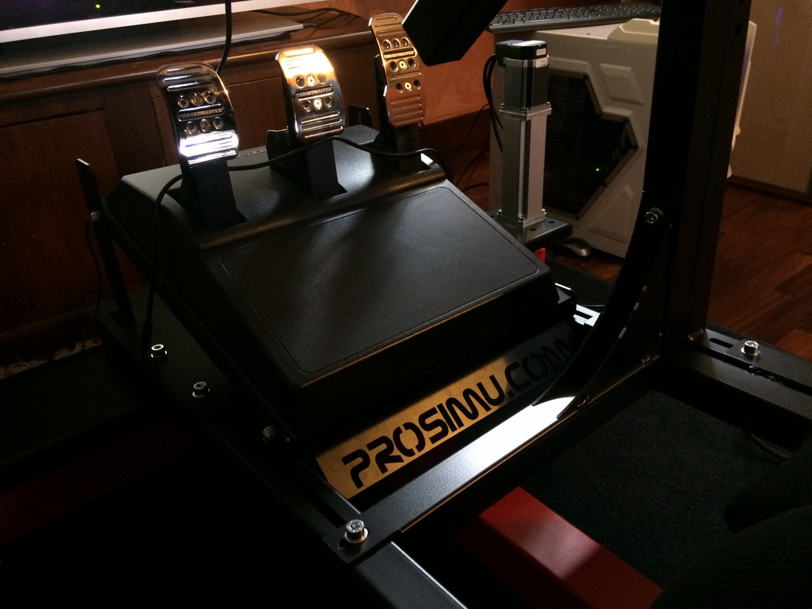

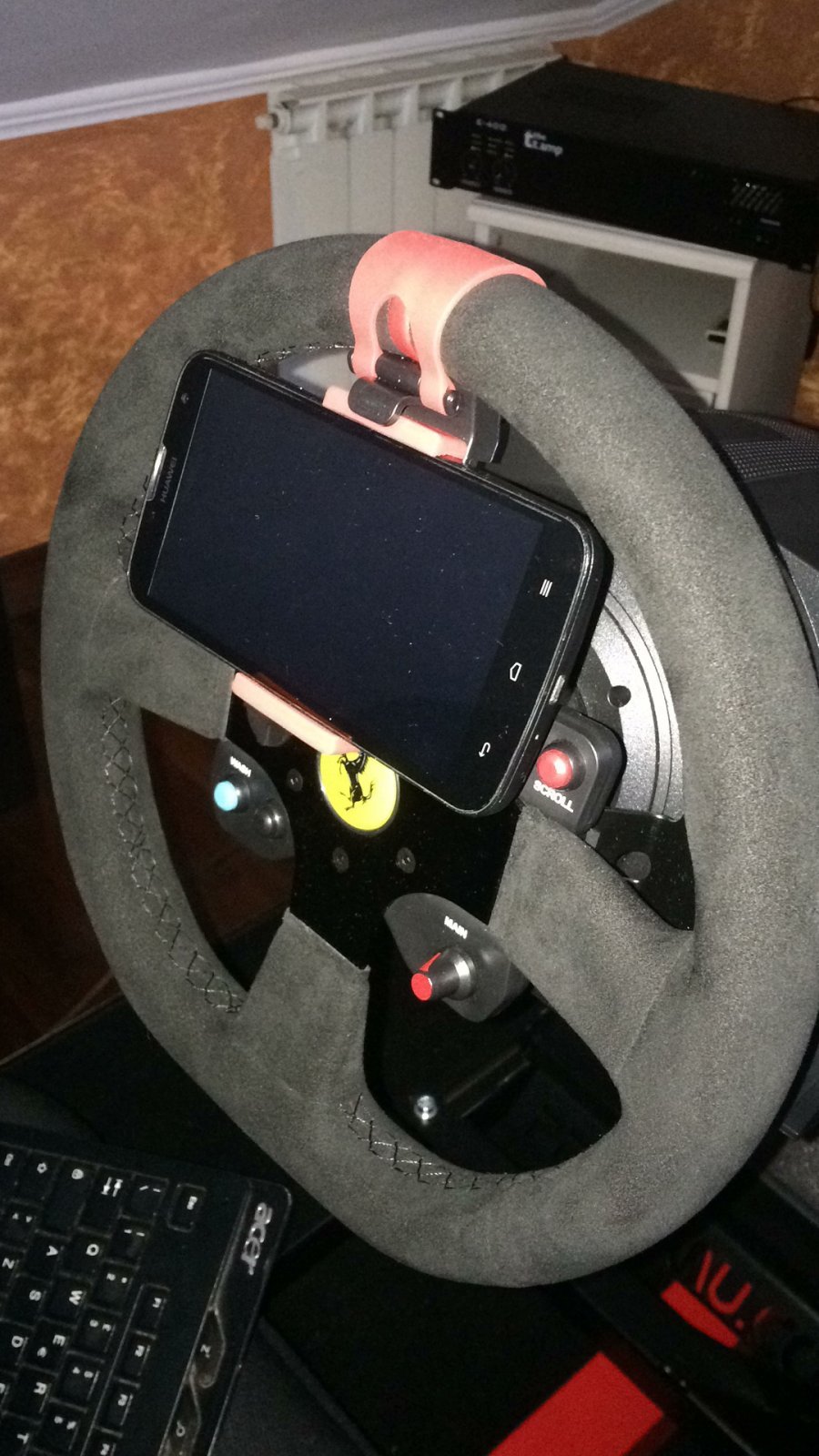

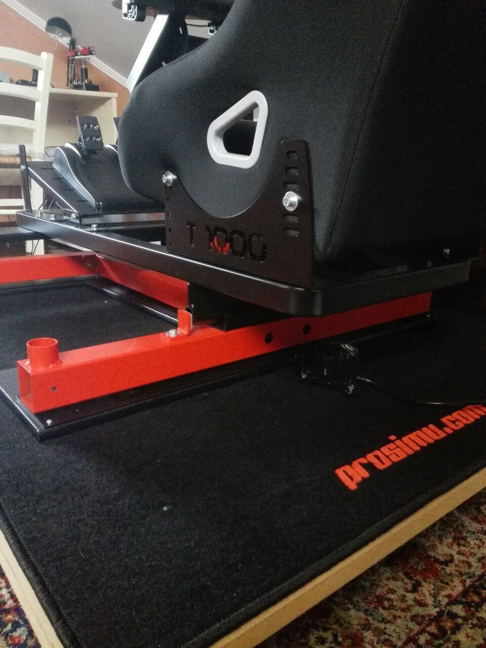

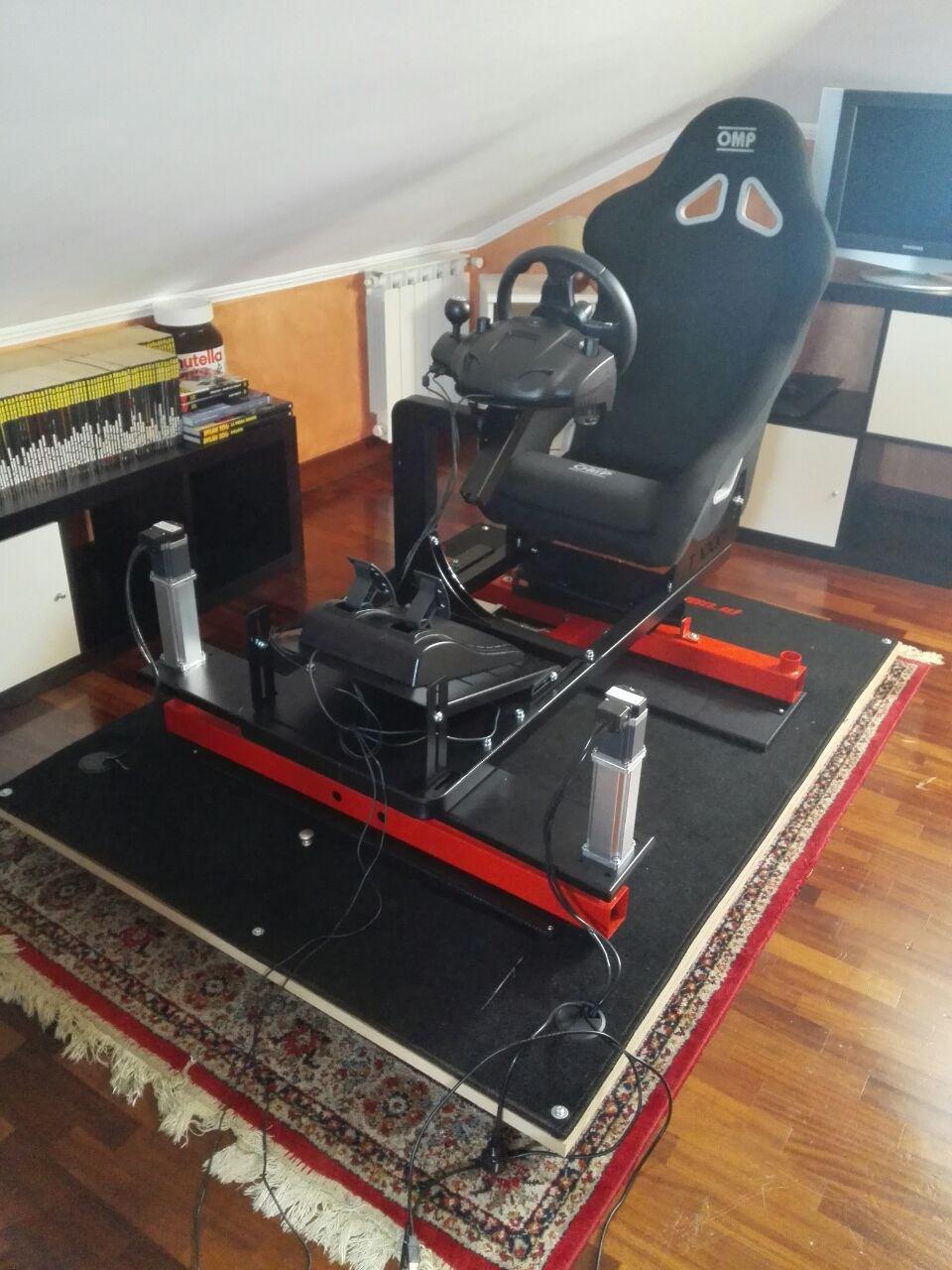

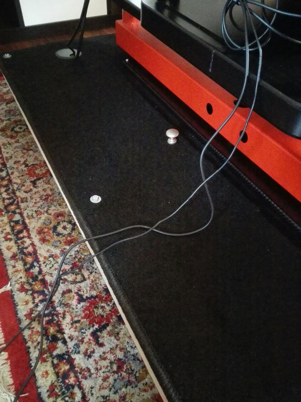

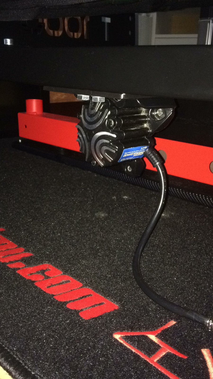

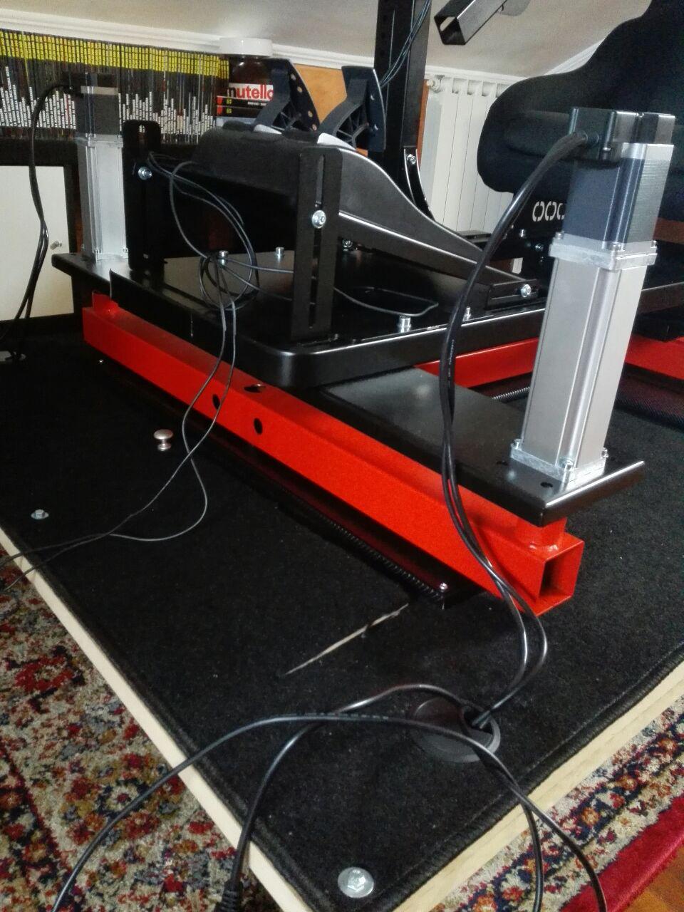

    After have sold my 2DOF rig...i've decided to buy a Prosimu T1000 3DOF.
    I was not convinced of a lot of thing but after tried it I can't say nothing else than..awesome!
    Pro:
    -SCN6 actuators are another world than DC motors; they are very fast and precisely. With this kind of actuator you can really feel little details that you lost with DC motor.
    -Entire frame is really clean, polish and simple. It's not very big comparized to a 2DOF.
    -Connections are very simple, 2 cables for actuator and all system is powered by a simple notebook power supply.
    Cons:
    -SCN6 actuators are pretty noisy.
    -when you stay on it...you don't want to get off :D
    Anyway, thanks Patrick because it's very a good simulator.
    Mirko

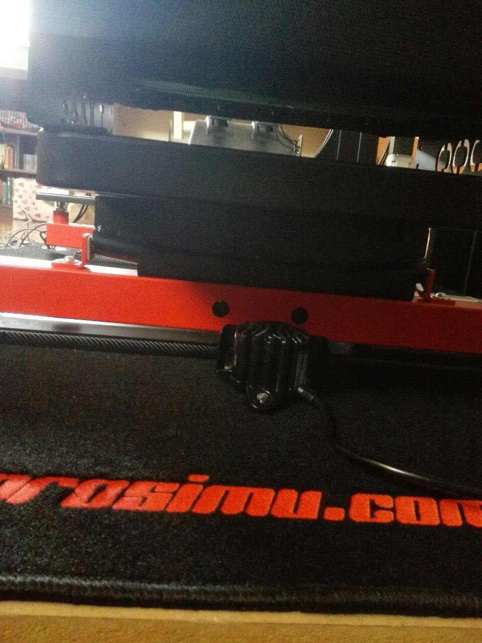

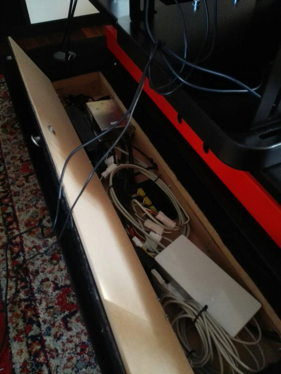

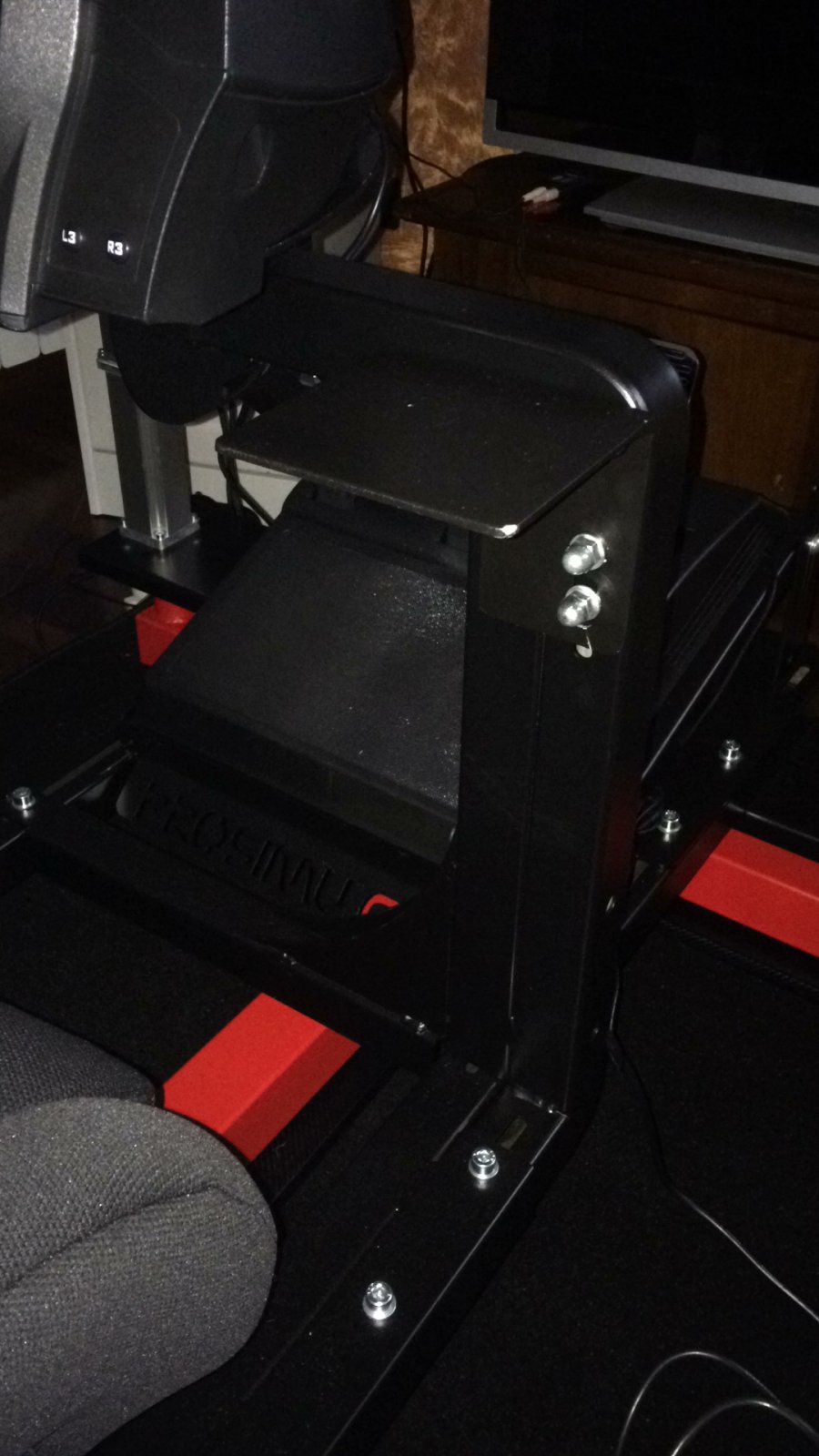

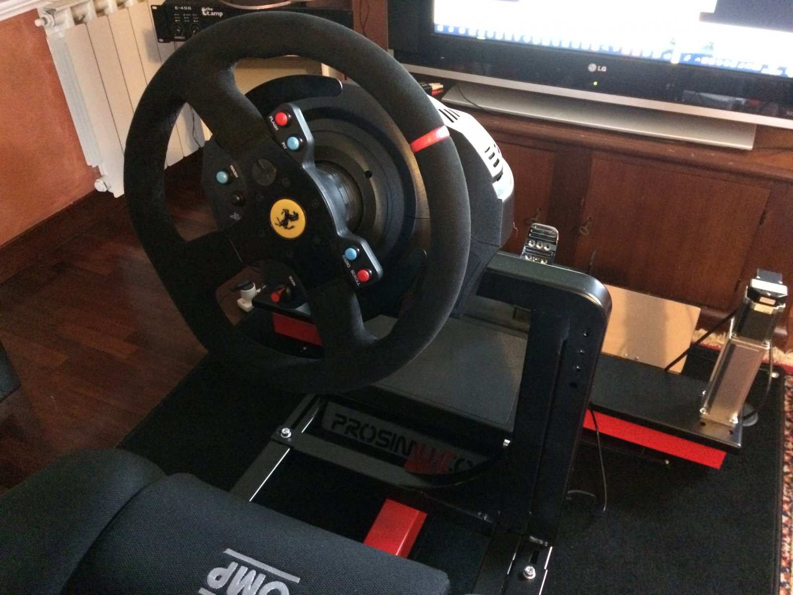

    Updates:
    EFA91817-9EF7-4C8C-BDAA-70BC4D8DD03C.jpeg AF624A82-9A80-4110-9FDC-B562BB224576.jpeg CAE625CF-3957-4348-A6CD-6B524D934DB0.jpeg 64A5DE8D-B834-4617-923A-FB4EC5FD36A4.jpeg 9417FB8A-D69A-45A9-89E8-CEF0E06FD9F5.jpeg 6C28EC9F-35E9-4B7A-95D7-C8E6B2F5B1E1.jpeg
