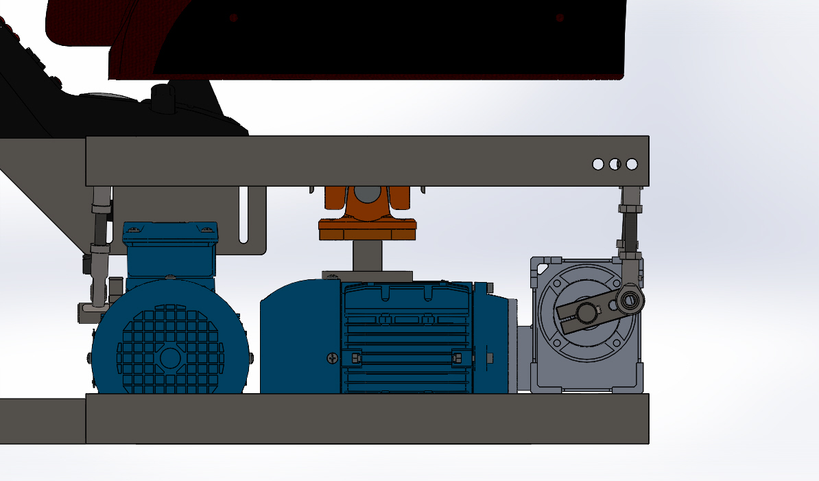

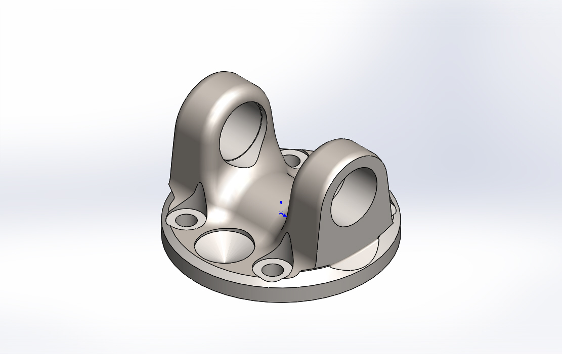

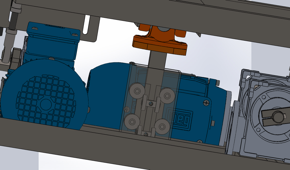

    It is mounted on a universal joint

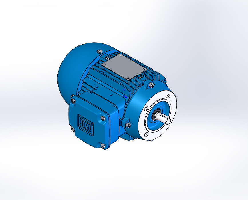

    motion cam gear motors

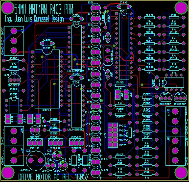

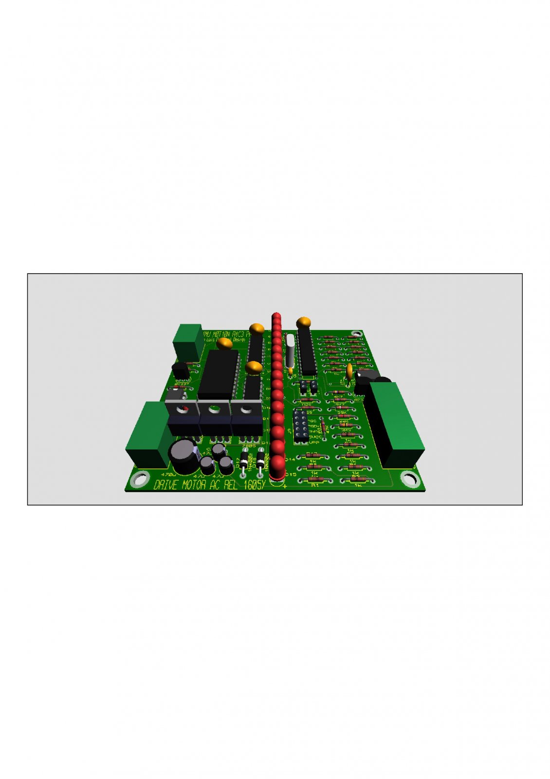

    BOARD OWN
    ONE FOR EACH MOTOR TO INCREASE EFFICIENCY

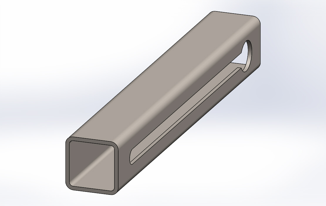

    ADJUSTABLE FOR DIFFERENT SIZES
    END OF PIPE WITH MOVEMENT

    Does the universal move up and down to allow heave?

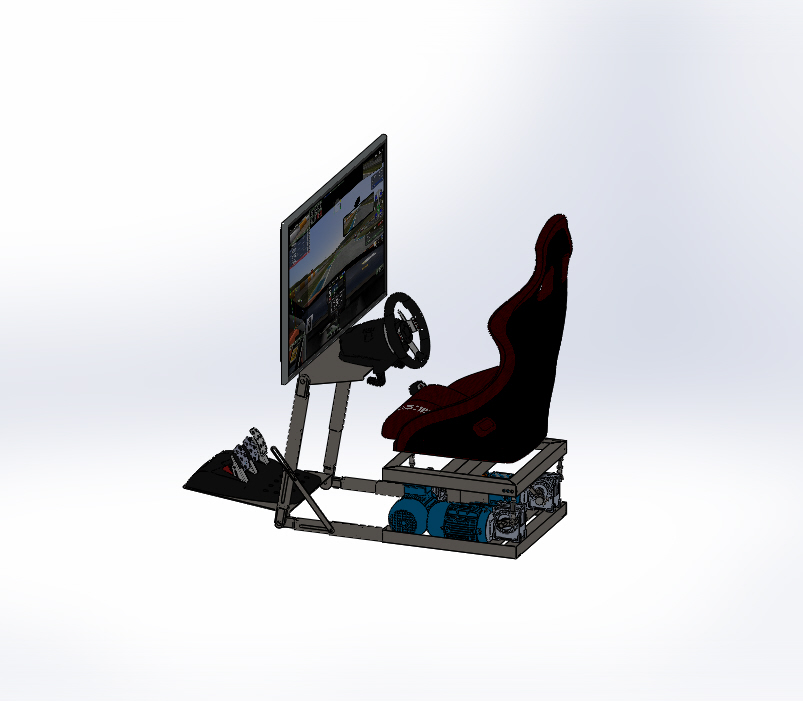

    SEAT SPARCO IN 3D
    Does the universal move up and down to allow heave?noorbeast
    G27 SHIFTER 3D
    G27 WHEEL 3D

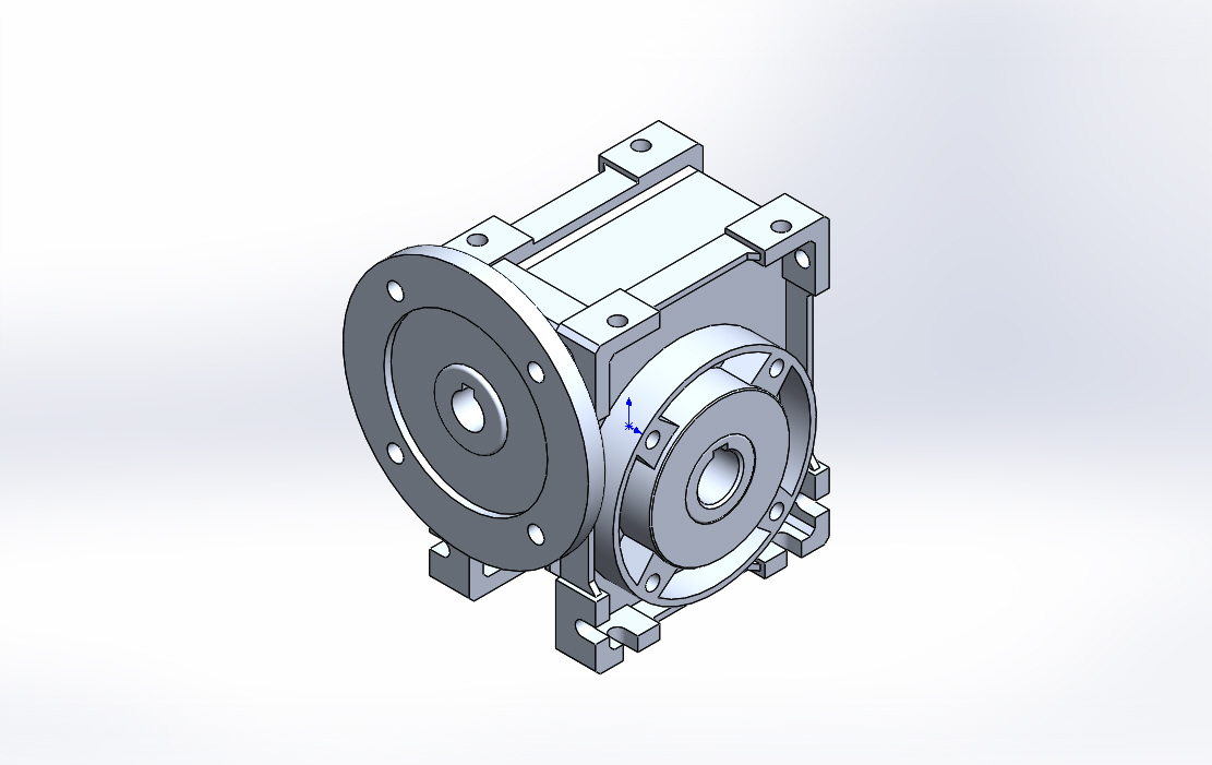

    REDUCTOR STM UMI 40 FA

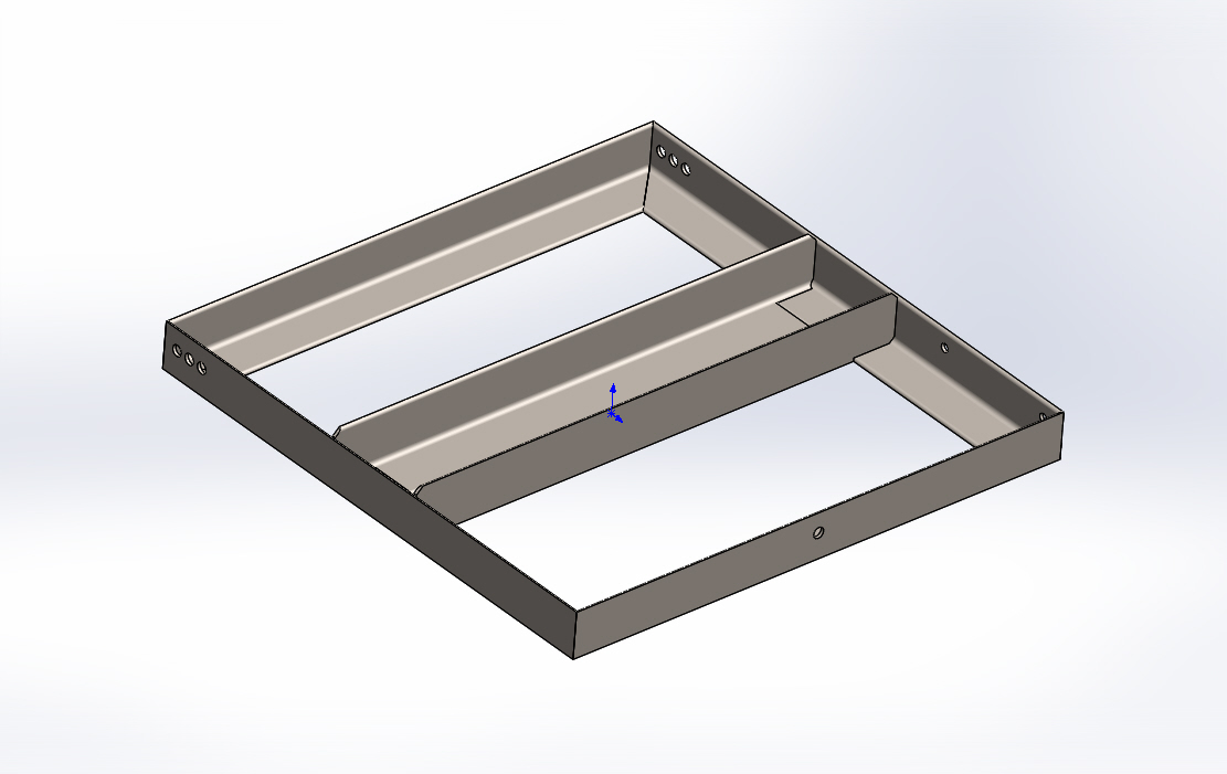

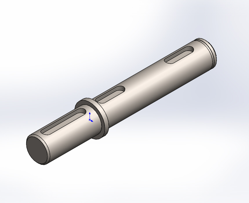

    TOP FRAME

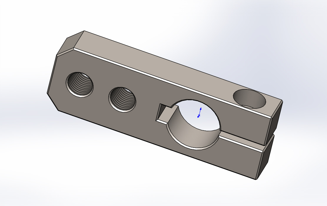

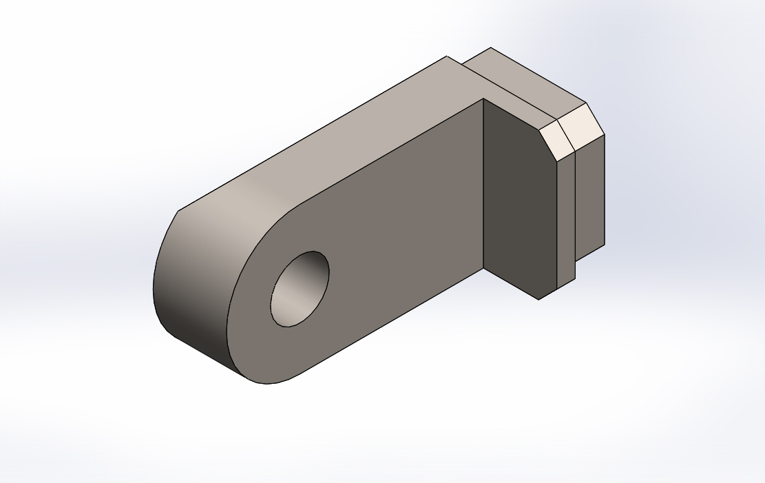

    I dont get it either. Looking at SEAT IDZ 4 pic, you can see something there, But im lacking to understand how that will work exactly. :confused:
    Any more details for us @juan_l ?

    With that kind of motors I don't see the need of a heave assist.

    From what I am seeing (I have a 3dof AC Platform) - He will have heave.................he looks to have a square tube that will move up and down - and is surrounded with roller bearing for tube stability and
    ease of movement....................on top of this tube, he has the u-joint attached..............IMHO, it will work.
    Tom
    PS - I use a 7 tooth Spline Shaft and Shaft Collar - Mine has spring assist.

    Sure it will work, I just don't see the need of any kind of assist or central guide.

    As "Close" as his three motors are together, a U-joint/Central guide is not necessary, "assuming his motors/gearheads are correctly matched and heavy-duty enough............
    IF his motors "were" spaced further apart (like mine are) then a U-joint/Spline Shaft / and in some cases, a support spring are necessary................all depends on the total weight
    of the of the top platform including rider.
