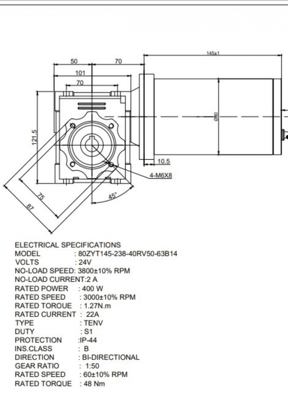

    I definitely want to make/fix the G seat. I also have two of these: upload_2022-12-9_17-49-30.png
    I also have some hall sensors, arduino boards (I don’t yet know if I’m going to use it.)
