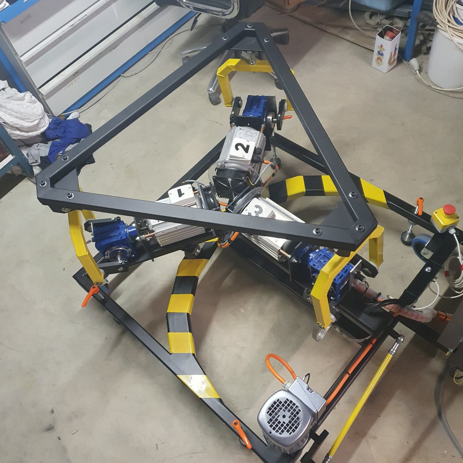

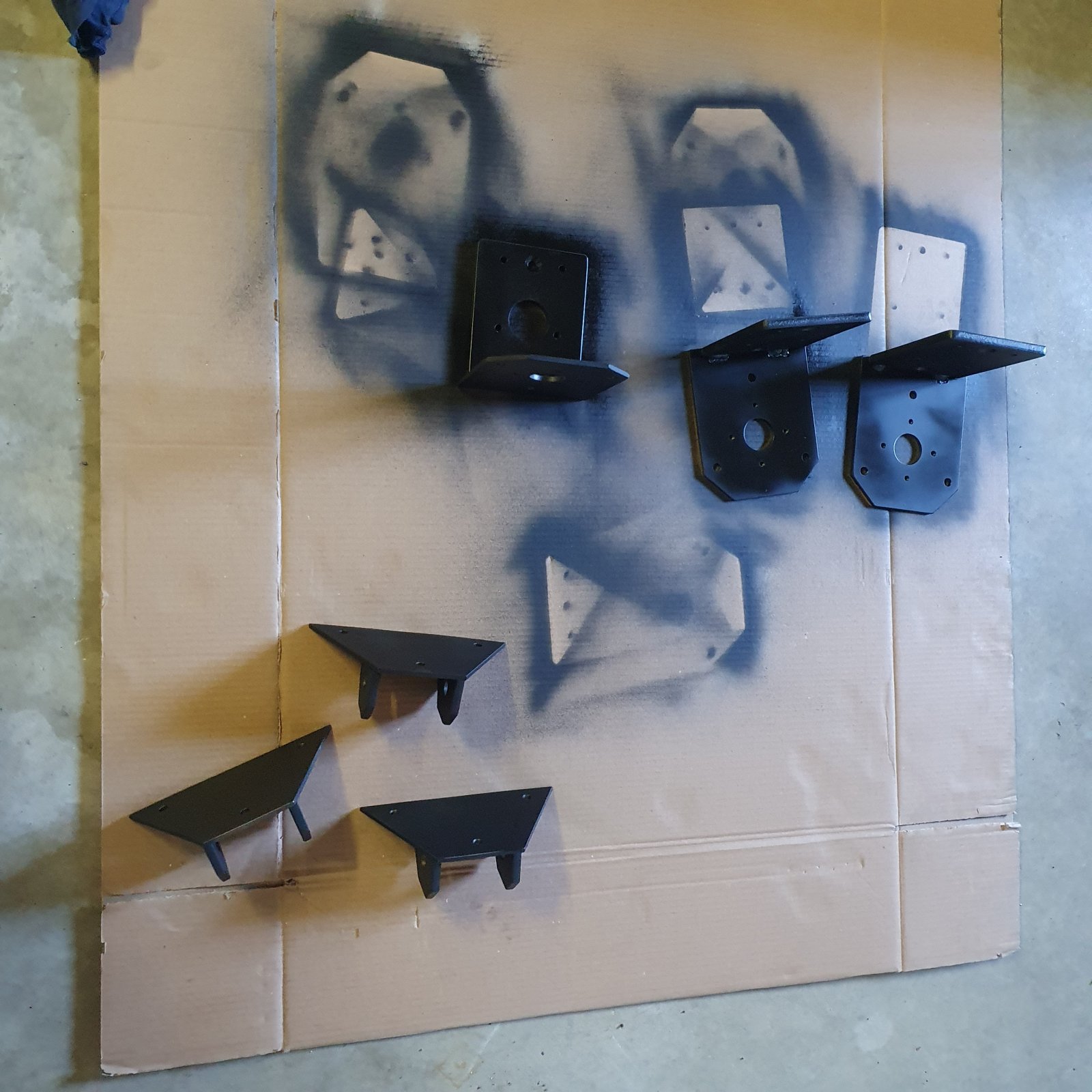

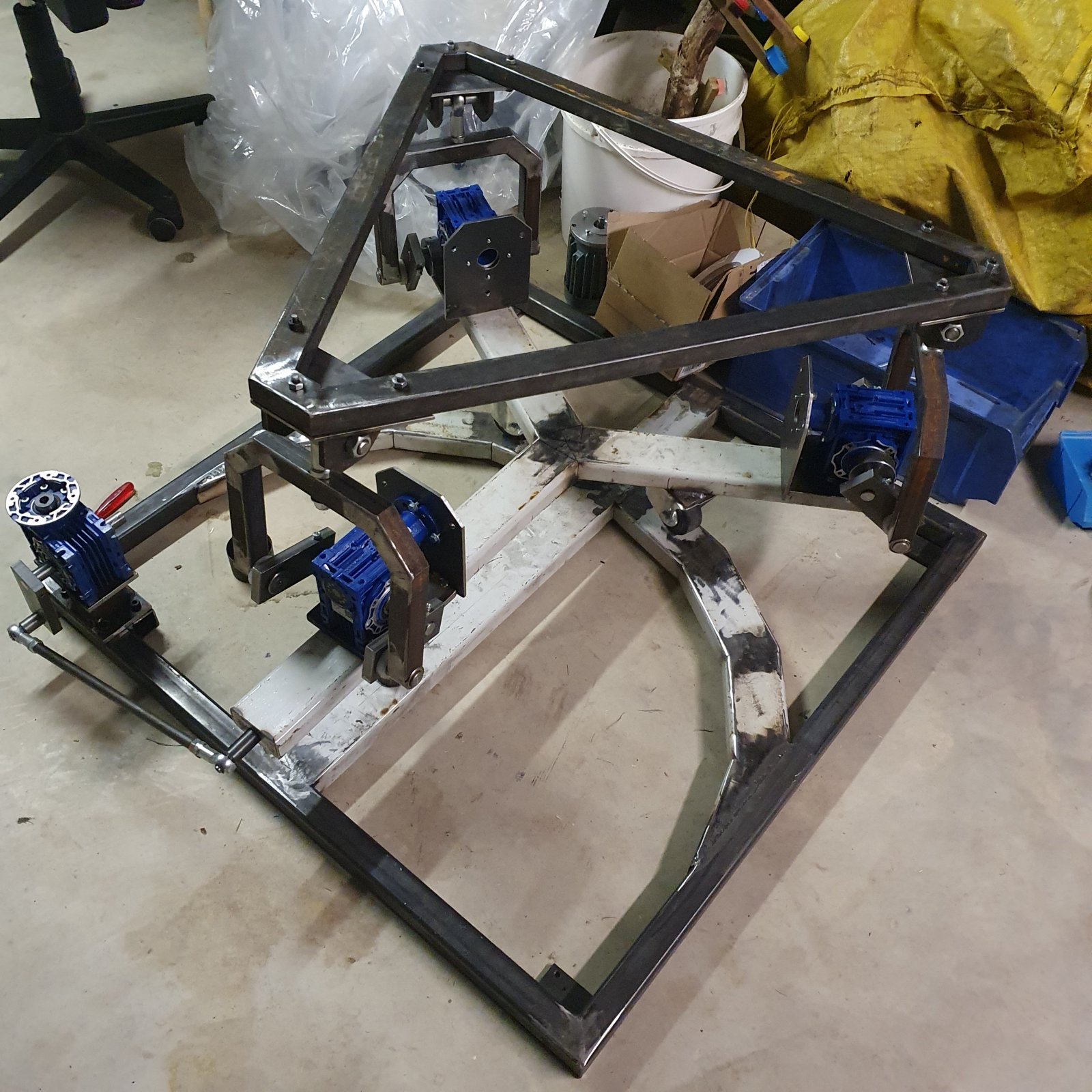

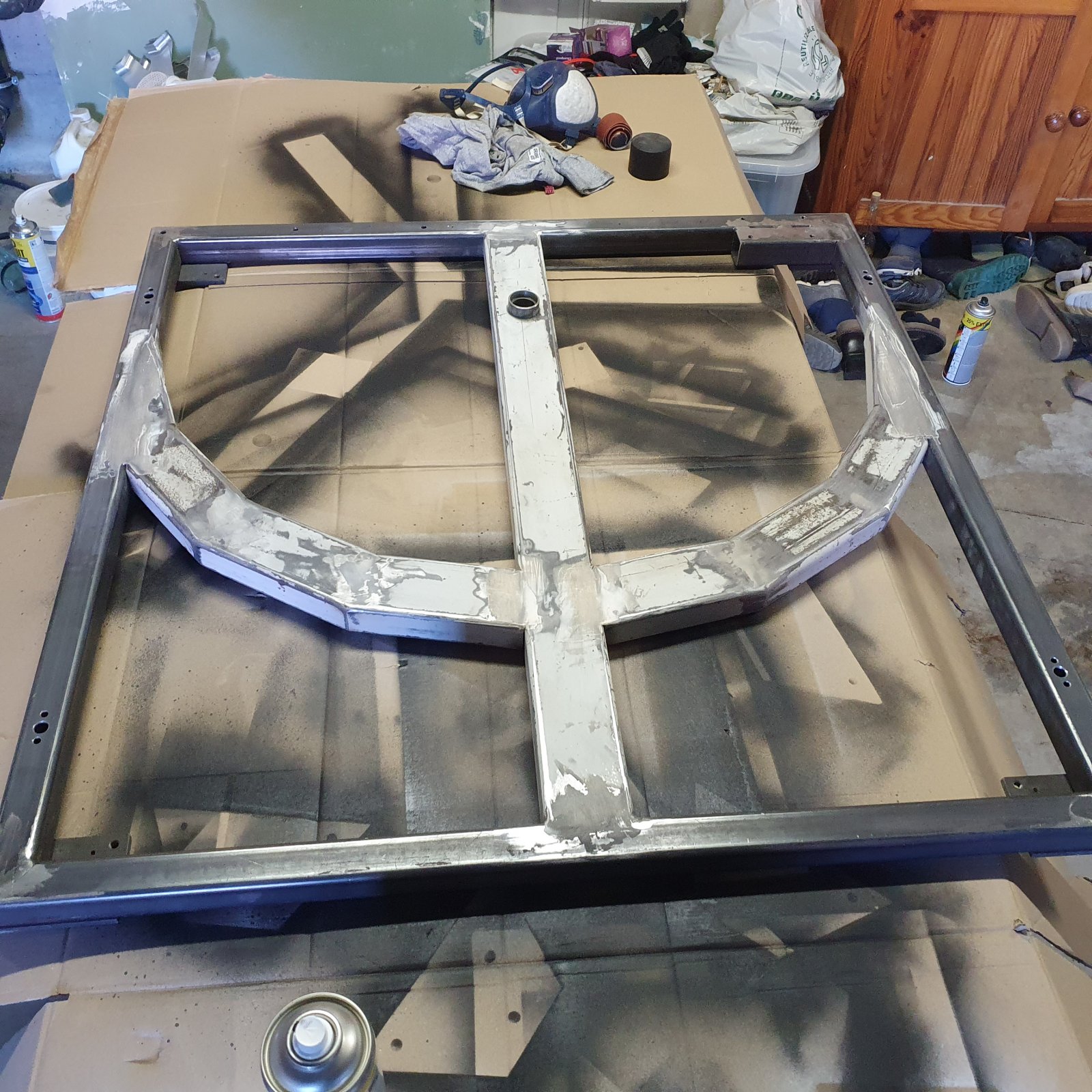

    good evening, here are the different stages of the construction of my simulator 20230404_105223.jpg

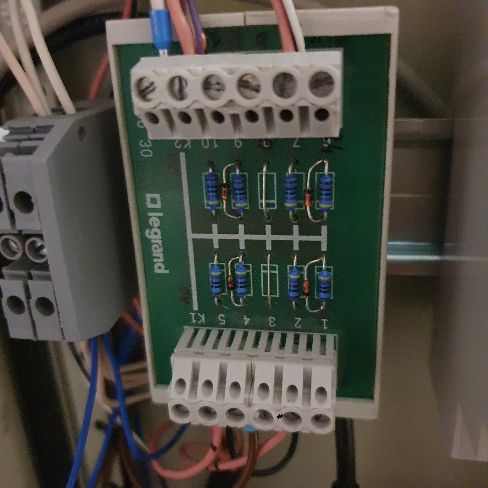

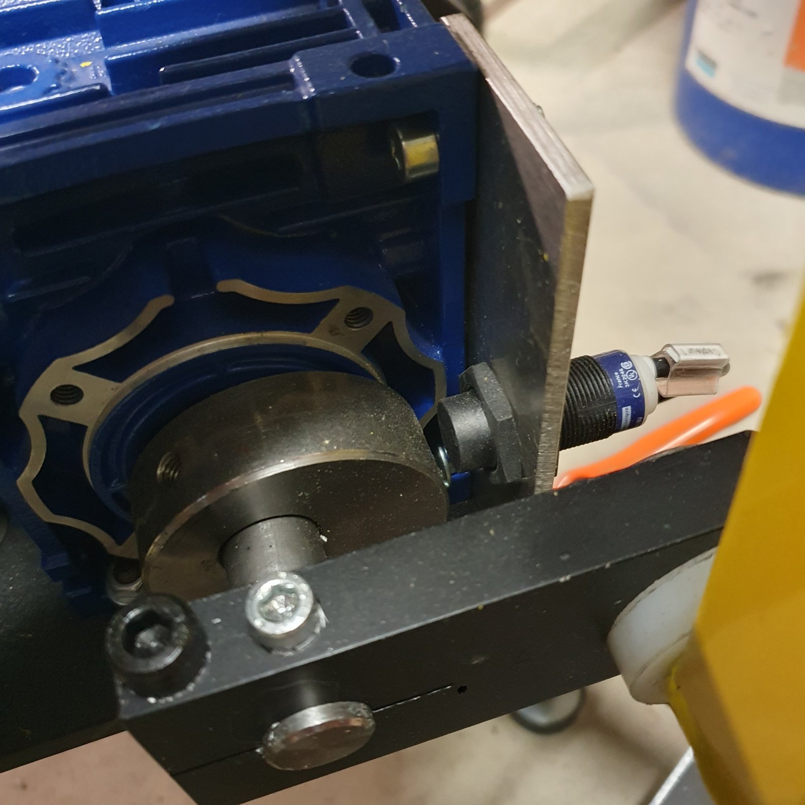

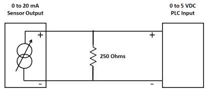

    to control the position of the arms I use analog inductive sensors (XS4P18AB120, 4 ... 20mA) instead of potentiometers in order to avoid mechanical problems: risk of breakage, wear of the gears...)
    the system is simple: I use a steel roller with an eccentric hole that moves
    when the platform moves, the detector provides an analog signal of 4mA ...20mA over a distance of 8mm
    this signal is transformed into 0 ... 5V DC by an electronic card that I created and sent to the input of the arduino

    here is the final result of my 4DOF project, the simulator works with F1 23 and a PS5:
