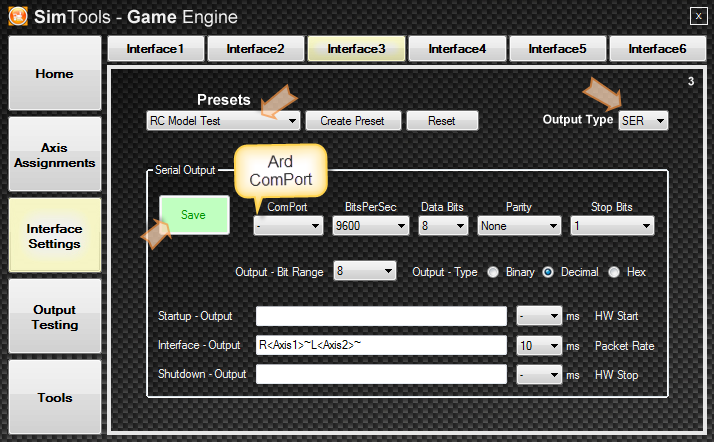

    I'm building a motion simulator, for RACERS.(posibility of using flying simulators) I want some more that a 2DOF. At least 4DOF would be great. My basic condition is that the simulator has to be "floating", suspended by the actuators. I dont need/want horizontal movement, right now, just inclinations to feel some little G's and heave.

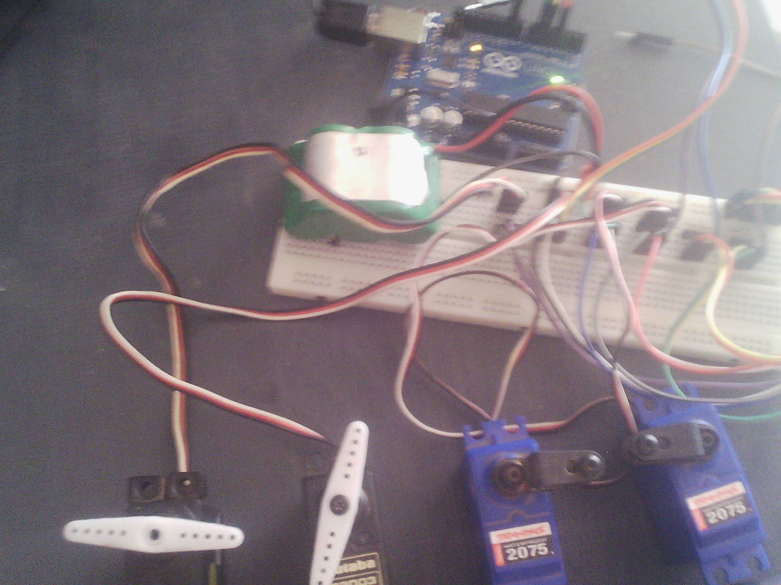

    I have no photos because nothing is built yet, I just have the Arduino UNO, 4 servos, 1 6vbatt, and a lot of pins and cables.
    First, I want to build a little plattform moving, with servos, using PWM signals to move them. When I reach a working code able to control up to 6 servos(or 4), and a working small plattform, I will start to build a big one.
    This "big one" is going to be a 3 monitor rig, so it has to be STRONG. About 150kg (by excess) without pilot, and a max pilot weight of 150kg. about 300 kg of lifting power ( will be less but ok)
    The powering: I'm thinking of 3 things:
    - "Real" servos: up to 6 motors ( steppers ) like NEMA 34 or similar. To achieve something like:
    - Homemade linear actuators, to make something like the HEXATECH simulator.
    -Gear worm DC motor like this one
    http://es.rs-online.com/web/p/motores-dc-con-caja-reductora/0718391/
    If I use the DC motor, I want to use a device like the JRK or a H-bridge able to power a huge motor.
    For all options, is it possible to use a device that changes PWM signals to control steppers (easilly configurable)?????
    Well so far, I have this code, which fails:
    It controls 2 servos, first servo works great, but when I move the "slider" over 45% of the axis1, servo2 in axis2 becomes crazy and goes to its top ( ~180 )

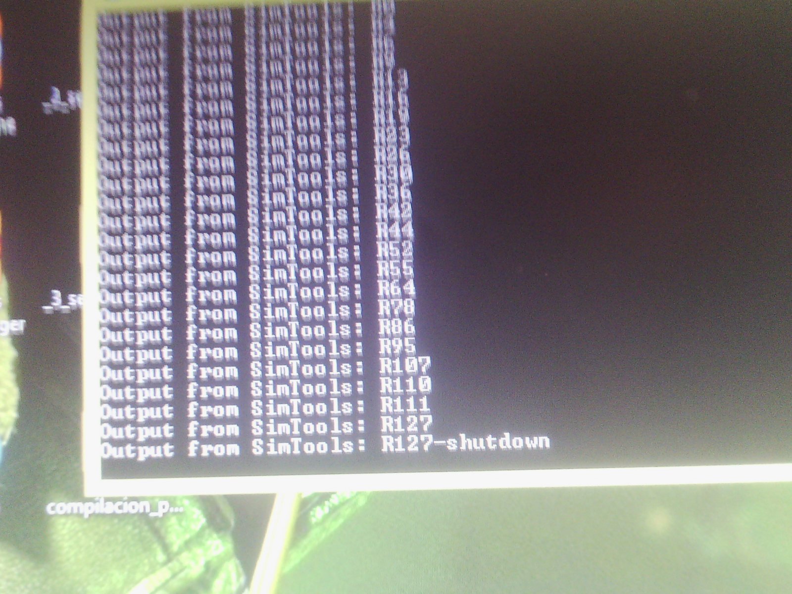

    THIS ONE is my own compilation took me 1 week to write it ( note i have 0 programming idea, ZERO) I've reached it from 3 or 4 codes i've seen over there, It seems to be ultraBasic.
    Its problem: only works on positive values, I mean, on the right side of the "axis output test". From center to left, servo goes crazy.

    As provided , one has debug and should only be used in the Serial monitor for testing with Rxxx~Lxxx~ where R is the right servo and L is the Left servo. plus xxx is 0-255.
    The other is ready for SimTools and can be driven in Serial Monitor but wont output to the monitors where the servo is, this cant happen if you want to use it with SimTools, it locks the serial port up on the Ard.

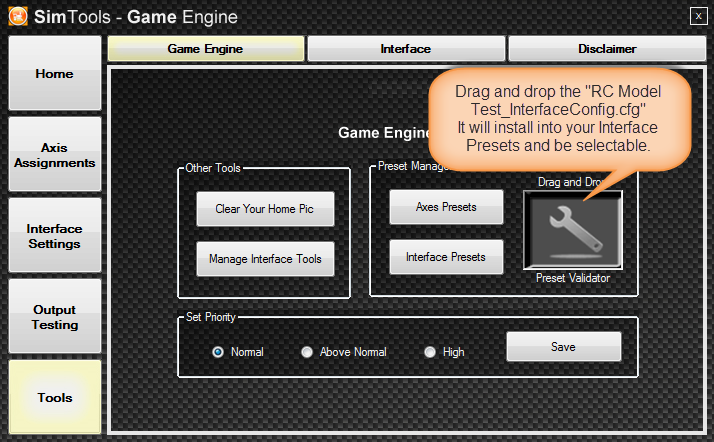

    Install the Interface preset supplied in the Zip like this :
    And how to select this preset and setup the interface tab.
    1. Select Interface
    2. Select the Output Type to SER (Serial)
    3. Select the RC Model Test Preset from the Presets.
    4. Add the comport the Ard is connected too
    5. Press save
    6. Ready to test if a game is patched or even just to test via the Output Testing.
    One note , needs a default axis to be set in the Axis Setting too.
    For example:
    Axis1 Roll 50% Pitch 50%
    Axis2 inverted Roll 50% Pitch 50%
    Make sure you press Save once all set before moving on.

    Hey Robbie, thanks a lot for your info. I have already tested the RCmodel arduino code with simtools, it has a perfect movement of each axis (2) with some problem, it is related with the problem on my own code.
    On my code, when i'm testing the axis, the servo goes crazy when going under -18% -20%, this is due to the value sent by simtools R100 and R99 ( R is my Axis1 too)( works great on values >-20%<+100%)
    I guess when the app sends R99 there is a lack of a character so the servo goes crazy.
    In the RCmodel code. Servo 1 works great. but when servo1 goes under the same point than with mycode +-(-20%), servo2 goes to 180 ( at full )
    I'm talking about direct axis control, I will configure DOF's and movements to axis later.

    About my actual connections, my Ard has connected only GND, and signals on pins 3, 5, 6, 9, for now I have a 6v NiMh batt running the servos, and a second 7.4 7600mAh lipo with an U-BEC set to 6v 3A
    Excuse low cuality of photos.

    I am so sorry for my last message, my newbishness :p made me error. You use 9600 bauds for a reason, right?
    I was using 115200. Just changin the value to 9600 everything works great. Using 115200 makes the servos wild at some values.
  8. eaorobbie
    20,506Coins
    +1,687 / 23 / -2
    Ah serial communication error, to run at 115 200 think you need to increase the SimTools ms on the output , well test with changing that. But I choose to run at 9600 as its more stable and didn't note any lag.

    I got my 3servos 3DOF running It is not stable because im using 3 traxxas steering tie-rods from my summit. But it works.
