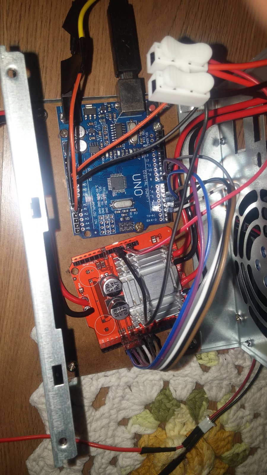

    Hey. greetings
    could you tell if it works for you. I'm doing a same one, but for now nothing. What code you use?
    thank for your time.

    Hi, yes mine is working 100%.

    I used the smc3 to configure the engines and then sim tools.
    follows the tutorial , has the files to download the program that will in Arduino and program that will on your PC, which is the smc3.
    search on Google by smc3 xsimulator.

    i download the matt code for arduino. It works in the pahe of test output axis. But val when i start the game nothing. neither the vallues of the salider dont move.
    The smc3 that you say, its only for 3dof or works for 2dof?

    158Coins
    +9 / 0 / -0
    I also tried to use this code and happened this case like yours. there gave up and I was pro smc3. but only works opening programs and the game as administrator. tries to do it there. and Yes, the smc3 works perfectly with 2dof.
