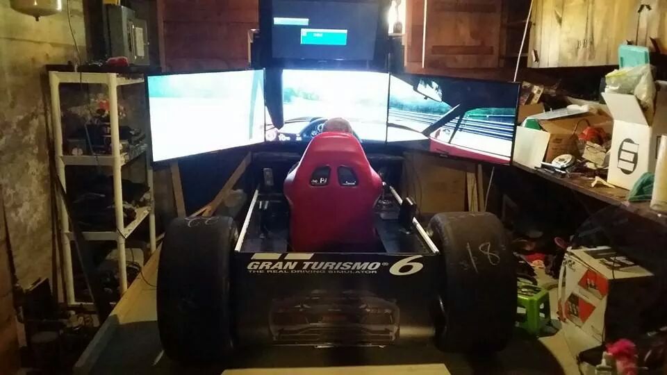

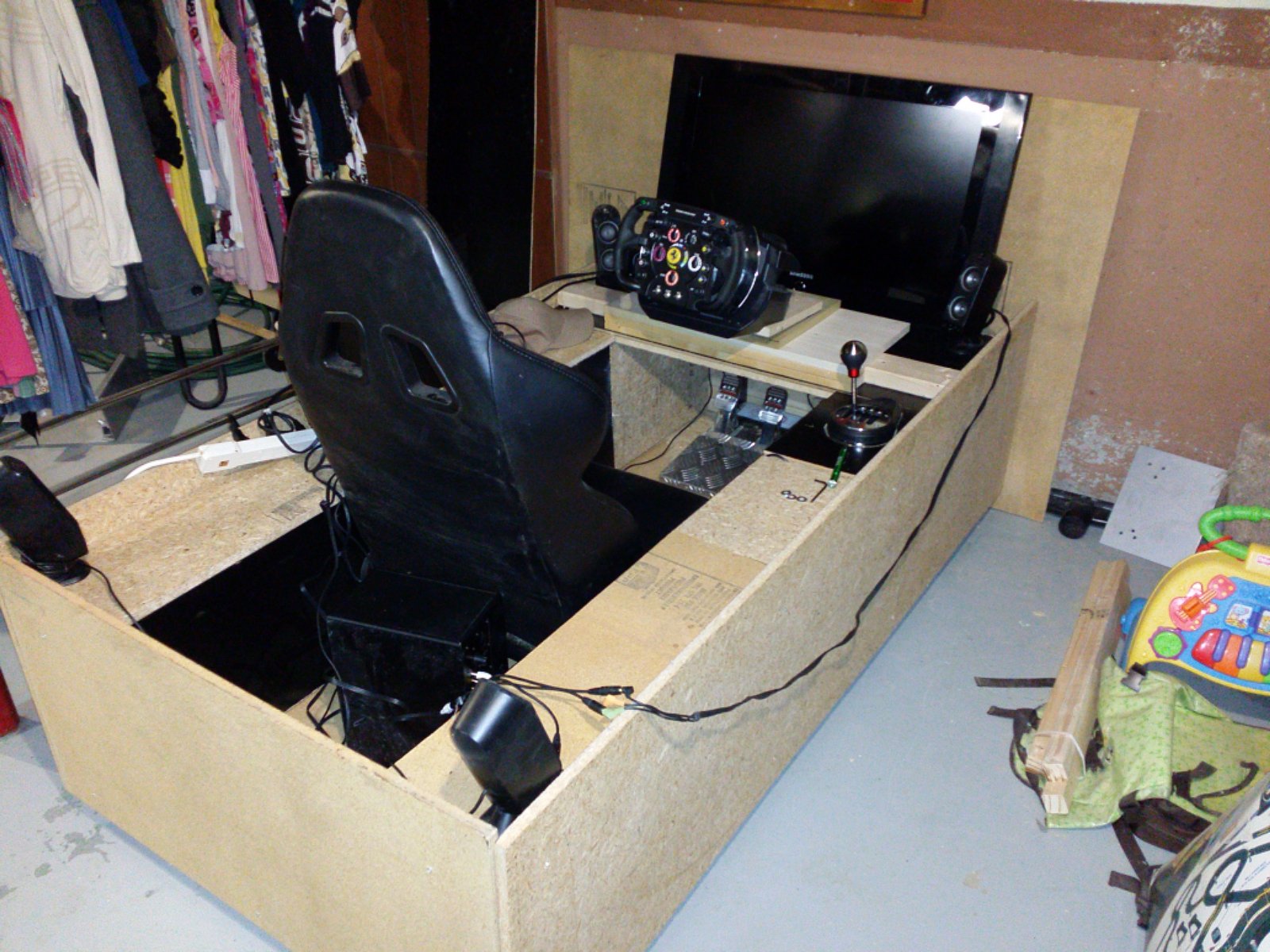

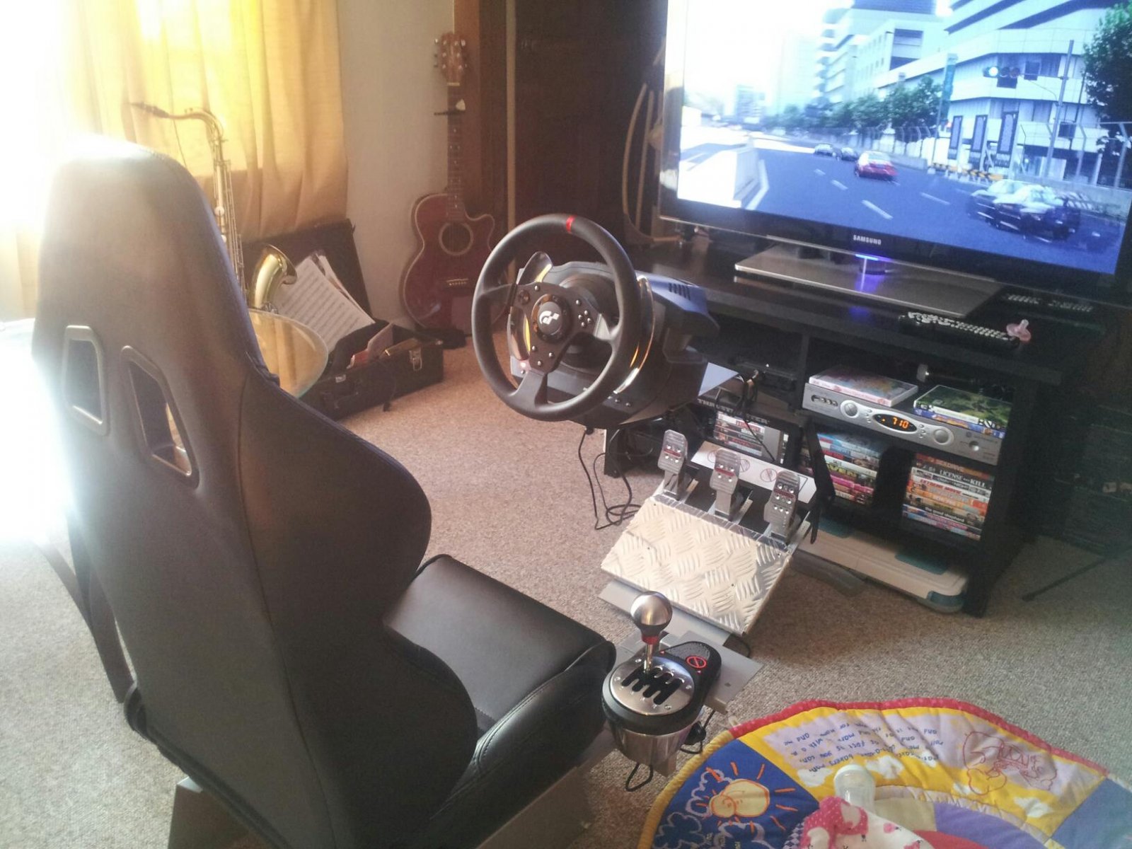

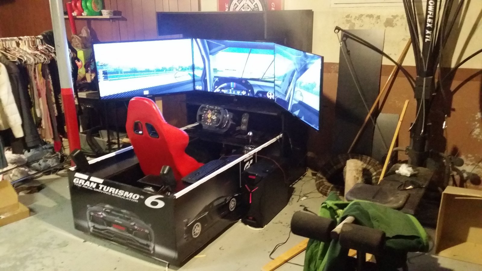

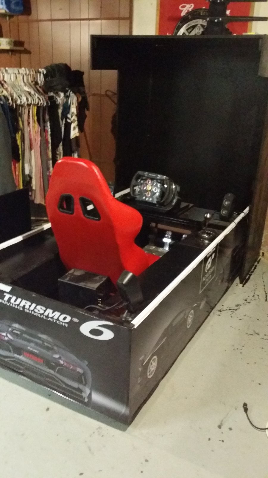

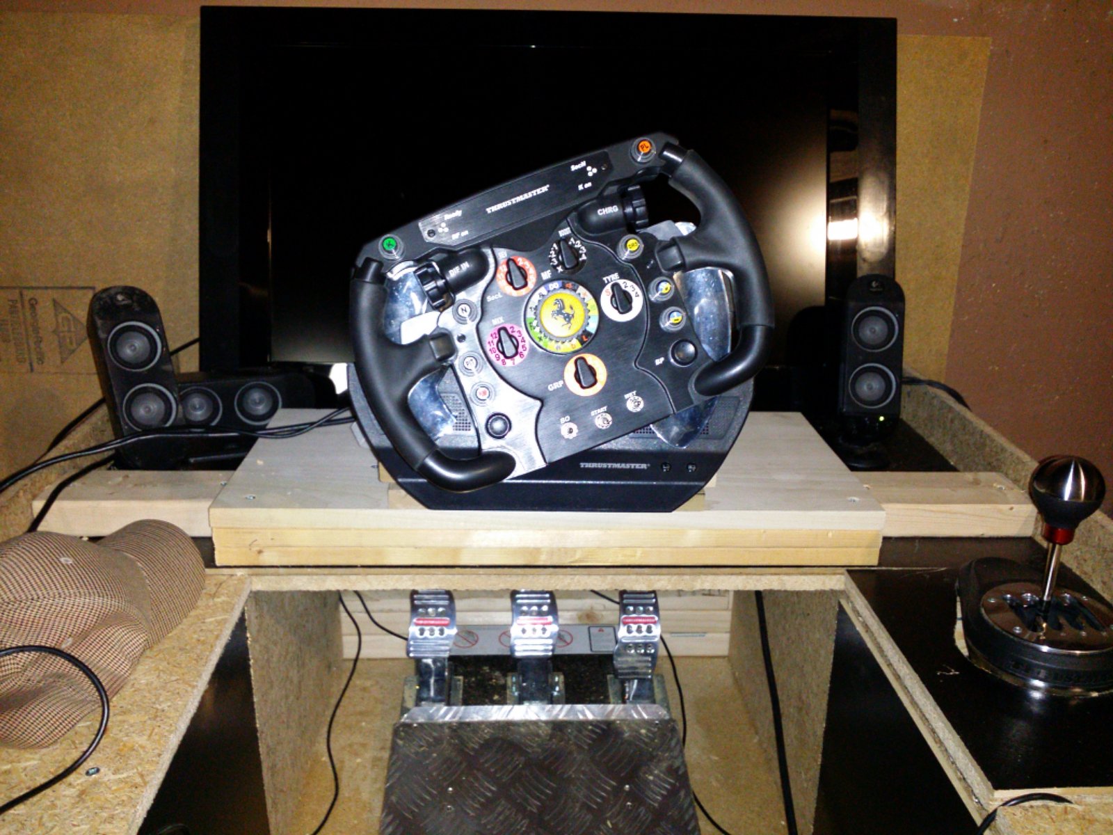

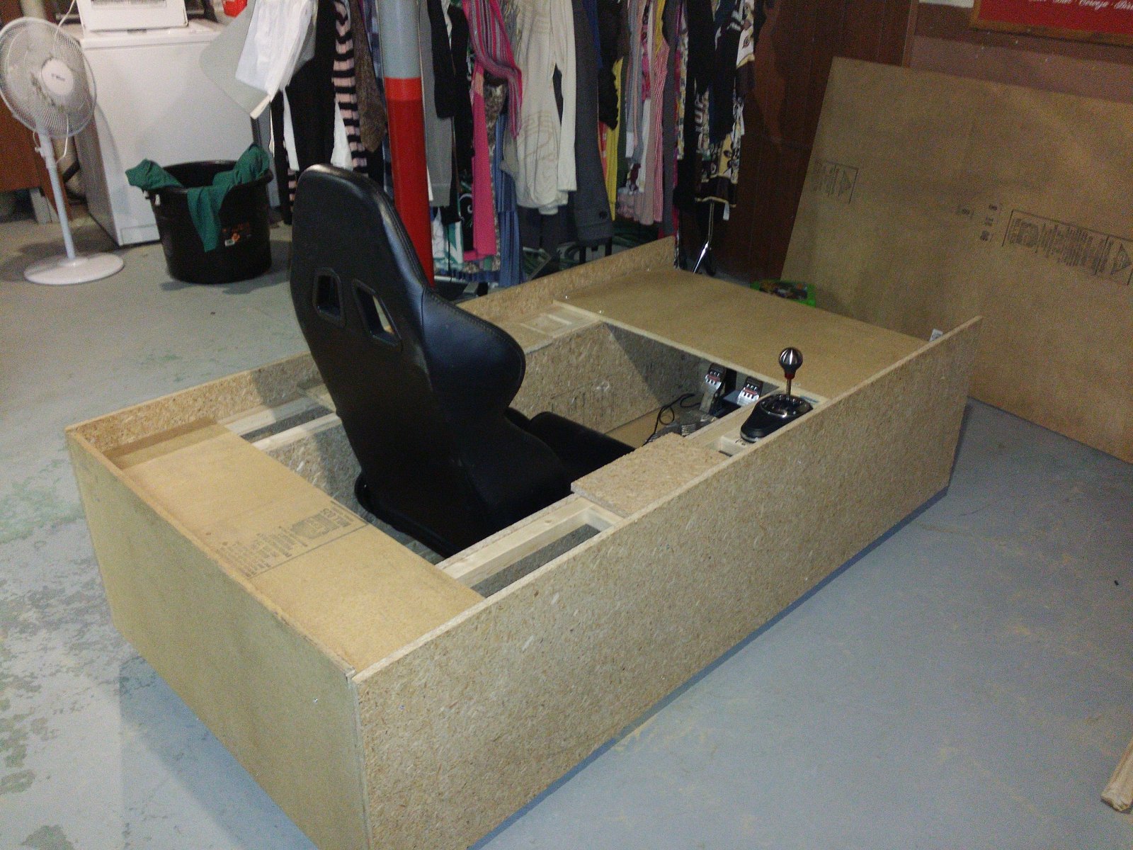

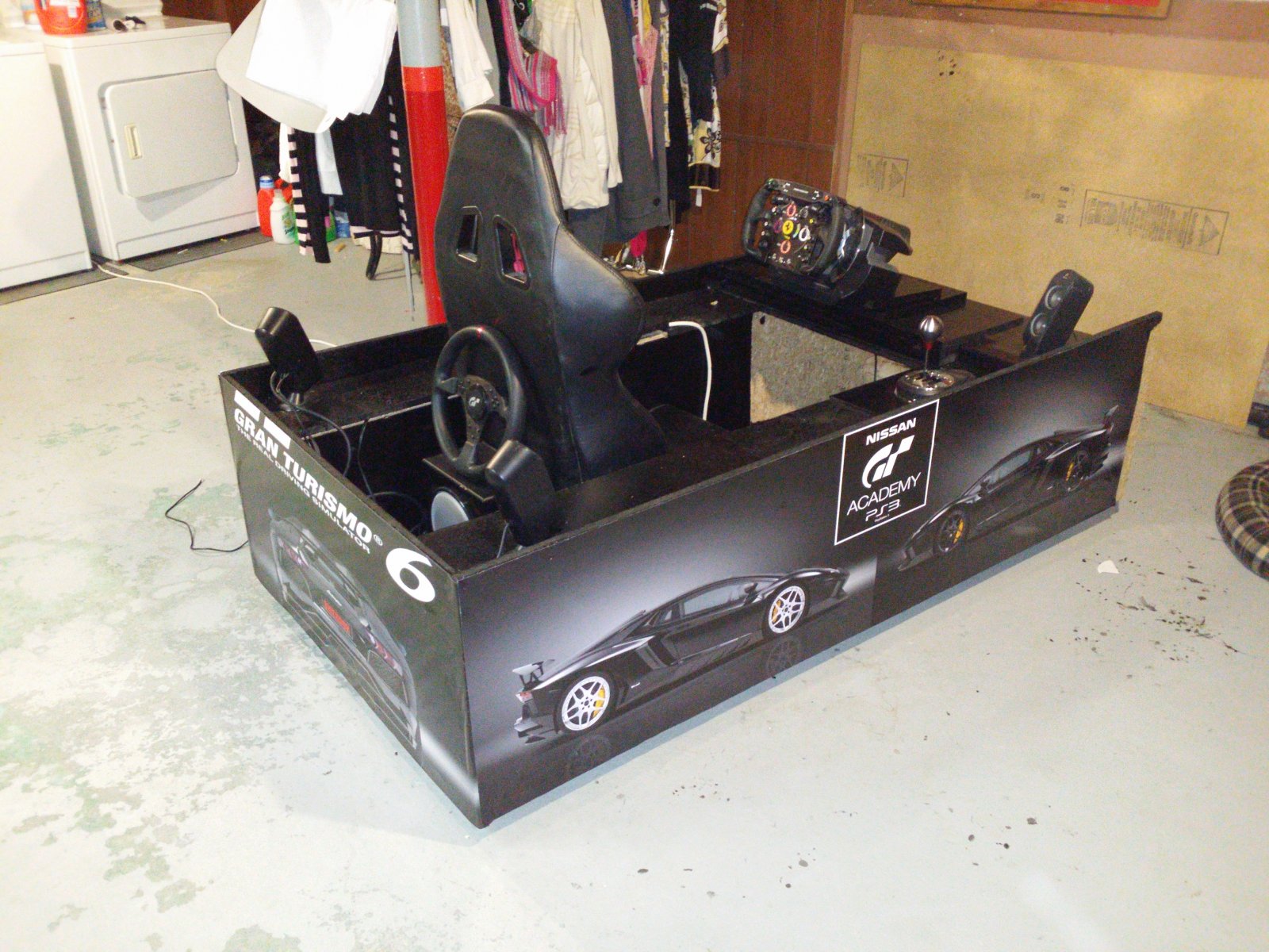

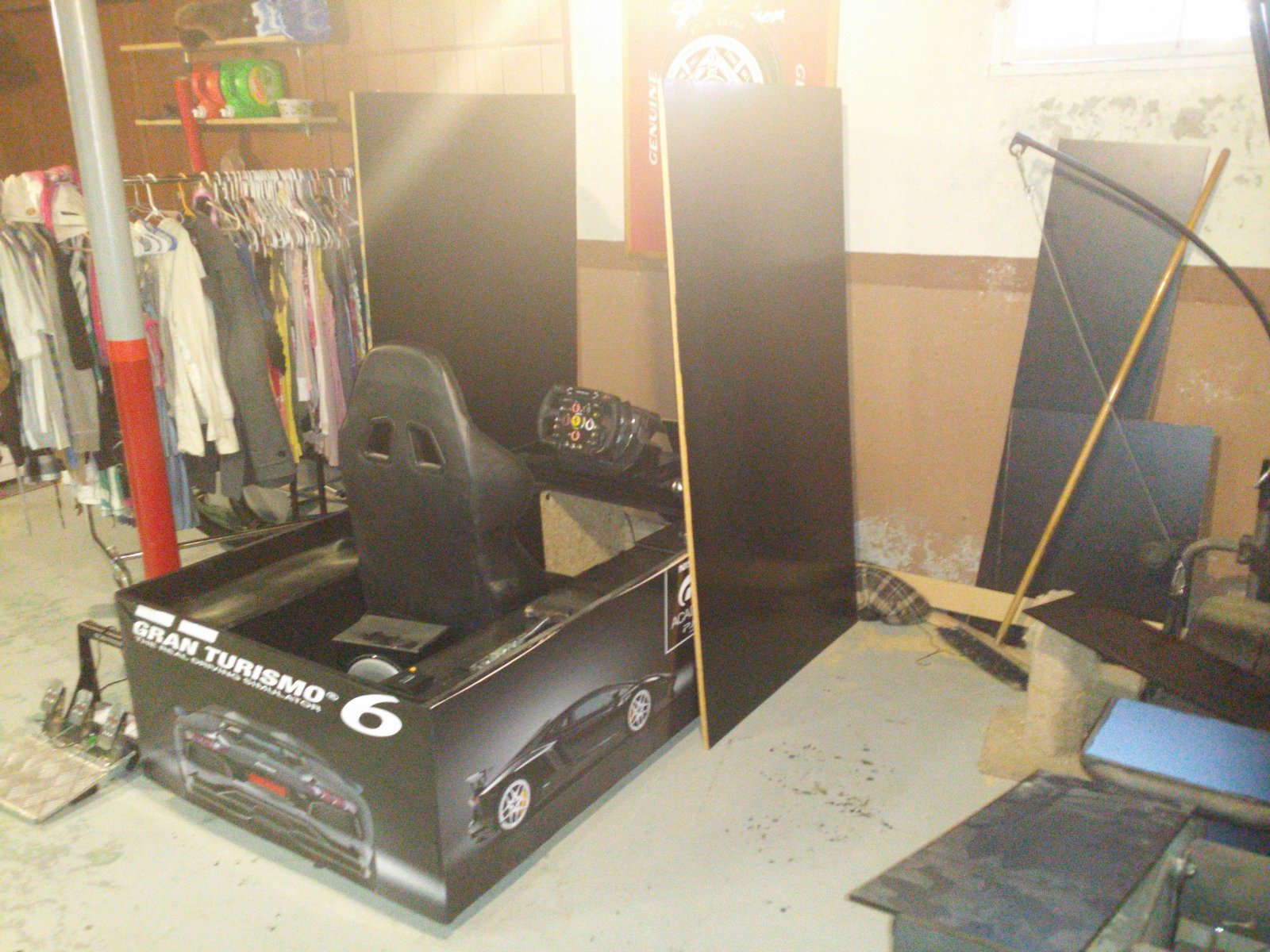

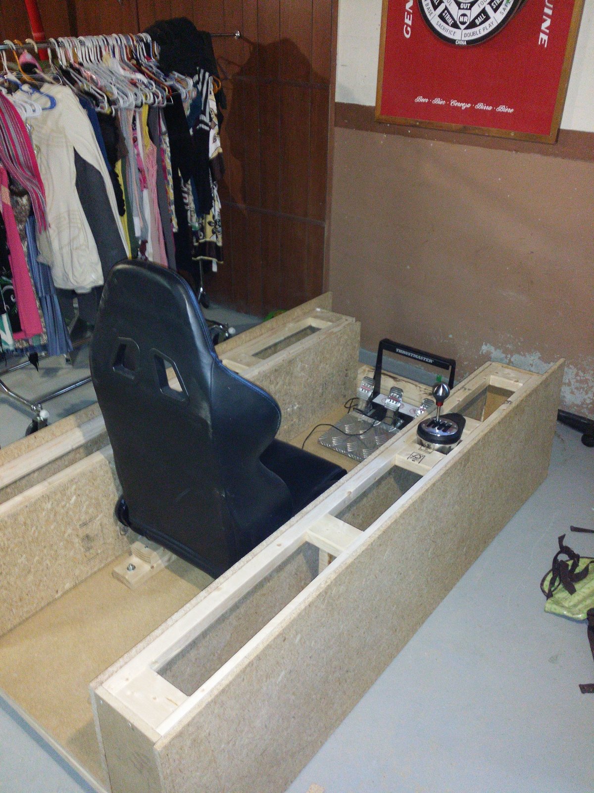

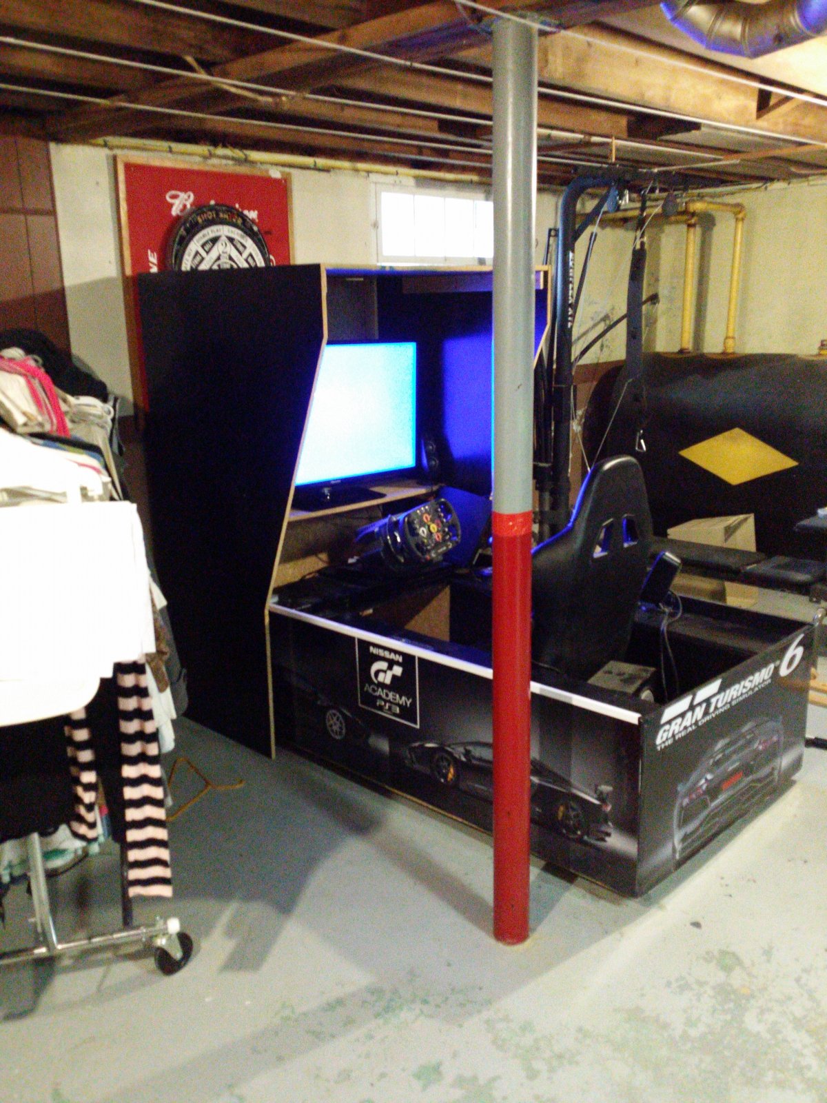

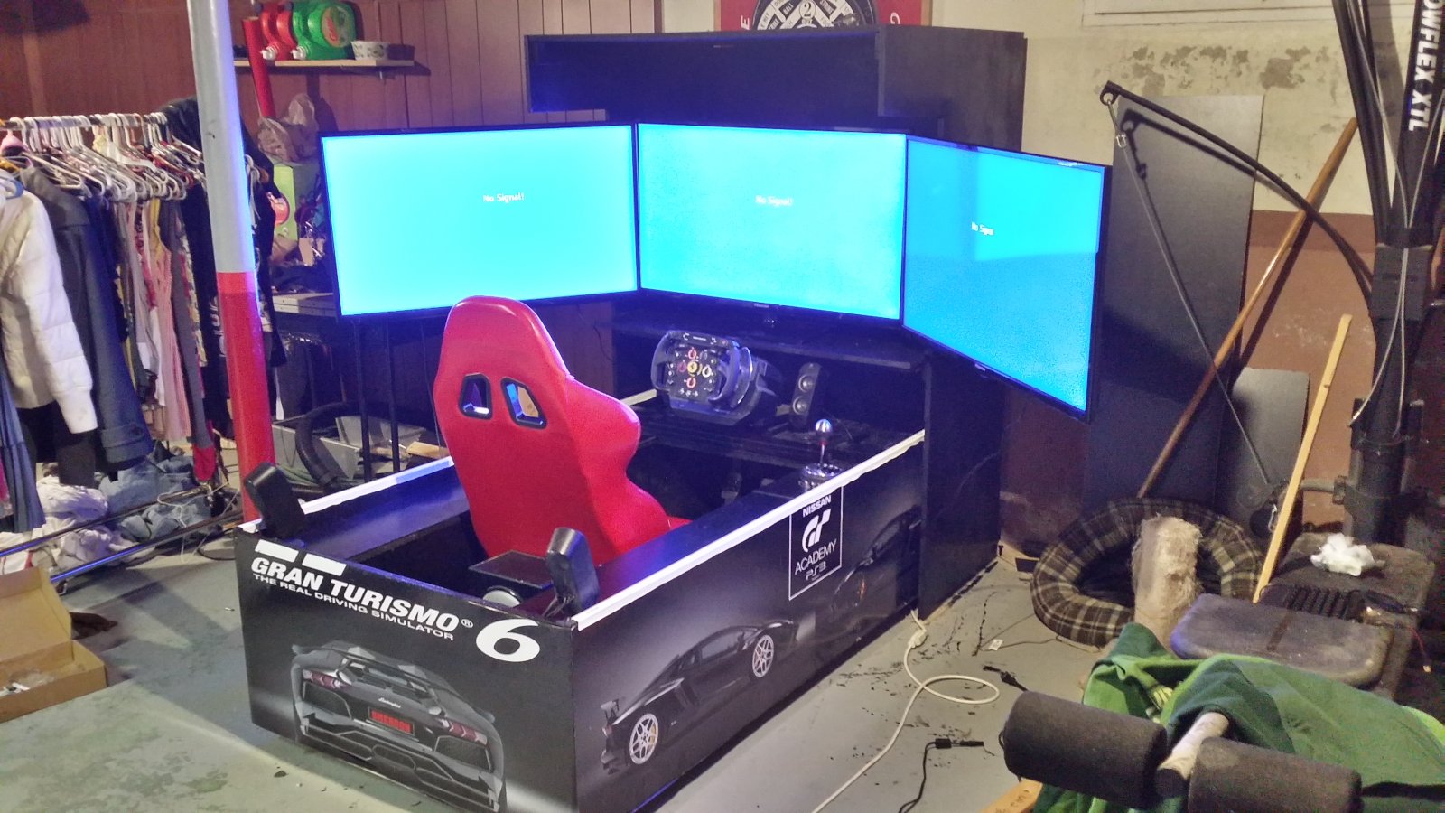

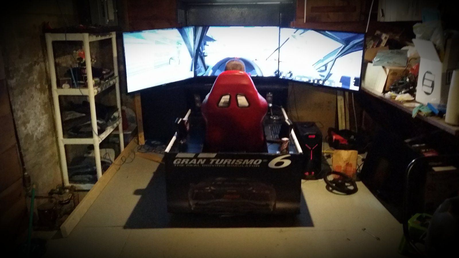

    17571 17572 17573 17574 17575 17576 17577 17578 17579 17580 17581 326928_10150632794663637_1167255170_o.jpg IMG_20140112_191950.jpg IMG_20140115_115941.jpg IMG_20140115_164248.jpg IMG_20140115_164256.jpg IMG_20140117_164459.jpg IMG_20140118_202559.jpg IMG_20140118_202615.jpg IMG_20140118_202652.jpg IMG_20140308_200038.jpg IMG_20140314_180818.jpg IMG_20140322_152228.jpg 20140418_221008.jpg 20140417_065824.jpg 20140418_221021.jpg 20140419_220355.jpg 20140420_092059.jpg 20140420_212317_Richtone(HDR).jpg 20140420_235307_Richtone(HDR).jpg 20140421_012021.jpg 20140516_135527.jpg IMG_5194164532303.jpeg 20140407_215843.jpg 20140407_215856.jpg 20140521_182708.jpg Going to start to make my rig into motion sim. I just don't want to change my setup that much. I'm going to try to add it to what I have.
    Here are some pics of my rigs life
    Sent from my SM-G900T using Tapatalk

    Think if I remove the back cabinets I can fit the actuators in there

    Yes its doable with a little modification.
    Nice setup!
    Everything you need to know can be found in these forums.
    Just finished mine yesterday, Im having all kinds of fun now.

    Nice setup already.
    If you're talking about SCN5 actuators just search on SCN5 there is a lot of info in the forum.
    I think this one from Seppel is a great example for you and to fit into your rig.

    Awesome rig u got there Ryan, What size screens are those ?
    Motion's a breeze when you understand it all. How are you planning on going motor wise ? Actuator, Gear motor, or maybe even Dbox ? Seat mover is what im thinking your wanting.
    I personally went Gear motor and seat mover for the cost/size and the fact some Highly rated sim builder's Prefer their seat movers over Full frame movers.

    Thanks Rinus. They are 40inch I need to go cheap. I have to much money in this. What do you recommend. I don't have enough for scn5 but want my set to move with the turns and gas/braking

    Hey Ryan, I Highly suggest going the route i went, I have less than 8-900$ into the project and that was with spending a bit more than i wanted to in my Seat Frame and Miscellaneous welding.
    here's my thread, have a look and see if there's a way to incorporate the motor's to your current rig, The Motor's at the end of the thread also might suite your need to keep thing's more "inboard"
    http://www.xsimulator.net/community/threads/2dof-diy-seat-mover.5271/
    Oh and I am Extremely pleased with the gear motor's on my Rig, Couldn't really ask for much more to be honest, They are Uber fast and dont have a problem pushing my larger buddy's around. (im 150lbs, buddy's are 200+) I did have a little quirk with one of the gear boxes but when you read my thread you'll see the seller's an awesome guy and is swapping the "potentially defective" box. Currently working great however.

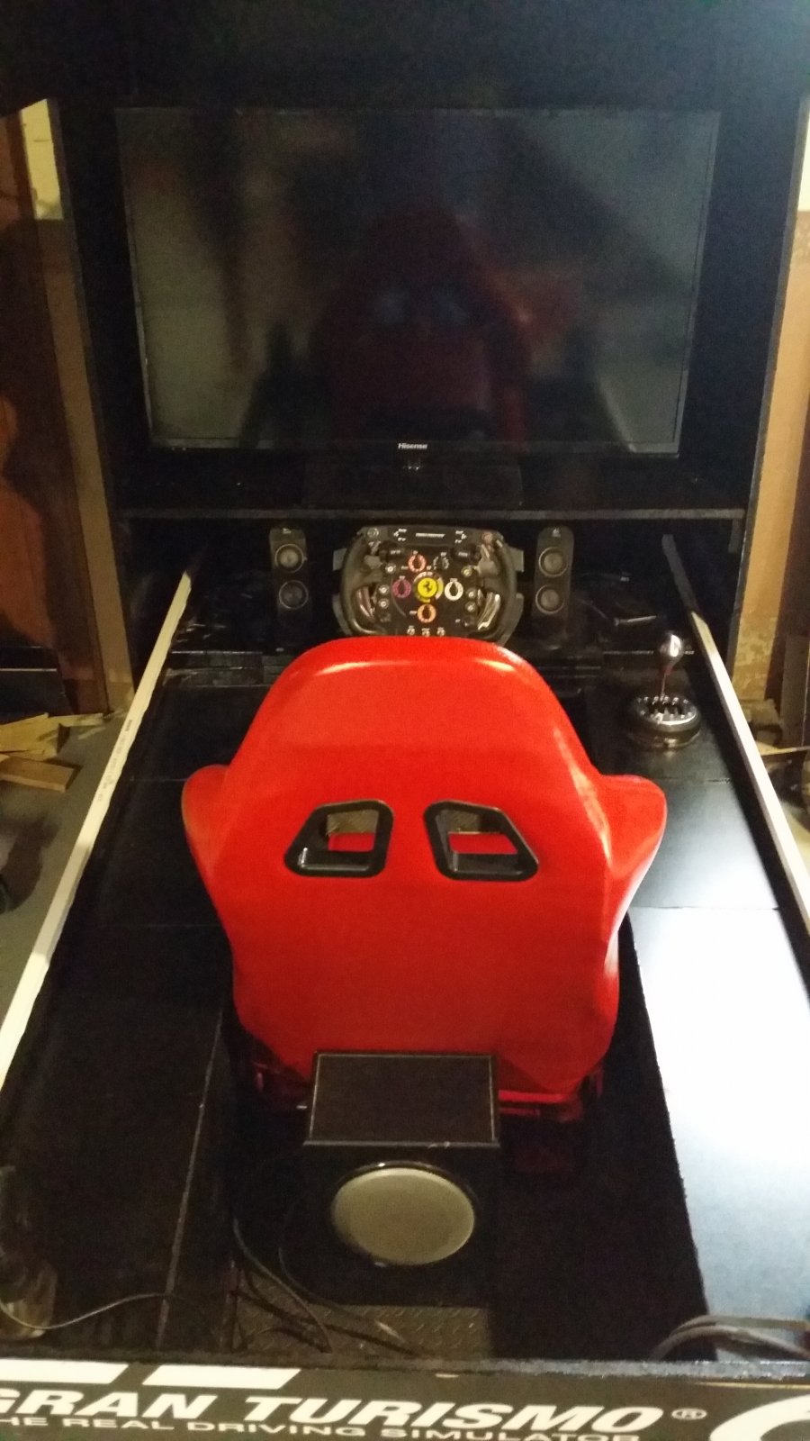

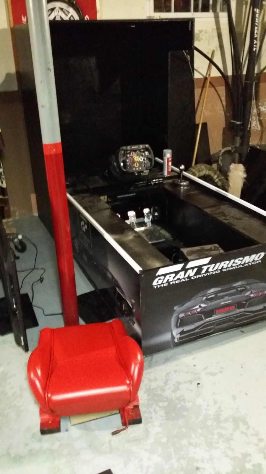

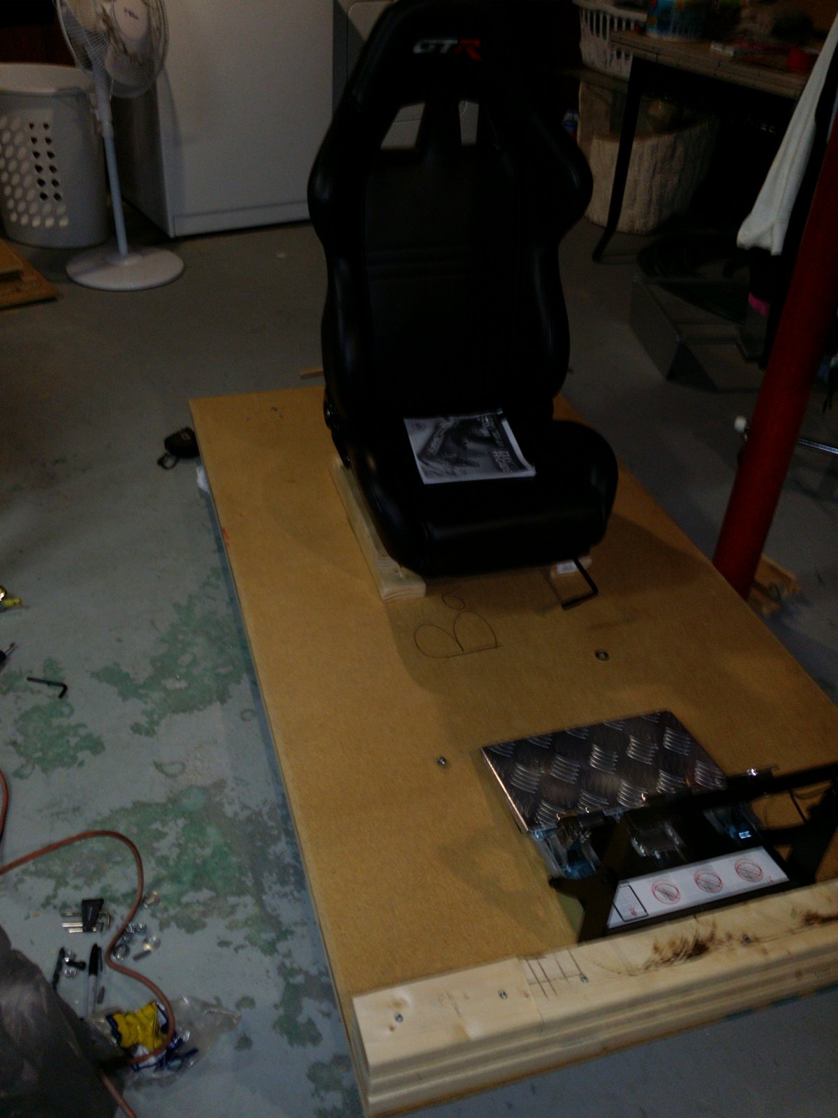

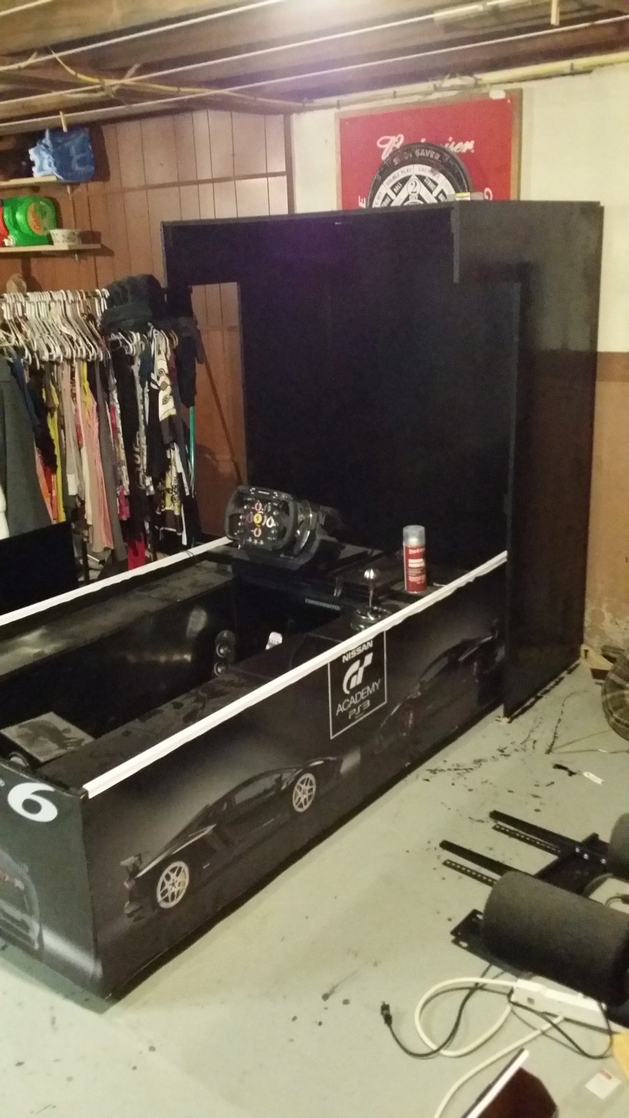

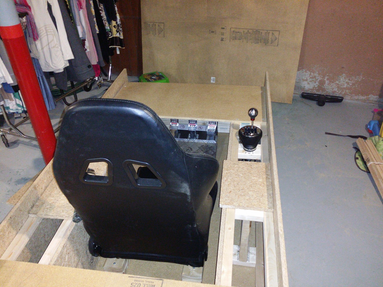

    Nick I know your post was from April but I am now ordering all my parts. My rig has evolved little . I took a pic from the back to show how much room i have on each side of the seat. I beleive I would need to remove the side cabinets. Also my seat is sitting right now on a movable sliding frame bolted to mdf board. I think I will go with the motors you suggested. In my rig, what benefits or choice would i have over 50:1 or 25:1 in my setup. Also i will not have my wheel moving. just the seat.

    Lastly, I would like everyone opinion, Should my set up be motor to back of seat or motor to a platform my seat sits on. Pros and cons?
    21,029
    147,872Coins
    +10,876 / 54 / -2
    I think a shoulder mount seat shaker would be a simple and effective way to add motion to your existing rig @RyanSmerdon. The pros are simple design, good movement and easily incorporated into you existing rig.

    +1 Shoulder mount, You have more than enough room to fit some gear motor's in between your current side's
    Difference between 25:1 or 50:1 is really personal weight, Im a little guy at 150lbs so 25:1 Other buddy's near double me so we went for 50:1's the 50's also hold their position pretty well when not powered.
    For sheer reference material, here's what i ended up with for the rear angles, Angle doesn't need to be as extreme as say the SimX units with the fragile Actuators.

    I'm 210lbs so i will go with the 50:1. I was looking at the 600 psu that you used. Should i go with the 700w?. I agree, I am going to go with your setup
