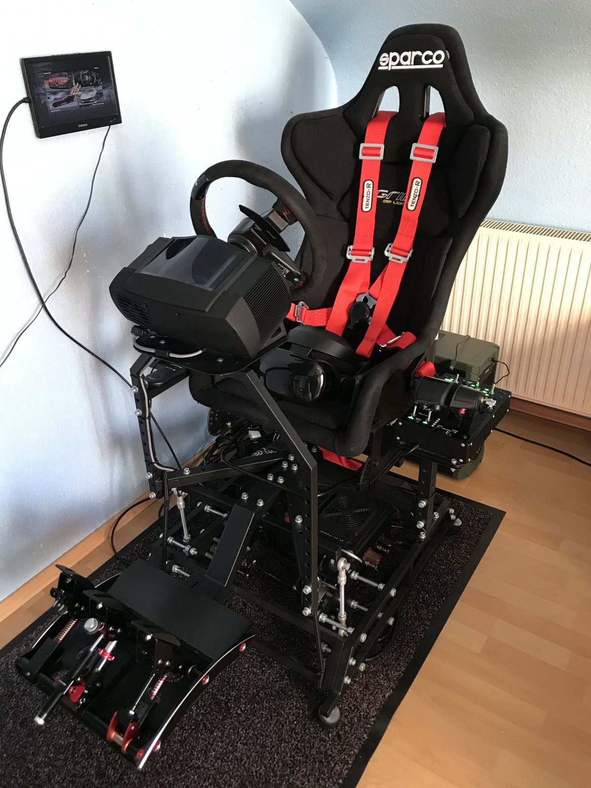

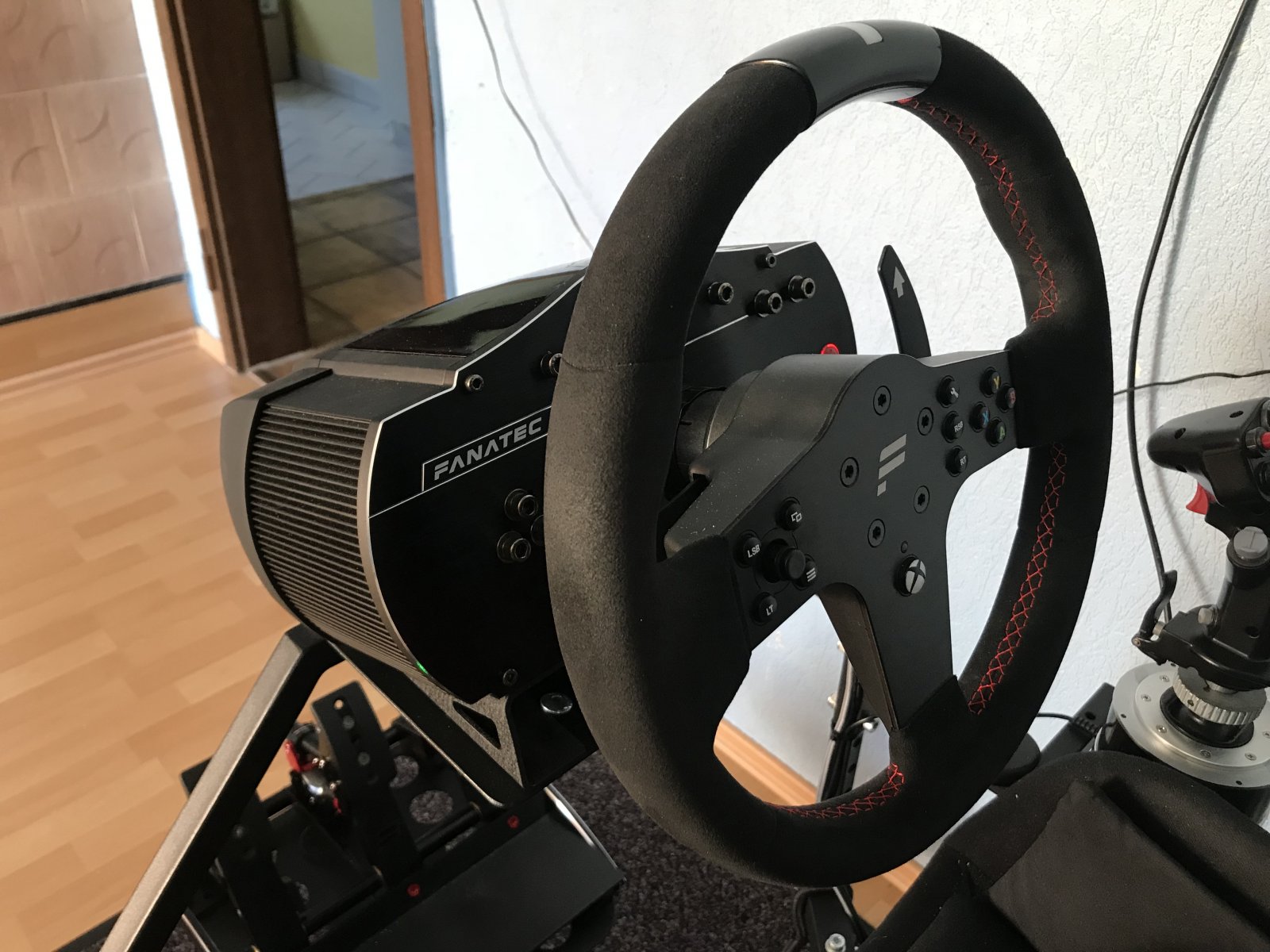

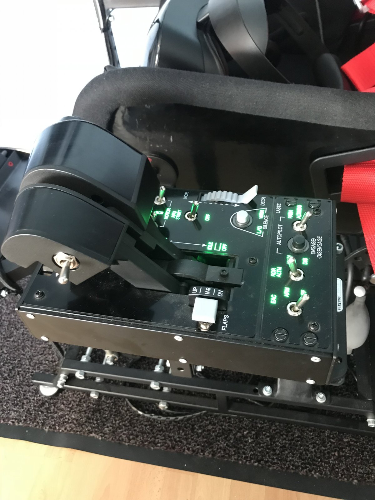

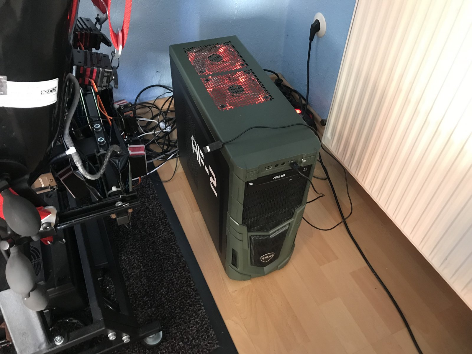

    My H2 from DofReality
    equipped with Fanatec clubsport v2.5 base and P1 steering wheel...

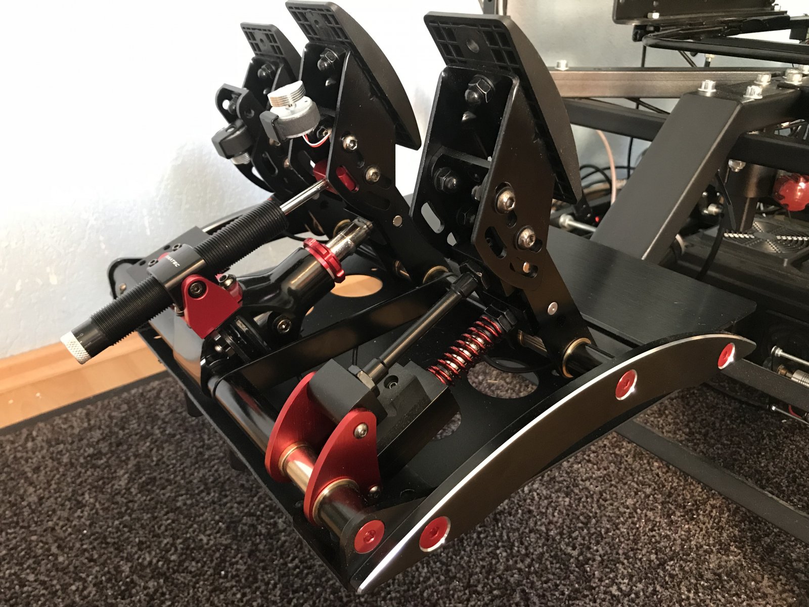

    Fanatec Clubsport Pedale v3 ....

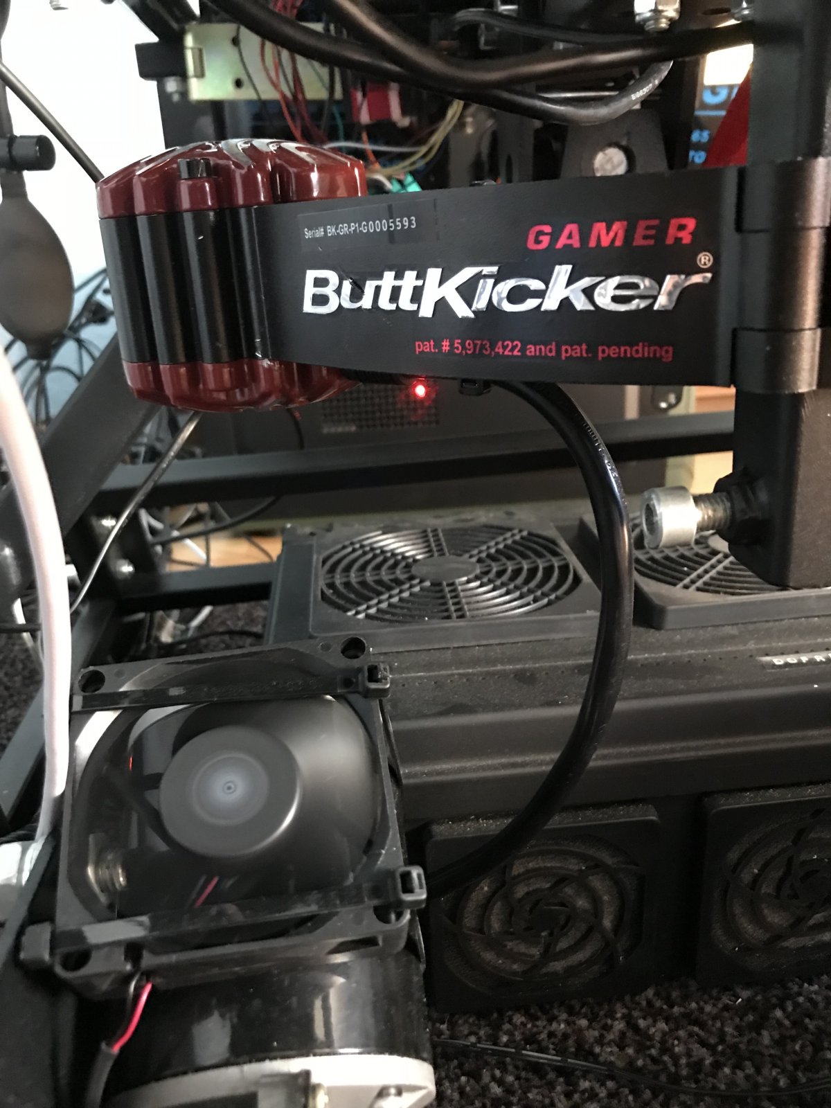

    Buttkicker ...

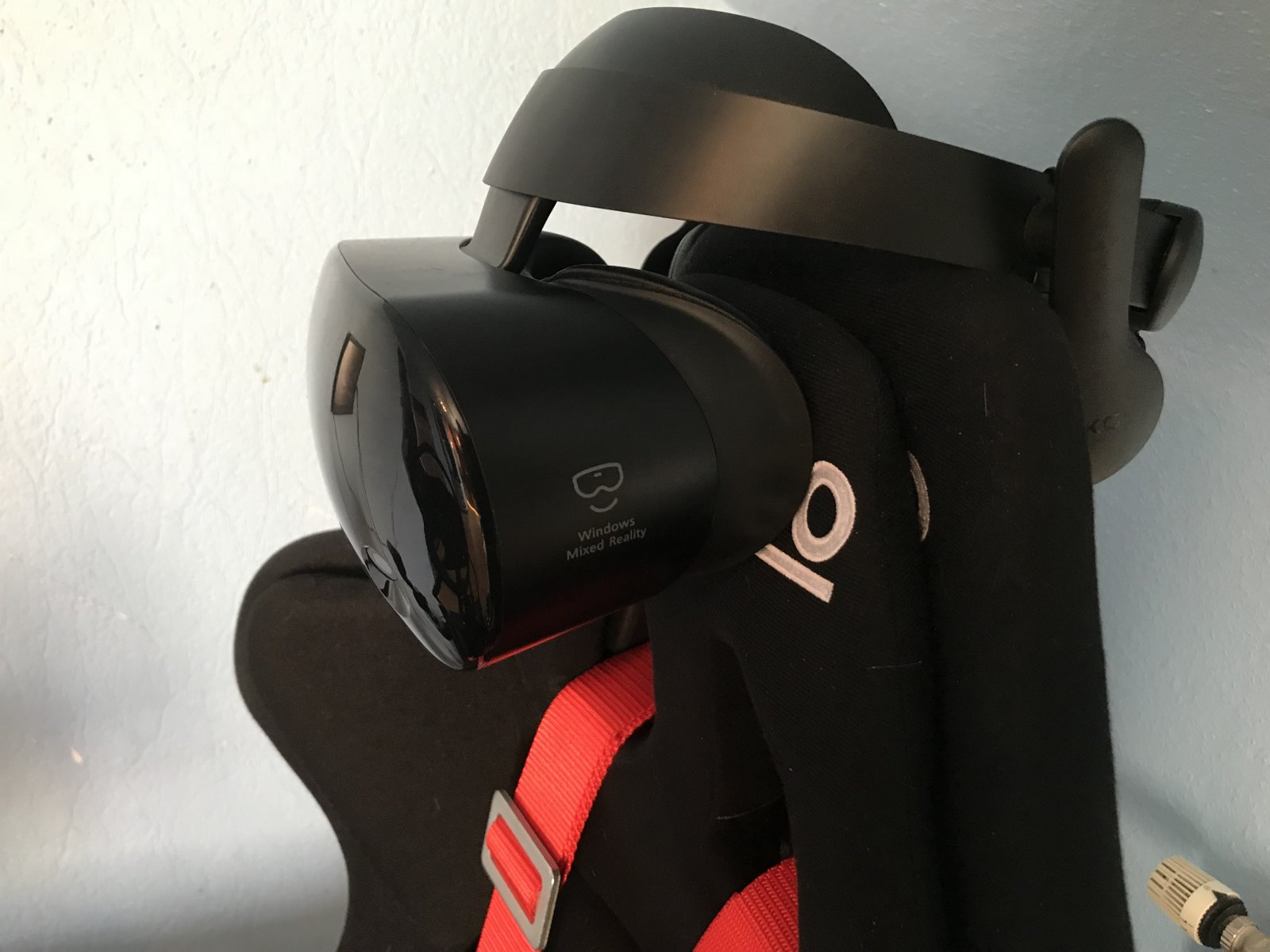

    Samsung Odyssey ...
    Gaming PC I5 GTX1070ti ...

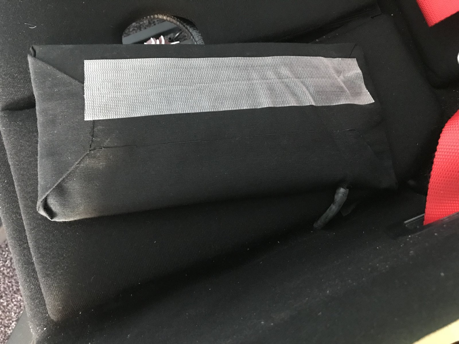

    Harness Tensioner...
    pneumatic G Seat...
    .... Druckkissen .....
    .. Servo Mechanik ..

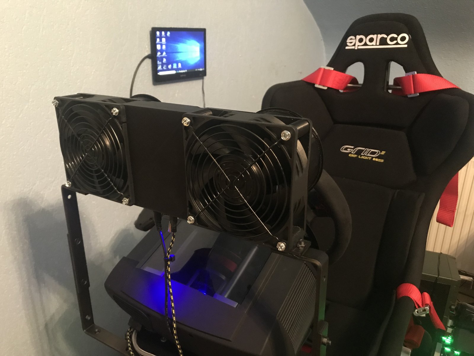

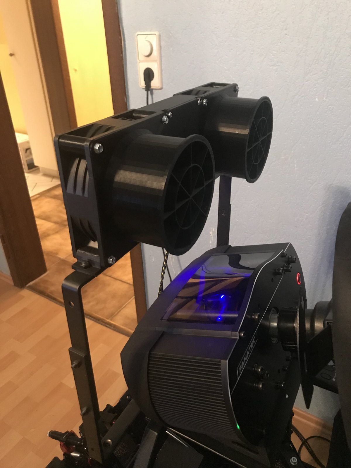

    Extra cooling for the engines...

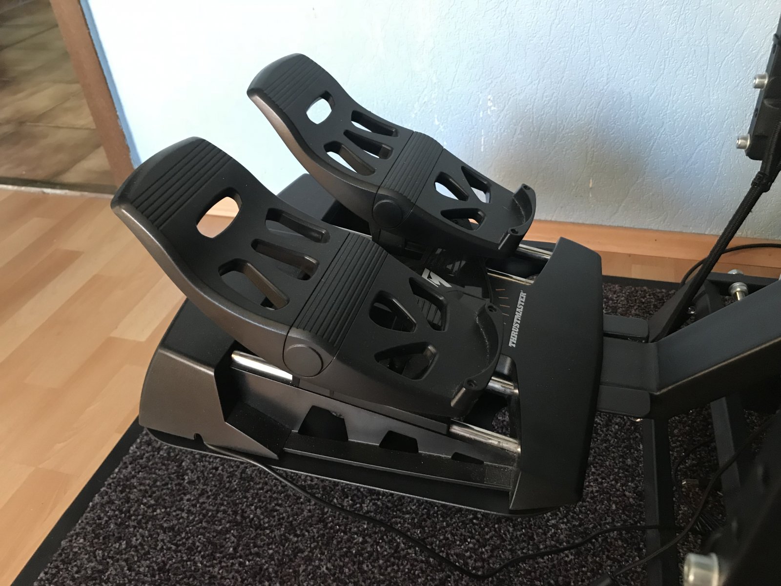

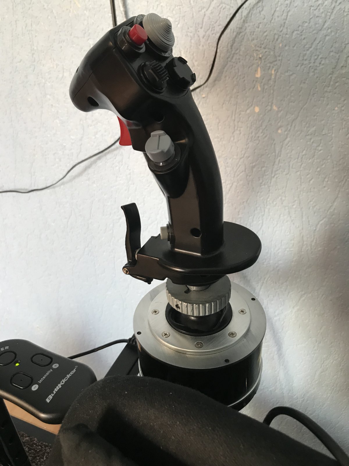

    and fly thrustmaster hotas warthog stick....
    thrustmaster flight control system...
    thrustmaster flight rudder pedals...

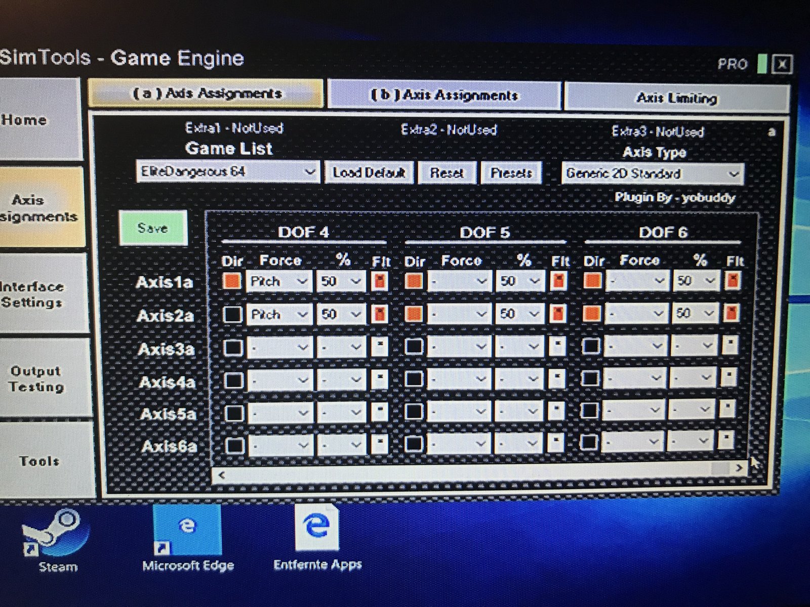

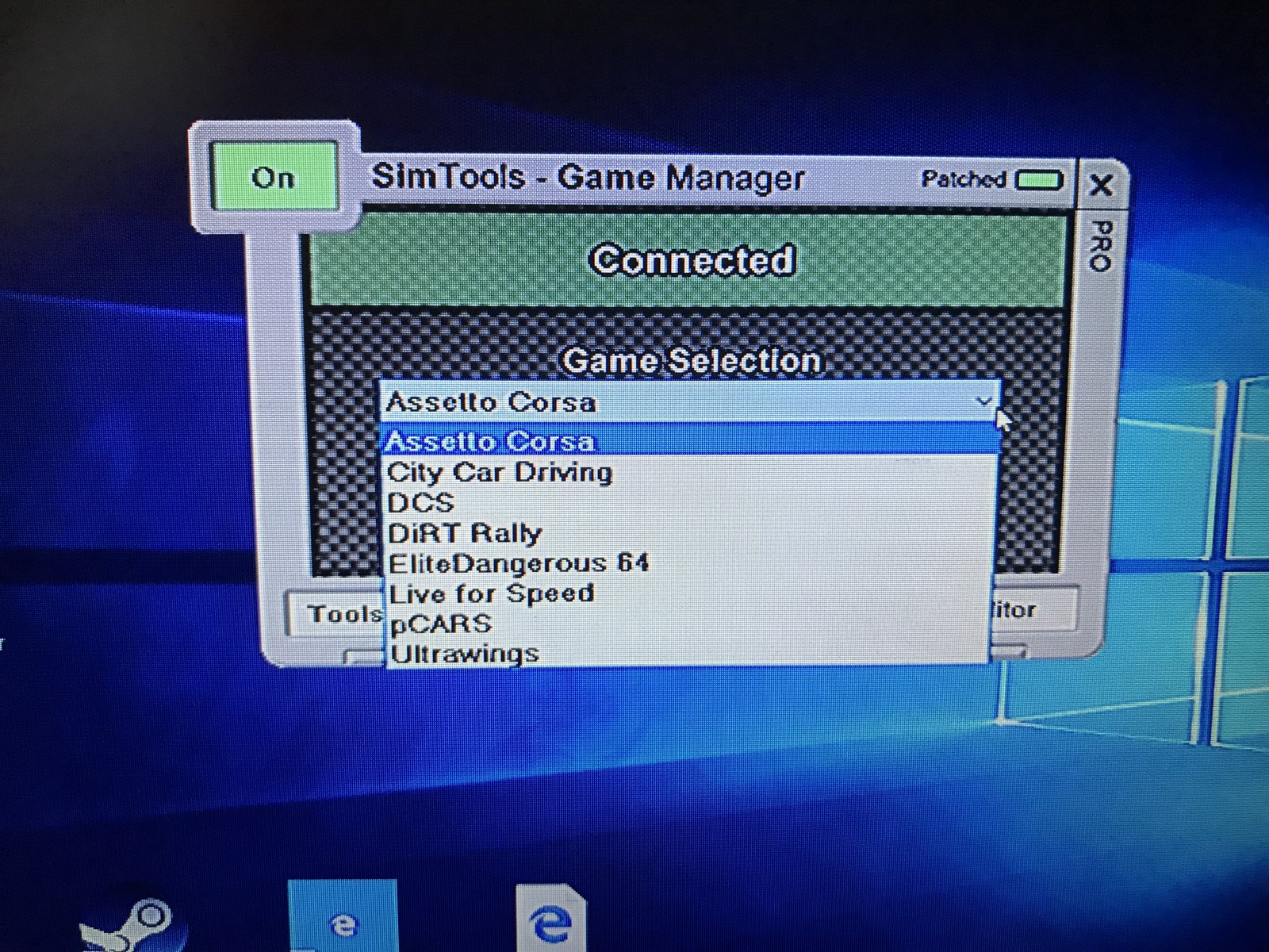

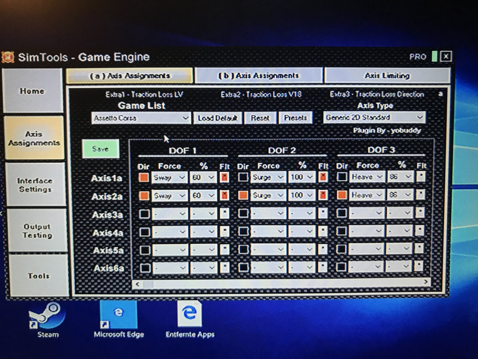

    everything works great with SimTools

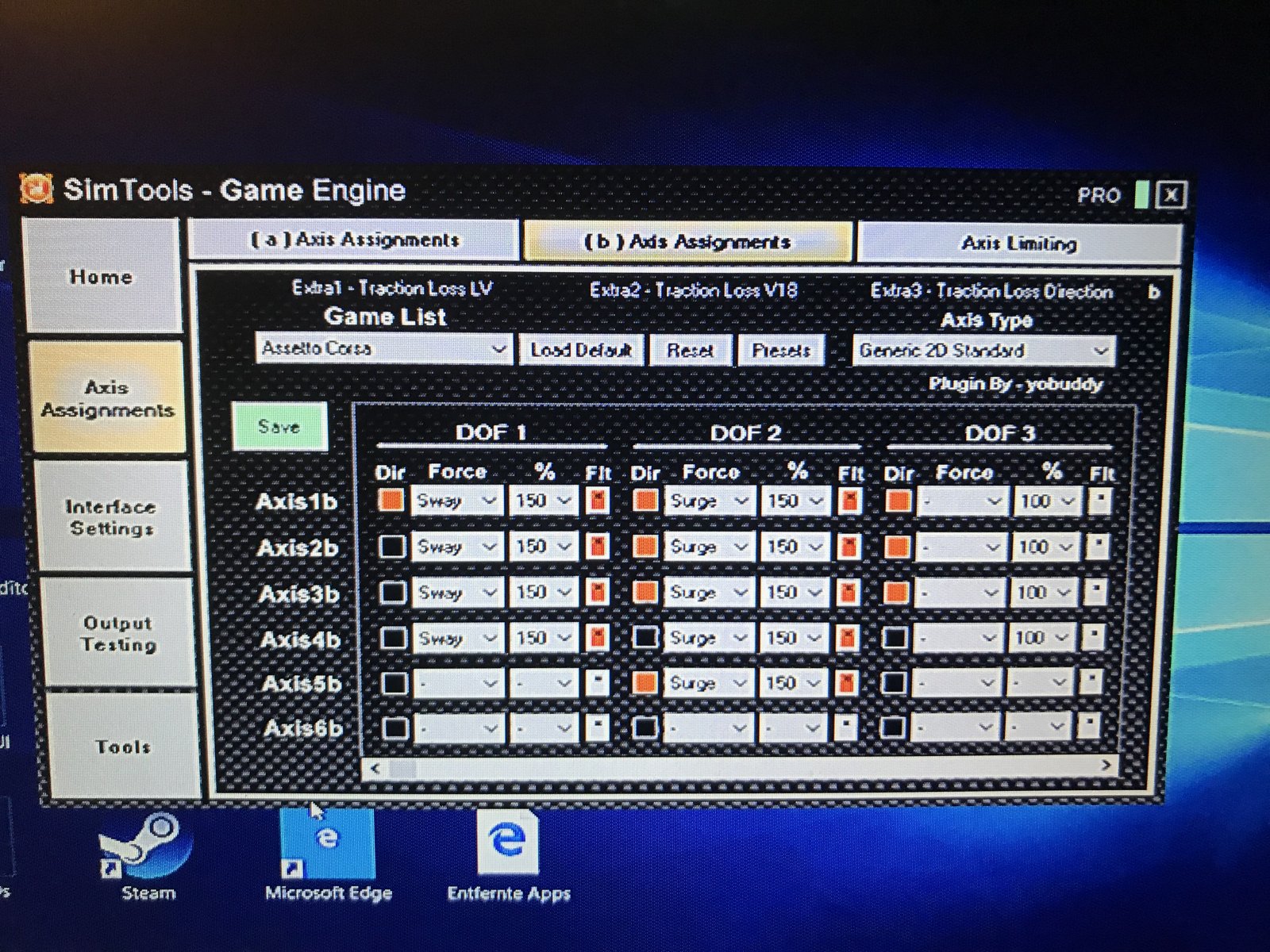

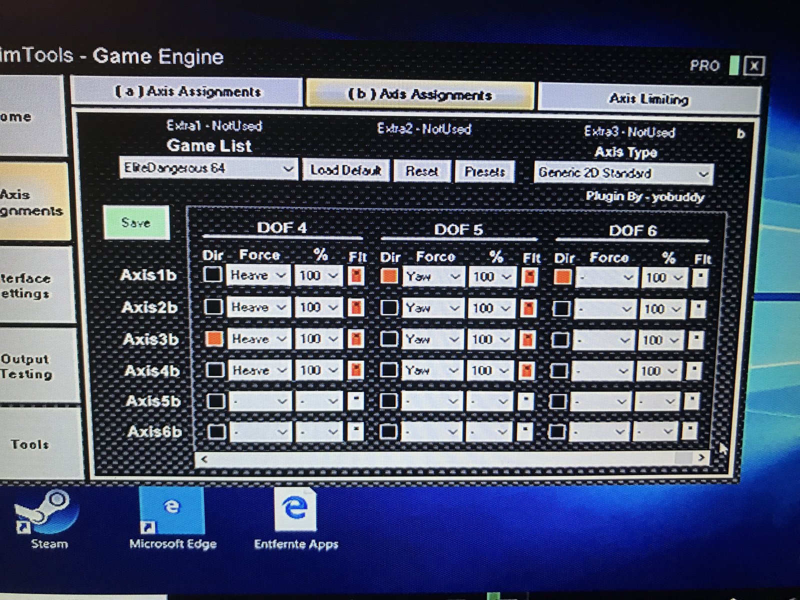

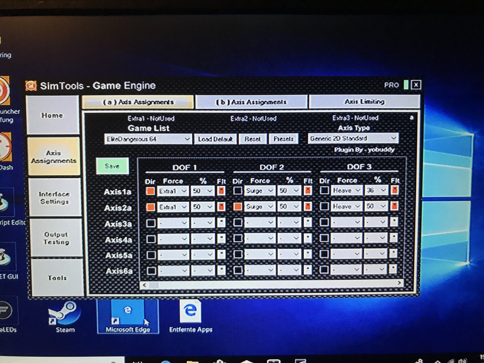

    My settings ...
    AC for H2
    ..G-Seat...

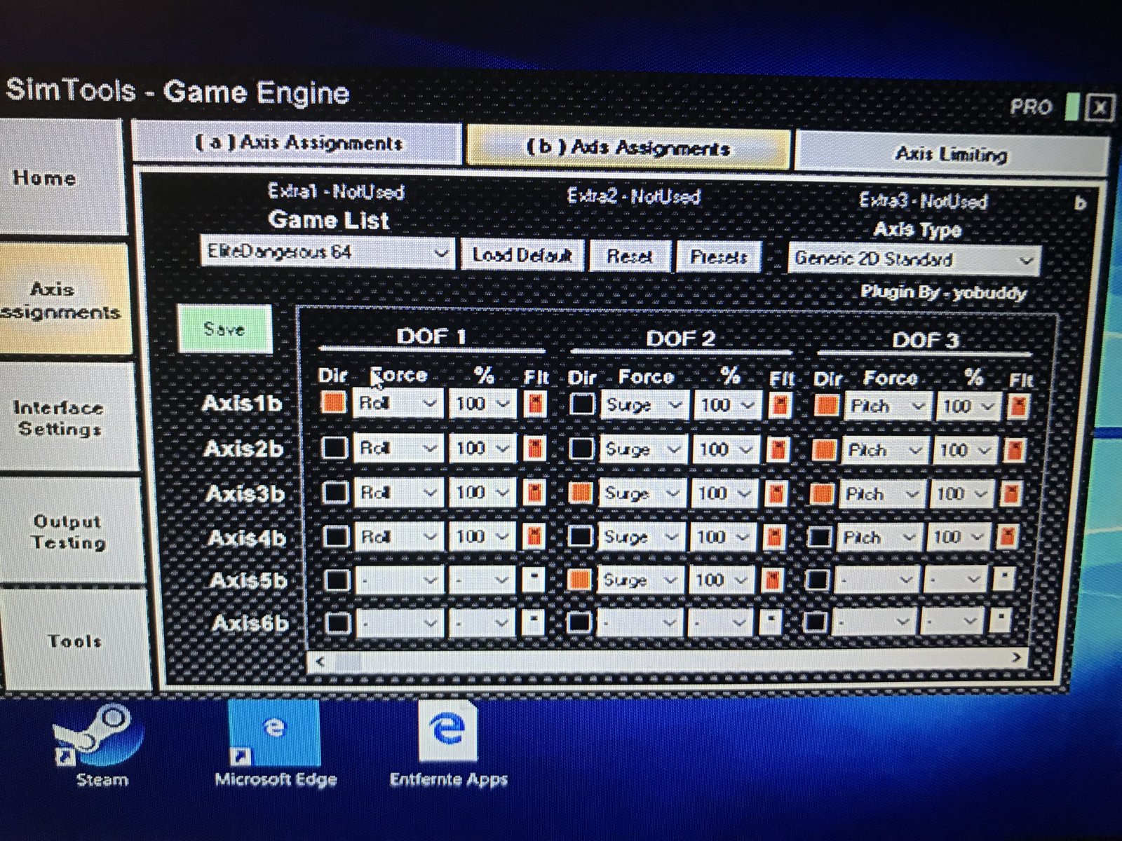

    ... „Axie 5b is the Harness Tensioner“ ....
    Elite for H2
    ..G-Sitz ...
    in the future, a wind simulator will be installed,
    and a fan temperature controller for the H2 controller.

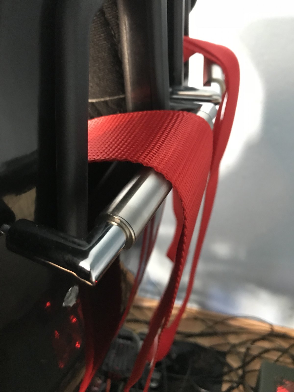

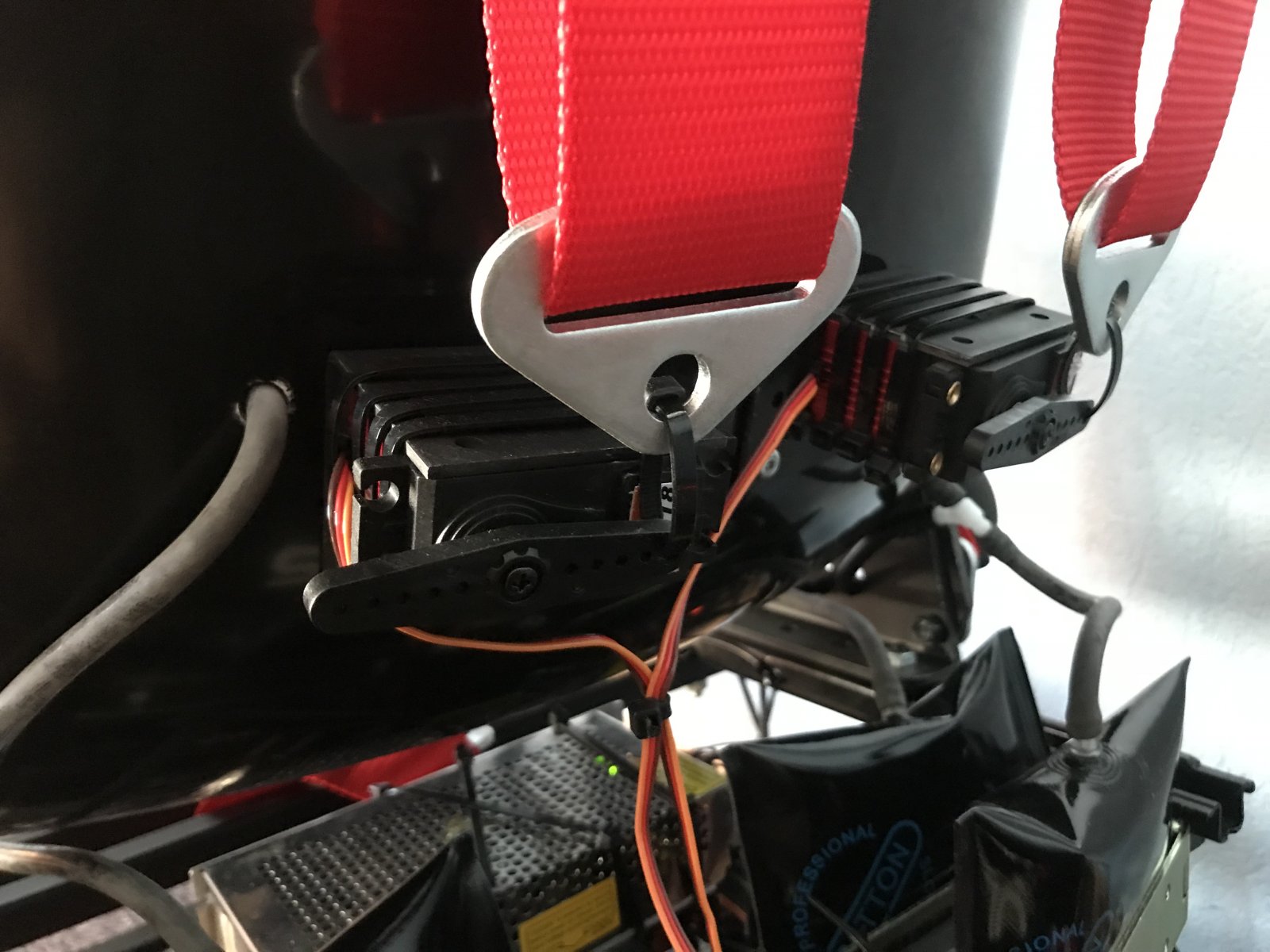

    Is that harness tensioner DIY or something you purchased?
  5. xxpelle
    xxpelle Discord "TPMax#9574" Gold Contributor
    Dec 24, 2017
    120
    612Coins
    +150 / 0 / -0

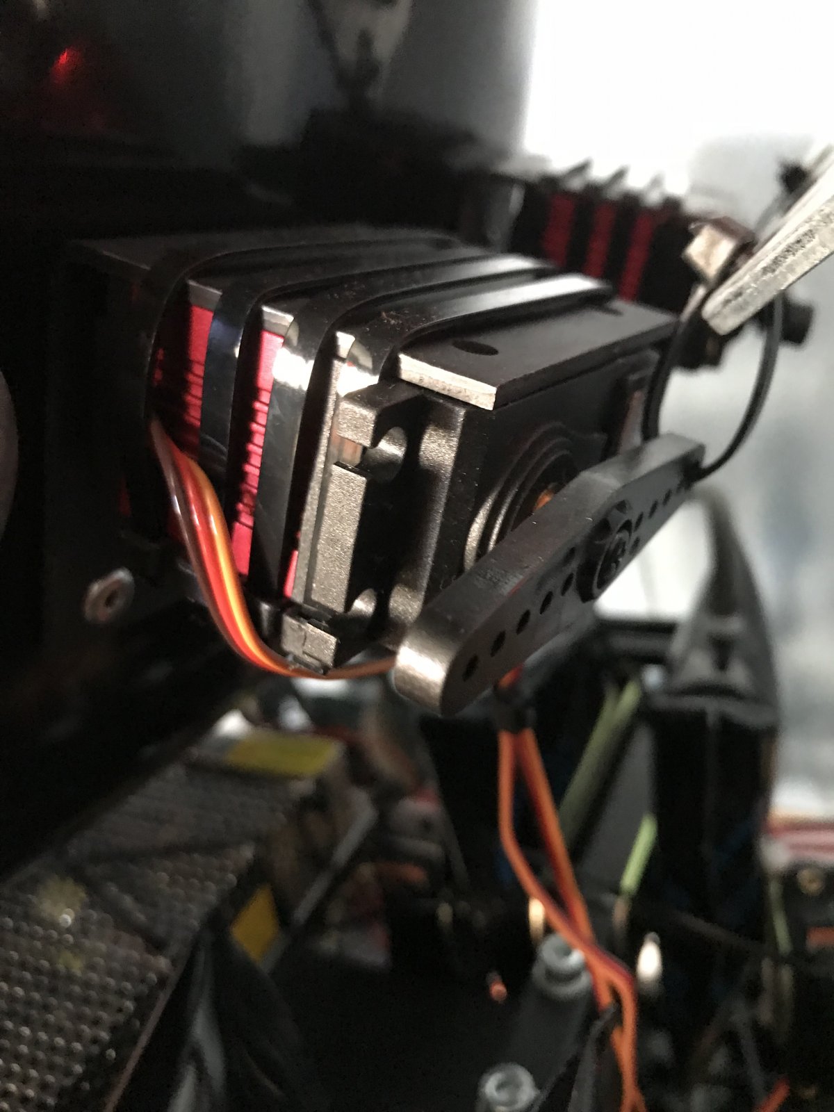

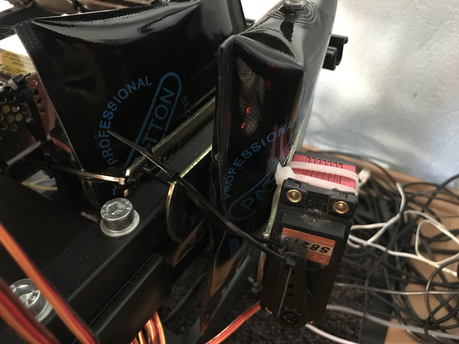

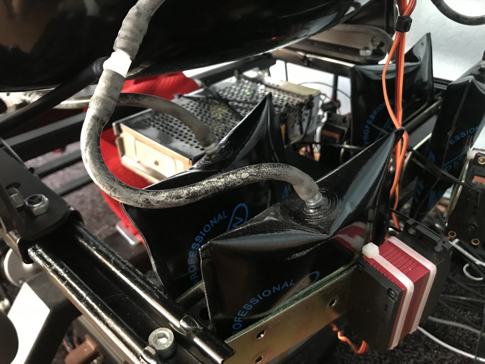

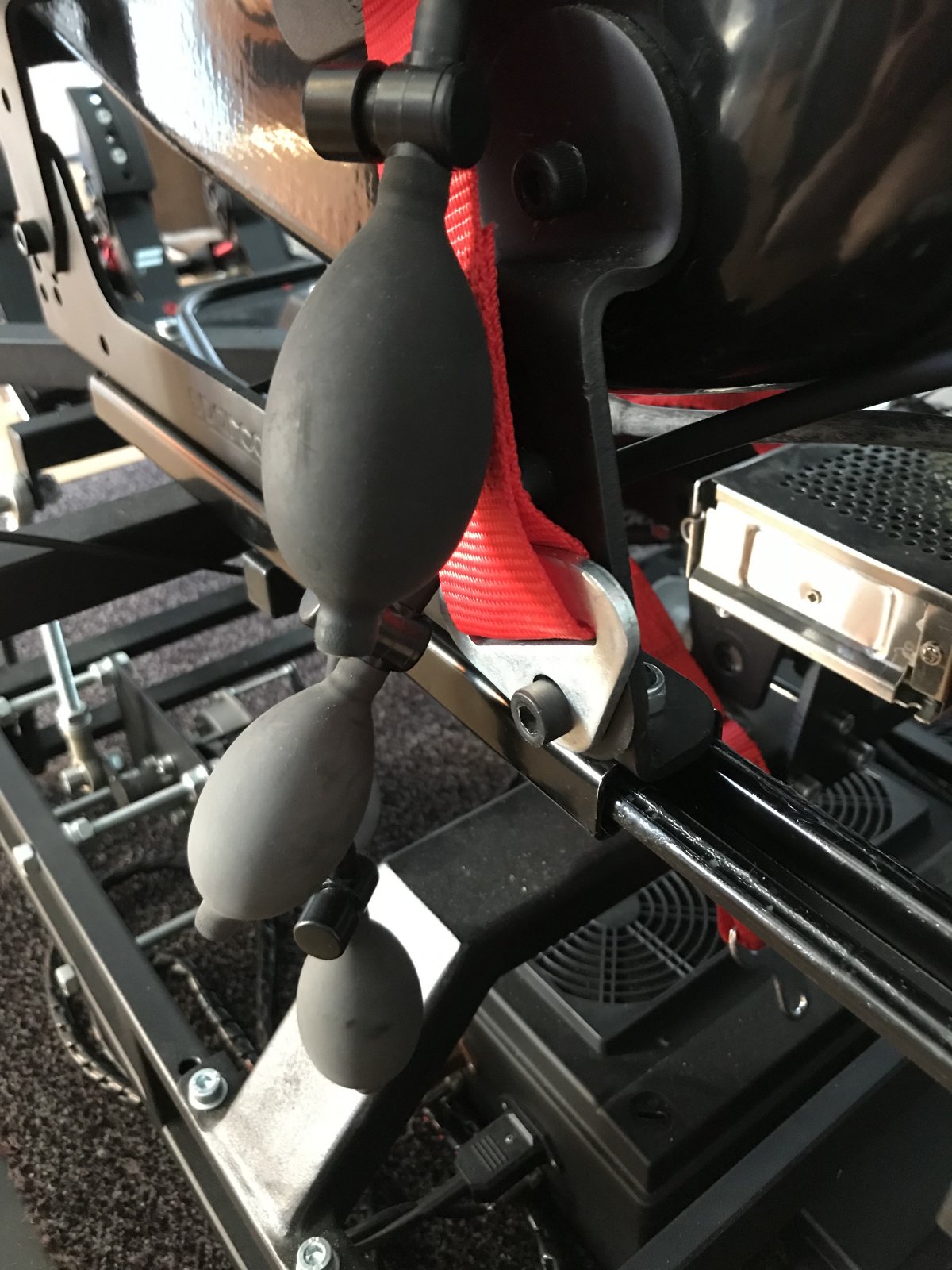

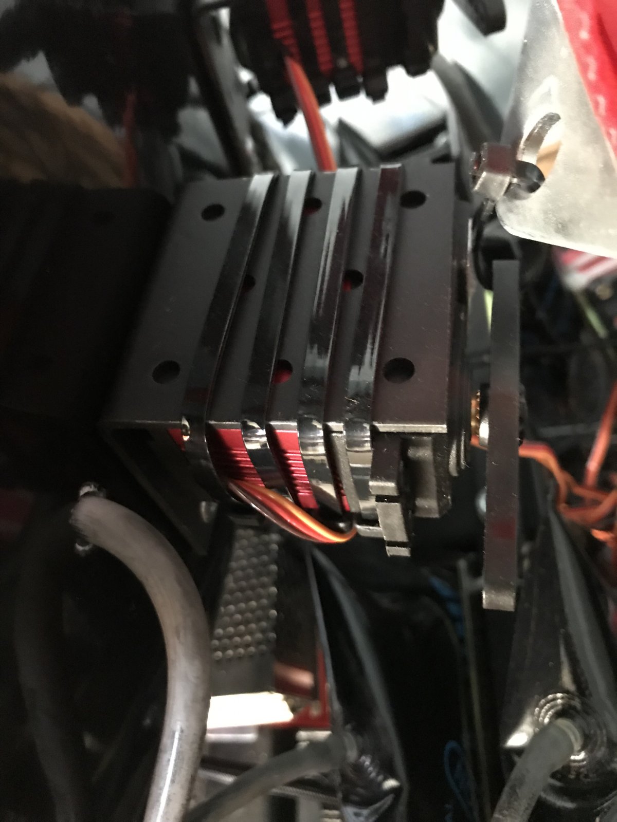

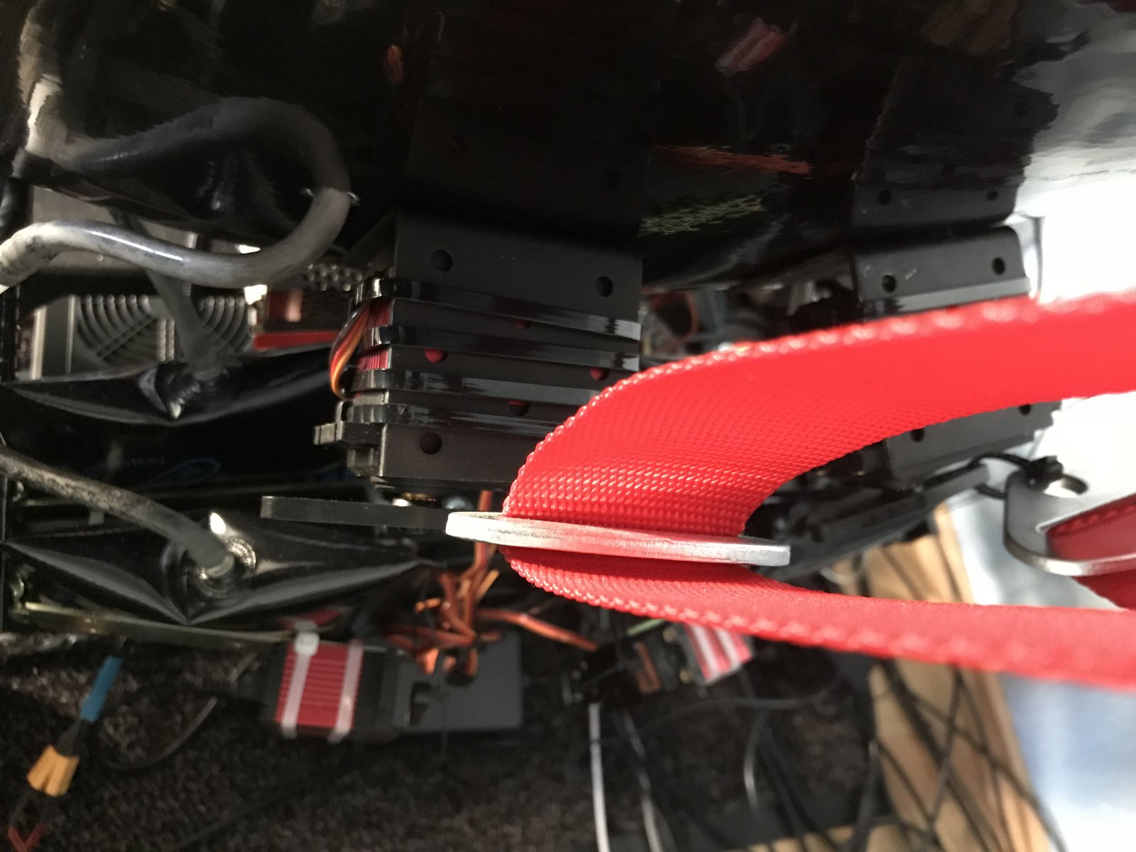

    I built the harness tensioner myself
    1 x Arduino Uno for G-Seat and harness tensioner
    1 x 6 volt transformer
    2 x Servo "40kg"
    2 x metal angles with rivets attached to the seat
    and some cable tie
    Drawer handles as a diversion

    Thank you! I just found my next project to add to my T1000 2 dof.
    I might bounce some questions off you if you don't mind.

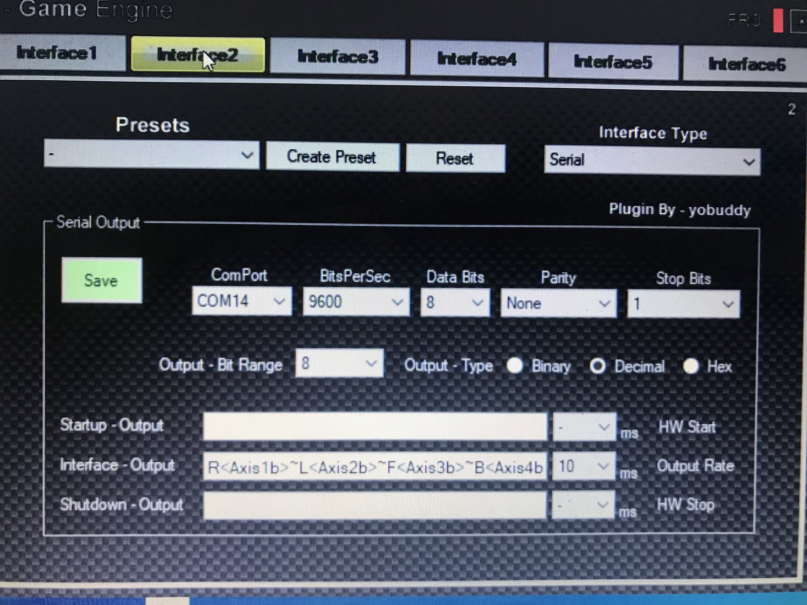

  8. xxpelle
    Dec 24, 2017
    120
    612Coins
    +150 / 0 / -0
    Here are my Arduino code for the G-Seat for up to 6 servos
    Interface Type : Serial
    Comport : is at every individual
    BitsPerSec : 9600
    Data Bits : 8
    Parity : None
    Stop Bits : 1
    Bit Range : 8
    Output Type : Decimal
    Interface Output : R<Axis1b>~L<Axis2b>~F<Axis3b>~B<Axis4b>~G<Axis5b>~H<Axis6b>~
    Output Rate : 1oms
    this setup works well for me

    Looks great, would you mind sharing the simtools and arduino procedure for the harnas tensioner?
    Als do you have links to the parts?
    Thanks a lot !
  10. xxpelle
    Dec 24, 2017
    120
    612Coins
    +150 / 0 / -0
    GSeat-Arduino-Code-6DOF.rar
    is integrated with the harnas tensioner
    On simtools axis 5b, the harnas tensioner is addressed

    I already have a paddle-based g-seat, but I recently discovered that I need some more pressure points, and the pneumatic bladders seem to be much easier to mount than additional paddles. Great idea!
    (Besides I have lots of servos lying around after I switched to bowden cable driven paddles.)
