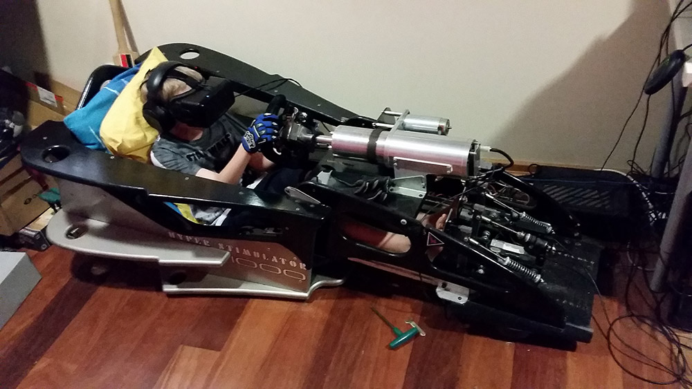

    Hi everyone,
    I have a Hyper cockpit that I use, primarily, for iRacing.
    (that's my 10 yr old son driving, I don't normally need pillows to reach the pedals :)
    It has 4 transducers running Simvibe (two under my heels and two behind my back on the seat), ECCI wheel, and CST (at least the Australian version, 5 Star) pedals. It also now has two Seaflo fans producing wind.
    I'm keen to add anything that might add to the immersion of the Rift, but without too dramatically modifying the Hyper. I decided to do a cosmeetic upgrade of the Hyper (it's almost 20 years old, I'm thinking a livery change will be nice) and would like to include a couple of other projects as part of that.
    I've always wanted to find out if moving the wheel can provide a similar effect to the seat mover feel of acceleration, so that's my first step, and then would like to add tensioning to 4 points of a 5 point harness to see how much of a sense of movement that can provide (since seat movement isn't possible with the Hyper).
    I've seriously considered adding a G-Seat system instead of the belt tensioners (especially after seeing SeatTime's thread), but I'm leaning toward doing the belts for now, and trying the G-Seat if I'm not happy with the effect the belts give (not sure at this stage, if I want to modify the Hyper seat as much as the G-Seat will need, but if enough people try to convince me that the G-Seat is the way to go over tensioners I could be swayed :).

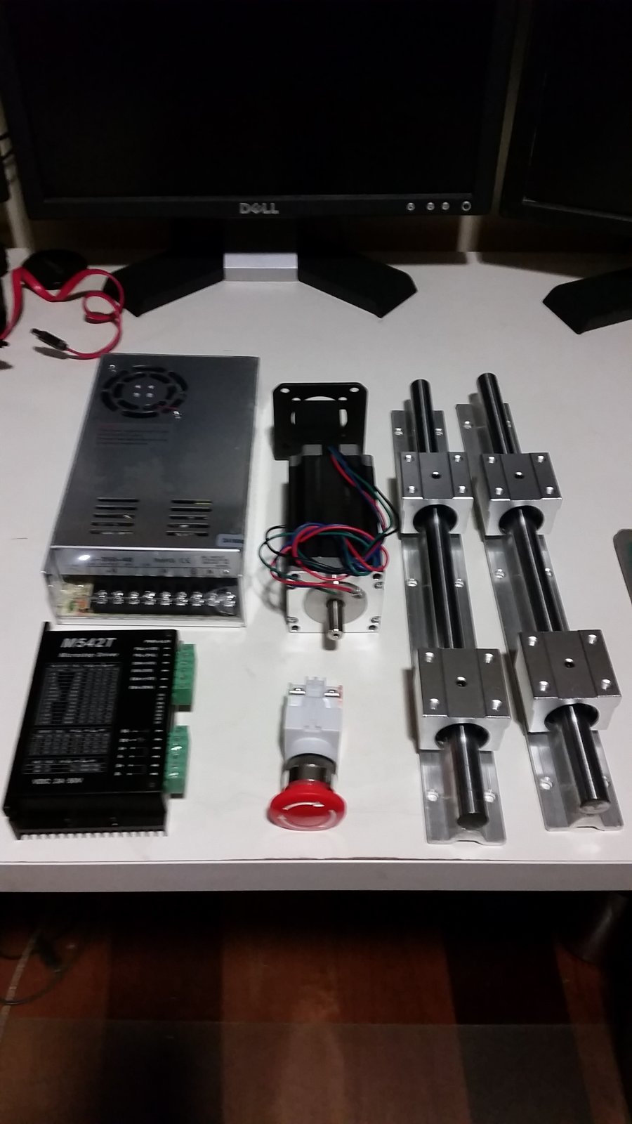

    Anyway, first step is the wheel mover, I've just ordered a pile of parts:
    (and Arduino Mega and box of assorted springs completed my shopping list) so now I'm working on how I'm going to mount the wheel to the rails. It'll be a while till I can make much progress, the cosmetic update of the Hyper comes first, but I'm keen to start playing with the software side of things to find out what issues I might have getting this working as I'm prepping and painting mdf.
    I plan to connect the stepper arm to the wheel platform with springs on either side (each under half tension) so that as the motor turns it doesn't pull the wheel out of my hands, rather it applies tension on my grip on the wheel by extending one of the springs further, this should also mean that it always centers when there's no power applied to the motor, so it should always start at the center point at the start of each session (so I don't think I'll need an encoder?).
    To be honest I'm not sure whether I've gone overboard on power, should I have just gone with a cheap RC servo, I'm not sure, the wheel is very heavy, and I obviously want it to move quick (although accuracy isn't all that critical at all), so I figured a strong stepper would be worth it from that point of view (comments from those who know better than me welcome)?
    One last question, I'm struggling to find a linkage arm (around 80 to 100mm long I think) to connect to the stepper spindle and springs, does anyone know where I can get hold of one?
    Any comments or criticism of my plans welcome :)
    Peter.
  2. SilentChill
    2,643
    20,561Coins
    +3,488 / 34 / -0
    Whats that wheel base ? its very long
  3. pab61
    pab61 Member
    Jan 13, 2017
    47
    Adelaide
    638Coins
    +40 / 0 / -0
    ECCI 7000 FFB wheel, it was state of the art in the days before dd servo wheels. It's tempting to go OSW, but hard to justify when I have a good quality wheel that's built like a tank and will last practically forever.
    It is currently a little longer than it needs to be, I put a 100mm extension on it to allow the wheel to fit under monitors before I got the Rift, now that's not necessaary I'll probably remove that to make it a little more compact again.

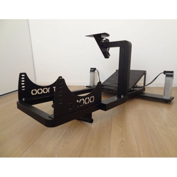

  7. Archie
    Archie Eternal tinkerer
    Dec 31, 2014
    1,081
    Wollongong, NSW, AU
    3,796Coins
    +1,379 / 4 / -0
    If you wanted to add movement to the hyper, you could bolt on a shallow semi-circle arc and have two motors rock it from side to side from the front, and when combined also have basic pitch / heave / surge?
    I've seen that design somewhere, but can't find a suitable picture....
  8. Archie
    Dec 31, 2014
    1,081
    Wollongong, NSW, AU
    3,796Coins
    +1,379 / 4 / -0
    And as soon as I post... I find one...
    You can see the "arch" under the seat.
  9. pab61

    Hmm, interesting, thanks Archie. I'll consider that, sort of like a babies cradle for rocking to sleep.
    I'm hoping that moving the wheel and belts will give me a good sense of acceleration/braking, but something like this might be good for adding a sense of turning forces.
    You know the only thing that bothers me a little about something like this though, I've got a rift and headphones on, imagine a pet, or child (mine should be old enough to not be that stupid now, but you never know) getting caught under it, and you go on driving blissfully unaware of it.

    So, just so that I know at this stage, does the SimTools software talk directly to the JRK through the plugin, or is there another layer of software required in there?
  16. noorbeast
    21,155
    148,616Coins
    +10,909 / 54 / -2
    JRKs have a handy configurations utility that you install and use like this: https://www.xsimulator.net/community/threads/playseat-to-2-dofseat.5401/page-2#post-56352
    Personally I prefer Hall sensors to pots, as they won't break if over rotated, can be direct mounted to the gearbox using simple flexible couplings, give accurate readings and have a good life span, so something like these: http://au.element14.com/bi-technolo...fs/sensor-hall-0-2v-20v-to-10v-pin/dp/2319662
    Get the correct size flexible coupling: : http://www.ebay.com/sch/i.html?_sacat=0&_from=R40&_nkw=flexible coupler&rt=nc&LH_BIN=1
    Again personal preference but I prefer a PSU per motor, as our rigs generate some pretty demanding power spikes.
    You will want 80mm or 120mm fan to cool the JRKs and 2 X proper size heat sinks for the main chips on the JRKs, plus some double sided thermal tape to stick them on: http://www.ebay.com/bhp/thermal-adhesive-tape?rmvSB=true
    Set of 4 tie rod ends to connect motor levers to seat frame, something like these: http://www.aliexpress.com/item/4pcs...ight-hand-tie-rod-end-bearing/1559309095.html
