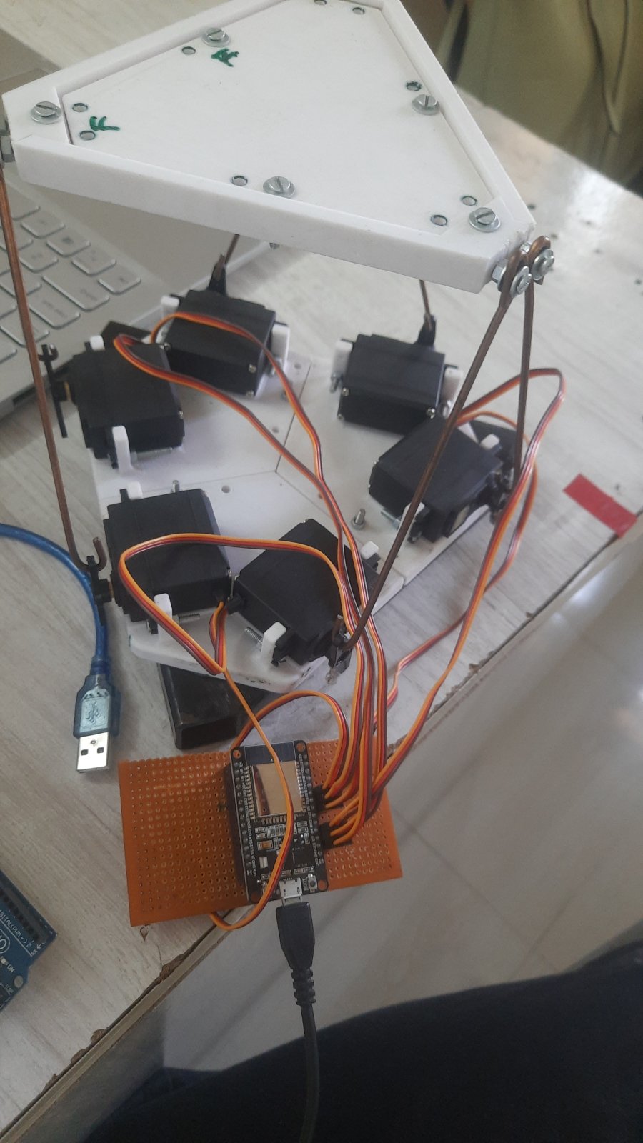

    Hi, I'm building a mini model of a 6dof rig using servo motors to sync with LFS. I've assembled the platform and connected to Arduinos, yet a few questions :
    1. Do I need motor controller and what type ?
    2. Can't figure out the simtools configuration for axis, interface and such ( I have the free/demo version ).

    I'm trying to replicate hooshang's rig, I have the platform set but I'm confused how to move forward.
    Currently I have just the Arduinos and servo motors, unsure if I need motor controllers or SMC3 to make it work just like that.
    Would appreciate if I get specific instructions as codes/software isn't exactly my forte

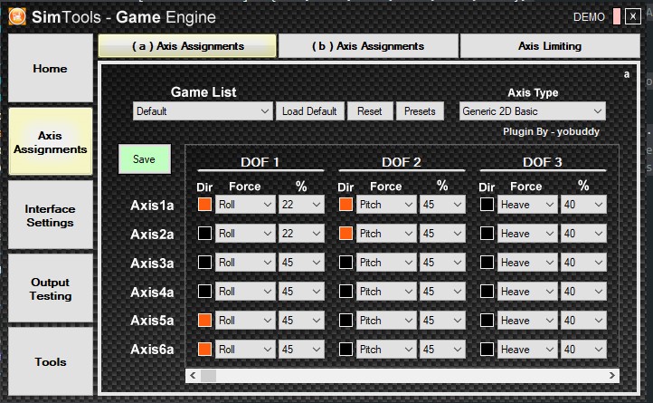

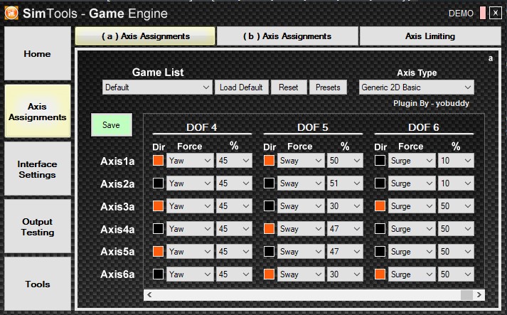

    Welp, I guess I didn't configure the Interface properly. A little help with this axis assignment ?
    Also, t Screenshot 2024-03-21 163431.jpg Screenshot 2024-03-21 163451.jpg his is the code I've been using

    I guess I'm still doing something wrong with the interface, looking at my axis assignment what should I put in the interface output box ? I'm using Serial type interface 9600 bits

    So far I'm here. Fried some pins on one of my Arduinos testing the servos. Any specific power supplies/ battery recommendations for MG995/ MG996R servos ? Would appreciate if it is possible for a single Arduino to do it via simtools.

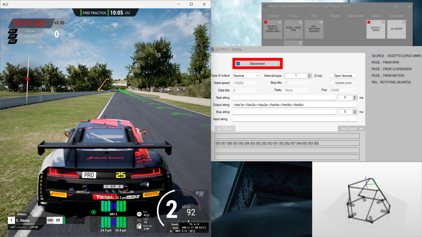

    Update : I'm trying FlyPT for Assetto Corsa, using this code to upload to an ESP32 for testing purpose 20240413_130201.jpg 20240413_130201.jpg Screenshot (6).png .
    Uploaded this, tried the interfacing with the Output window but no movement in platform

    Did you set the rig for 10 bits (0 to 1024) in the rig module of Mover?
    In your code you are using 9600 baud rate, in Mover you have 115200, it should be the same.
    Also, serial is a stream, you have no way to know when you are receiving the data for the first axis.
    You need to use a delimiter for that in your string.
    For example 3 bytes with 255, that's something that never happens for 10 bits
