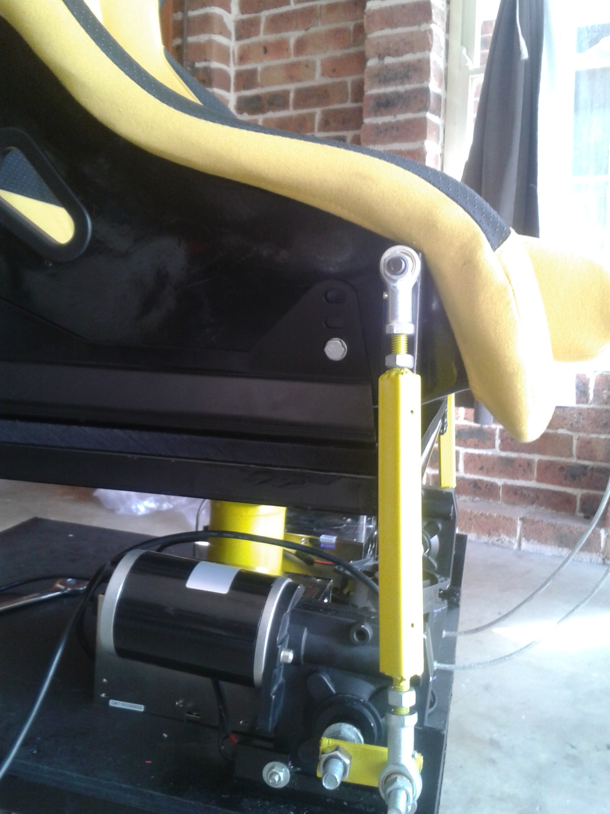

    The overall good choice is a 12v 200 watt 25:1 gearbox worm drive motor. Not 100% where you could find them in Portugal , heres a general USA link http://www.ebay.com/itm/GEAR-MOTOR-...992384?hash=item51bd392f00:g:nOwAAOSwPhdVCxQg

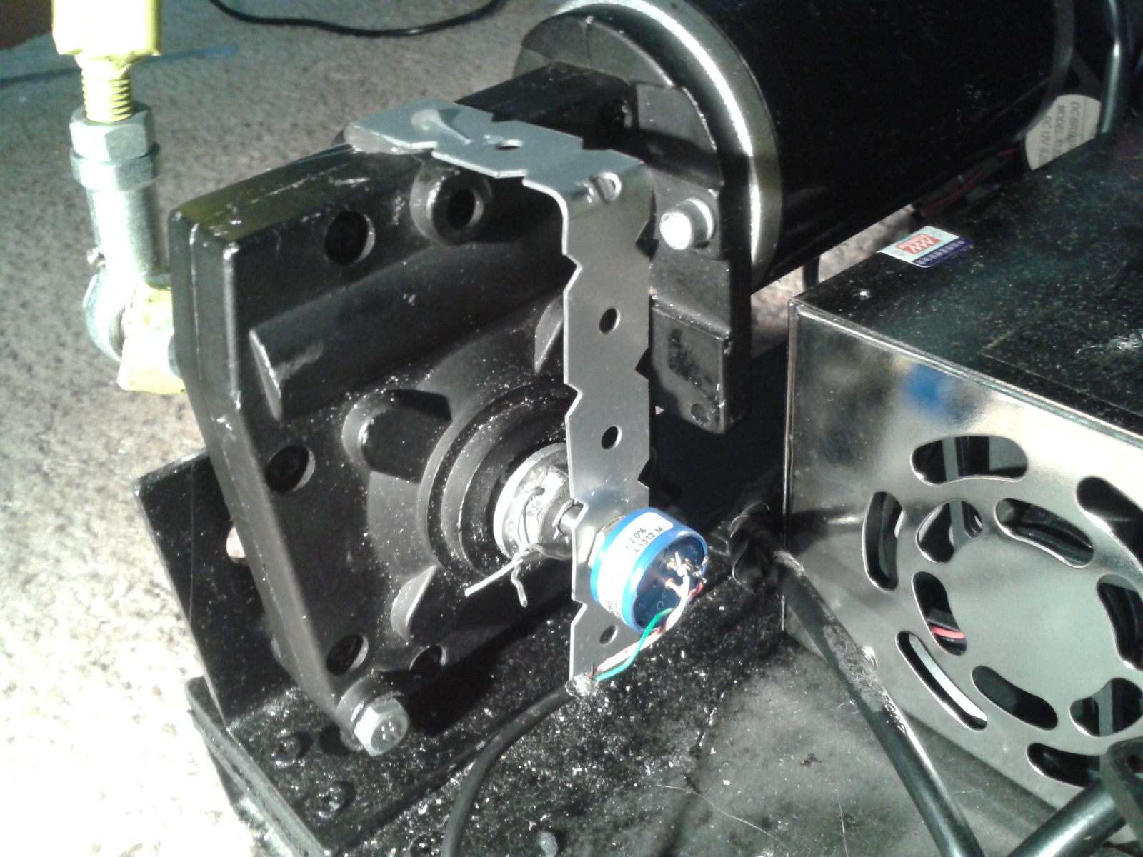

    However, you need to make up a few things for it, you would need a bolt through the shaft, a suitable length lever on the end of 50mm CTC long. You would need to hunt up rod ends, various brackets to mount the motors , mount a pot on the back for feedback, something like this using a hole in the back of the motor shaft and tap a grub screw into it to hold the shaft
    2014-03-28 10.35.20.jpg length of wire shown . you can see the lever this side 2014-03-21 14.27.48.jpg
    For motor control, if you want to save some money, but have the possible hassle of code re-writing and adjustment, then Arduino and Monster Moto drivers. As I do not use them, maybe @Pit can advise there.
