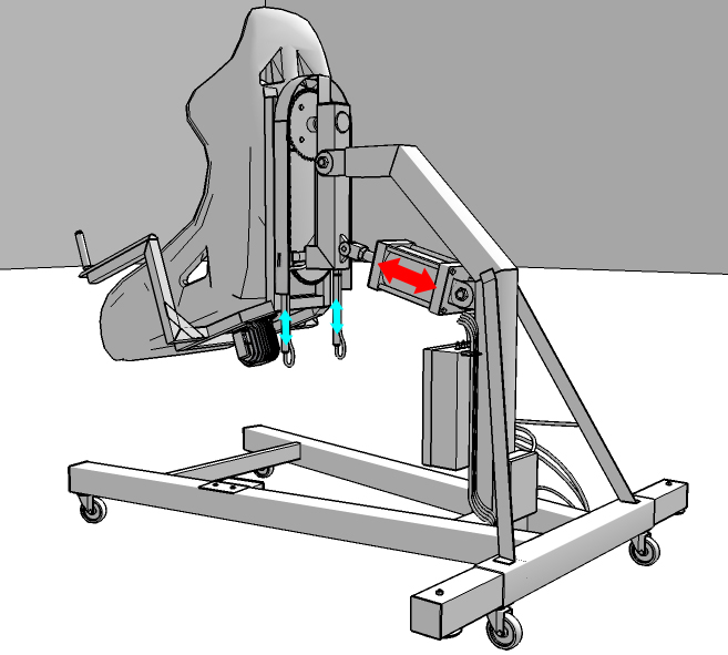

    Here's a decent model I made to show the basic operation though:
    And here is one in action, at the first public demo.
    They are 2DOF, with one large pneumatic actuator controlling the pitch, and two smaller actuators (connected to a bike chain and sprocket) controlling the roll, at about 90psi. There is one pot for the pitch and one for the yaw. There is also a quick-release valve, that may be triggered via one of four extra effects controls, which will immediately release most of the pressure to give the rider a good drop/heave effect to add some excitement.
    As you may already understand, the valve board controls the air in and out of each actuator, making them move up or down to a certain distance, depending on the position of the rotary pots. From what I've gathered here, this "all or nothing" movement is not desired for accurate racing simulation, but is proving to be a very exciting and, still, somewhat accurate format for roller coasters and similarly styled rides. The inventor, Walt Noon, writes a bit about the way he's fudged the program to be more responsive here.
    So, currently the software is a lightweight program written in Visual Basic. It allows for programming of new rides via joystick input, which is then replayed in conjunction with a video file, I'm assuming much like the upcoming Video Ride Creator/Player for 2.0.
    So I'd love to license a couple of copies of SimTools 2.0, to help me replay VR media, rather than the current 3D mpegs, but the control boards are not communicating with the legacy version of SimTools I have installed. Upon further investigation, it appears that the boards use MIDI communication! I've emailed the creator, John Wale, again and am waiting for another reply, but did notice in his last email that rather than completely replacing his boards, he said it would be possible to "write an interpreter function which would, say, take data from SimTools as UDP packets from localhost and convert them to VF-2000 commands." (VF-2000 was a working title for the sims.)
    So I'm not sure if it would even require more hardware! As of my last email, John was too busy to tackle this anytime soon, but if it's something I can find a tutorial for, I'm willing to learn. However, if this is going to be WAY over the head of a n00b like myself, I might be interested in contracting someone to tackle this for me, since I'm hoping to make this conversion by the end of May at the latest. Maybe I/someone could even write a SimTools plugin for this??
    I understand that I'm a little fish in a big pond, and that I'll need to be patient if I want free advice, but if - if - this business takes off for me, I'll be purchasing SimTools licenses for every new sim that I build for myself, and could even work in a requirement for any new sales to do the same, in order to run my VR media.
    Thanks again guys! :thumbs

    The problem is only John Wale knows how to control your sim atm.
    Taking data from SimTools UDP packets and convert them to VF-2000 commands would be easiest for John Wale in this case I think.

    Ok, so it looks like the interface is 10bit.
    So now all we need to know is what we send thru the serial port it set the current position.
    In other word, what does the 'fire and forget' position command look like?
    I would ask him "what would I send thru the com port to center the rig?".
    The answer could show us how to command the rig I believe.
