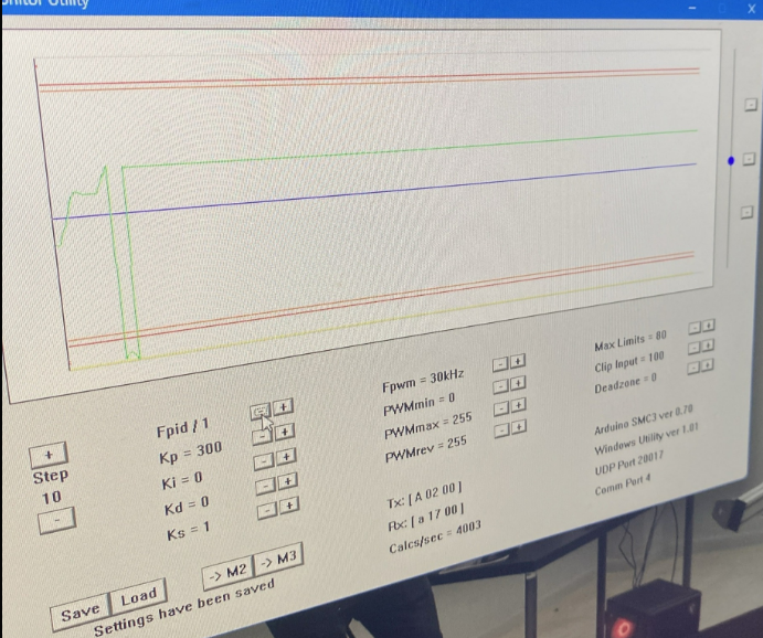

    I wanted to build a 2DOF system, but right now I’m having a problem with my Hall effect sensor. In the screenshot taken from SMC3Utils, you can see that when the sensor reaches a certain upper limit, the signal suddenly drops all the way down and never goes back up again — at that point, the motor also stops rotating.
    Because of this, I have to manually realign the motor and the sensor every time. What do you think might be causing this? Could it be an issue with the sensor itself or with the values I’m using?
    Also, the pulley attached to the motor shaft is larger than the small pulley on the sensor, and I didn’t really pay attention to the ratio between them when assembling. Could that also be causing the issue?

    What specific Hall sensor are you using and what is its specs?
    The Hall sensor does not look to be centered in the picture.
    One of the benefits in using Hall sensors is that you can direct drive them, while a mismatched ratio complicates such simplicity.
    I am not sure how you got the values used but it is recommend you follow the steps below: https://www.xsimulator.net/communit...3dof-motor-driver-and-windows-utilities.4957/

    The sensor I used is pandAuto p3022-v0-cw360, and the values are
    vcc=5vdc, out=0-3.3v, gnd=0v
    Actually, I only shared the screenshot as an example — my real problem is with the sensor.
    Normally, when I move the motor, the motor signal and the sensor signal (the green one) move together.
    However, as shown in the screenshot I sent, when the green line reaches a certain upper area, it suddenly drops all the way down and turns the motor off.
    To make the motor work again, I have to manually realign it by hand.
    I don’t understand why this issue is happening — could it be caused by the gears?

    First when the encoder/sensor is out of range the motors will turn off in SMC3. I suspect yours is sending 0 which is less that the Min.
    I suspect that your 3.3v sensor going into a 5v A/D is the problem. When the sensor gets to 3.3v it will go back to zero. The software assumes the range is 0-1024 but yours will range from o-676 so the midpoint is 338. So when you setup the midpoint it’s 338 not 512. So the software has to be modified in order to work.
    I have been successfully using A5600 sensors for a few years now. There are cheap and effective. A different sensor is another alternative.
