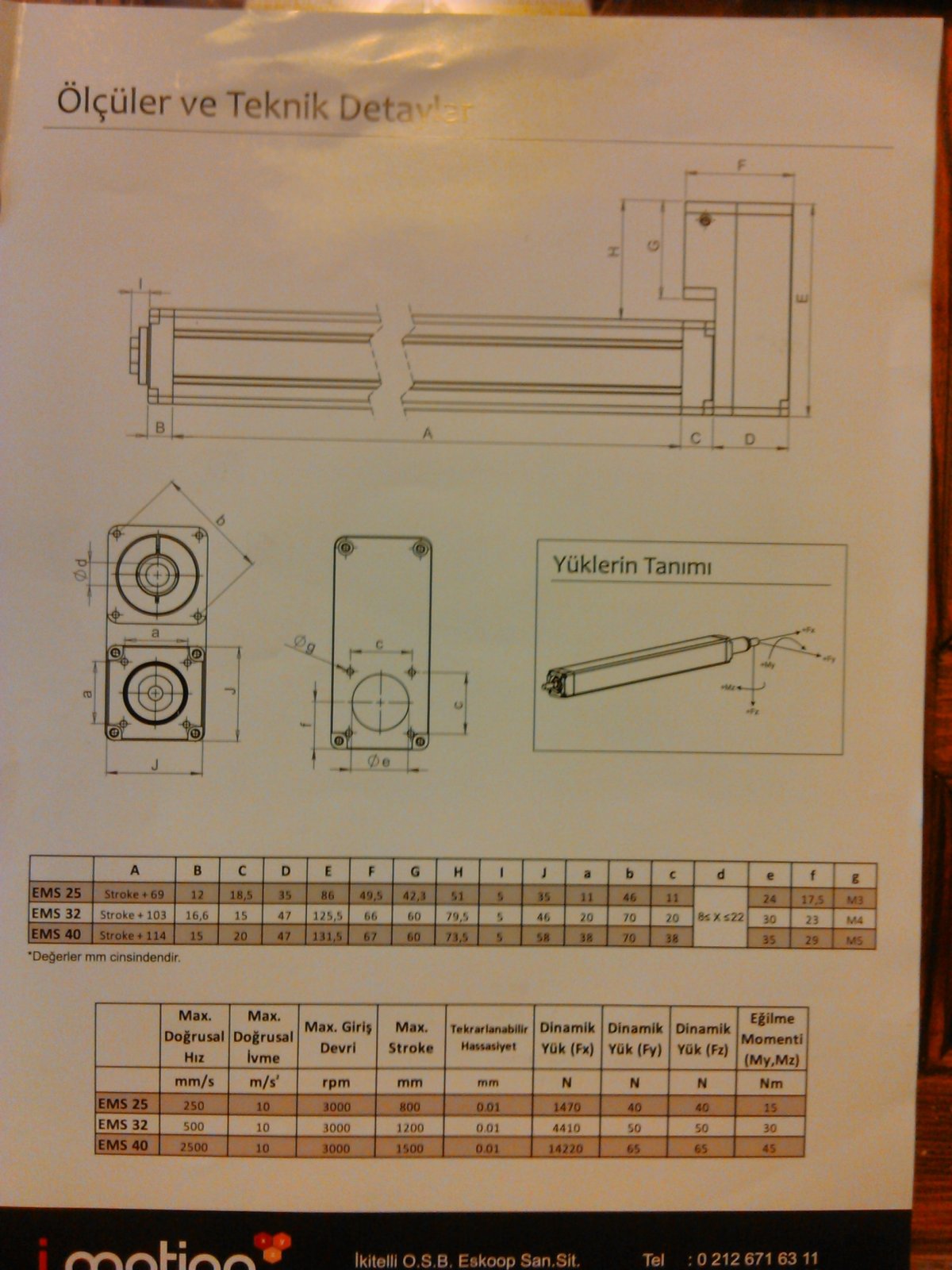

    Concerning the actuators, you can see a technical sheet attached. The EMS32 model has 4410N (450Kg) for Fx load and 500mm/s of speed. The length and stroke is long but they can produce a custom dimension. So the chassis of the car without wheels and swing arms weight will be approximately between 800Kg and 1000Kg. Each actuator have to loaded approximately between 200Kg and 250Kg I think. I am not sure but these actuators have to be sufficient.
    My budget for motion parts is $4000 ...if someone else have another idea to let this real car motion...an easiest and cheapest way please let me know, I will appreciate.
    One more thing, the G27 is simple and cheap ready to go steering set. The steering wheel is small diameter but I will not use as it is, I will connect it to the original steering of Alfa as they did on the video.
    I can work on pneumatics, hydraulics or AC motors but I need someone who can track me for what I must buy and how to set them (codes, electrical wirings). Is there a hero?

    Oh I see what you want to build, you are looking at this the wrong way, all you need to do is replace the current suspension dampeners with actuators,while keeping the car springs, way less power would be required - I would also disconnect the sway bars if fitted.

    SeatTime you are right, I am just thinking the same think...without moving the springs, the actuators will be less loaded and of course without swaybars.
    For example we can tilt the chassis of a car only by lifting from on side of the fender or sitting on. We are not spending much power to do that. A powerful actuator like EMS32 (on my previous attachment) can do much better tilting I guess.
    I think that the mainly problem is to drive these step motorized actuators. One on each swing arm, what I will be the coding and what I need to use as hardware (Arduino or JRK).

    I still would recommend removing as much weight as you can from the car as its the inertia that you have to worry about not just the static weight of the car. You may then have to use different rated springs as the weight of the car decreases to keep the required static ride height. Unfortunately this will require lots of measurement/trial and error. You may be surprised with what size motors you can get away with. Cannot help you with code for steppers - don't use them, but I have seen Arduino drive steppers (although allot smaller then you require). Do you have to use steppers? - as I don't think you could build a motion system using commercial actuators, drivers, controllers and power suppliers anywhere close to your $4K budget. Even just one 60kg rated SCN-6 actuator is close to $1k delivered.

    No I don't have to use steppers, but the Electromechanical cylinder can work with stepper or servo motor only. So I have to choose one that will be the easiest. The mechanical part isn't difficult for me, I will solve it somehow. I am stuck on one subject; which type of electromechanical cylinder must use (stepper or servo powered) and how to control 4 of them (each on one swing arm) with simtool (which hardware and coding).
