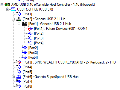

  10. Tino.Sturlic
    Tino.Sturlic Member Gold Contributor
    Sep 2, 2010
    44
    201Coins
    +30 / 0 / -0
    This is how it looks. I tried different USB host controllers. Now it's alone on it's own host controller and it still doesn't work every time.
  11. Tino.Sturlic
    Sep 2, 2010
    44
    201Coins
    +30 / 0 / -0
    Is there any kind of debugger for this? Now it just lost connection in the middle of the race... :(

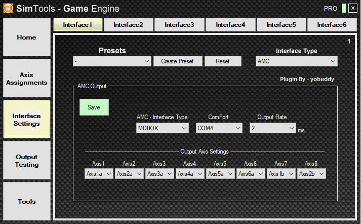

  12. yobuddy
    5,282
    49,198Coins
    +5,093 / 18 / -0
    I have a AMC-MDBOX setup here and it seems to be working fine.
    I did have to update the firmware on my thanos controller when I received it, but I was an early adopter, so it may not be your problem.
    May I see a pic of your interface settings?

  13. Tino.Sturlic
    Sep 2, 2010
    44
    201Coins
    +30 / 0 / -0
    I tried with different usb cable. Did not solve the issue. What does that beep sound means. It makes that sound during startup of the game engine every time it's not working. I was also updating Thanos interface I believe. It was working fine for some time without problems...
  14. yobuddy
    5,282
    49,198Coins
    +5,093 / 18 / -0
    It means SimTools was not able to startup an interface.
    Try with an update rate of 10ms and see what happens buddy.
