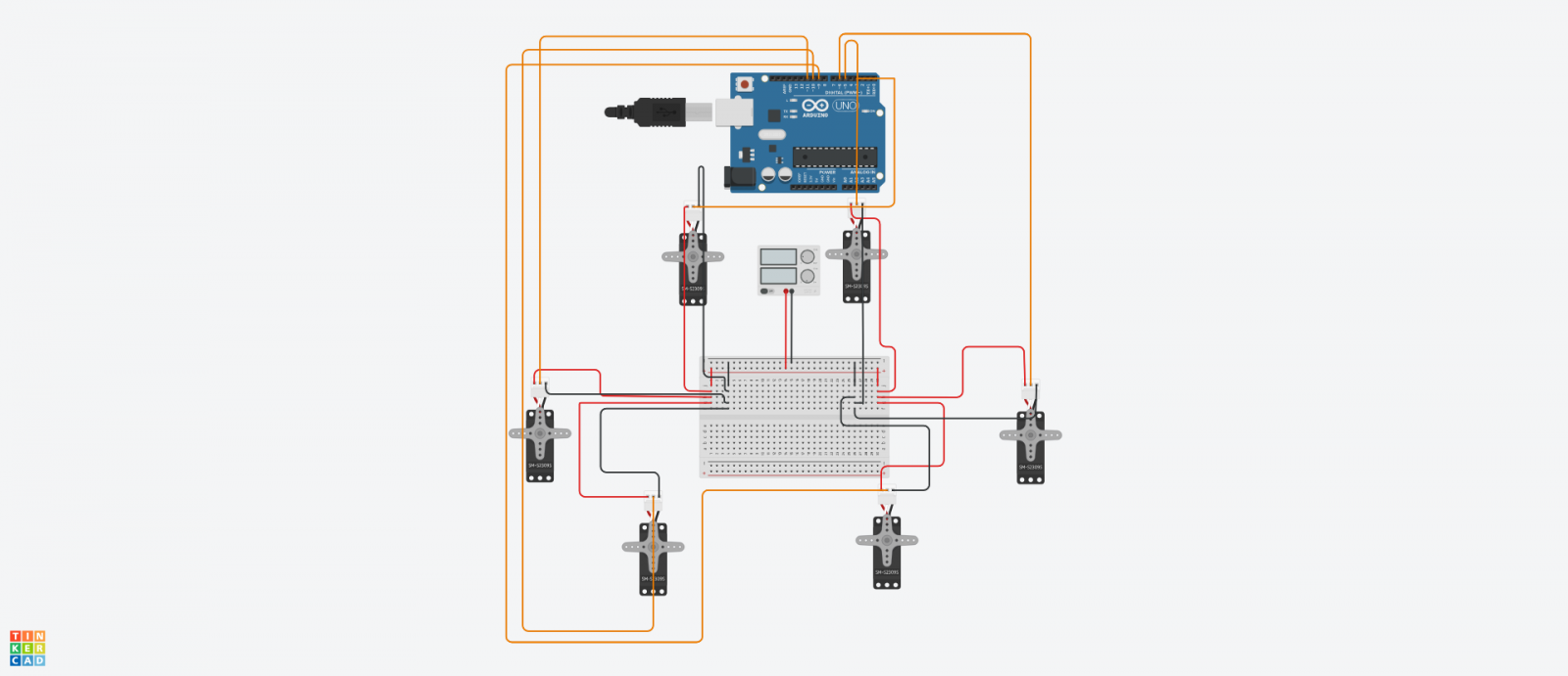

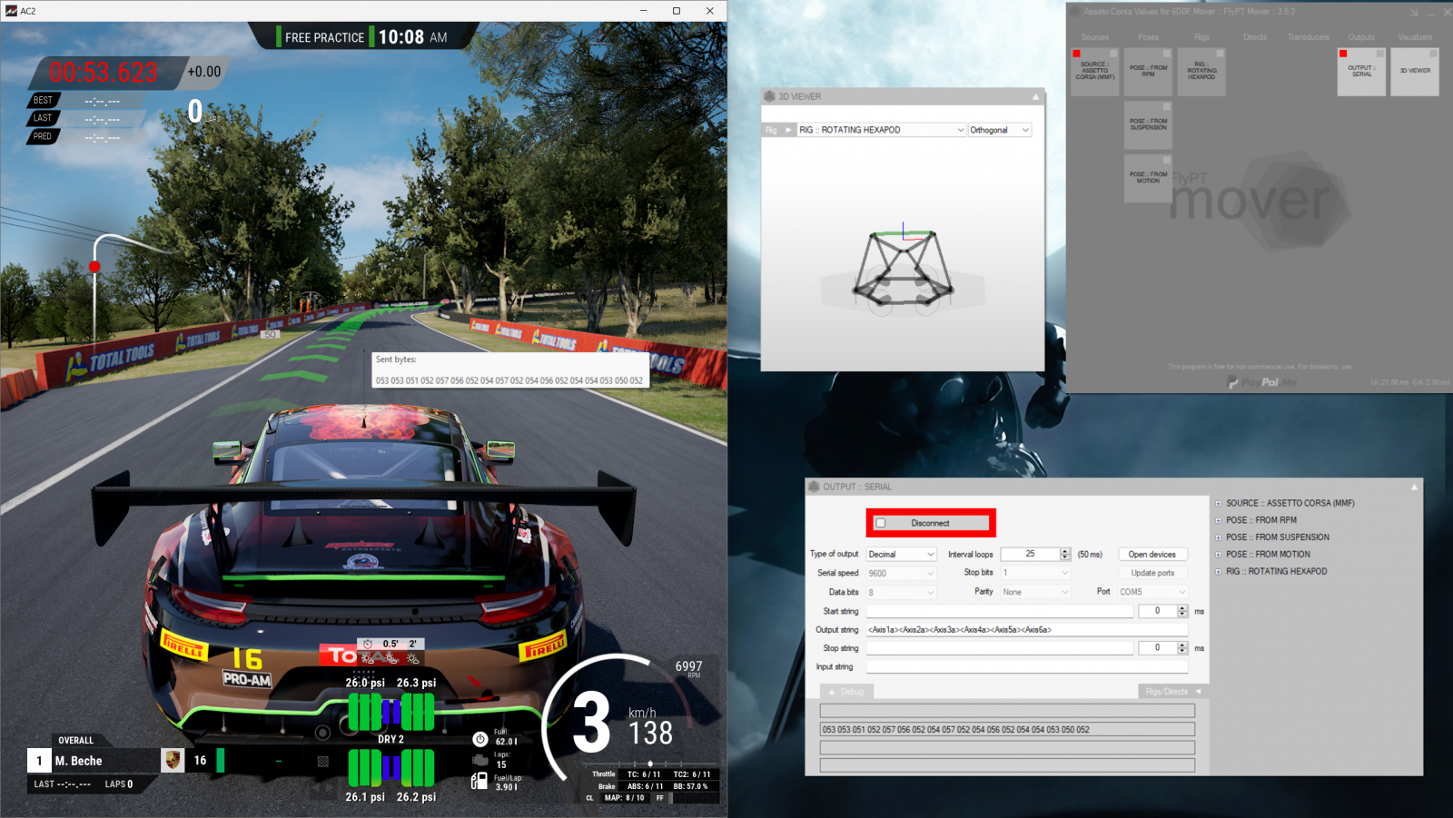

    hello, ive been working on a servo powered rig model and tried testing assetto using flypt. Either I'm stuck at a power or a code problem. i use a 5v 2a adapter for mg995, mg996r motors, connected them and tried testing using the following code. it gives a late and limited response as shown. set the parameters correctly at flypt

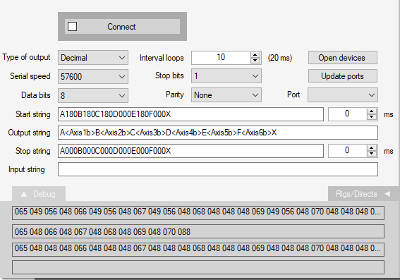

    Use this for the setup data in FlyPT:

    Worked like a charm ! though need a bit of tweaking on my hardware tho, the servos sometime lock off
    thanks a ton
