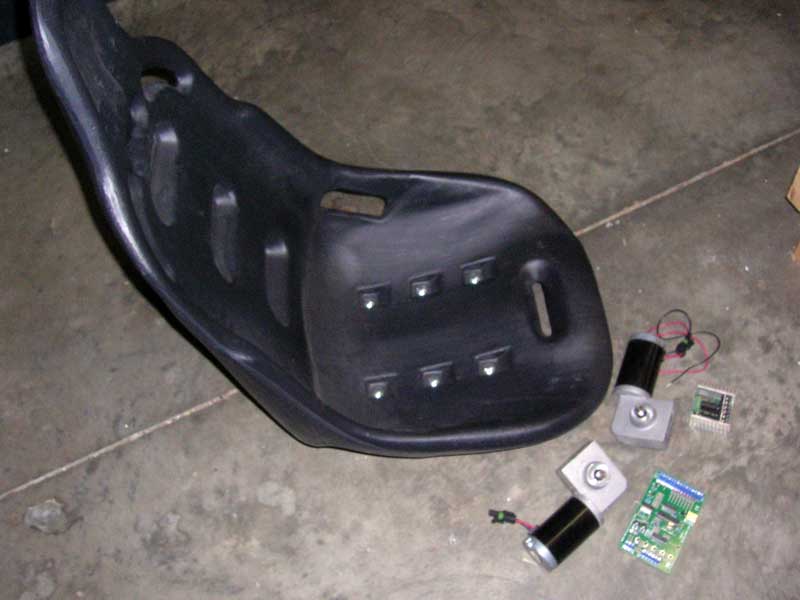

    I'm about to start the build of a 2DOF sim. This is what I've got so far:
    RCI 8000S Poly Baja Highback Seat
    2 DC gearmotors from wheelchair lifts
    K8055
    Sabertooth 2X25 motor controller
    2 10K pots
    4 Ball bearing rod ends
    400 watt PC power supply
    The motors run 270 rpm @ 12v so I'll have to gear it down. I'm planning to use the gears off an old bike to get the rpm to between 55 and 70. This will also increase the torque.

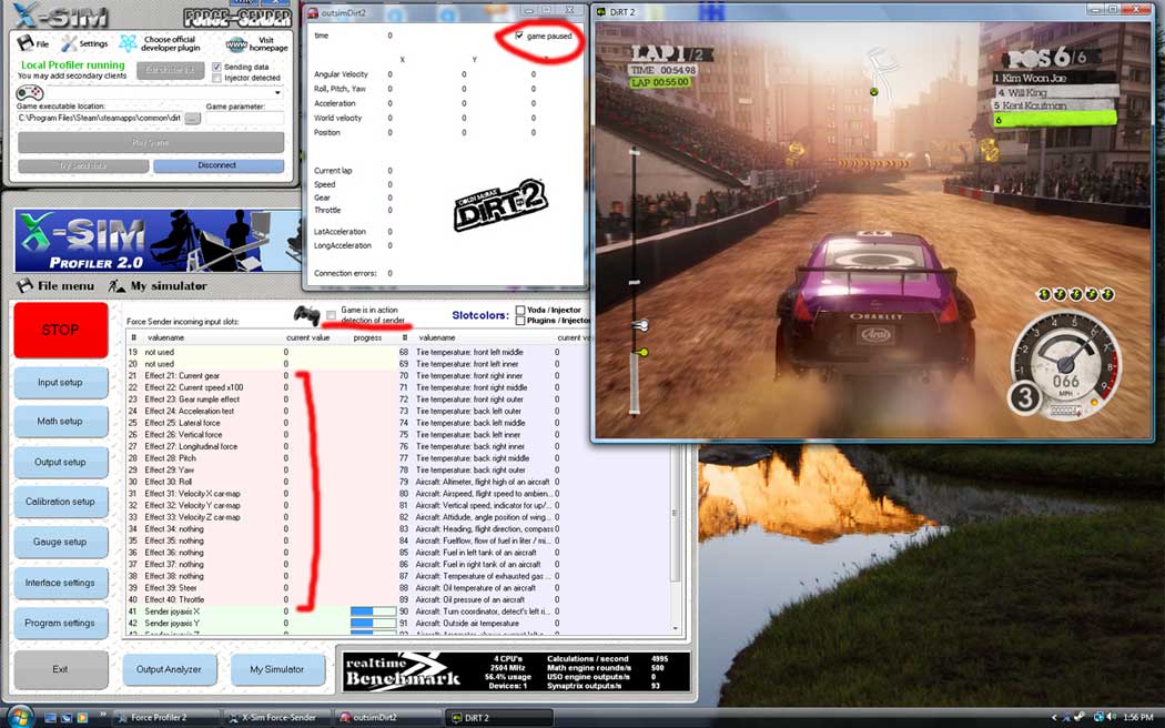

    I'm not sure if this problem should be posted here or not ( not sure it's a profile issue).
    I've got a profile, dirt2 plugin and a sender config file loaded, the program tells me a game has been detected but when I hit Start and play the game, all the inputs stay at 0. The 'game is in action detection of sender' button is unchecked. My sim output screen has 'game paused' always checked. Before I connect any outputs I want to make sure all the different modules are communication with each other.
    Thanks,
    Dave

    Have you selected the official developer plug in ? Also have you tried it with another game and profile?

    Yes, the official plugin is loaded. Dirt2 is the only game I've got that has listed plugin. The test panel plugin works fine though.
    Dave

    From what I can tell from the pic, you have clicked try sending data instead of play game.Perhaps change the game exe file location and try starting the game with that, as well as click start of profiler.

    I think I got it. I edited the hardware config file to change the ip from dbox to 127.0.0.1 I can see the values change as I drive.

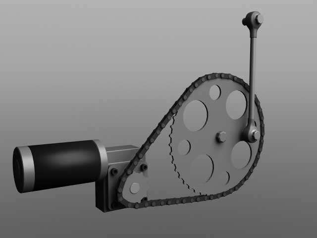

    I was originally planning on using the 2 wheelchair lift motors I had. Their rpm was too fast so I devised a reduction from bicycle gears to get it down to about 60-70 rpm.
    I wasn't happy with how it was going so I stopped of at the local salvage yard and picked up 2 wiper motors ($15 each). They have plenty of torque and should work well. I'll work on the frame next.

    Hi Dave - using gear reduction with bicycle components does work, but from my prototyping I can tell you that this configuration is compromised. Yes you will get a speed reduction and power advantage through the use of gears, but you will also lose power and gain speed from the increased length of the lever (centre of the axle to edge of small cog : Centre of axle to arm connect on big cog).
    I believe that you will also experience difficulty using bike components, as they do not connect in the way your diagram shows... the hole in the centre is much bigger.
    For a step by step guide on how to set up cogs and chains on a wiper motor, check out Page 17 post 5 in my thread... later on in the same thread, there are pictures and videos of this setup in action... very poor performance by comparison to other configurations - this configuration could barely lift 10kgs... other configurations I have tested were capable of throwing a 2m sofa around with the same motor!
