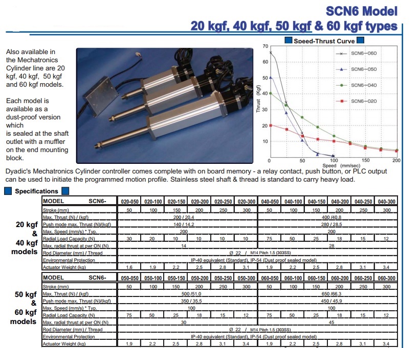

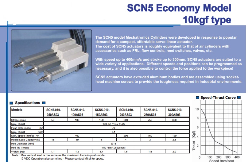

    Nice stuff - more options for people to consider. For everyone's info, here are the speed/load graphs for an SCN-5 & SCN-6 - note that the specified load on the Heading/graphs is not for a vertical lift (see 'Push Mode' in specs Eg. Max 7.1Kg for '10Kg' SCN-5 and 45.9Kg for the '66Kg' SCN-6 at 0 mm/Sec). It would be interesting to see the graphs for the 'High Force' actuator if they are available.

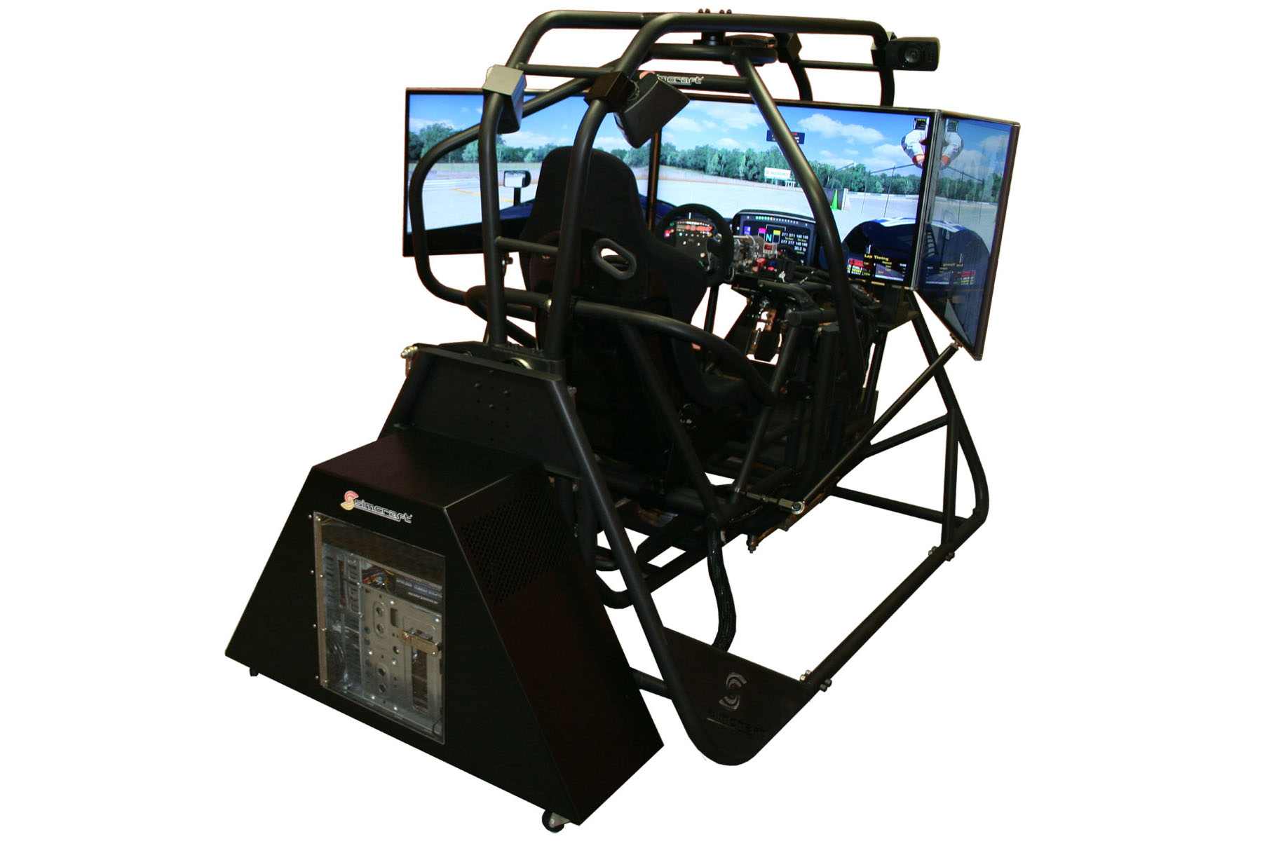

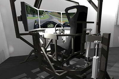

    We mostly use and recommend the SN6. We found that the motion is more precise and for the minimal price difference its worth going to it. We use the SN6 in almost all of our professional Apex units as well as the Vertex units.
    SimCraft Apex:
    Vertex: (This is the rig we sell the complete diy plans for on the site)
