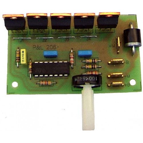

    More reading...more questions.I want to ask something about the motors again.
    I want to put dc motors.If I buy windshield motors from 24v truck would it be more powerful than 12v?
    If I buy a motor with high rpm for example 3000 can I reduce them with something like the one in the attachment?In the seller's site says that it can reduce motors from 12 to 48v and 90-350w.Unfortunately doesn't say up to how many rpm it can reduce.If I don't use this can I reduce them with gears?Tell me please that maximum rpm that the motors must have.

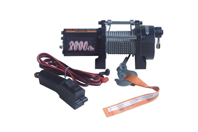

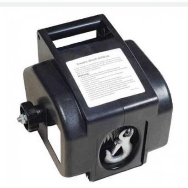

    A small update about some motors that I found and I need your opinion.
    I thought that maybe motors from car winch(if google translate translates the word correct because I don't know the exact word in English) will be good enough for the project so I found the motors at the attachments.
    Technical details for the 1st one 0.4hp / 0.3kw - max ampere 40 - when fully load (907kg) 1.8m/min
    Technical details for the 2nd 0.6hp / 0.48kw - max ampere 50 - when fully load (3161kg) 1.8m/min
    Technical details for the 3rd 0.95hp / 0.7kw - max ampere 62 - when fully load(909kg) 2.74m/min
    Unfortunately I couldn't found the exact specifications as needed above but if somebody can take as look at them the models are 1) DW3 2) DW4 3) DW2000
    Is one of these good enough?
  17. noorbeast
    21,040
    147,938Coins
    +10,882 / 54 / -2
    Have a look at the FAQ winch motor section, as they have been used by some members before: https://www.xsimulator.net/community/faq/dc-winch-motors-for-motion-simulators.151/
