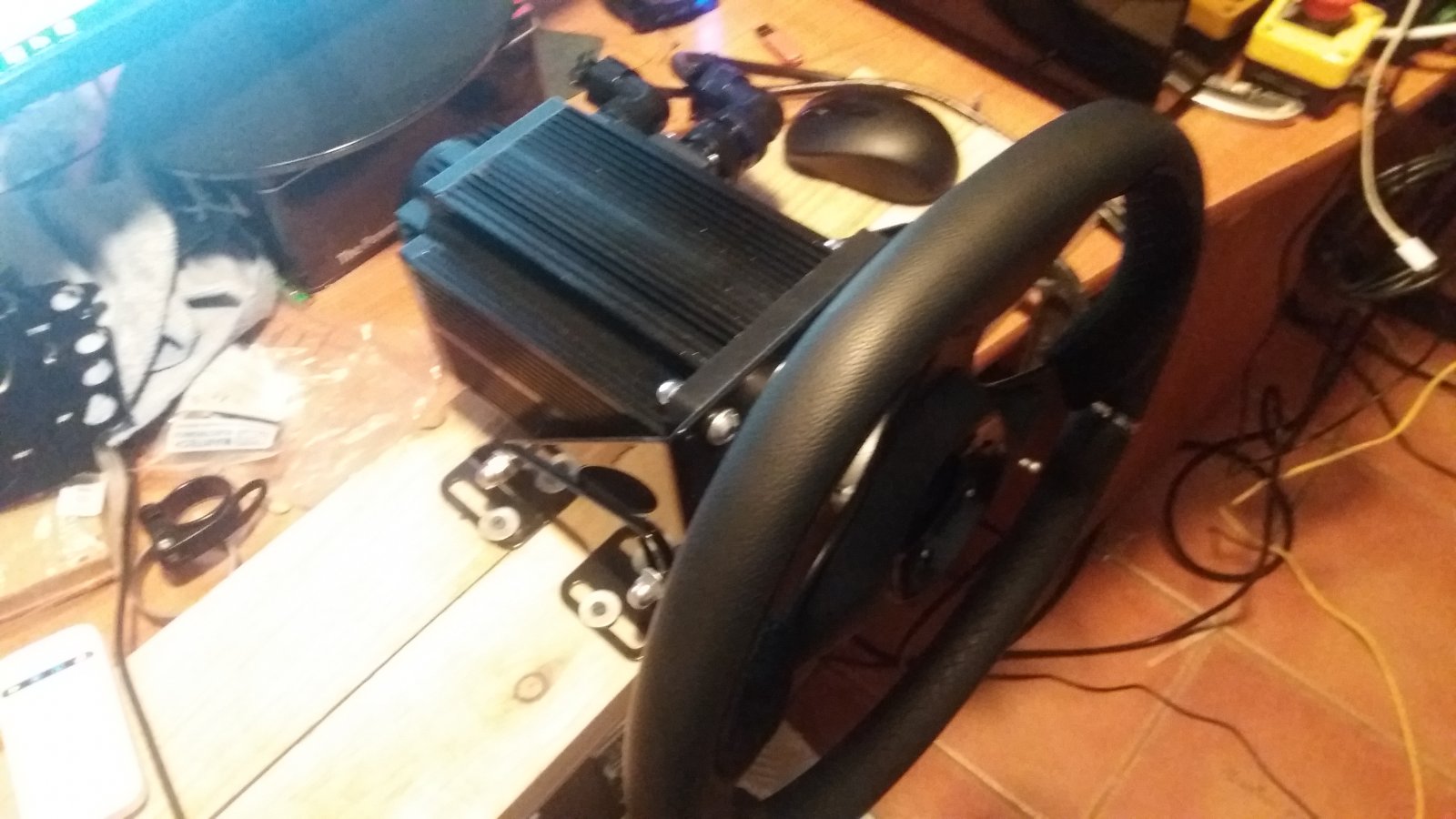

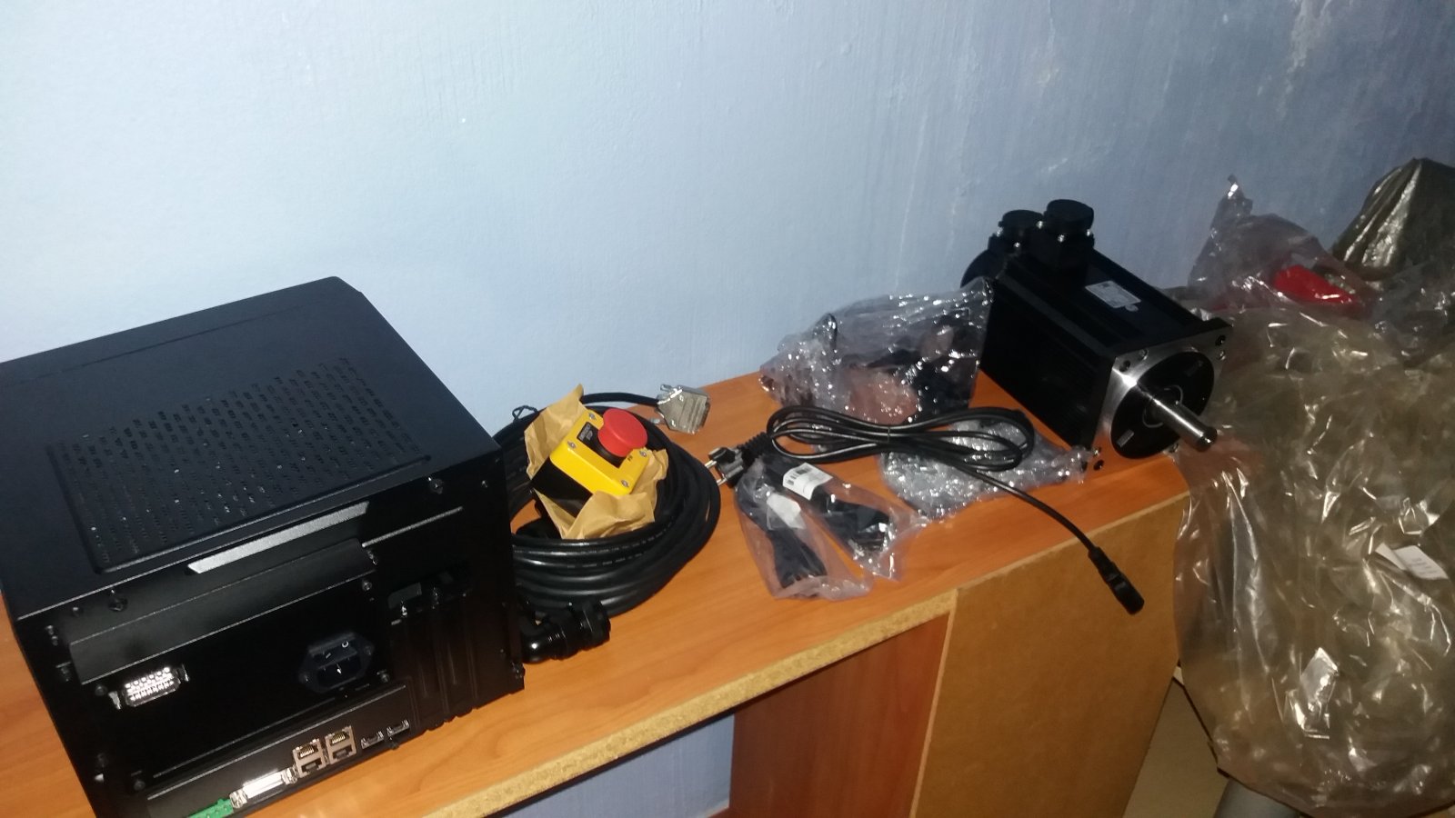

    Thanks Gigi, at this stage im not decided on which motors yet. I did get a nice welcome home present when I got home today. My OSW had arrived from Tomo. What good service and fast shipping.

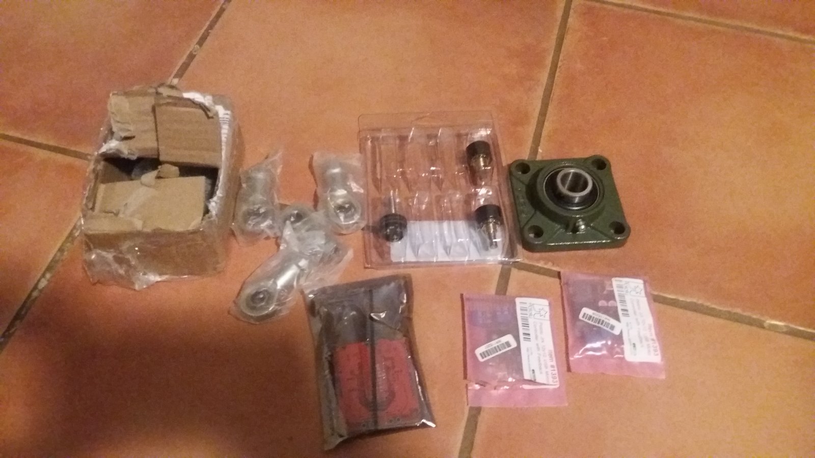

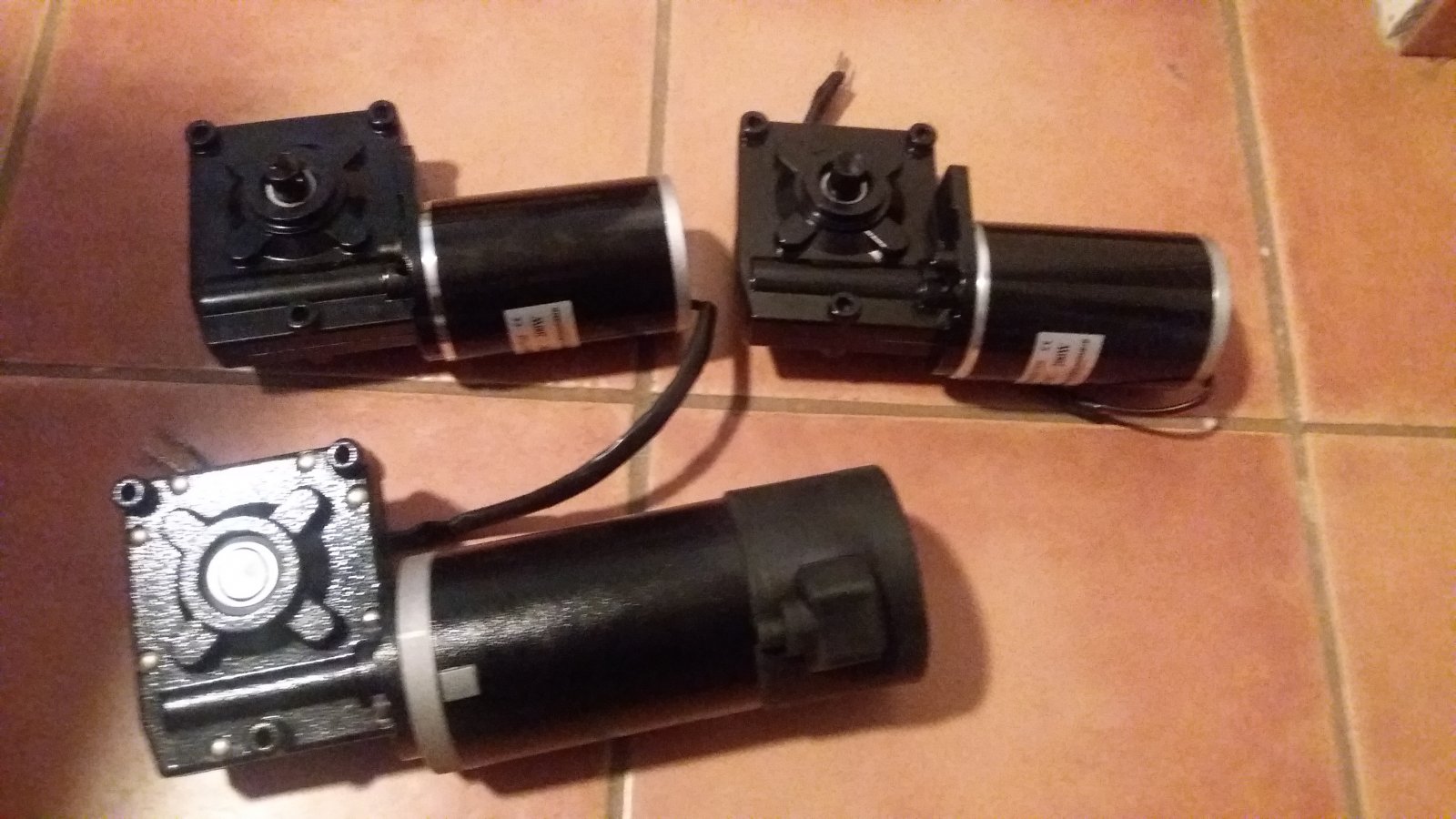

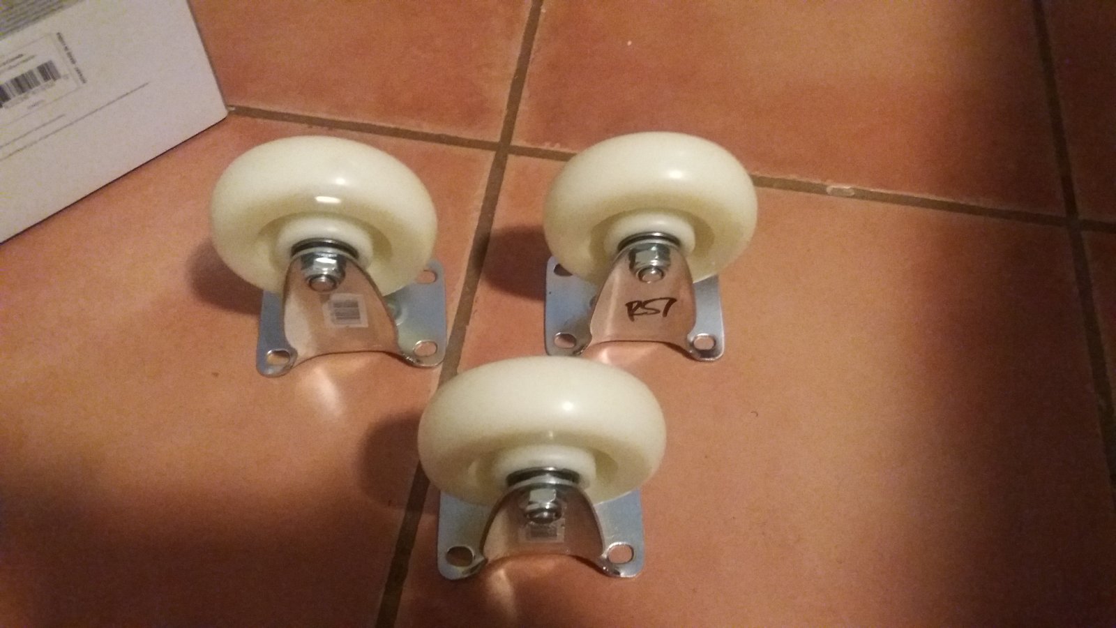

    Got home today and had some goodies greet me. All arrived today! Ball joints, Motors from motion dynamics, JRK's, Caster wheels, F1 Steering and a pillow block bearing.
    I have been using the OSW since it arrived a few weeks back and all I can say is WOW! and that I need to get this rig built ASAP. I'm almost have everything that I'll need, just need to find a Universal Joint and a seat and waiting for a Sabertooth and an Arduino to be delivered. Will be ordering steel in the next week or so and then the build will begin. Really excited now

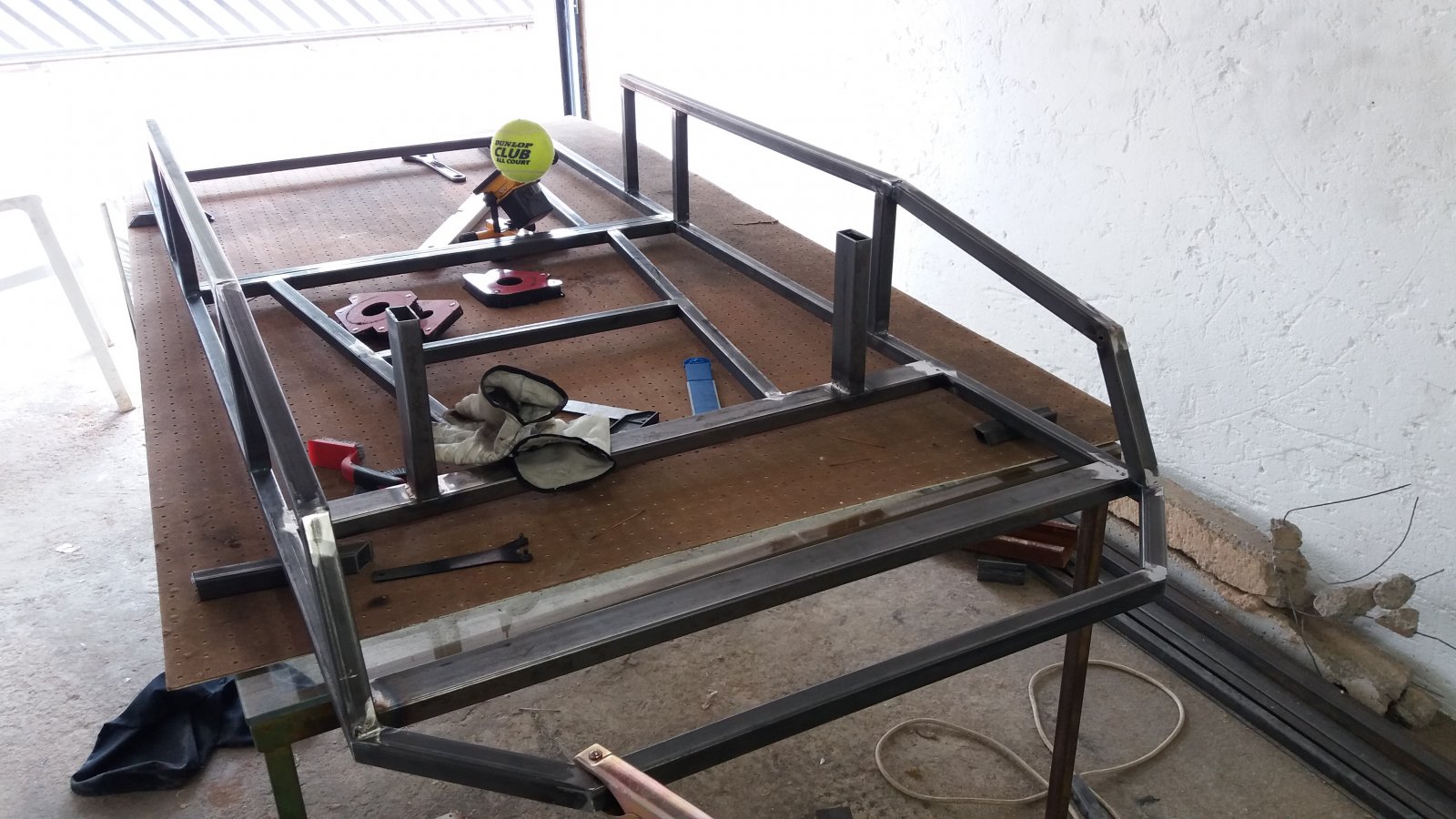

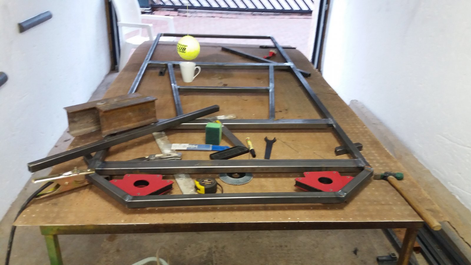

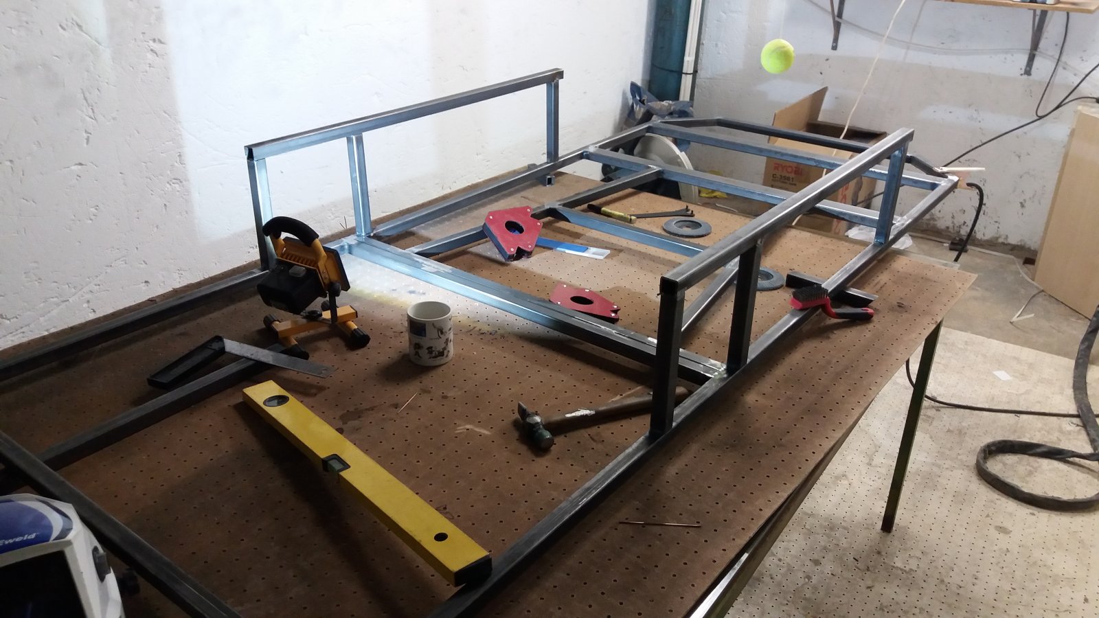

    I bought myself a tig welder a couple weeks ago and been teaching myself to Tig. I'm at a level now where I'm comfortable to start welding the rig together so decided to make a start today. Some pics of the days progress
