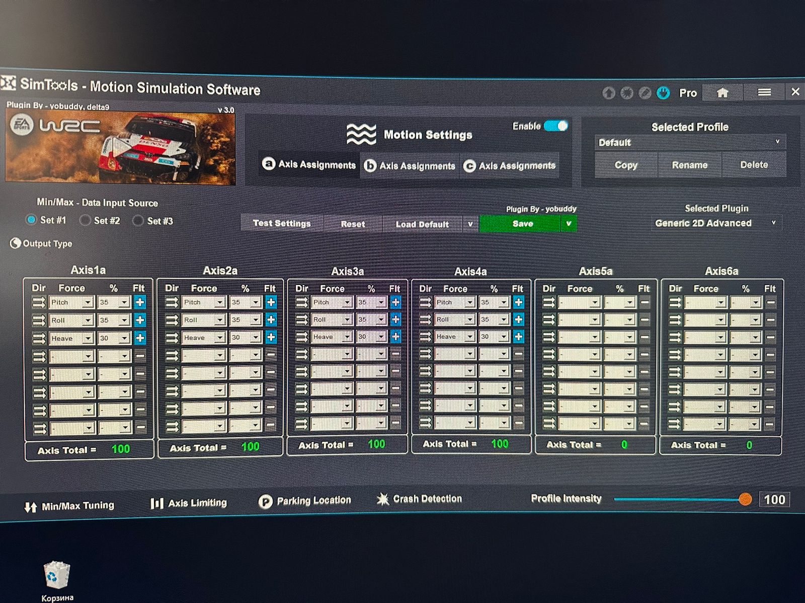

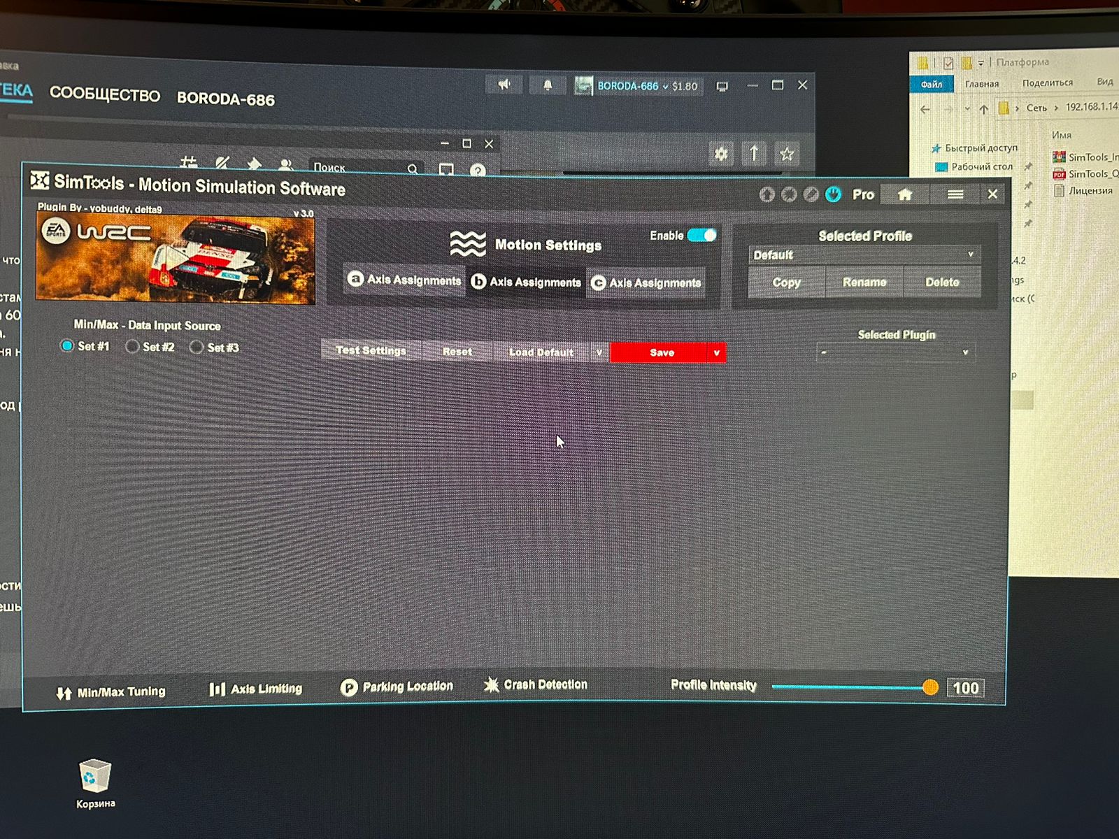

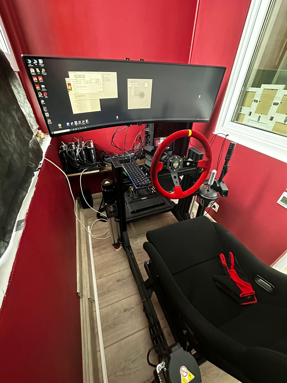

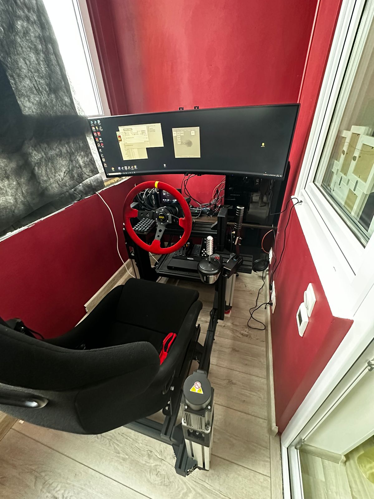

    Hello everyone. My name is Danila. I'm a complete novice in the world of simracing. I recently put together a platform with the help of a friend. he completed everything for me and sent me a set of actuators. In Dirt rally2, everything works fine through the FlyPT Mover program. Now I'm dealing with SimTools to launch the WRC 23 game. It doesn't work in any way (((((. I bought a license yesterday. Perhaps SimTools is not suitable for my drives. Please help.
    I apologize for my English. I use a translator.

    Welcome and nice job with your rig :thumbs

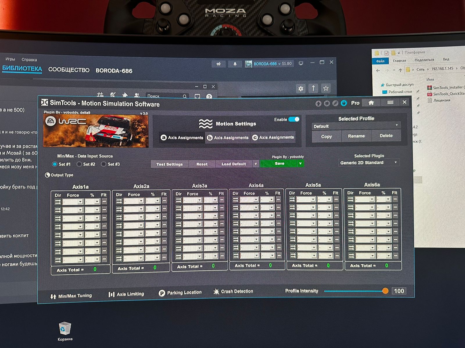

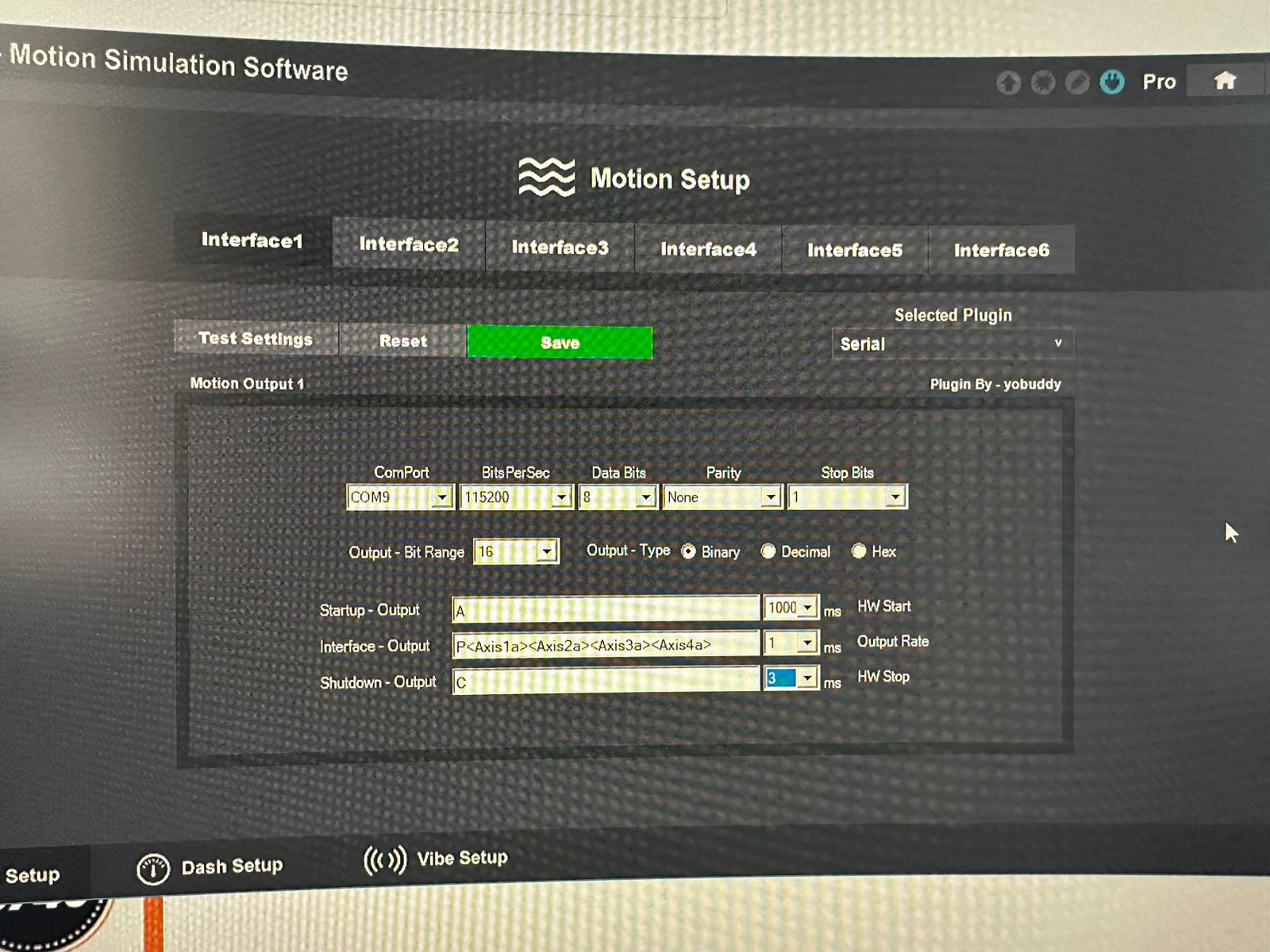

    What control code and hardware are you using? Please also post pictures of all of your settings.

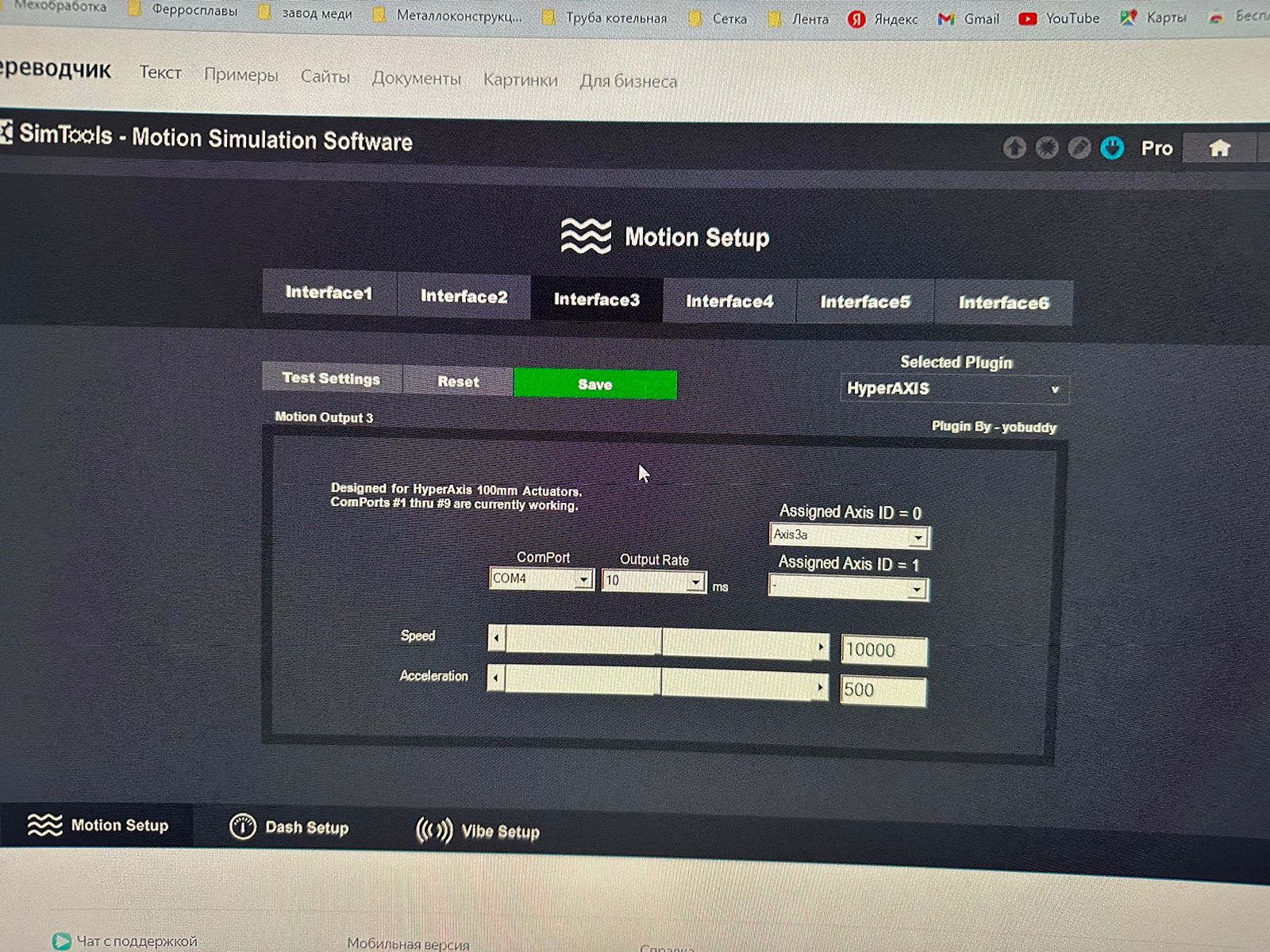

    I'm very bad at settings. The flyPT plugin was sent to me. I was just adjusting the power. I don't understand anything about the simtools program at all. I was looking for configuration information for the srt-80 platform, but I didn't find any information anywhere. I understand that you need to choose the Hyper AXIS plugin instead of SCN. All these settings are incomprehensible to me. I am even ready to give anydesk for help. or maybe some hints . it's very hard for me

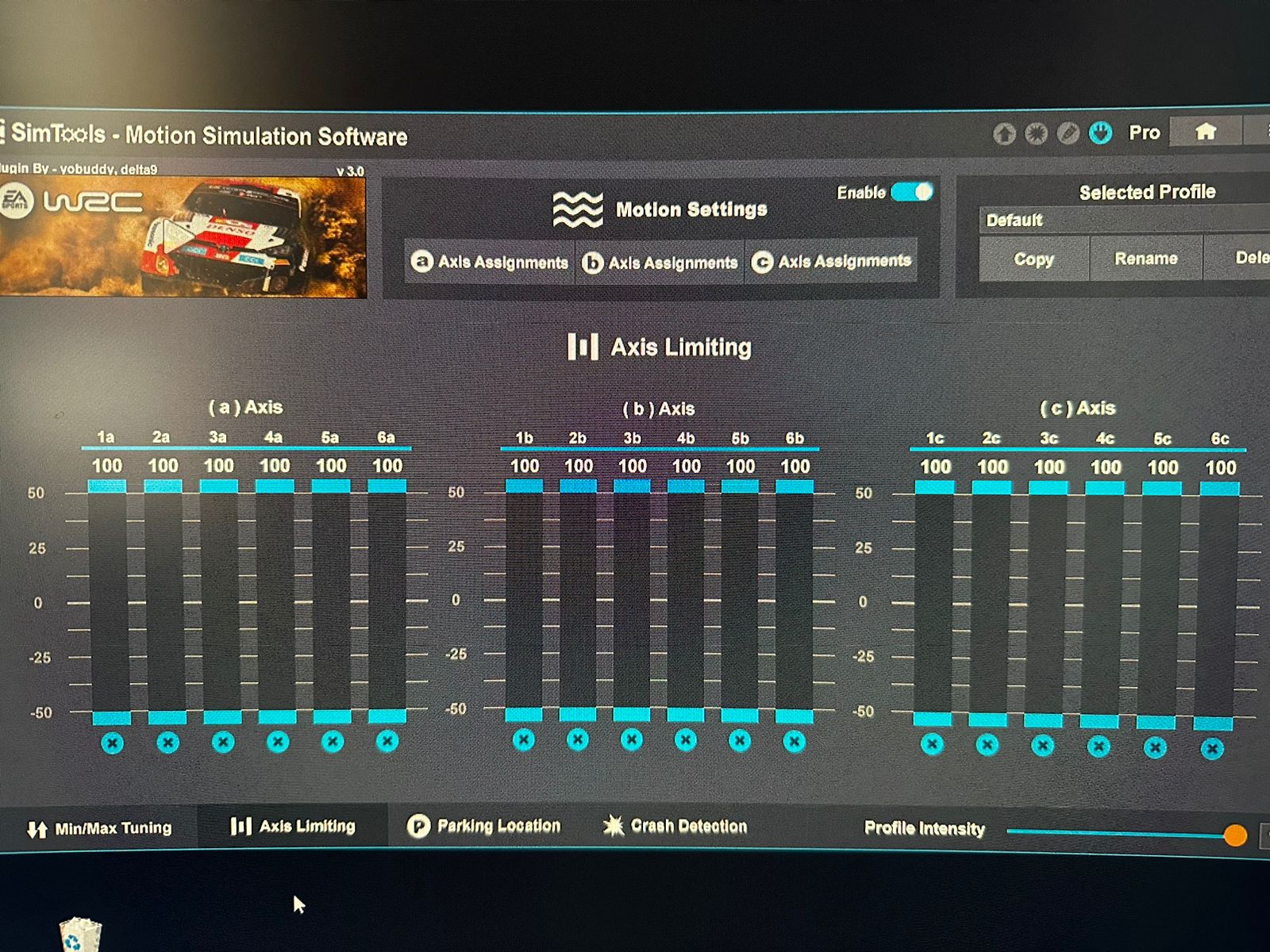

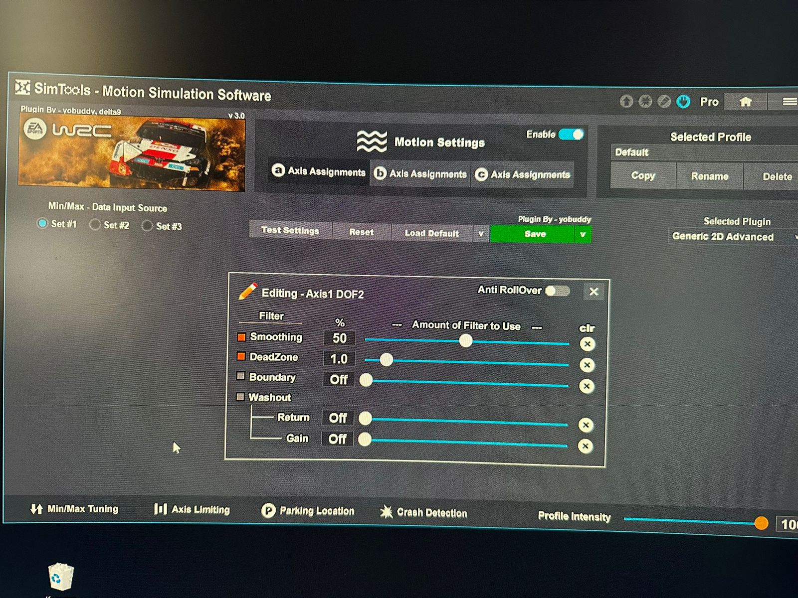

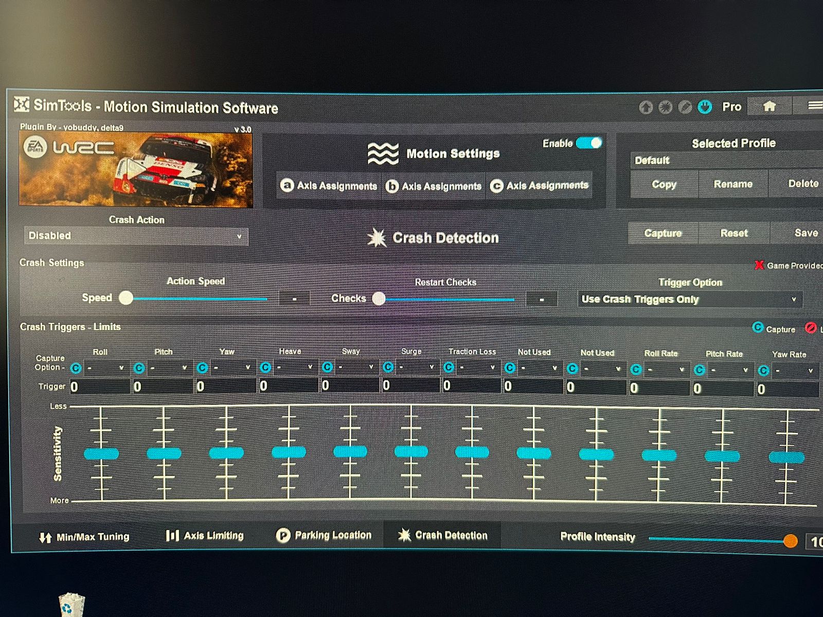

    I wrote to him, but he doesn't answer. I managed to run SRT 80 for WRC 23. but only up and down movements work. leaning forward backward and sideways does not work.
    please look at my settings, maybe I didn't click something.
    20,958
    147,464Coins
    +10,865 / 54 / -2
    That is unfortunate.

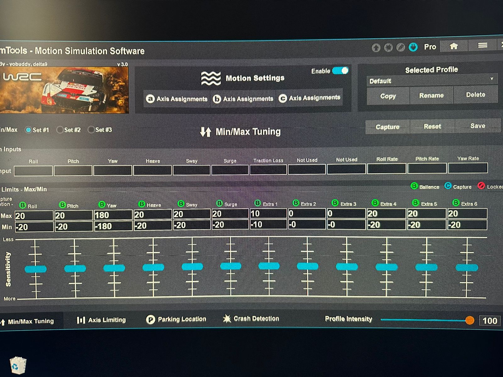

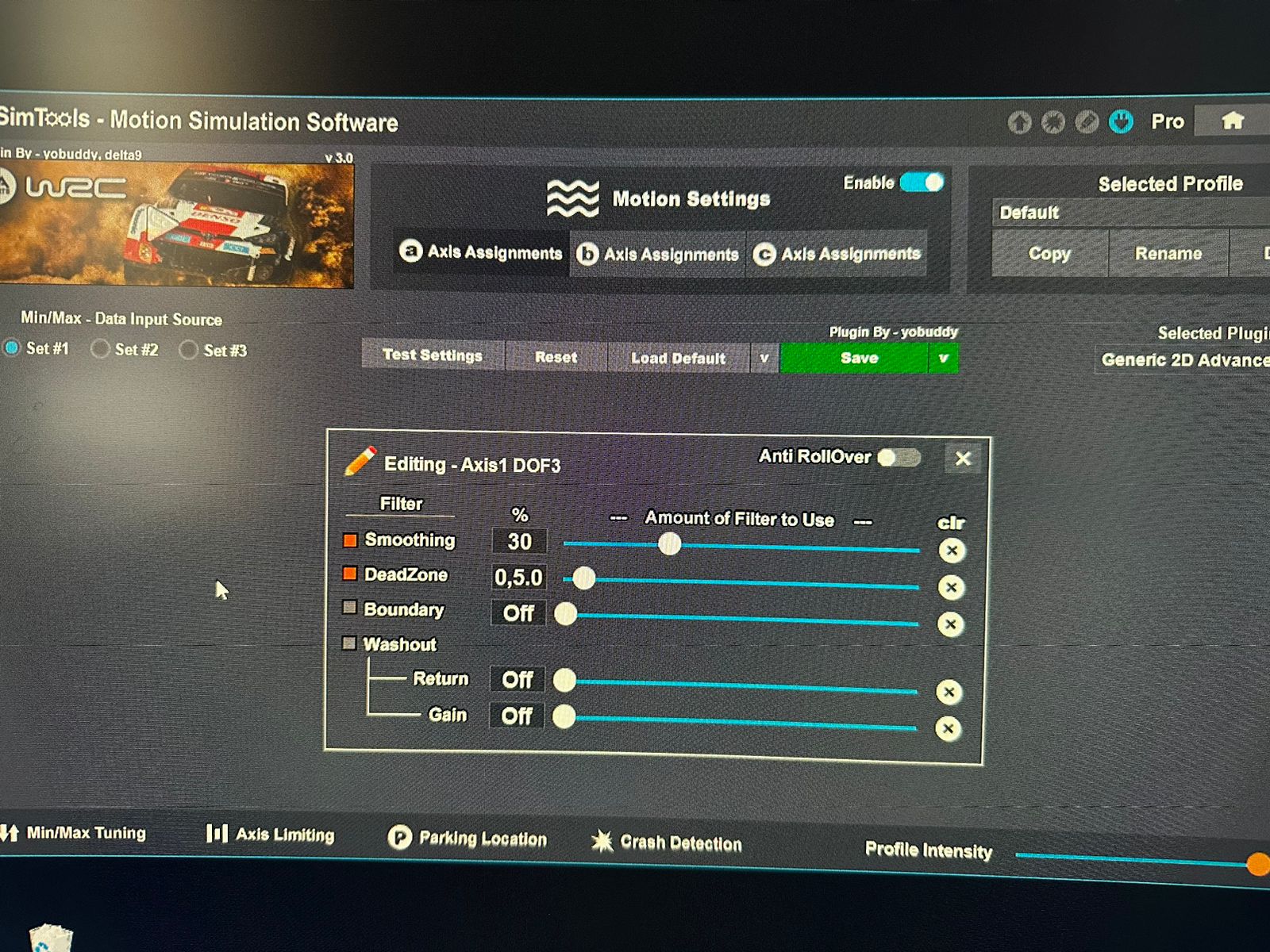

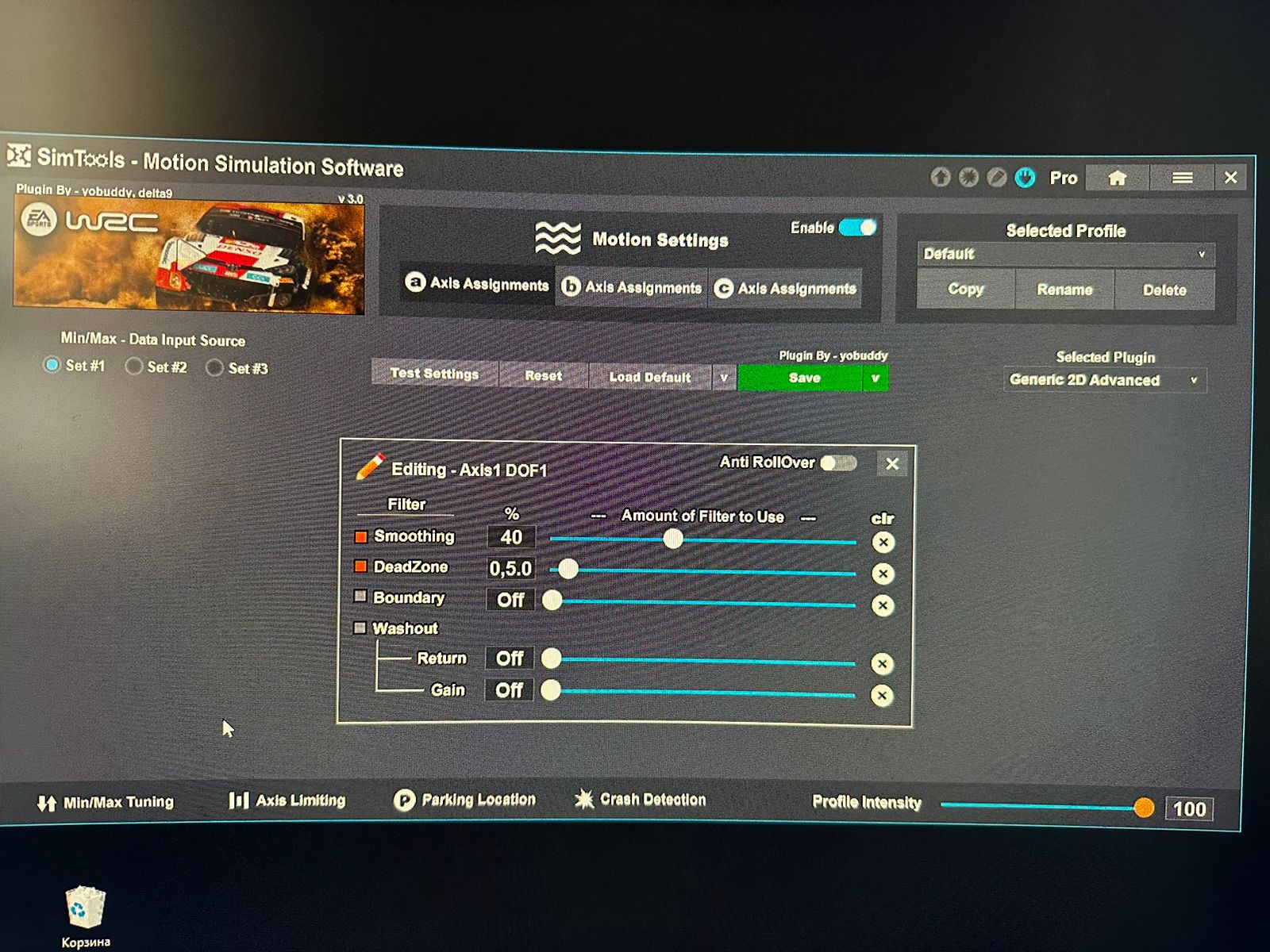

    What are your Interface Settings?
    It is not a good idea to use filtering, limiting, or DeadZone until all issues are sorted, it only compounds the possible variables.
    From the pictures it does not seem that Max/Min values have been captured in the Tuning Center.

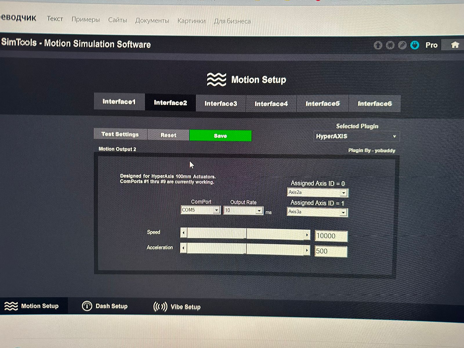

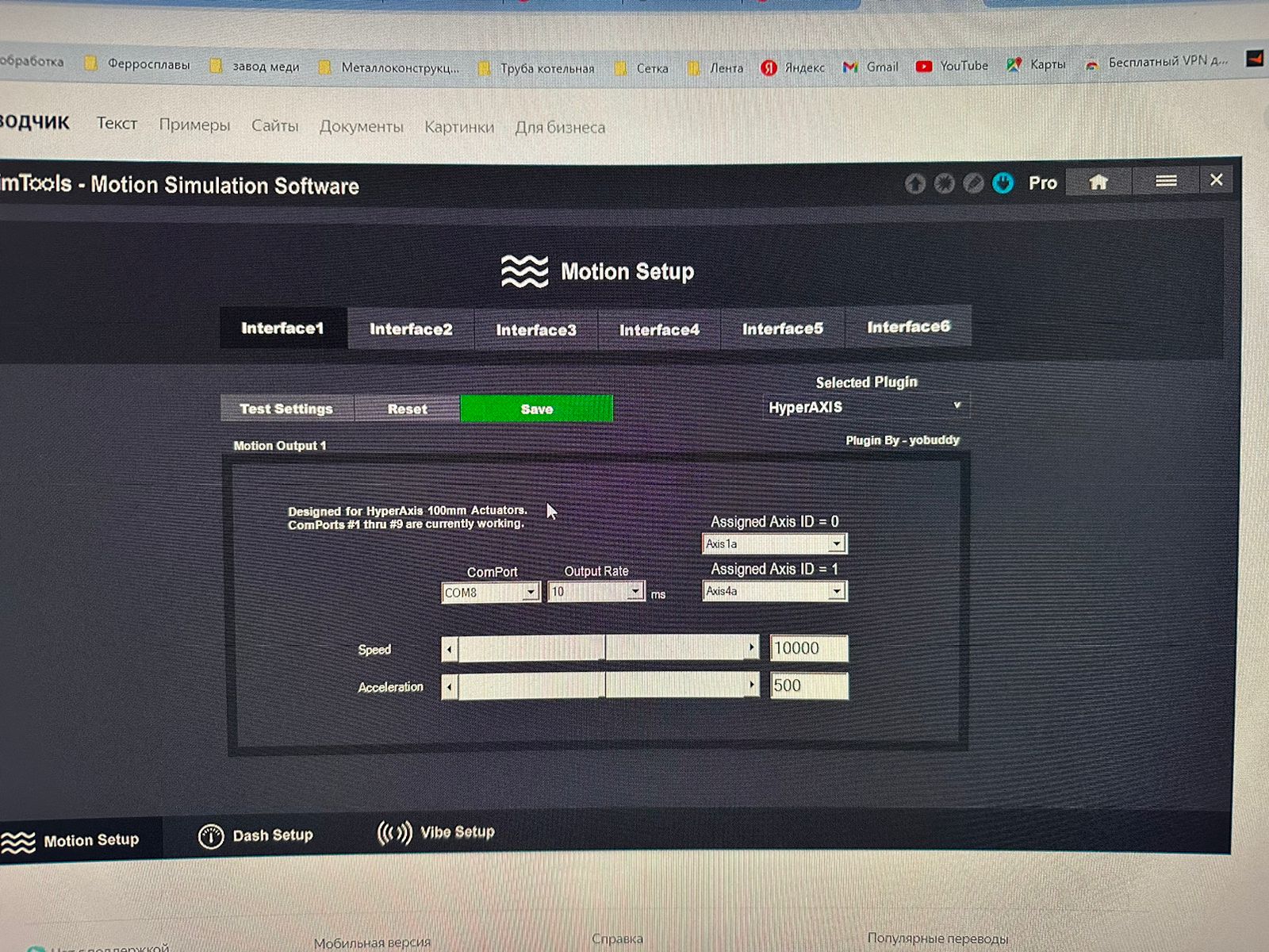

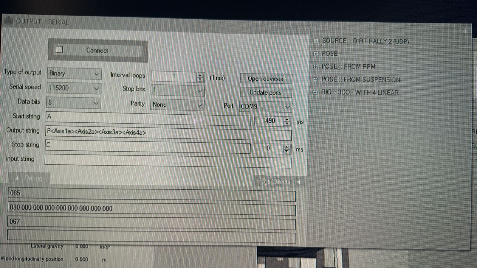

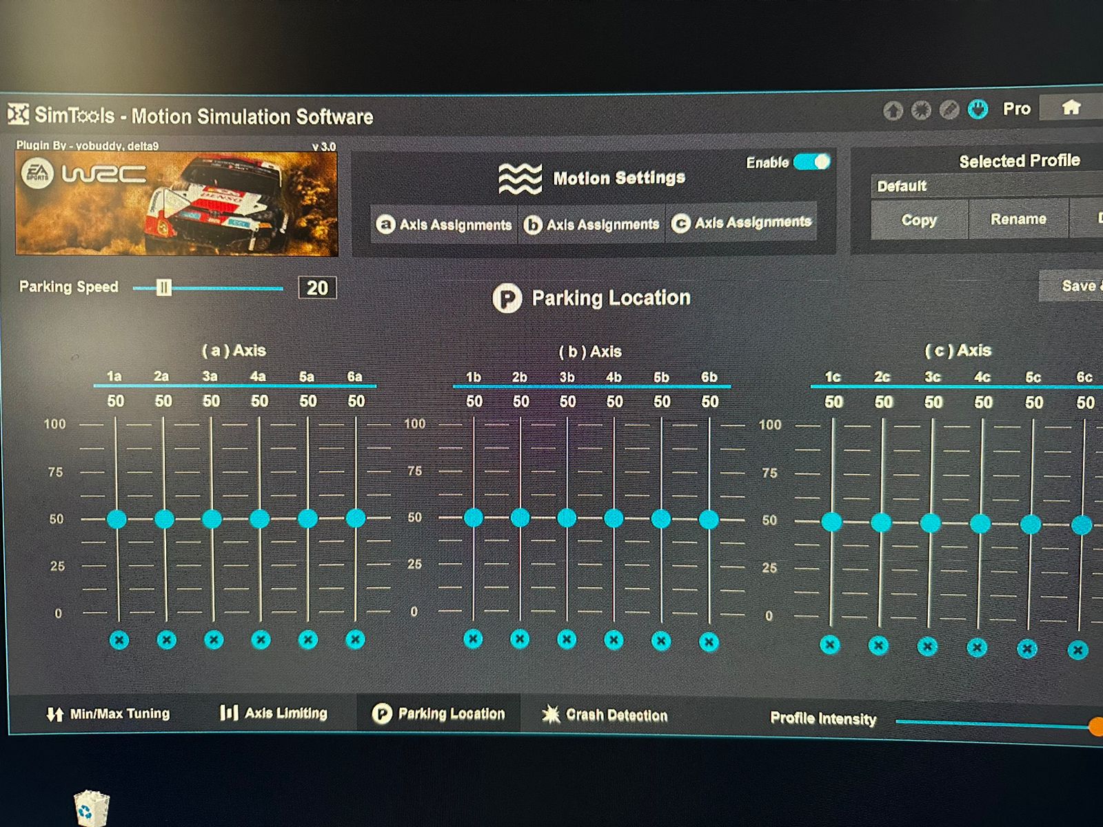

    Here are my settings in FlyPT and SimTools

  13. noorbeast
    20,958
    147,464Coins
    +10,865 / 54 / -2

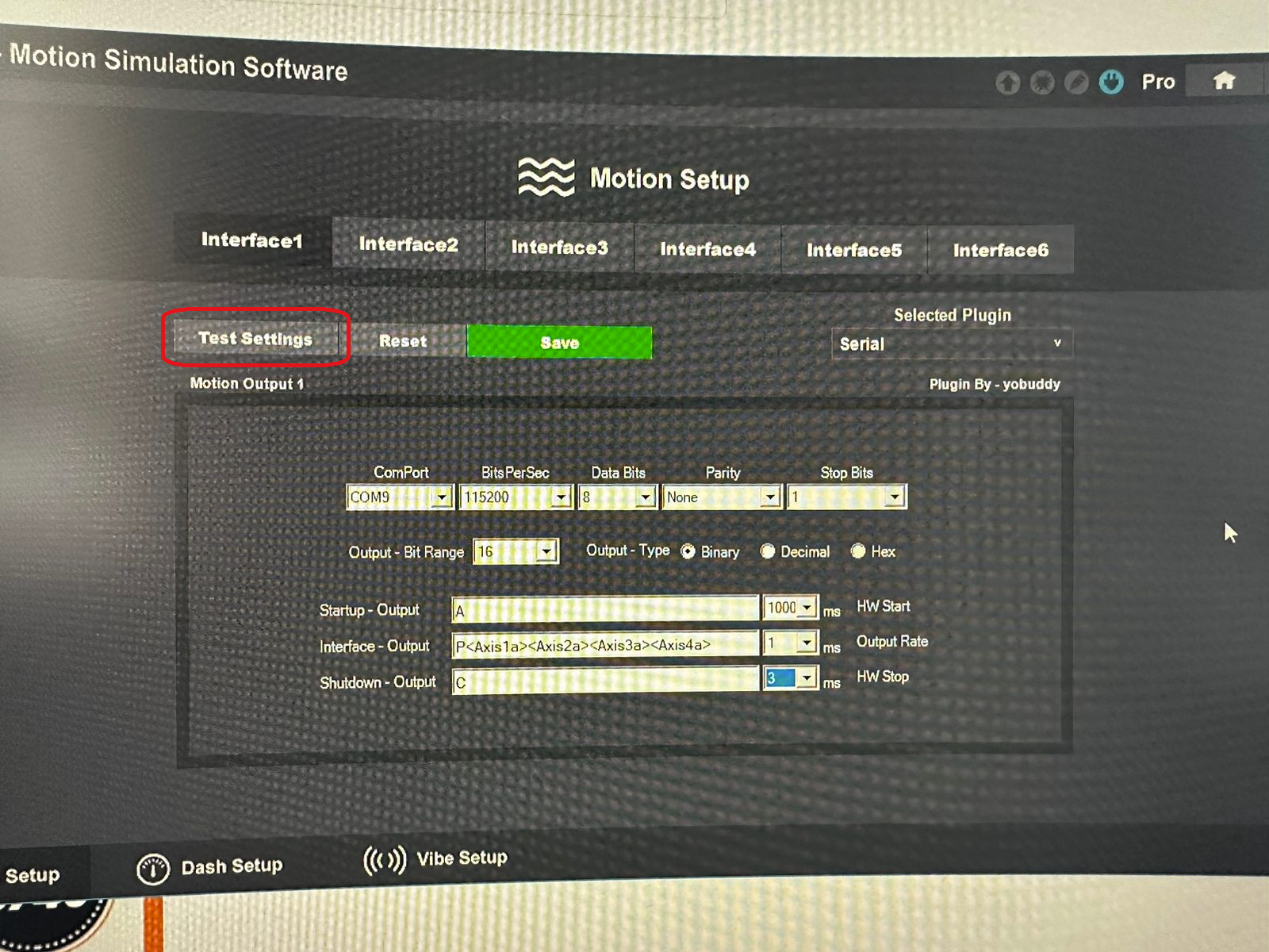

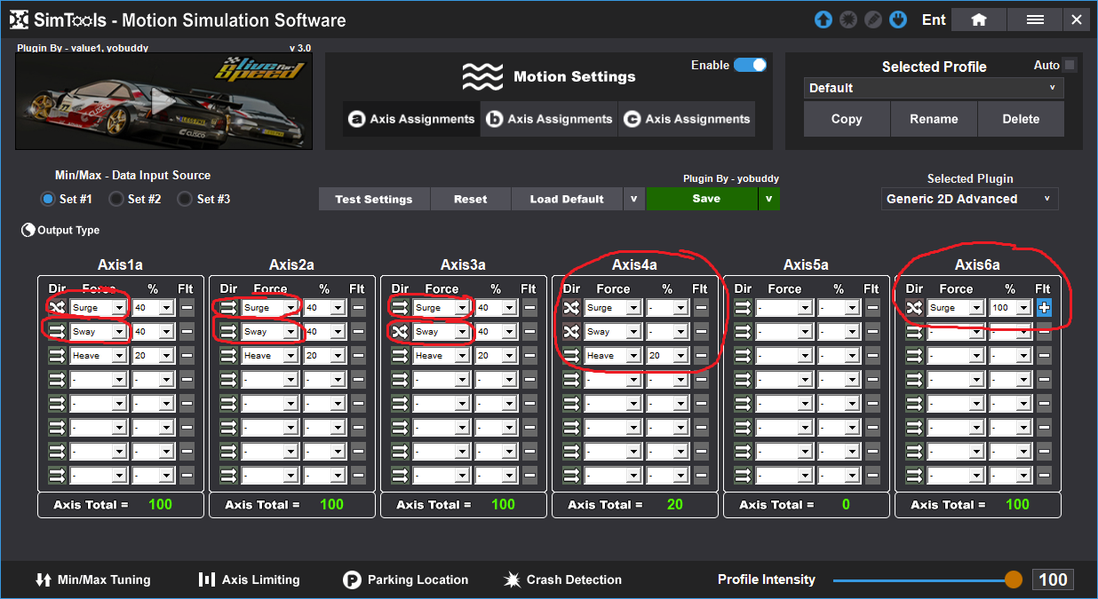

    The Dir being checked or not determines which way each axis moves.
  14. yobuddy
    5,261
    48,990Coins
    +5,076 / 18 / -0
    Please click here and make sure all 4 corners are working as expected.
    (don't sit on the sim or anything for the is, as its going to move one leg at a time.)
    Please let us know what you find out.

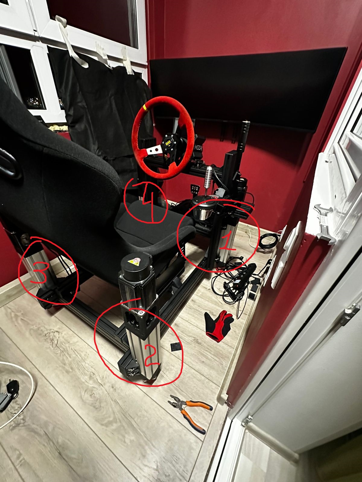

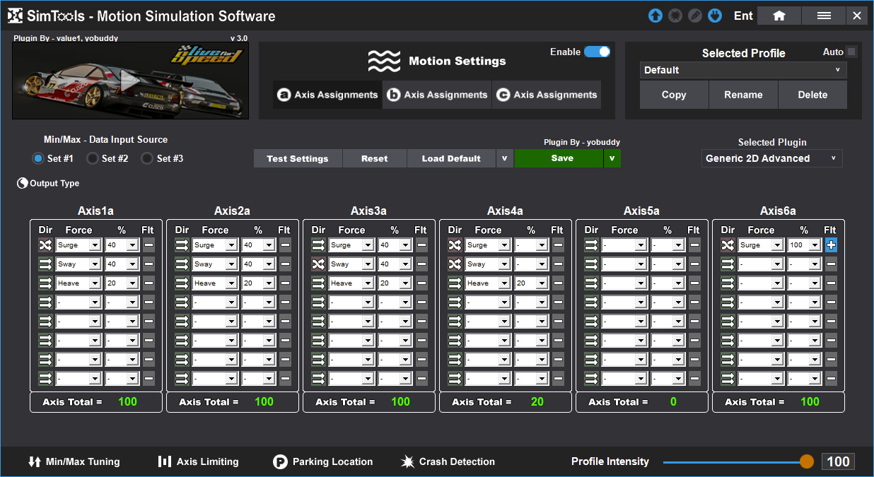

  16. yobuddy
    5,261
    48,990Coins
    +5,076 / 18 / -0

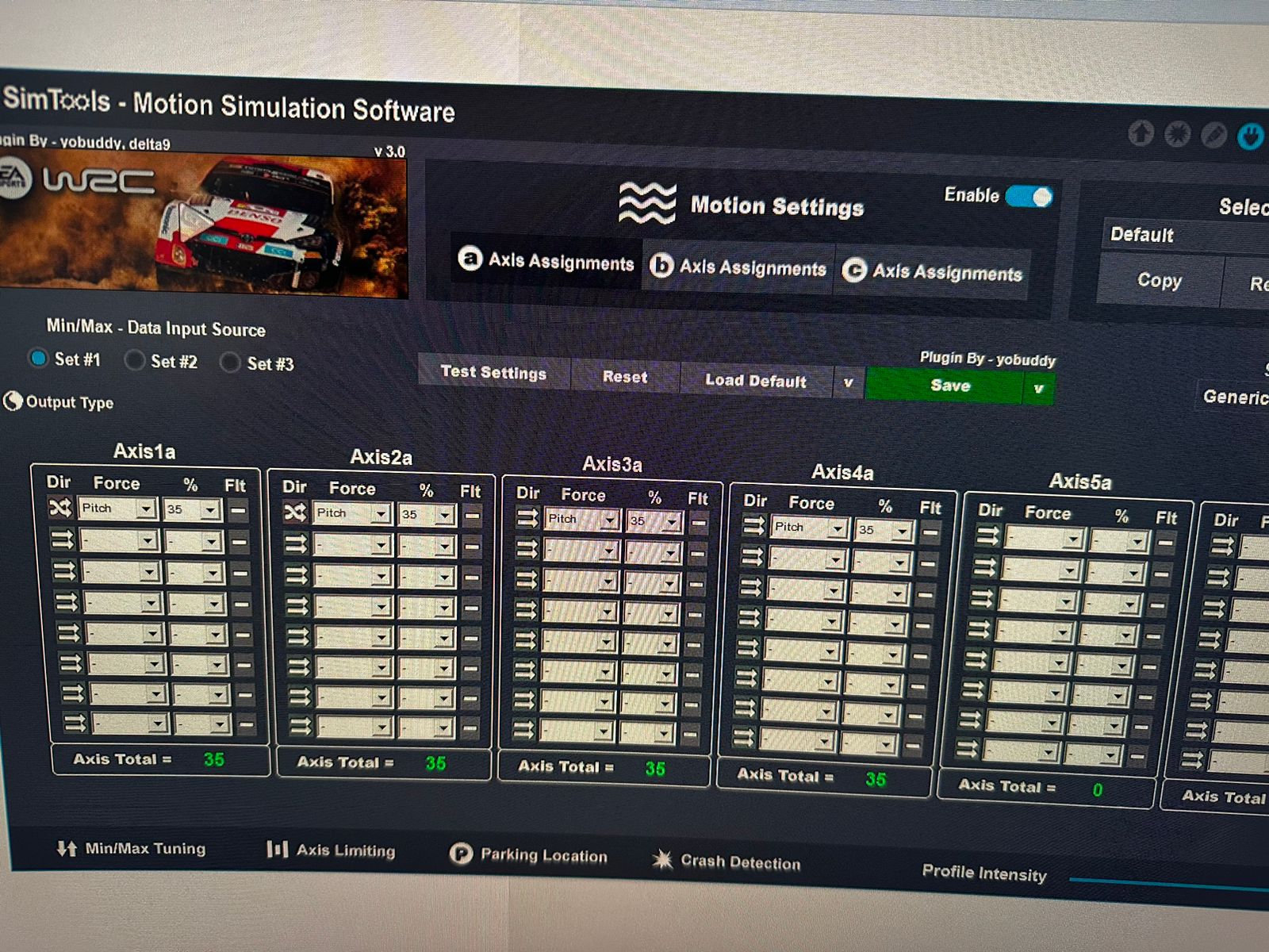

    Then you just need to figure out your axis assignments is all.
    Please help me identify what axis1a, axis2a, axis3a and axis4a is (front right, front left, rear right, or rear left)
    Once i know what each one refers to I can help you more.
    Edit - I didn't see the pic you attached.
  17. yobuddy
    5,261
    48,990Coins
    +5,076 / 18 / -0

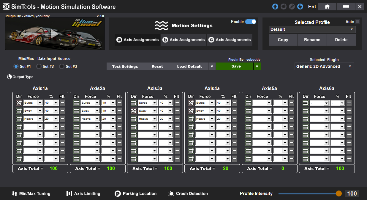

    Please try this and click test settings
  18. Danila-686
    Danila-686 New Member
    Nov 27, 2023
    24
    124Coins
    +1 / 4 / -0
    3DOF, Arduino
    set it up right like this ? Pitch Roll ?
