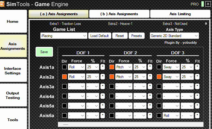

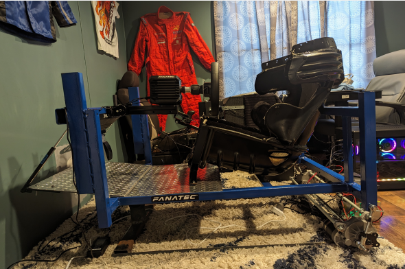

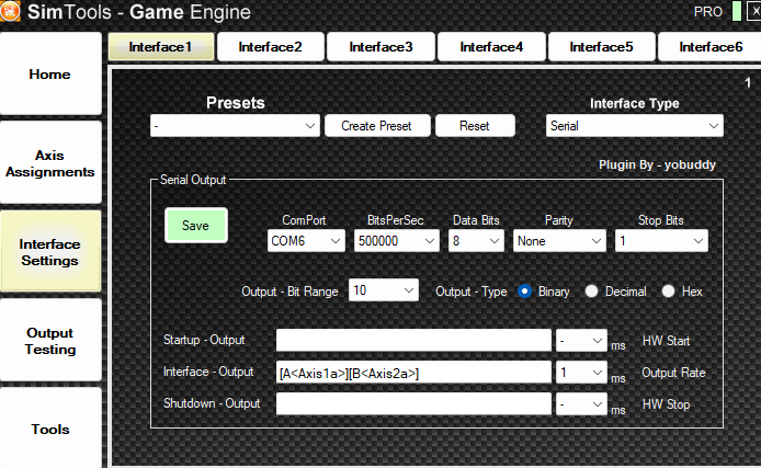

    I have a 24 volt wheel chair motor rig, That works, But i have one problem, the motor on left spins one way and the one on right spins the other way. I have tried to swap the black and red wire around on one of them, and then that motor just spins round and round till I unhook it. I was wondering if someone could tell me what I need to do to fix it? Thanks for any help! Screenshot 2024-07-14 113009.png

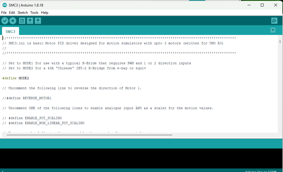

    Thanks for your help, Here is what I have

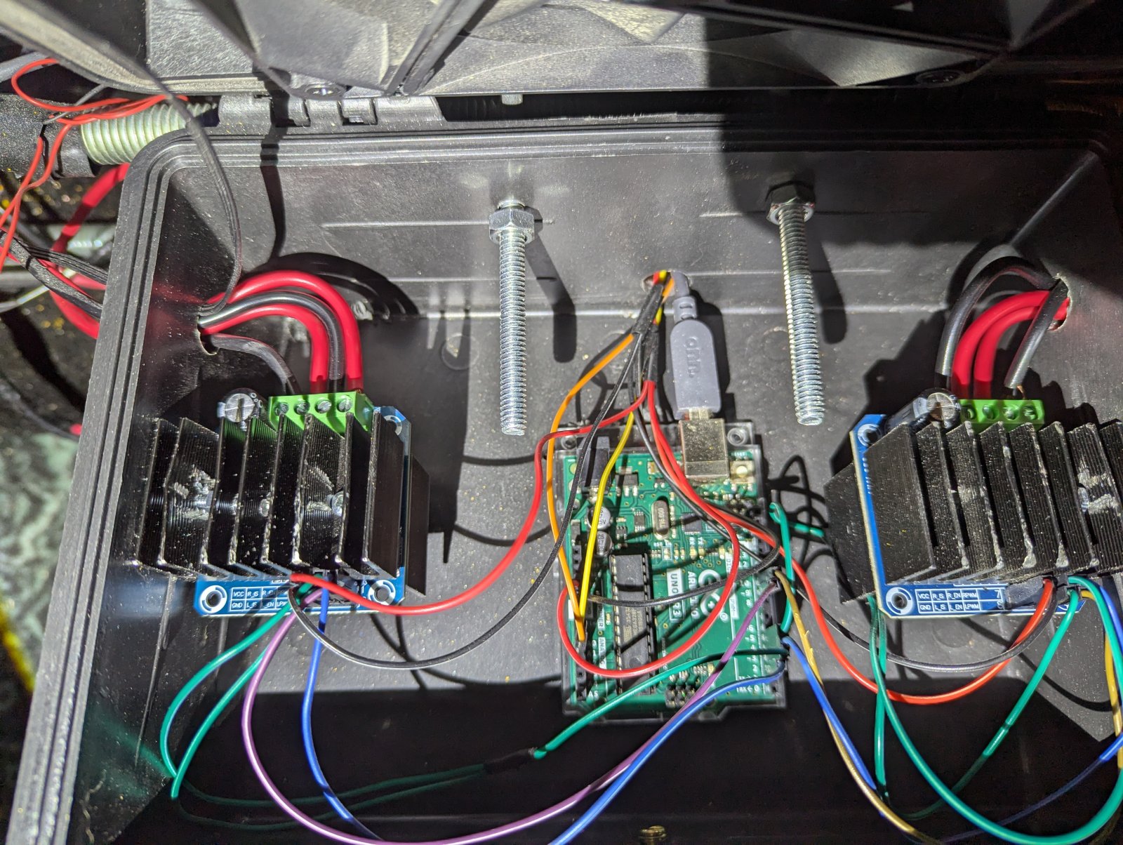

    2 IBT2 BTS7960 43A Dual H-Bridge Stepper Motor Drive

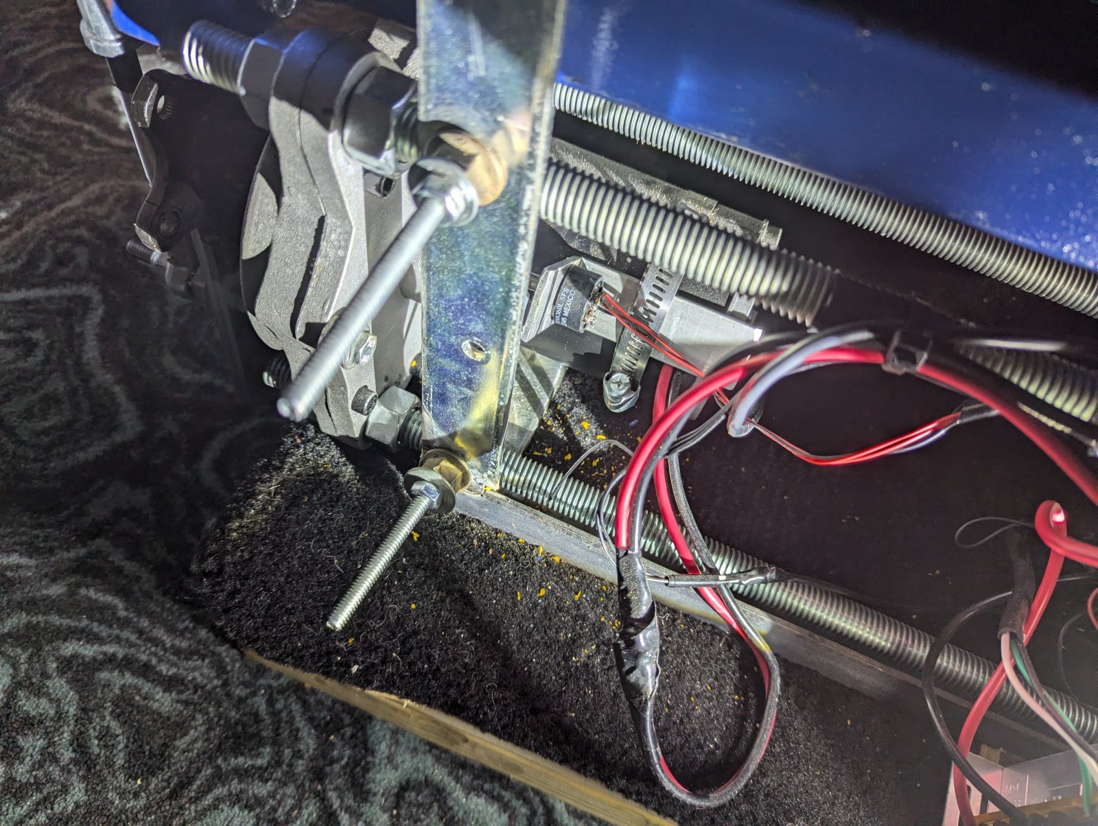

    2 Jazzy Wheelchair Gearboxes Motors Large Rc Lawnmower Robotics 12-24vdc Electric
    1 Arduino Uno REV3

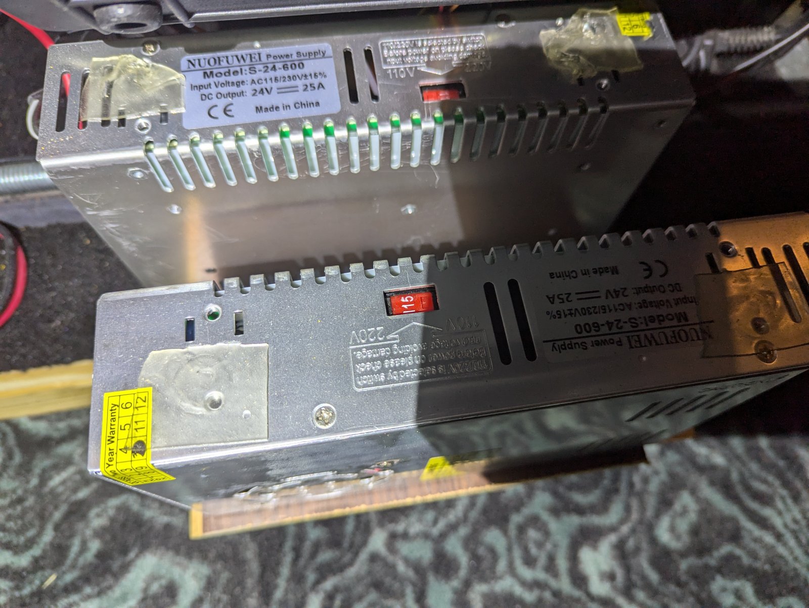

    2 DC 24V 15A 360W Power Supply Universal Regulated Switching Transformer Adapter

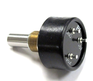

    2 potentiometer 6127v1a360l5fs
    Screenshot 2024-07-14 125737.png Screenshot 2024-07-14 125513.png Screenshot 2024-07-14 125232.png Screenshot 2024-07-14 125258.png PXL_20240714_194256402.jpg PXL_20240714_194422701.jpg PXL_20240714_194329404.jpg Screenshot 2024-07-14 132421.png

    Ok, are both engines working properly in SMC3Utils ? for example can you run Sine mode ?
    If so, you need to change the direction of movement in Simtools is the only way. Ceckbox "DIR" in the pictures you showed
    I unfortunately use FlyPtmover so I didn't have to deal with Simtools :(

    Even in simtools one motor goes the wrong way
    20,805
    146,678Coins
    +10,833 / 53 / -2
    As noted the DIR being checked orange or not determines which way it goes, so reverse DIR for the misbehaving motor.
