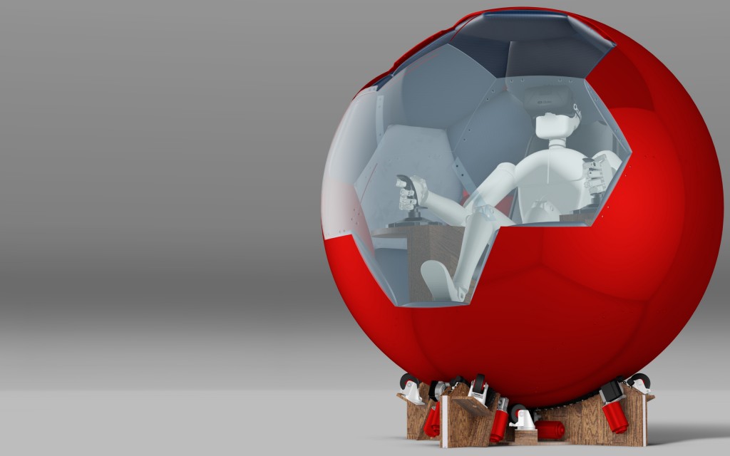

    Hi All
    New sim project for a DIY motion sim
    http://www.feelthree.com/
    regards Terry

    That's ambitious!

    If it worked I imagine it would be cool for flight sims, but not so much for racing.

    in the past, a member has already made a simulator in a sphere
    I did not find image
    21,042
    147,950Coins
    +10,882 / 54 / -2
    Do you recall how it was driven? I would think a sphere gives pitch and roll but lacks heave and bump type simulation.

    The lack of heave and bump would be provided by a good motion profile with low numbers in the " Tuning centre" and in "Axis Assignments". This is assuming that the sim is well balanced.

    Looks comfortable. Definitely the winner for a design-furniture contest...and yes, very ambitious, but not so bad at all.

    Thanks for the kind words guys.
    Heave will be an optional add on once the base unit is working and there is plenty of room for tactile transducers.
    I'm also running a raffle on the site to help drum up support for the Kickstarter, so put in your name and you can win one!

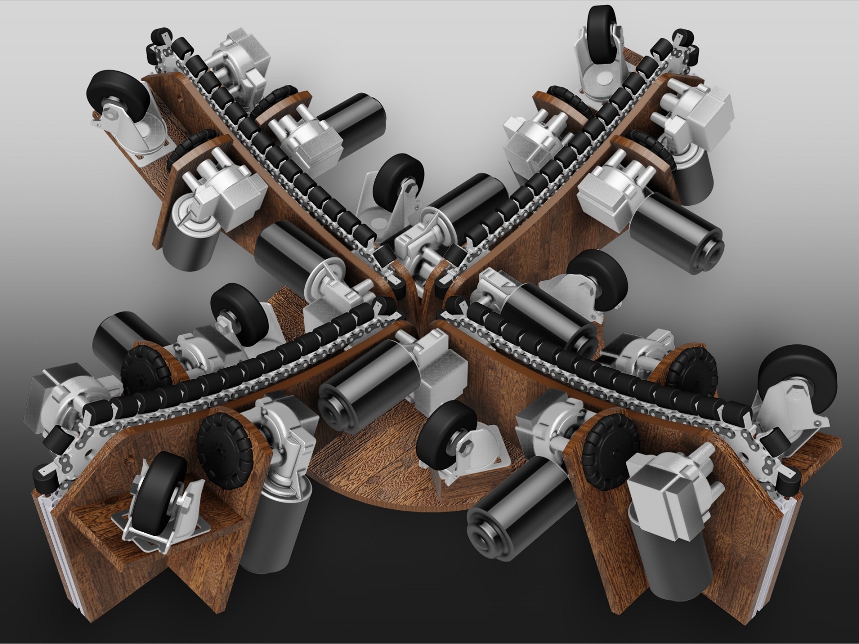

    Yeah, it's a good idea. Now I'm sure the panels are affordable I've started looking more at the motors and there are a million options.

    2DOF, 3DOF, DC motor, SimforceGT, 4DOF
    Ciao @traveltrousers
    Una piccola descrizione sarebbe gradita della foto che hai messo:)
    Cos'è una trasmissione a catena con rulli... e come funziona?
    Puoi spiegare anche cosa sono i trasduttori tattili?
    Hello @traveltrousers
    A small description of the picture would be appreciated that you put :)
    What is a transmission chain with rollers ... and how does it work?
    You can also explain what are the tactile transducers?

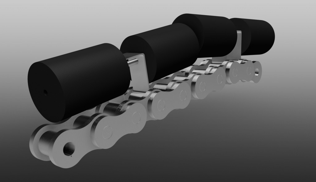

  13. traveltrousers
    traveltrousers Active Member
    Jun 5, 2014
    115
    Timbuktu, Tombouctou, Mali
    890Coins
    +87 / 1 / -0
    Um, sorry :)
    It's an idea to rotate my sphere, instead of using omniwheels I mount a series of rollers to a regular chain, which massively increases the traction for very little cost...
    A tactile transducer is a speaker that doesn't produce noise but rather low fequency vibrations, such as a 'buttkicker'.

  14. -kevin-
    -kevin- Fast e Furious
    Apr 6, 2012
    249
    Termo Tecnico industriale
    128Coins
    +175 / 1 / -0
    Ah.. quindi sarebbe una buona soluzione e anche economica.:thumbs
    Mi sà che da un pò di tempo mi sono dimenticato come si fà la ricerca su google.... buttkicker :grin
    Però non vedo come farai a simulare il sollevamento e l'urto con un trasduttore tattile..:confused: non credo che si ottiene la stessa sensazione.. va bene per avere le vibrazioni del cambio o del motore ma non credo per il sollevamento ed urto questo almeno e quello che penso io.;)
    Ah .. so it would be a good solution and also economic. :thumbs
    I knows that some time ago I have forgotten how to search on google .... Buttkicker :grin
    But I do not see how you're going to simulate the lifting and collision with a tactile transducer ..:confused: I do not think you get the same feeling .. okay to have the vibration of the gearbox or engine but do not think for lifting and impact and this at least what I think .;)
  15. traveltrousers
    Jun 5, 2014
    115
    890Coins
    +87 / 1 / -0
    Yes, but heave motion is 'expensive' as you need powerful motors to lift the platform. I will add this as an optional add on when the platform is successful.

    I've been working on the base concept.
    I will probably add a couple of omnichains to control yaw too...

    It certainly is an interesting approach, do you plan doing a working model prior to a prototype?
  19. traveltrousers
    Jun 5, 2014
    115
    890Coins
    +87 / 1 / -0
    It will probably be several.... I guess I need to lock in the design first :p
