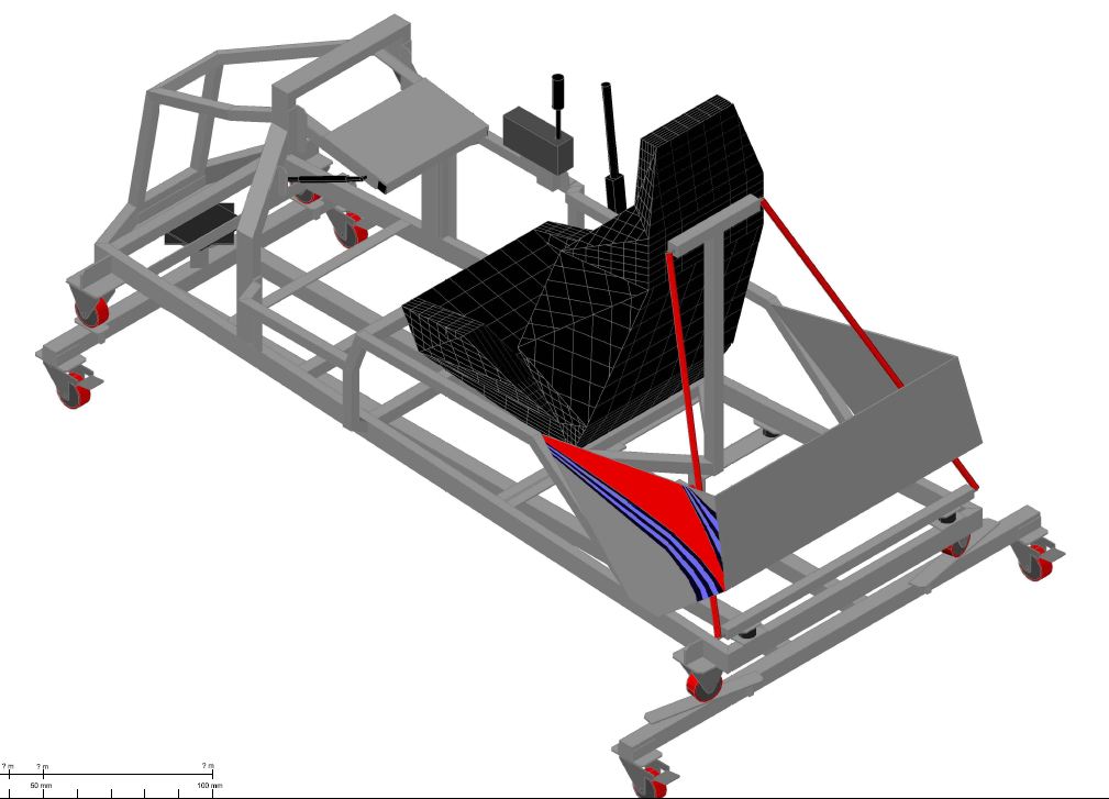

    Hi guys, new to the forum, looking to build a SEAT MOVER 3DOF for racing and little flying,,
    Been studying very hard last few days and decided that this will be a go for my use:)
    Want to use aluminium profiles for frame and 3* SCN6 acurators and SimTools.
    As there is waaaay too much of information here, i would really appreciate links to your builds like this to gather, little inspiration:)
    Planning to run on triple 40" screen, would love to do 12K, but seems unreal for some "normal" bucks at the moment (maybe in march the GTX1080Ti will be released it will be possible?) - but is that really worth it over Full HD? No way i can try it myself anywhere around:(
    And one more thing, can you please confirm my "shopping list" is complete, or am i missing something?

    3dof platform with SCN6 sound weird to me ! you should add a plan of your project . I think Scn6 actuators are not enough strong to lift to much weight.

    3 DOF is 2 at the rear and 1 for traction loss i imagine in this build. Are You building a seat mover type?

    But at the moment i need to know - am i missing anything in my shopping list to build this? What do you guys say on design´s posted previously?

    I think its all there. actuators, ends, wiring kit, power supply and sim motion.
    you can do it a lot cheaper if you dont use the simmotion and use 3x usb boards but you have to do your own wiring. I made all my own cable and bought the connectors from farnells as frex refused to tell me what type they were and only offered to sell me ridiculously over priced cables. one of the connectors from frex worked out at £17 with 200mm cables on it. I must of got 60 plastic connectors and about 3 or 400 various pins for about £25 from farnells

    Only i switched from SCN6 40kg to SCN6 20kg, for money save, from i´ve read it should be more then enough.
    Just not that sure in this dimensions on picture, anybody mind to provide me with correct numbers for my setup - SCN6 20kg?
    And one more thing can i use this Frex pivot instead of U Joint under seat?

    I do not think the pivot frex can give the same result as a U-joint.

    that pivot is just a mount to fit an actuator onto with the rod ends. you will still need a uv joint

    Ok good, i did not knew that, thanks for info! So i will take 2 of those pivots to mount acurators..
    Nobody can help with the dimensions on picture?:(
