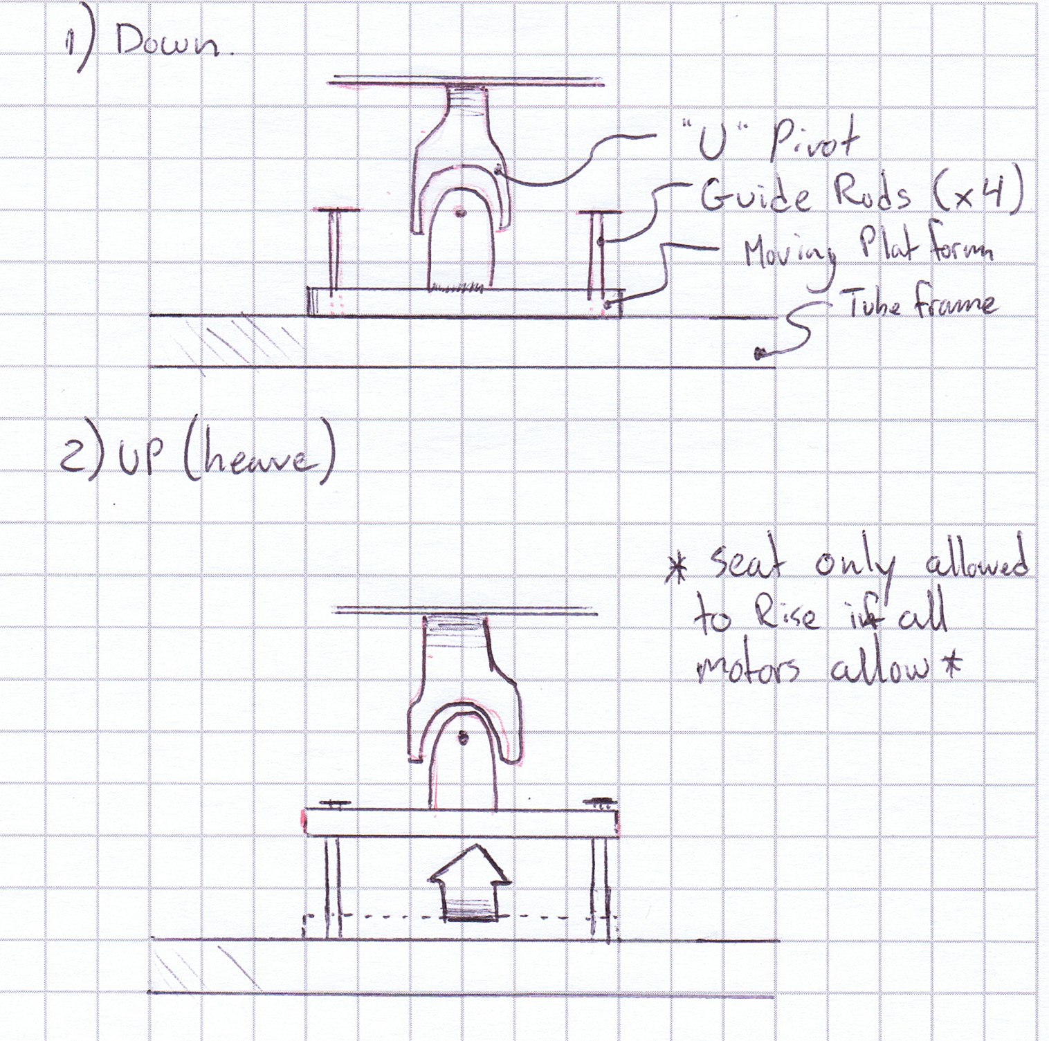

    I have been looking around for a week or so trying to get as much information as possible be for even designing a preliminary racing ( only) rig. I have come across numerous 2dof and 3dof diy rigs that seem to all share the same design principles when it comes to placement of worm gear motors.
    What I really haven't seen are any rigs that mimic the set up of a real car. What I mean is basically a frame with 4 motors ( one in each corner similar to a dbox?). To me this seems logical as it would place the motors in relatively the same location as a real cars tires and shocks. Is there a negative to this sort of setup? Is it considered overkill or something to have 4 motors instead of just using 2 since its basically a glorified seat mover?
    One thing that seems to be a concern when designing a rig is how to handle heave ( up and down jumps, kerbs ?). I thought if you were to use a 4 motor system to help lift the rig up and down that may help with the heavy loads? That brings up another issue. Now all 4 motors are supporting the weight of the entire rig and driver 100% of the time ( as opposed to a U joint supporting most of the rig).
    What I was thinking of was using a support platform with a U joint under the rig that would help take stress off the motors during normal operation. Then when the rig needs to heave up and down, the support plate would be able to move up and down via some guide rods. I did a pretty crude drawing below. I'd love to hear any advice on what I've come up with. Please excuse the crudity of the drawing. I didn't have time to color it or draw it to scale... :D
    I was thinking the guide rods would help to only allow the rig to move up and down when all 4 motors receive the 'heave' code. The rods would keep the support plate from rocking during surge, sway, etc. Springs could be added to the guide rods to help the motors lower or raise the rig.

    I covered three basic approaches to heave here, which @Pit added some detail to: http://www.xsimulator.net/community/threads/3dof-for-the-motion-flight-simulator.6281/#post-69812
    Basically what you are suggesting is similar to a Dbox system. If the mechanism is strong and fast enough you can do away with the U-joint and control motion with the actuators. The downside is finding those fast and powerful actuators at a reasonable cost.
    While important heave is less so for racing than a flight sims and operates at a far higher rate. I am not a hard core sim racer but plenty of members are and the designs you see replicated is because they work well, particularly for racing sims, and do a pretty good job at simulation including heave. That is because a simulator is a 'mind trick' that exploits physiological weaknesses to cover for the limits of physics, rather then trying to recreate actual forces: http://www.xsimulator.net/community/threads/needing-some-insight-to-start-design.6273/#post-69663

    While I agree heave for racing needs to be at a faster speed than for flight, I feel a need to strongly disagree that it is less important for racing, sorry! Of the three forces, heave is by far the most active since it is the one that provides the feeling of the road surface! While many 2dof rigs still incorporate heave into their profiles, doing so on axis that don't actually heave provides inaccurate feedback imho. After riding on a racing rig that properly reproduces heave I dare you to tell me it is less important than for flight! :grin

    My bad choice of words @BlazinH, I meant to convey an observation that many existing racing rigs here do not have a separate heave axis, not that heave is unimportant. A large percentage asking about implementing a heave axis are interested in it for flight, that is somewhat different from heave in racing. Of course all simulators are a series of compromises with their own strength and weaknesses.

    2dof, 3dof, 4dof - sometimes a question of philosophy but IMHO there is no doubt which dof we should use if you are a pure racer. In this case a 2dof is the best way to get the best immersion. Hard to believe but I can tell you there is so much fun driving the track trento-bodone in Assetto Corsa because you feel every laser scanned bump, you will be shaked like a long drink and feeling is insane. Most of the Pro Racers say the 2dof seat mover is the only one which gives you the best and real feedback from the track in comparison to a real race car.

    If racing is your game then a 3DOF with traction loss is the way to go and yes it can be a full frame with pedals. But by all means if you have the urge to experiment with designs then do so.
