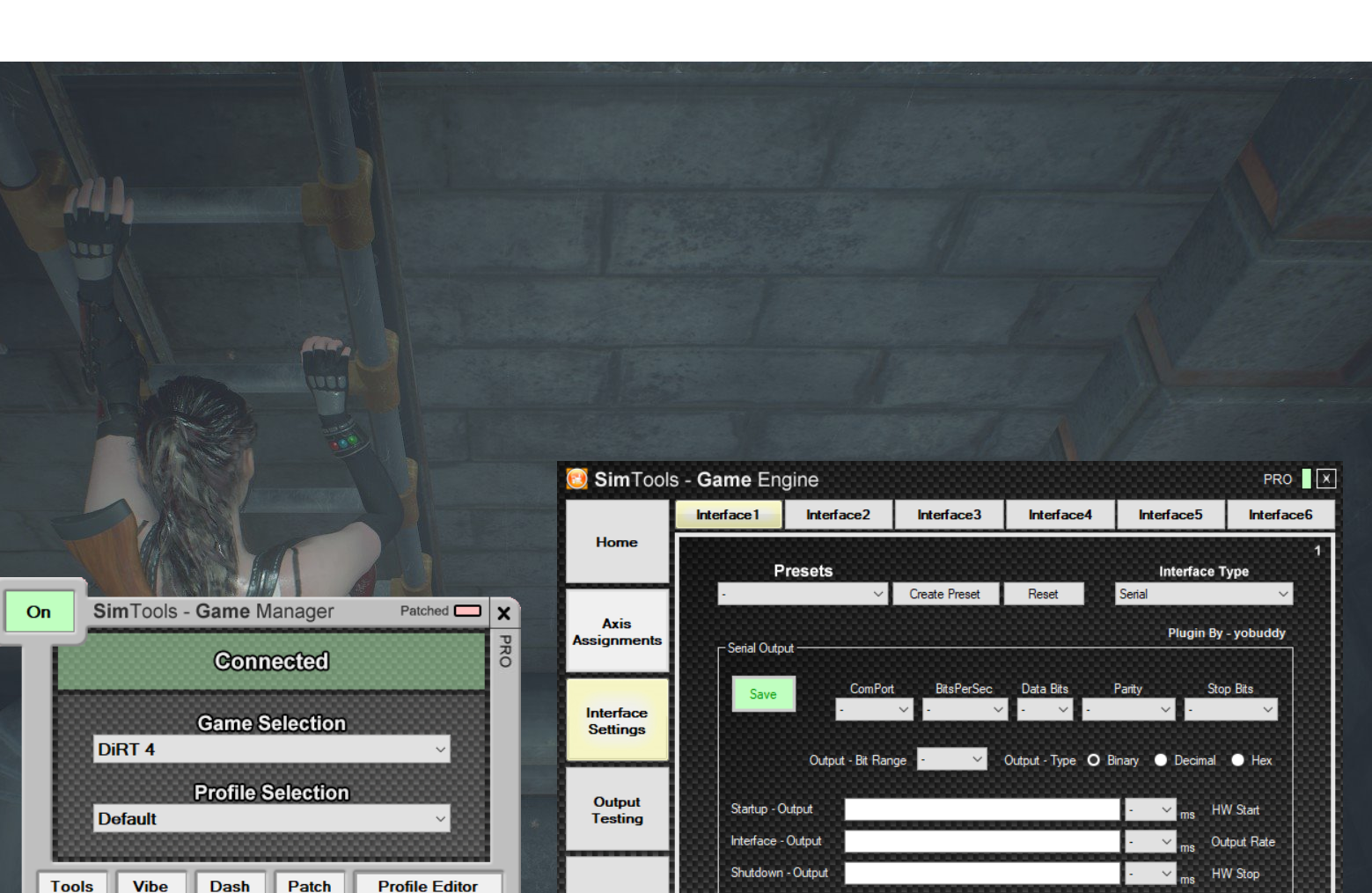

    Hi guys,
    I am trying to get Simtools working for my DOF Reality P6 but I am stuck here as there is nothing in the Presets dropdown menu for Interface 1 or any other interface as shown in the picture . I have installed all the plugins.
    in the tools menu there is a preset Installer i have looked in the axis presets folder but there is nothing for dof reality platforms can someone help?
    I cannot download any plugins from here as I received my license when purchasing the DOF Reality P6 from DOF Reality. Everything is working fine in SimRacingStudio.

    I have a similar issue, but on the AMC 'interface type'.
    The 'Presets' dropdown won't stick - I created a new preset to remove some of the output axis that are actuators I don't currently own - I only have 3 actuators so only need Axis1a, Axis2a and Axis3a.
    Seems the creation of a preset works, but when I choose it from the drop-down it always just defaults to the '-' default preset?
    Thinking this was just a software quirk, I clicked the preset drop-down arrow, then used my keyboard down arrow to highlight the new preset I created, then just click anywhere in the unused space of the Game Engine window, and now I can see the preset I created. If I mouse click on my created preset or hit enter on my keybord, it just goes back to the '-' default preset, so this workaround is the only way to see my created preset.
    Sounds good, right?
    Well, after I remove the axis I don't have, then click save, it seems that nothing has actually been saved.
    This happens for all presets, even the default.
    Here's a short video showing what happens:
    https://www.dropbox.com/s/blwtmfzt14xzl7f/Game Engine 2020-06-21 12-55-26.mp4?dl=0
    Appreciate some help.

    In the video the menus are not rendering, is that what you actually see? If so @yobuddy would need to have a look at that.

    I just watched the video, what is not captured in the video is what's in the drop downs - I can see this on my screen, but not sure why the screen capture didn't see that.
    Essentially any saved changes made to any preset do not stick, which I suspect has something to do with the inability to mouse click on a preset from the dropdown to select it.
    Instead you have to click the dropdown then use keyboard down arrows to select, but NOT press 'Enter' as it seems to do the same thing as a left mouse click and means that the default '-' preset is always the preset.
    Even the default preset will not save changes as I mentioned before.

  6. yobuddy
    5,282
    49,201Coins
    +5,093 / 18 / -0
    It always changes back to the "-" after the profile is loaded in the window below.
    It will not stay on the one you select, if that's what your expecting.

    Thanks for the explanation Dustin.
    Is there some important functional/technical reason for why the preset you choose to select isn't ever displayed like the norm for even the most basic programs out there?
    Or is it just one of those things that falls low on the to-do list - and understand that it's just a question born from curiosity and in no ways meant to be negative in any way. Your incredible passion and tireless effort in keeping SimTools what it is, is exemplary.
  8. yobuddy
    5,282
    49,201Coins
    +5,093 / 18 / -0
    The idea of the presets was to be able to save the current config, and be able to send it to a friend to load.
    It was a way to send something better than a screen shot if you will.
    For me anyway, once the preset is loaded, my thought is your done with it.
    If it altered every time you press save, it would make it hard to get back to where the preset started, should you decide to start over. (maybe think of them as save states)
    With the way it currently works, the preset is unchanged by you current settings, and can be reloaded at any time. (In my mind anyway, this is a pres-set group of working settings, a preset if you will)
