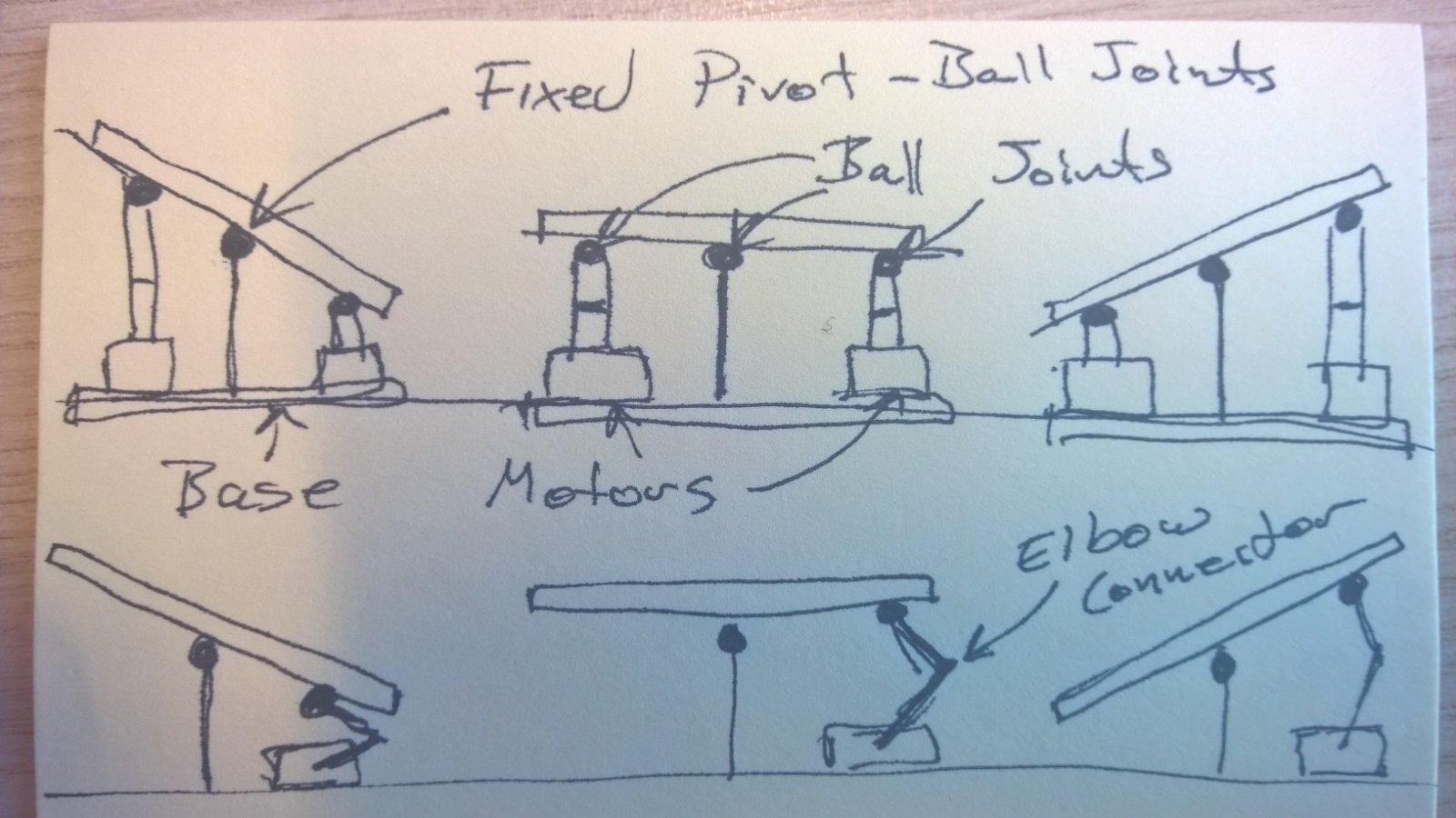

  13. X71
    X71 New Member
    Mar 24, 2015
    11
    Tarneit, Victoria
    114Coins
    2DOF, 3DOF, DC motor, 6DOF
    Wow, thanks for all the info everyone, very helpful.
    I certainly don't intend on rushing this and I'm looking to build a scaled down model first.
    With regards to starting I figure its best to KISS, so I think a simple platform might suit ... see attached sketch I quickly made.

  15. X71
    X71 New Member
    Mar 24, 2015
    11
    Tarneit, Victoria
    114Coins
    Well that's what I'm hoping you guys could advise me on. Fitting with your suggestions bsft I would say DC motors would suit that design.
    Just loosely thinking here but I would say the platform would need to support anywhere between 150kg to 170kg. I might just buy a PAGNIAN simulation frame and bolt it on top. I've also just noticed they have an add-on motion platform similar to what I've drawn for about $3k AUD ... :p
    I'd be hoping I could build one cheaper than that.
  16. noorbeast
    21,166
    148,682Coins
    +10,915 / 54 / -2
    DC with 60:1 would move it, though connecting above the COG instead of level with it would be better.

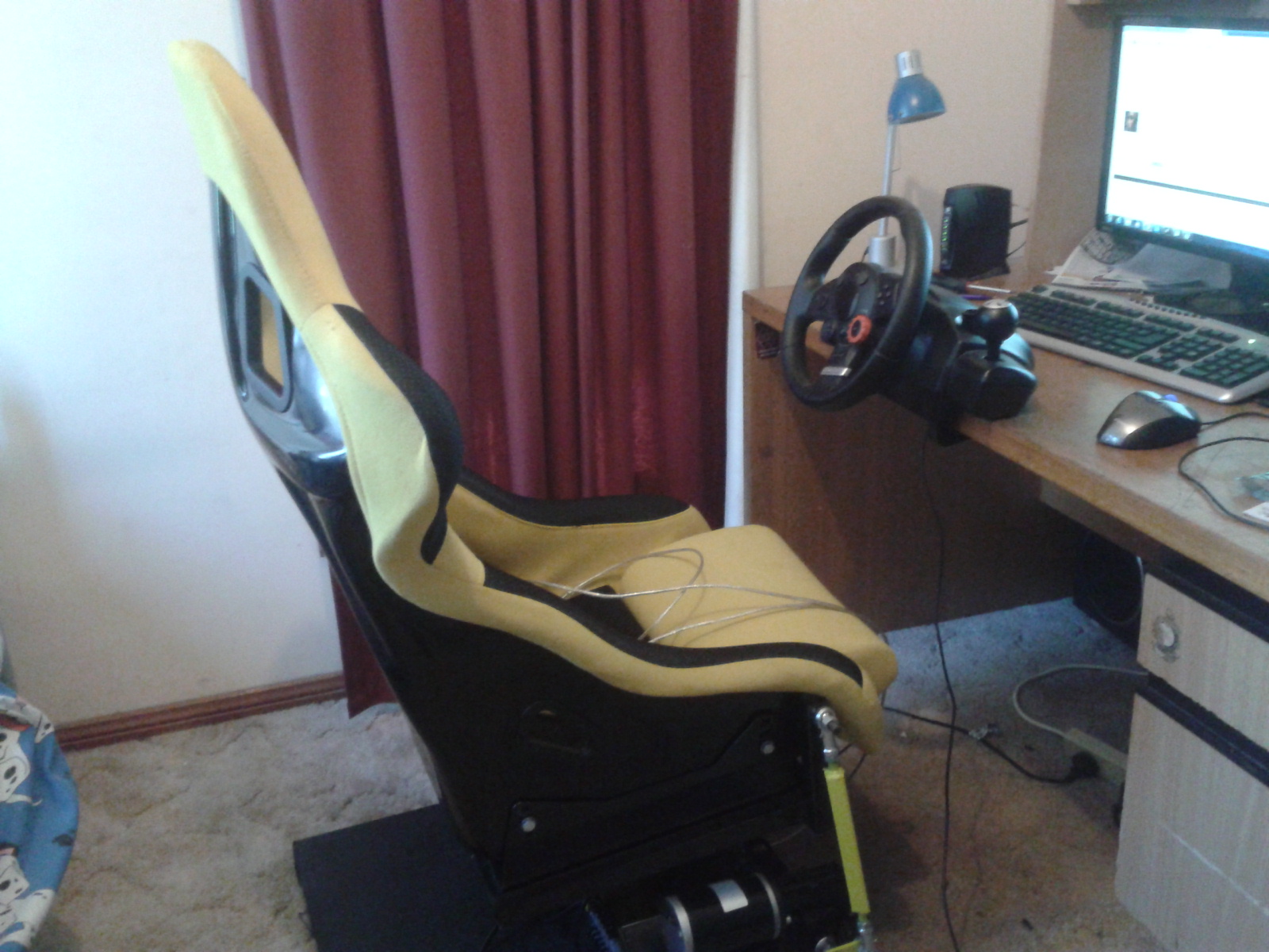

  17. bsft
    Balanced 2 DOF without screens on it feasible with 200 watt DC motors 60:1 gearboxes on then and JRK or Arduino - MM drivers.
    But are you looking at full frame or seat mover?
    150-170kg, just how much do you weigh?
    Pagnian seat mover motion yes , about $3k, will suit up to 150kg I am told
    This design with wider seat and frame to suit using 60:1 boxes on motors not 25:1, would suit up to 150kg driver. would cost about $900 in parts as seen in photo
    EDIT, as @noorbeast says, connect motors at shoulders at rear for seat mover or full frame, then again, if you do not weigh too much, like under 100kg, a full frame/desk racer motor mount design like noorbeasts will do ,or for for seat mover on its own, shoulder mount at rear ot desk racer mount.

  19. bsft
    Loose the screen and keep it static, balance it for you without screen with peripherals included for weigh balance.
    @noorbeast , you can advise further as you have all the goodies on yours
  20. X71

    Yeah I was thinking that the seat should be attached above the COG, so your suggestions confirm my thoughts.
    So for the motors, is there any particular brand / model I should look for? Where to get them in Victoria? Can these be sourced from old washing machines? ;)
