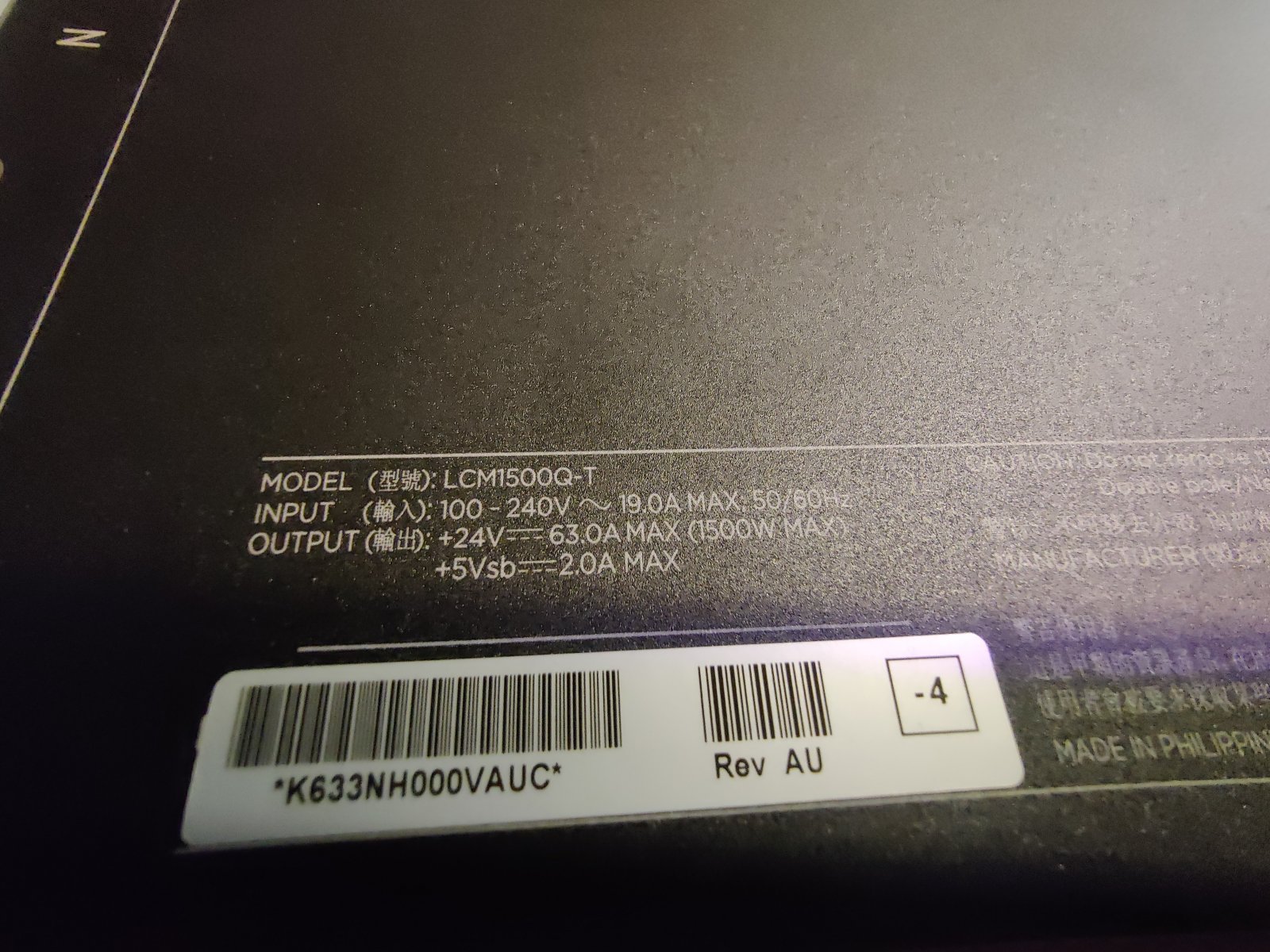

    Using 6 jazzy 24 volt wheel chair motors ( same as Dmax used on his 2 dof rig)
    Using 3 24 volt 63 amp 1500 watt power supplies
    6 ibt2
    And 1 Arduino? ( If I understand correctly this can handle 6 motors?)

    I was going to attempt to run all 3 psu off of 1 outlet and everything else off another.
    I daisy chained all 3 together and obviously it works,but there is no load.

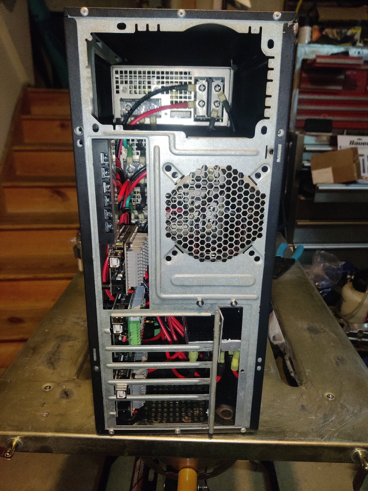

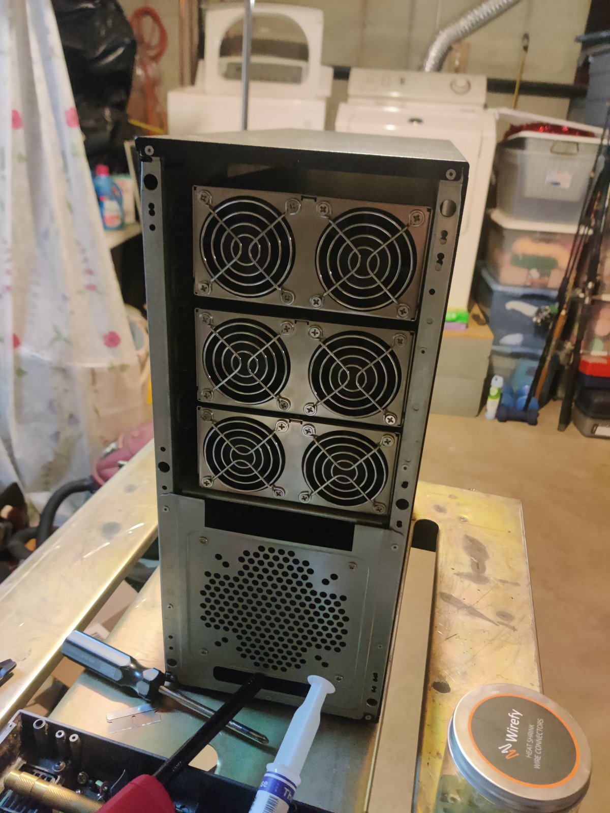

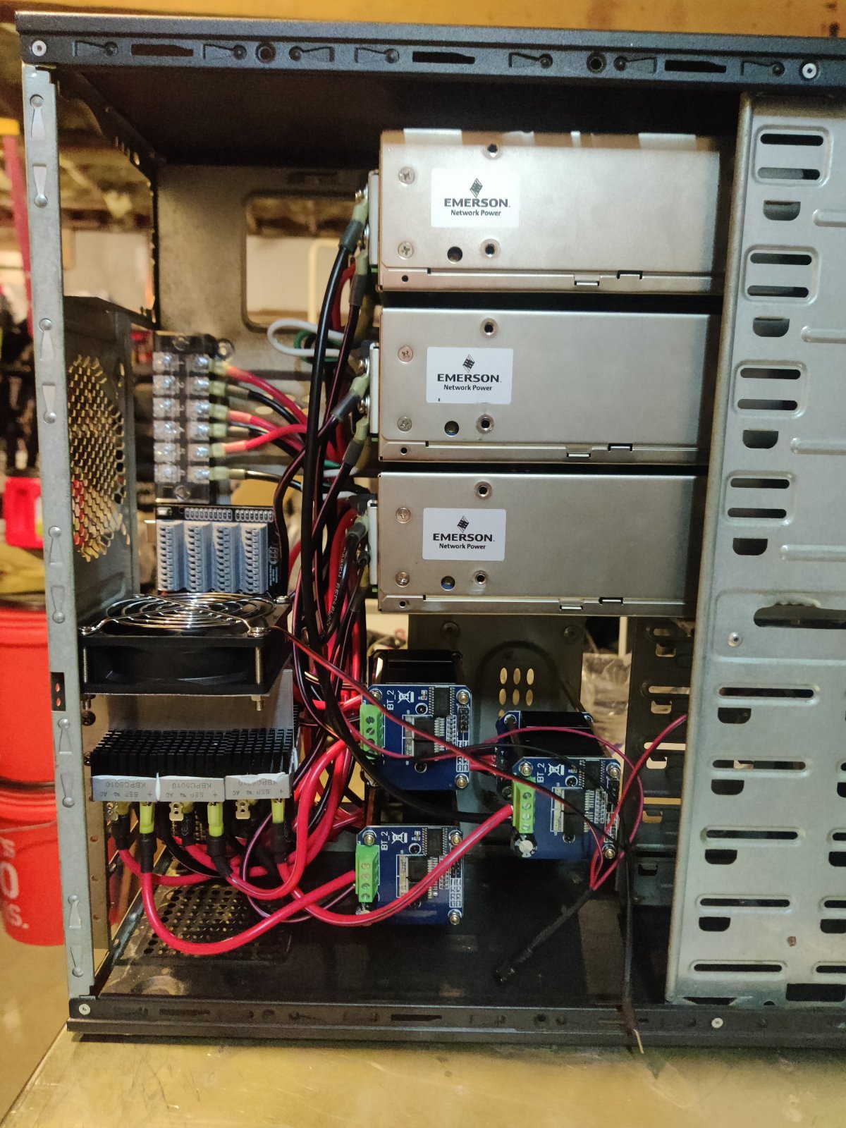

  6. Stevemannn
    Stevemannn New Member
    Mar 20, 2024
    20
    125Coins
    +15 / 0 / -0

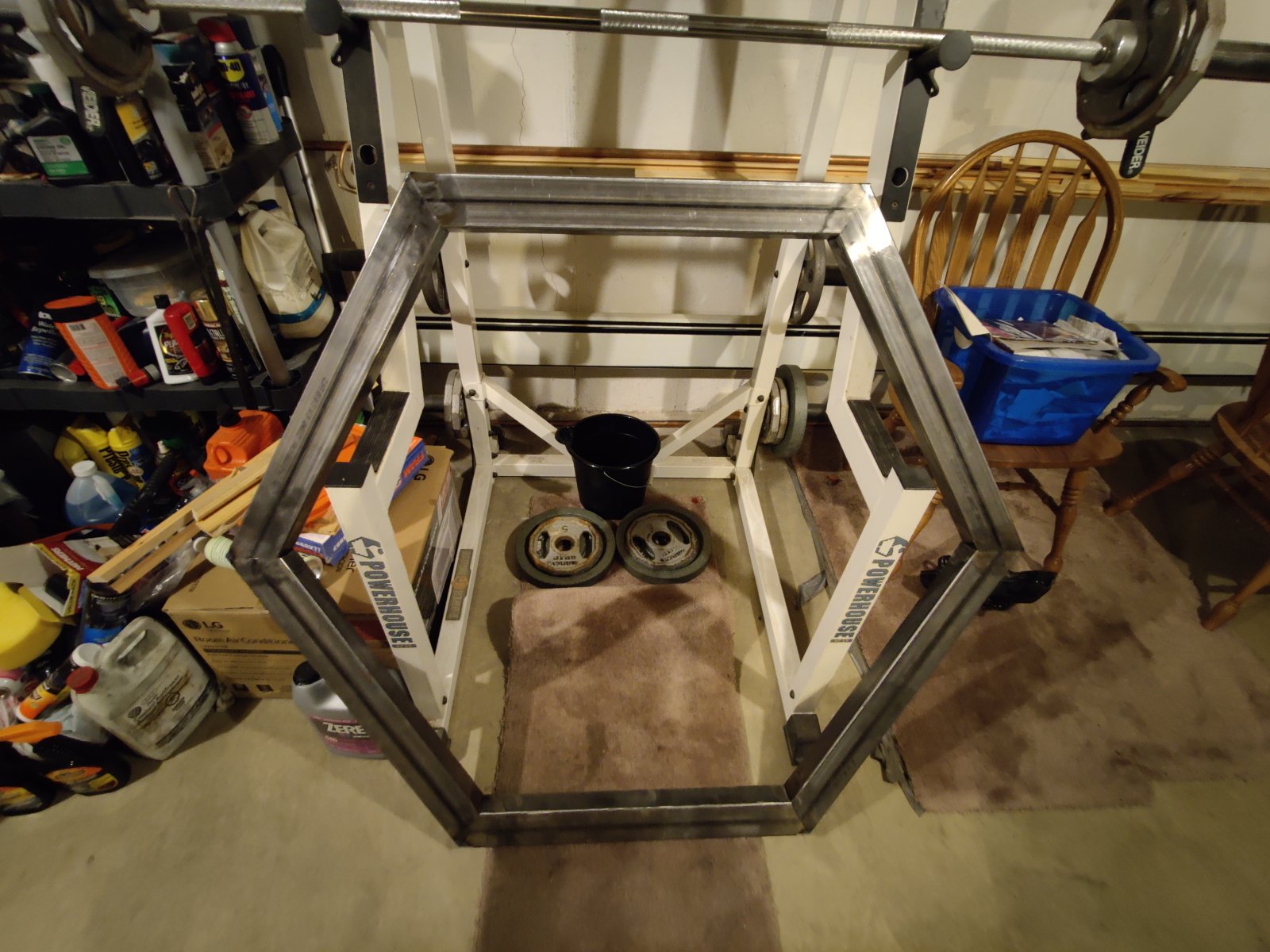

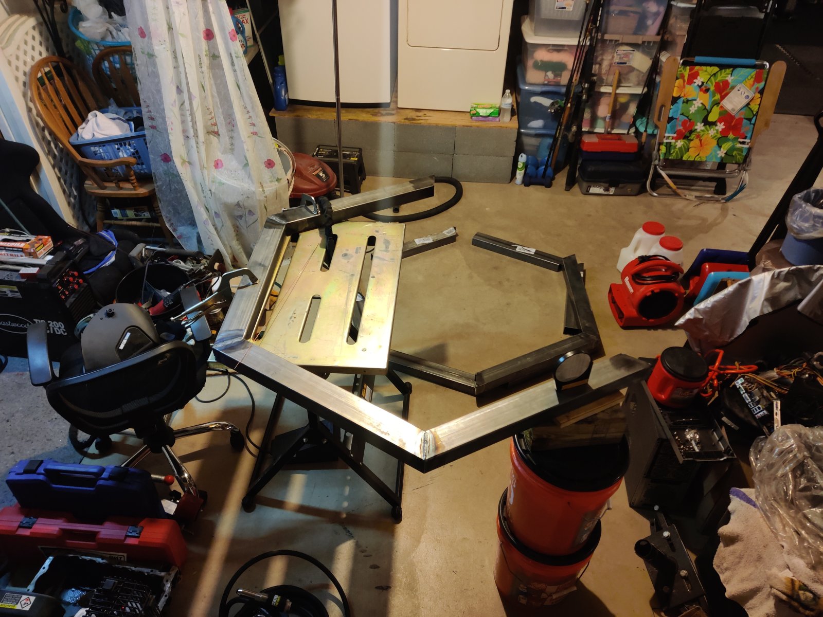

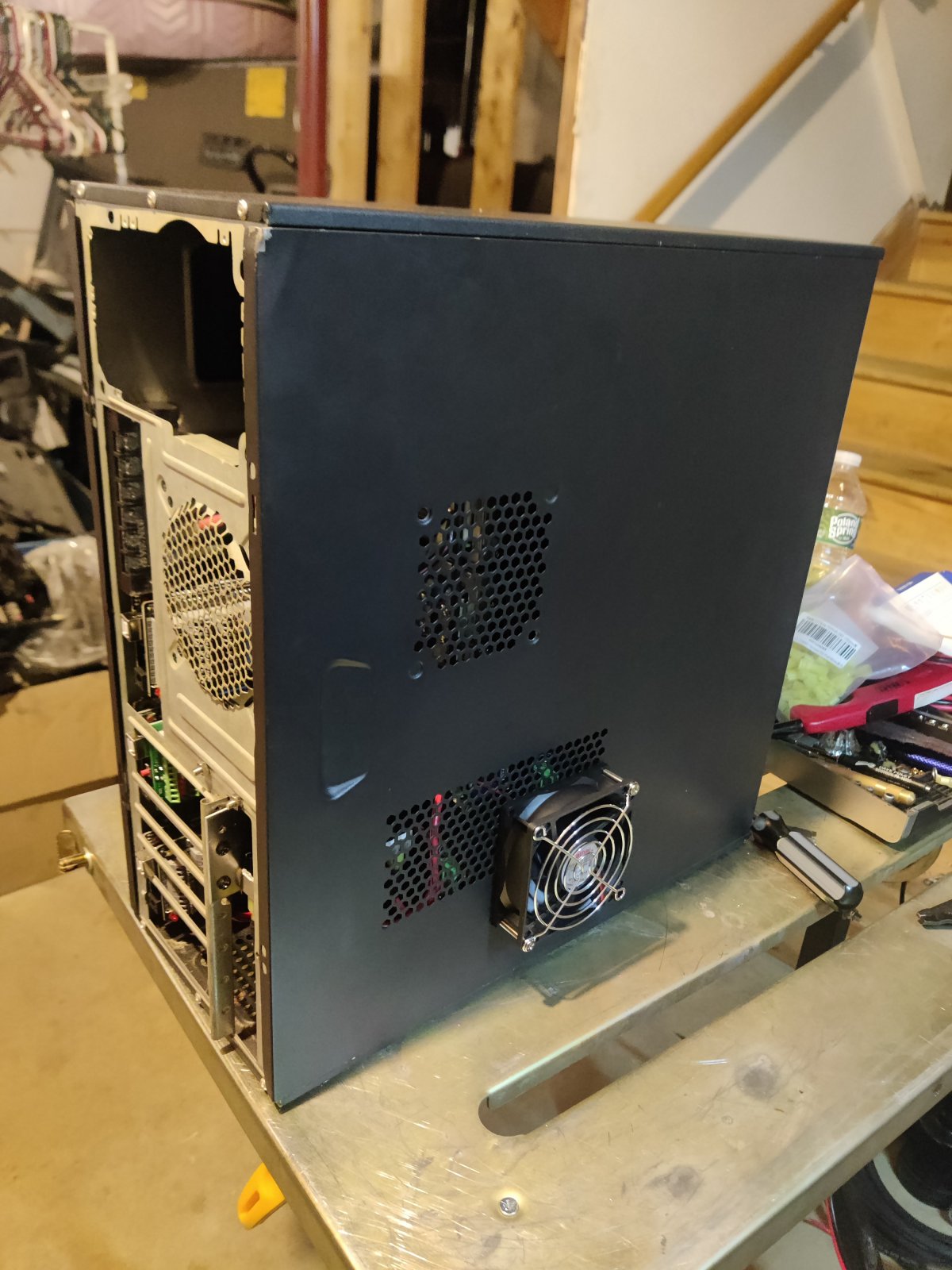

    Slowly been getting some work done, built the lower frame, but that's not entirely done, mainly working on the electrical side of things, turned my psu's down to 21 volts, which is as low as it'll go.
    ( trying to fit everything into an old PC tower case which is a bit harder than I imagined ,but tons of fun lol)
    Doing some reading here and there, and something popped into my head.
    When is it necessary to ground something?
    I'm new to all of this,but I obviously don't want to kill myself haha.
    All 3 power supplies are in the tower, all grounded through the outlet.
    I have all the ibt2s and Arduinos and diodes in the same box along with the cooling fans.
    This is a metal case, should I run a ground wire from the case to the power supply?
    What about with the frame itself when it's all together?
    Or am I overthinking this
    Some pics of what I've got done so far.
    IMG_20240602_211102.jpg IMG_20240514_172922.jpg IMG_20240527_184224.jpg IMG_20240526_211442.jpg IMG_20240602_210603.jpg IMG_20240602_211116.jpg

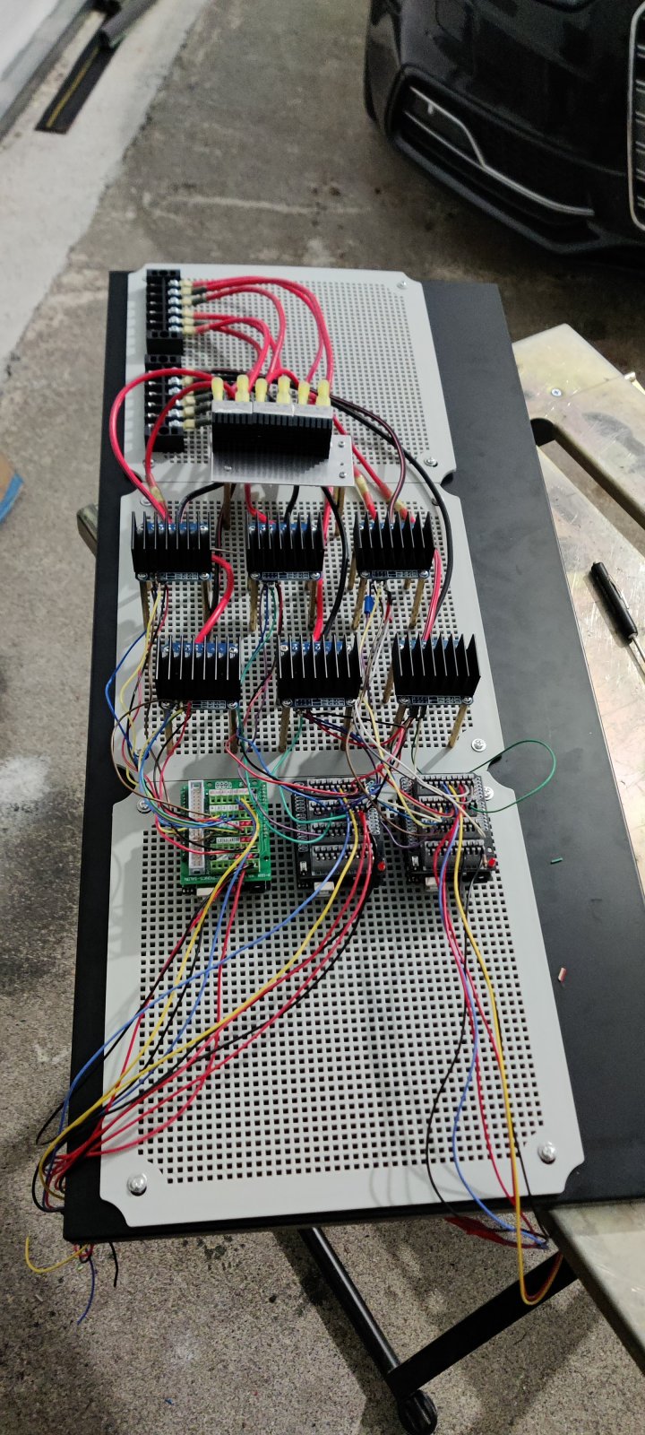

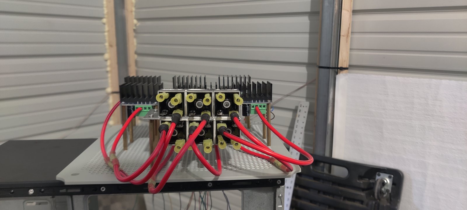

  8. Stevemannn
    Mar 20, 2024
    20
    125Coins
    +15 / 0 / -0

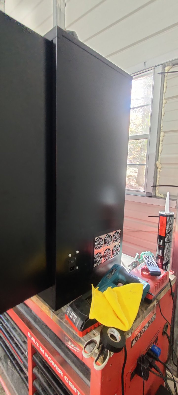

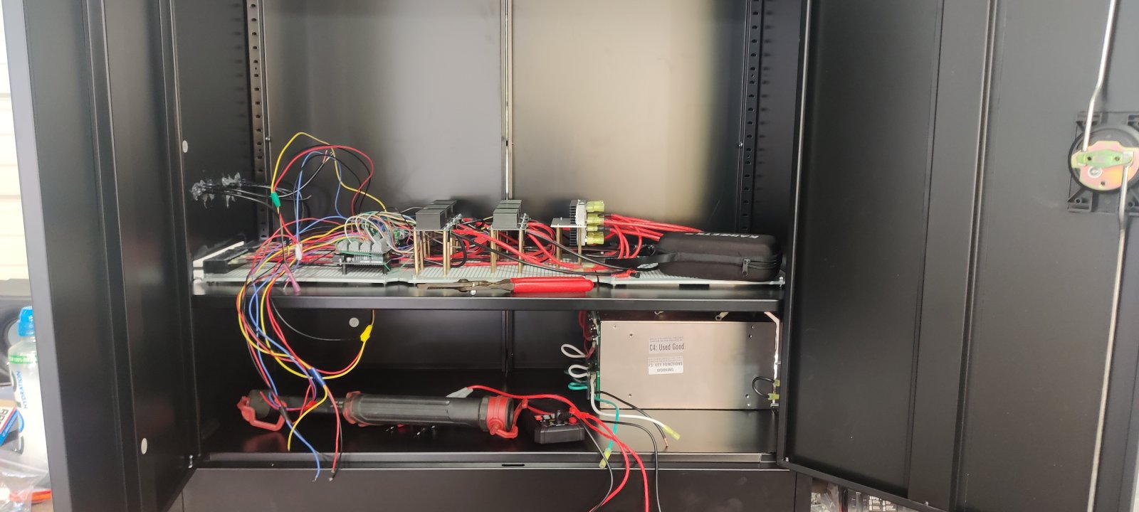

    Still working on it. Took a break from it for awhile.
    Then had trouble getting everything to communicate correctly, found out a few wires were shorted out, causing two Arduinos to malfunction.
    Ended up taking everything apart, and now putting everything into a cabinet.
    Just way too tight and hard to diagnose issues inside that little PC case.
    Currently working on it as we speak. Spent the last 3 days getting this together
    IMG_20241020_144156.jpg IMG_20241020_144226.jpg IMG_20241020_144156.jpg IMG_20241020_144156.jpg IMG_20241020_144226.jpg IMG_20241020_144245.jpg IMG_20241020_144156.jpg IMG_20241020_144226.jpg IMG_20241020_144245.jpg IMG_20241017_194202.jpg IMG_20241017_201226.jpg IMG_20241016_165901.jpg

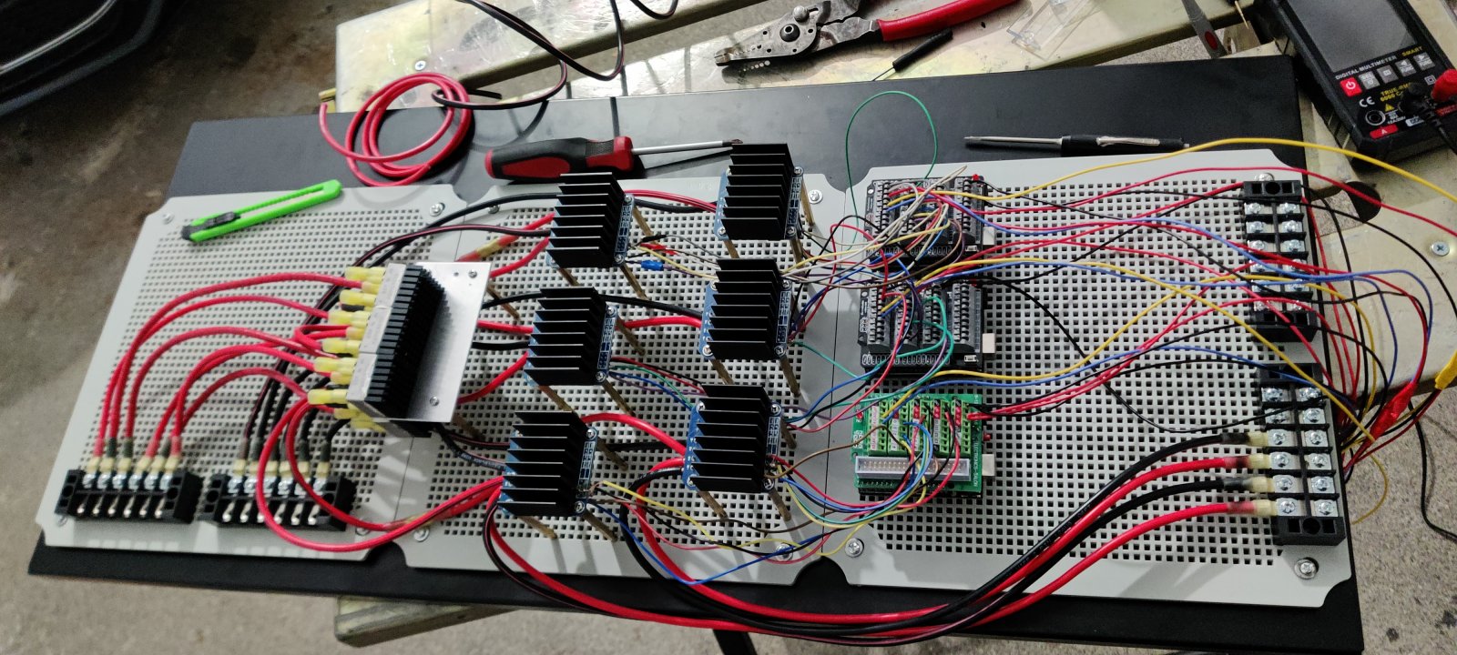

  20. Stevemannn
    Mar 20, 2024
    20
    125Coins
    +15 / 0 / -0
    Well small little update.
    Found out my 1 Arduino definitely died.
    It turns on,but not recognized by the PC, which I'm honestly not surprised. I'm surprised it even turns on haha.
    Spent about 2 hours diagnosing why my motor would only spin 1 way.
    Tracing wires, ohming things out, checking voltage etc.
    Well apparently you need to have both potentiometers plugged into your Arduino at the same time. I only had 1 plugged in, and for some reason the motor would not spin the other way.
    (I'm not exactly sure why this is, kind of doesn't make sense to me)
    But that was a simple fix, too bad took all my free time to find it lol, but I'm happy, I got 1 motor to actually talk, and work correctly.
    Hopefully the other 5 go smoothly.
    A win so far in my book.
    Sorry for the clutter and the mess, things are just mocked up for now to see if things work correctly,before I go any further.
    I will probably try to get all 6 to work correctly, then tear everything apart and paint it, then build the tie rods and the rest of the frame afterwards.
    Just seems easier to access everything now.
    I will most likely have to re calibrate every potentiometer afterwards,but that's fine. Much easier to rule things out ,in the state that it's in.
