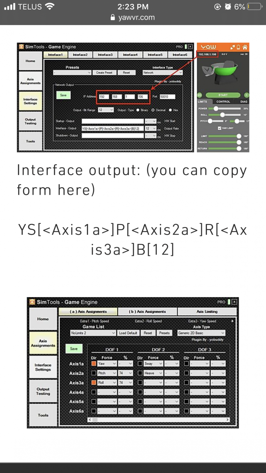

    I believe theses are the basic YawVR interface settings for SimTools:

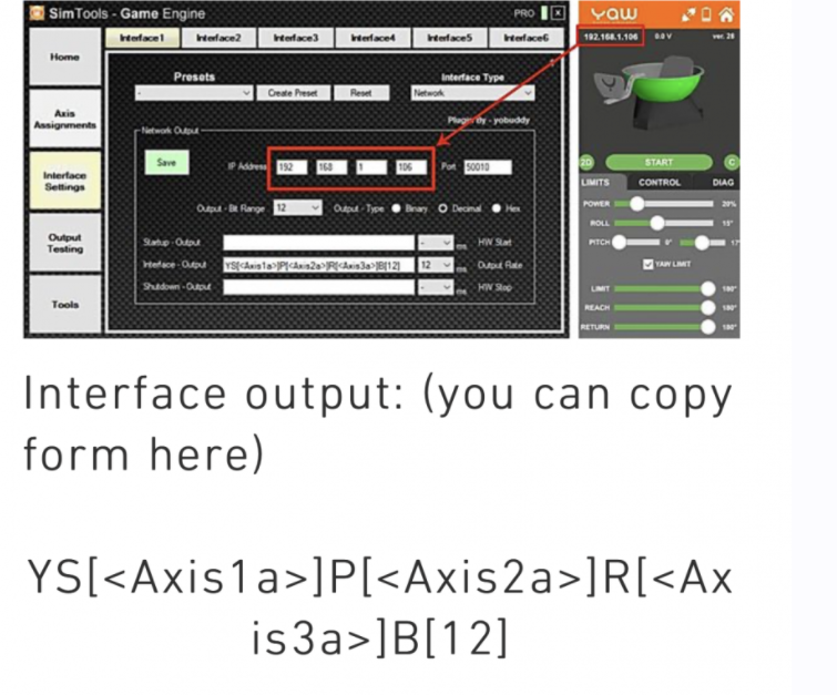

    And there is a Yaw VR interface to ease YAW VR setup, the version posted in thisforum is outdated so I will paste link to YAW VR forum maker thread wich is most up to date version.
    https://forum.yawvr.com/discussion/177/simtools-interface-driver-for-yawvr

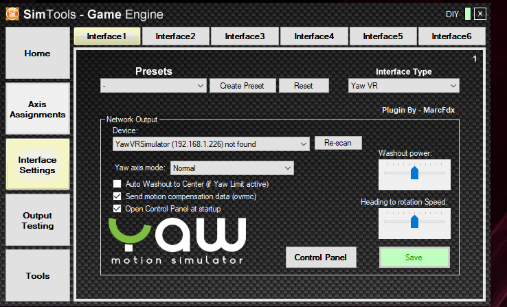

    @noorbeast @Dani Hey guys to keep the correct info flowing I did not need to do this part see Post yaw...but instead see Post Yaw my setup below
  7. Dan B
    Dan B New Member
    Jun 15, 2021
    11
    94Coins
    I think they now have a choice in the "Interface Type" that is named Yaw VR (i didnt type that name into the box) and I just selected that choice and it setup for the Yaw. in other words I never entered the IP address and Im using wifi, no ethernet cable on base just to be clear...what is that for anyway, does it take the place the trackers wifi or what?

    @noorbeast @Dani I think it might be the plugin that did the interface for me see below..

    Yes, that plugin is what mades yaw owners life easy. Its unnoficial and developed by @Marc Fdx YAW VR user,you canfind indeep instructions in its post on Yaw VR forum.

    You can get the YawVR onto your network over wifi or ethernet. Some people claim to have smoother motion over ethernet.

    @Dan B You need just one or the other. You can choose to use the wifi or the ethernet to get on your local network. The tracker in the chair part connects to the base over bluetooth. The tracker doesn't have usb built-in because it needs to be wireless for the 360° yaw axis to be able to spin and spin. The charging port used to be micro usb but was prone to breaking off. Newer units have a barrel charge port.
