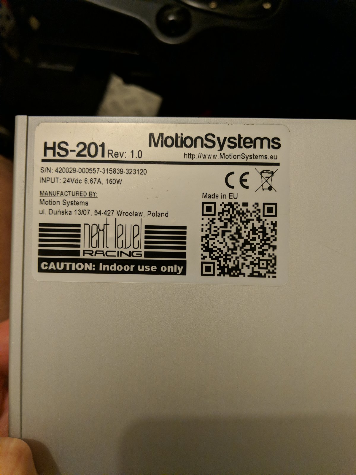

    Hello everyone.
    i have 2 NLR V1.0 seat movers/ motion platforms, they no longer support these older units, and they will not work on their latest platform manager.
    I would like to know if it would be possible to make a new controller for them with an Arduino + motor controllers and use Sim tools.
    or would there be a way to use the existing controllers with Sim tools.
    thanks in advance for any input.
    cheers.
    20,862
    147,009Coins
    +10,845 / 53 / -2
    What hardware do they use, both for motors and controllers?

    hi thanks for the reply. how do i post pictures here to show you

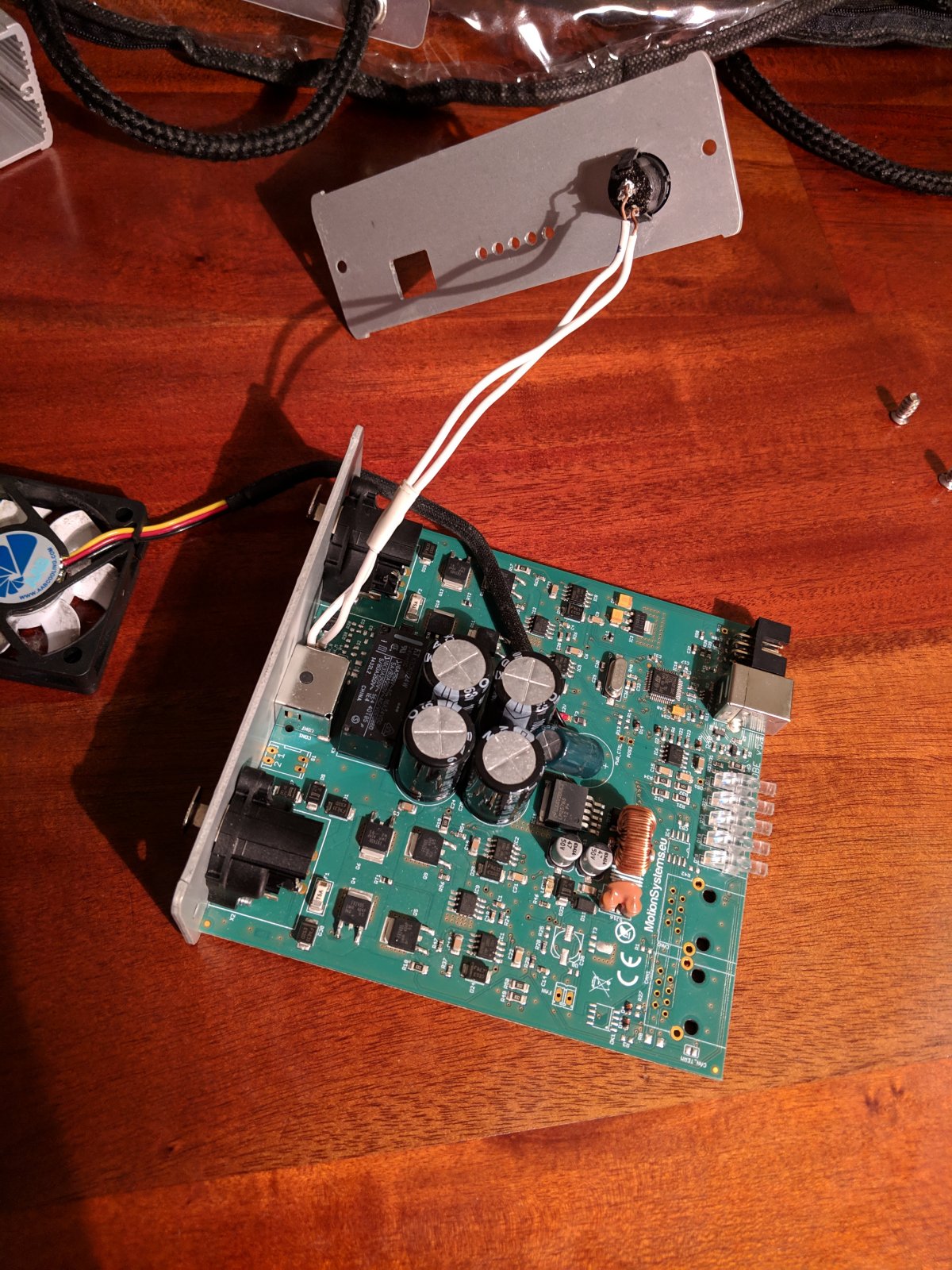

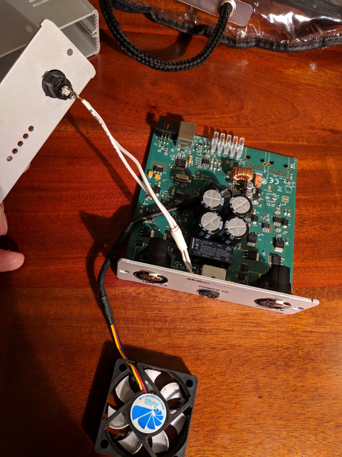

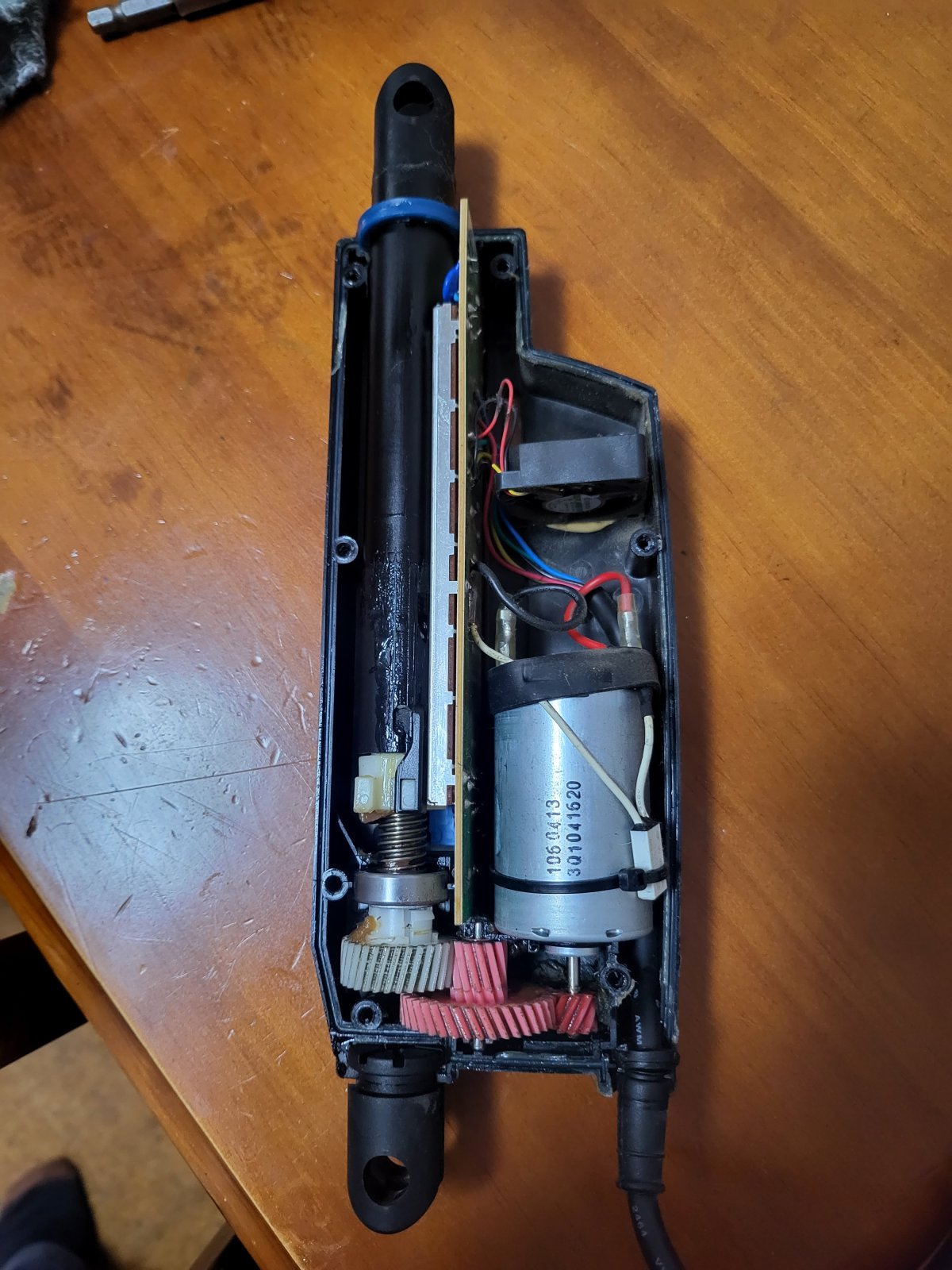

  4. DuffmanGT
    DuffmanGT doing stuff
    Oct 30, 2022
    18
    Australia
    47Coins

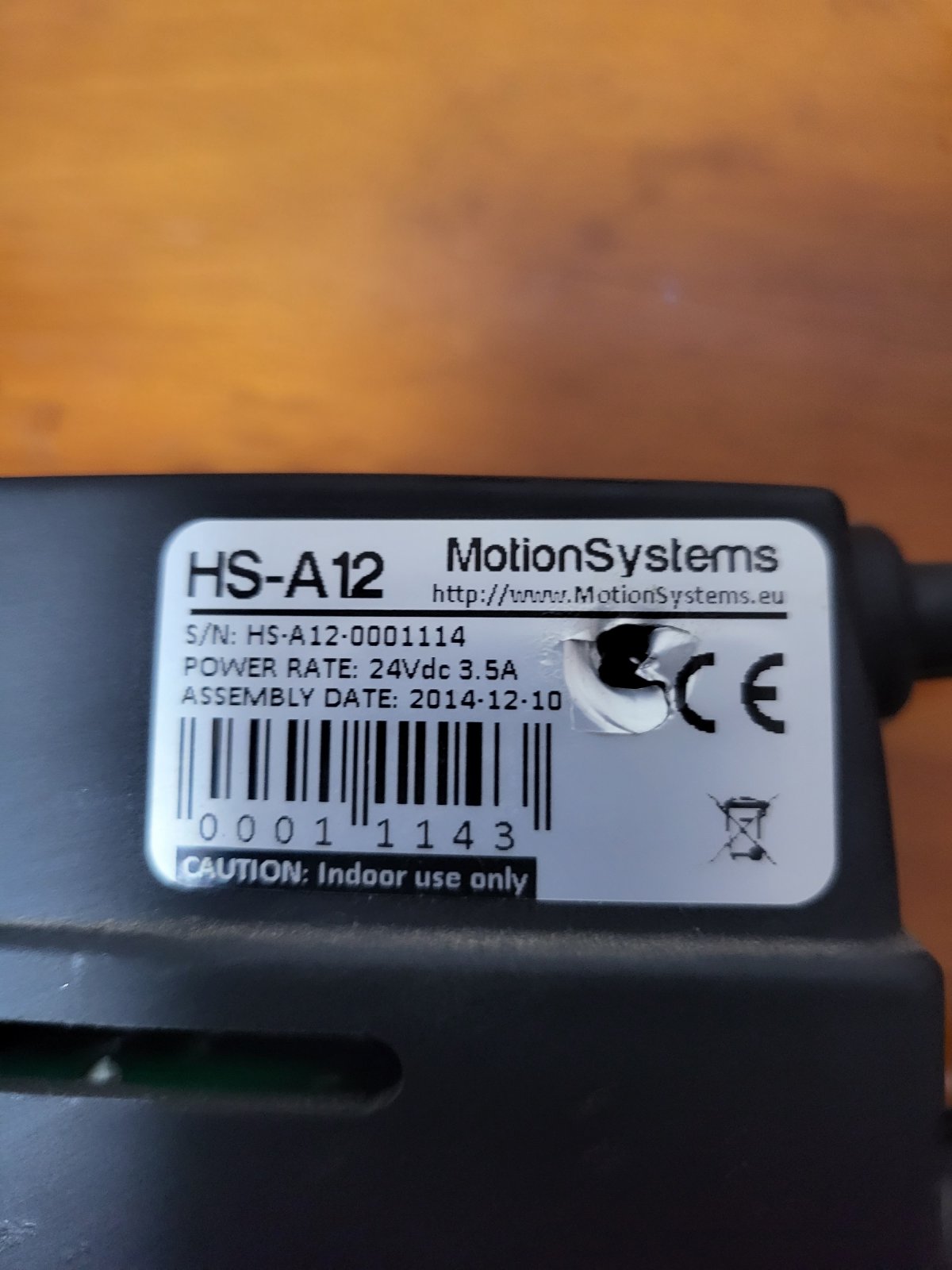

    i have uploaded some pictures of the motors and the controller.
    20,862
    147,009Coins
    +10,845 / 53 / -2
    So 24v, are those pots or limit switches on the actuator?
  6. DuffmanGT
    Oct 30, 2022
    18
    Australia
    47Coins
    they are pots on the actuator

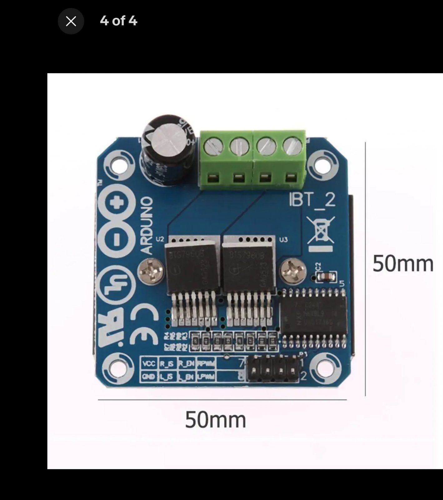

    Can an Arduino, with 2 IBT2 motor controllers and software like SMC3 and simtools drive linear actuators and slide potentiometers?
    20,862
    147,009Coins
    +10,845 / 53 / -2
    The best way to find out is to try it, as the components are cheap enough, and you have nothing to lose.

    before i commit to buying parts can anyone tell me if these are what i will need?
  11. ChuckyP
    ChuckyP Active Member Gold Contributor
    Sep 21, 2020
    122
    Chicago, IL
    748Coins
    +63 / 0 / -0
    Yes those look like what you need. A couple of things to think about. The IBT2’s don’t come with thermal paste on the heat sinks so you may want to take off the heat sink and apply some.
    also I only run 12v, but I have heard that with 24 volts the Motor Drivers can heat up quickly. Those that run them usually limit the power to something more like 19 volts to keep things cool.
    The drivers would also benefit from active cooling with a fan to keep air moving.

    ok thanks i will order the parts,
    i plan to put the Arduino and IBT2's in a enclosure with a fan to keep them cool as i will be running 24V

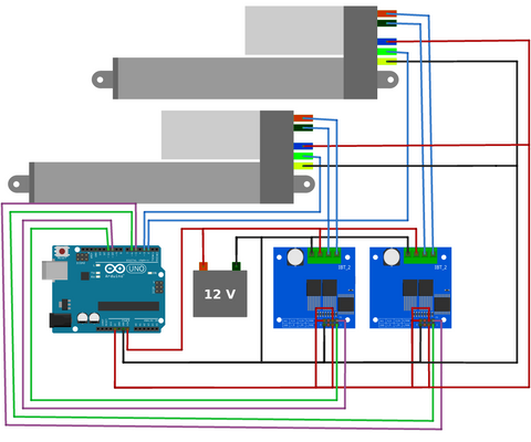

  13. DuffmanGT
    Oct 30, 2022
    18
    Australia
    47Coins
    dose this basic diagram look like the correct way i would need to wire up my arduino, IBT2's and actuators?
  14. ChuckyP
