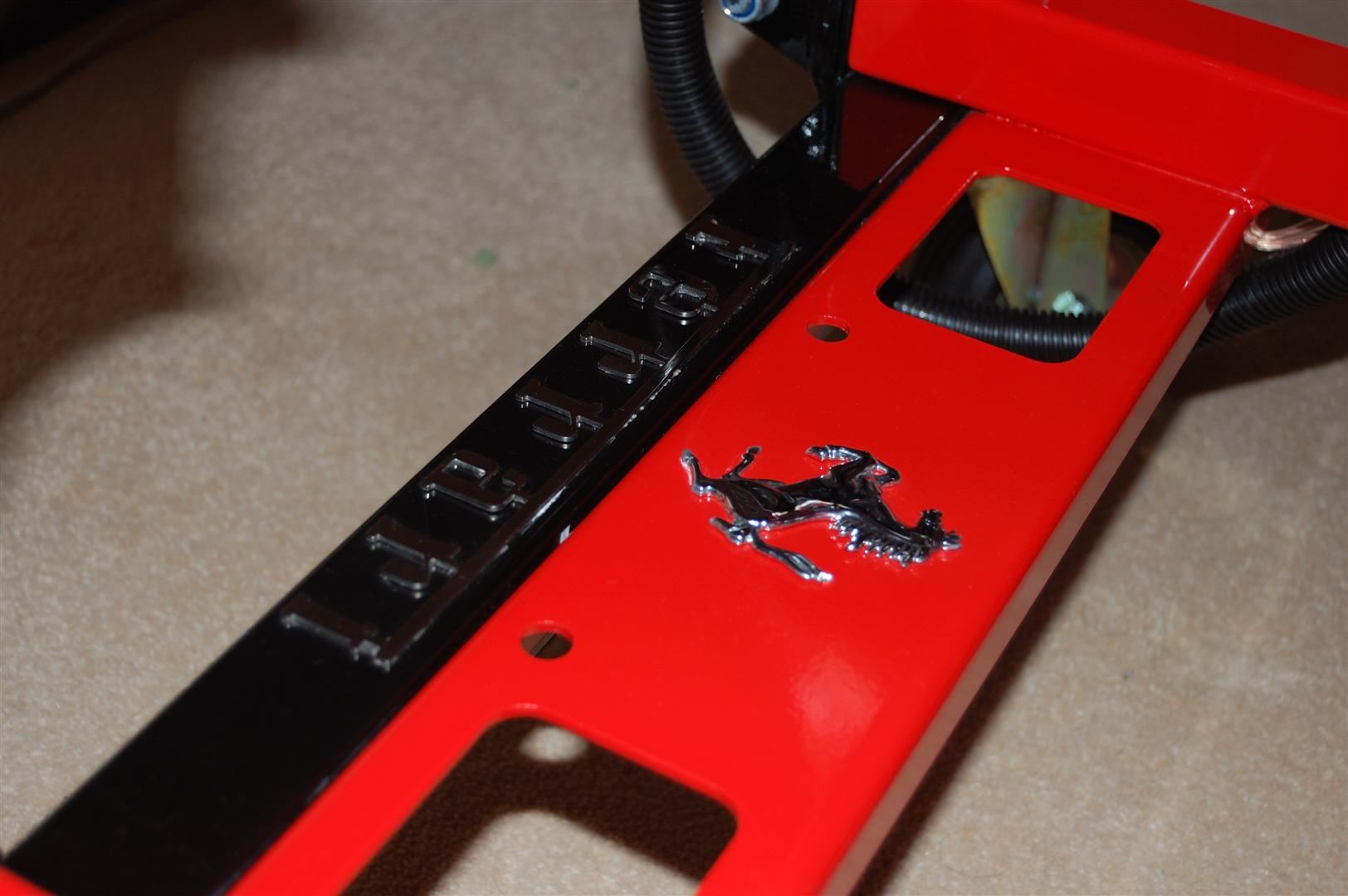

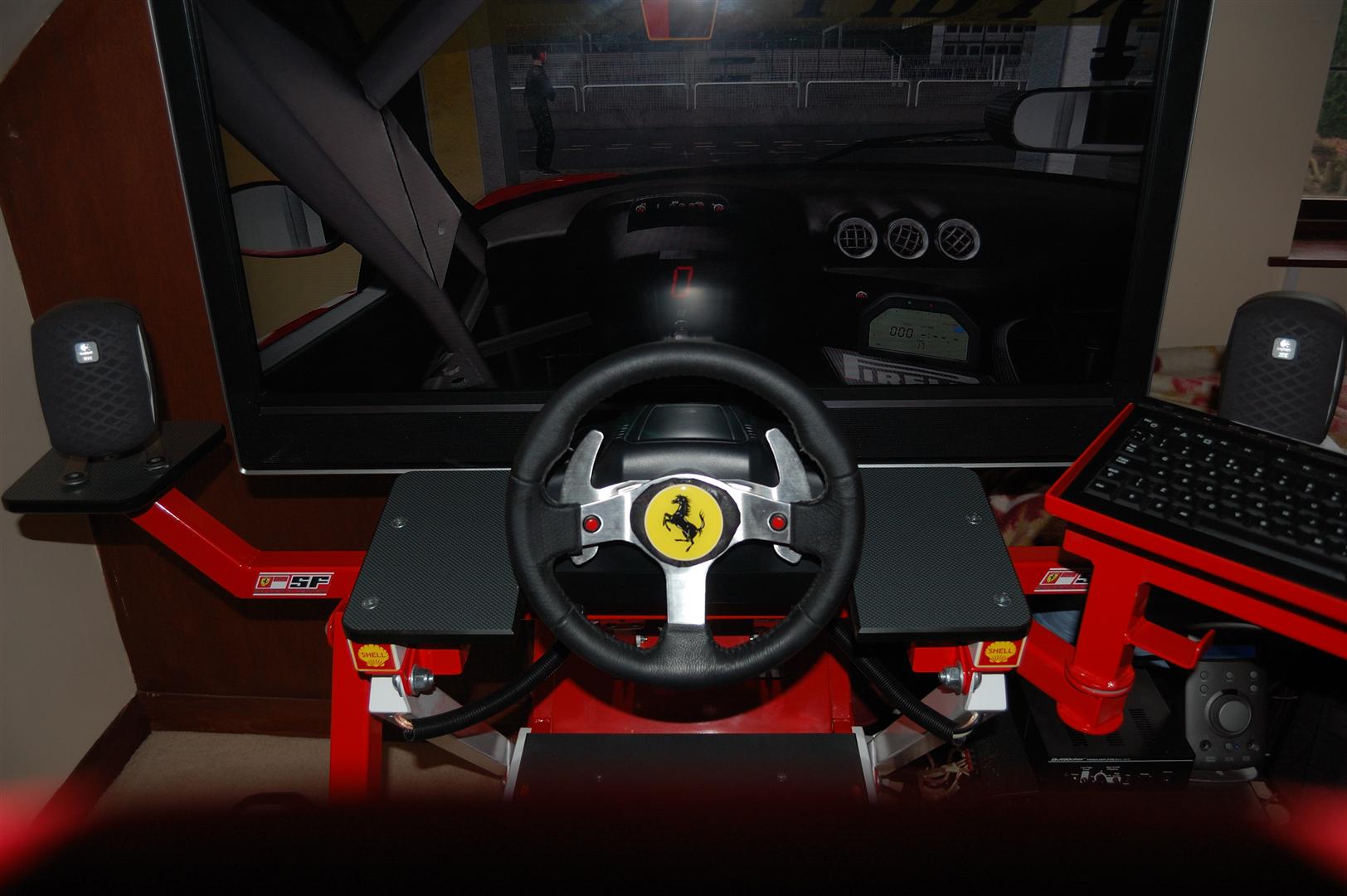

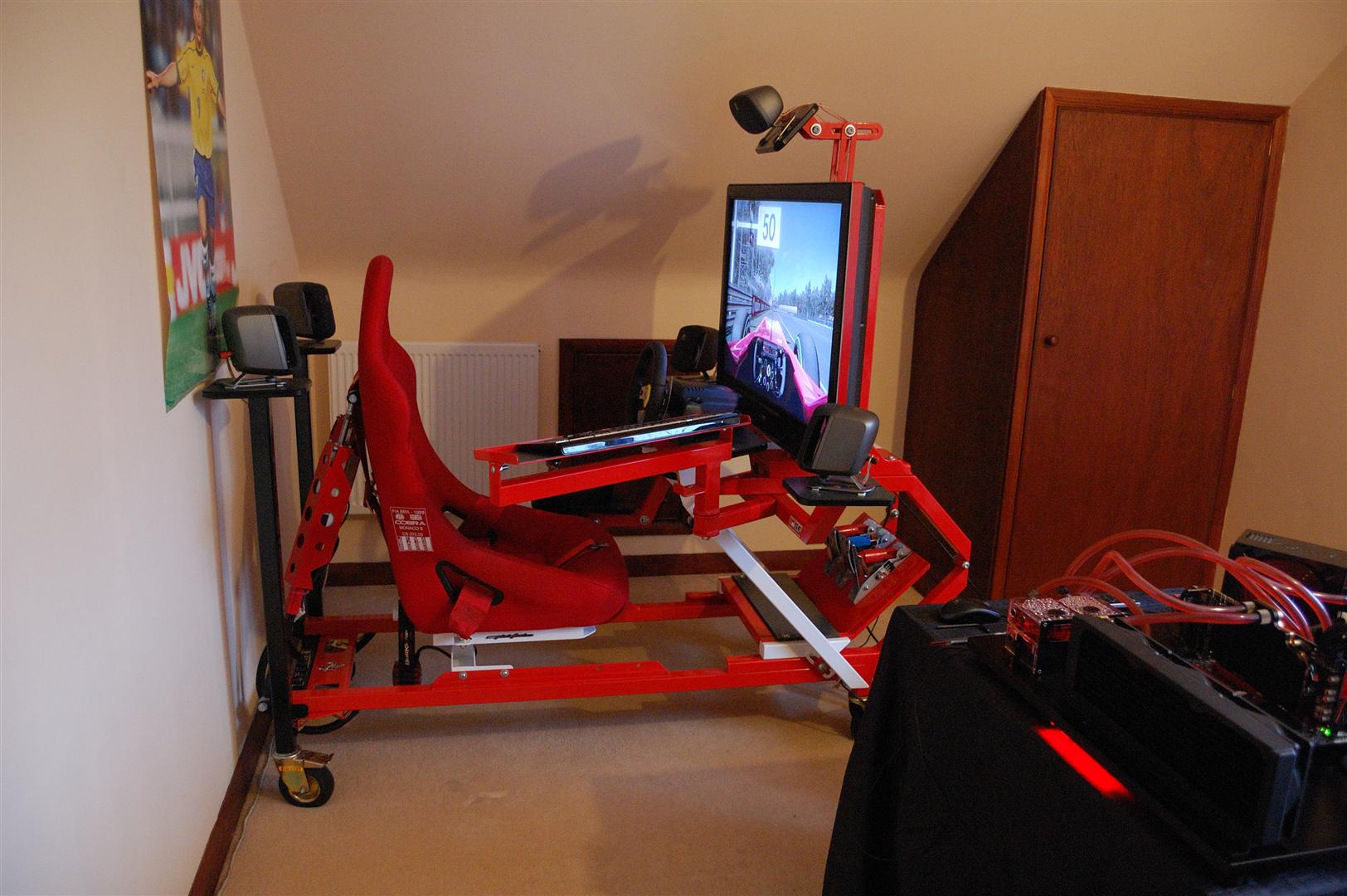

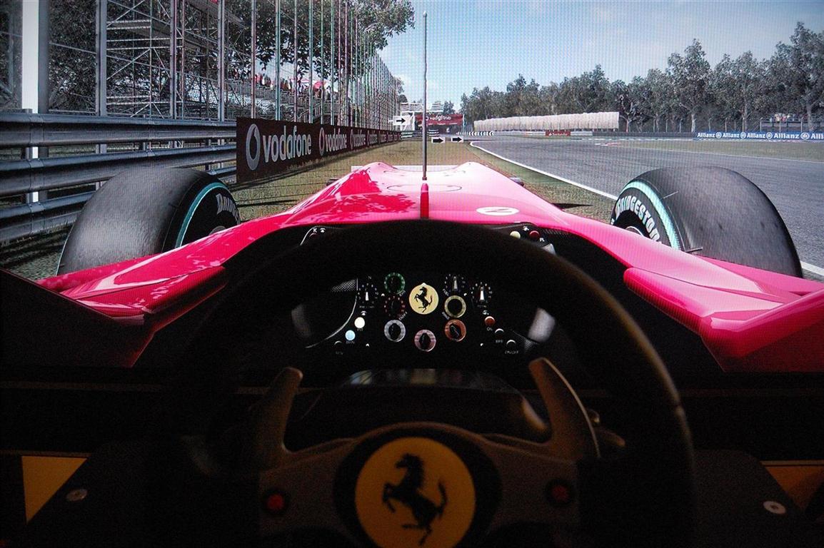

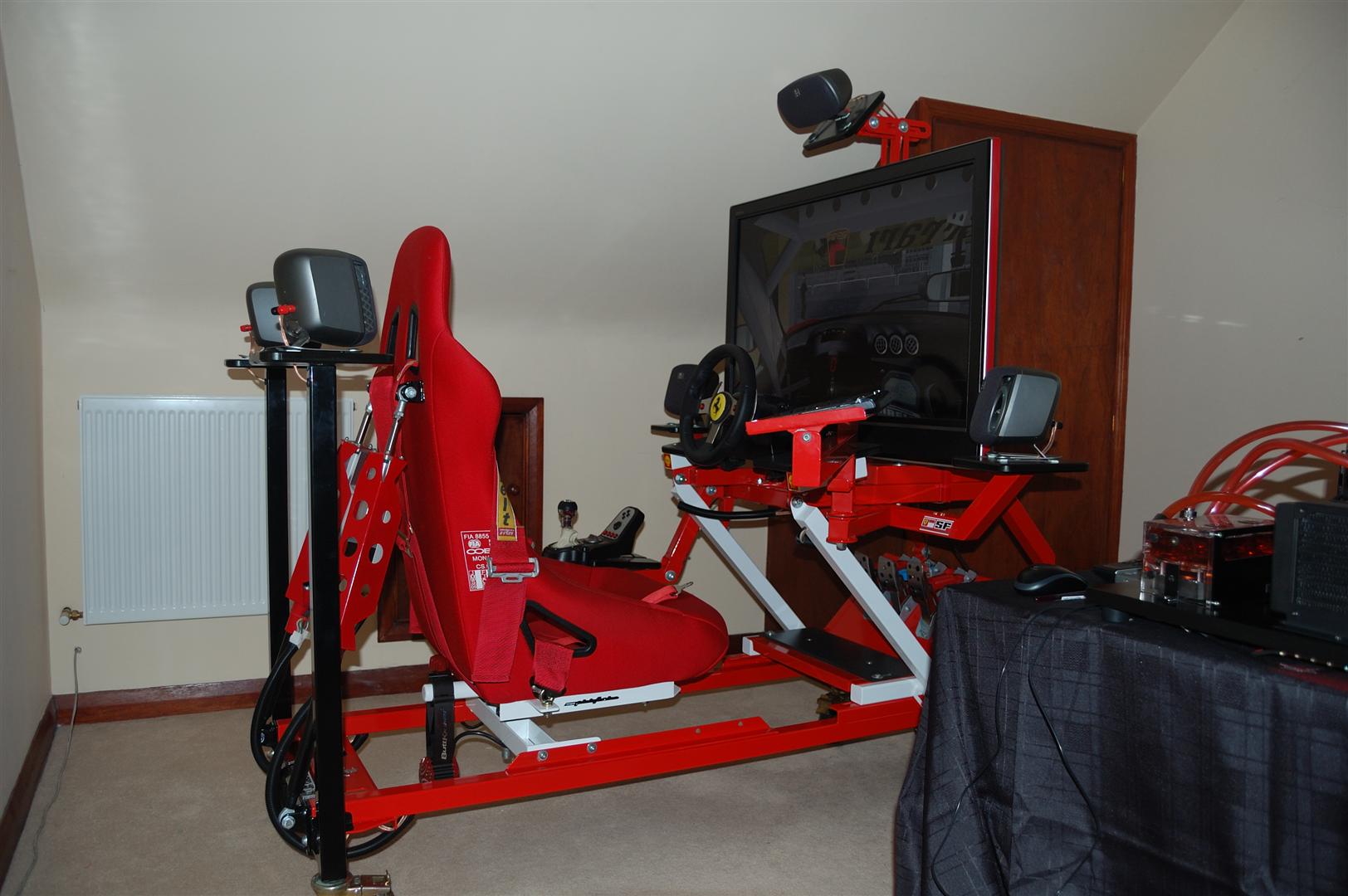

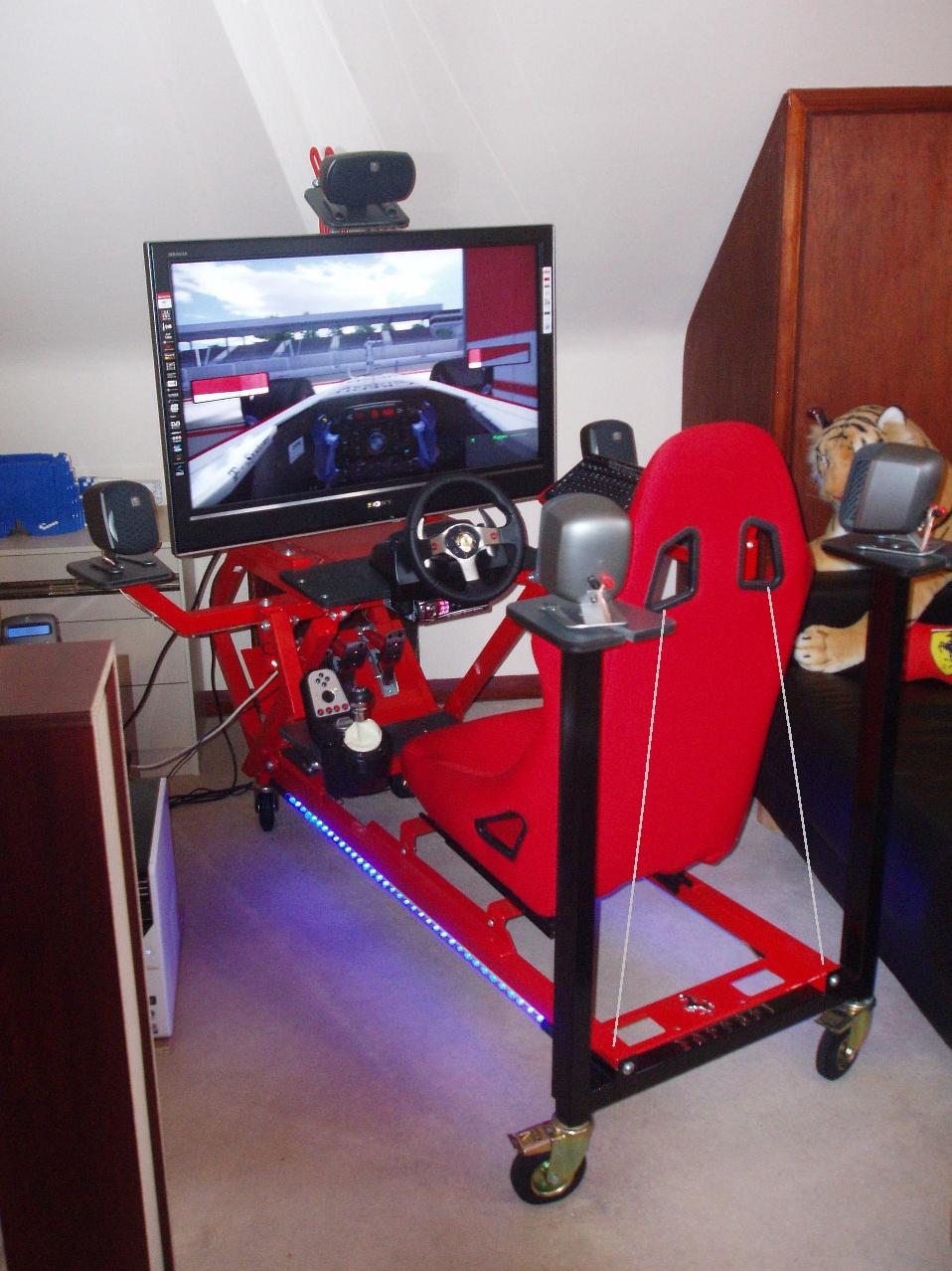

    Thanks to NIXIM.com & X-Sim community very much :D
    Pictures:
    xsim2.JPG xsim3.JPG xsim4.JPG xsim5.JPG xsim6.JPG xsim7.JPG xsim8.JPG xsim9.JPG xsim10.JPG xsim11.JPG xsim12.JPG xsim13.JPG xsim14.JPG xsim15.JPG xsim16.JPG xsim17.JPG xsim18.JPG xsim19.JPG xsim20.JPG
    Video:
    My cousin driving in F360 and yes even keeping the car on the track on first attempt of video :D . It was his camera we use to take shoots. That's why the picture is better quality than ones I took.

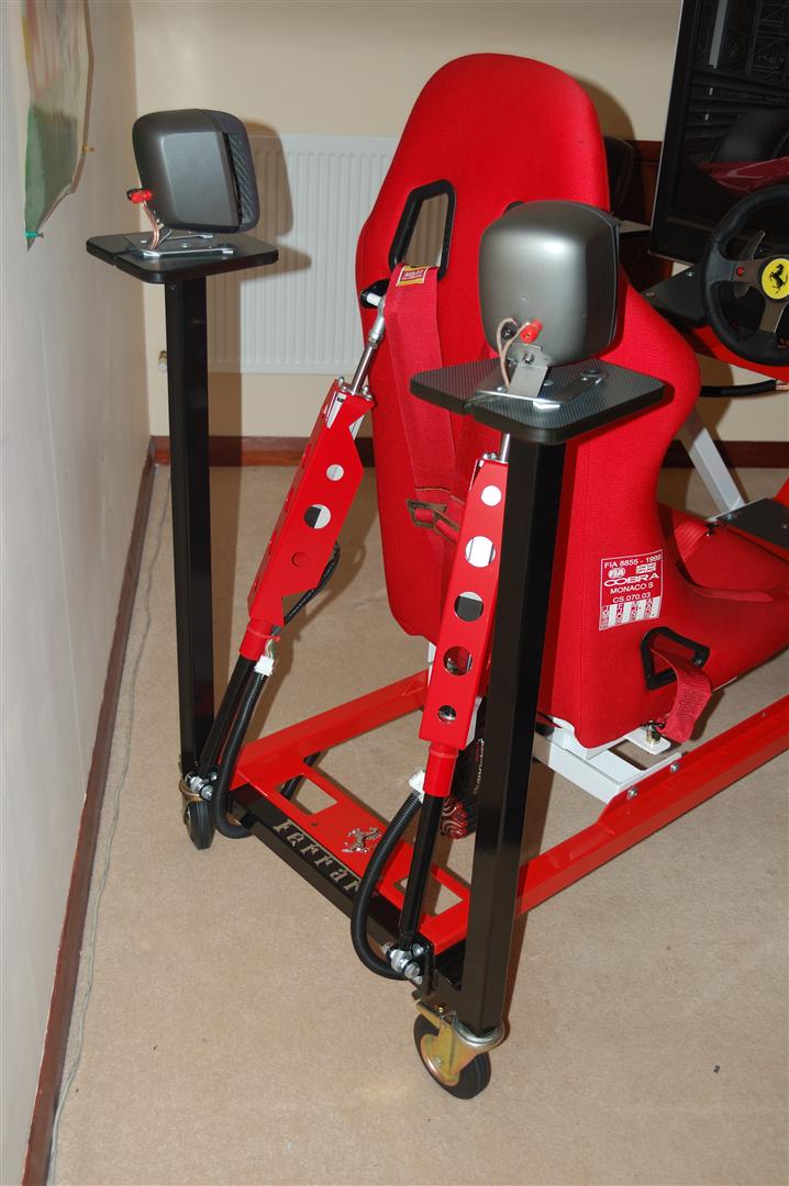

  6. Fahim
    Fahim Member
    Dec 11, 2008
    424
    235Coins
    Dear sirs,

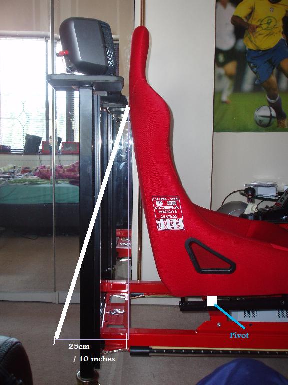

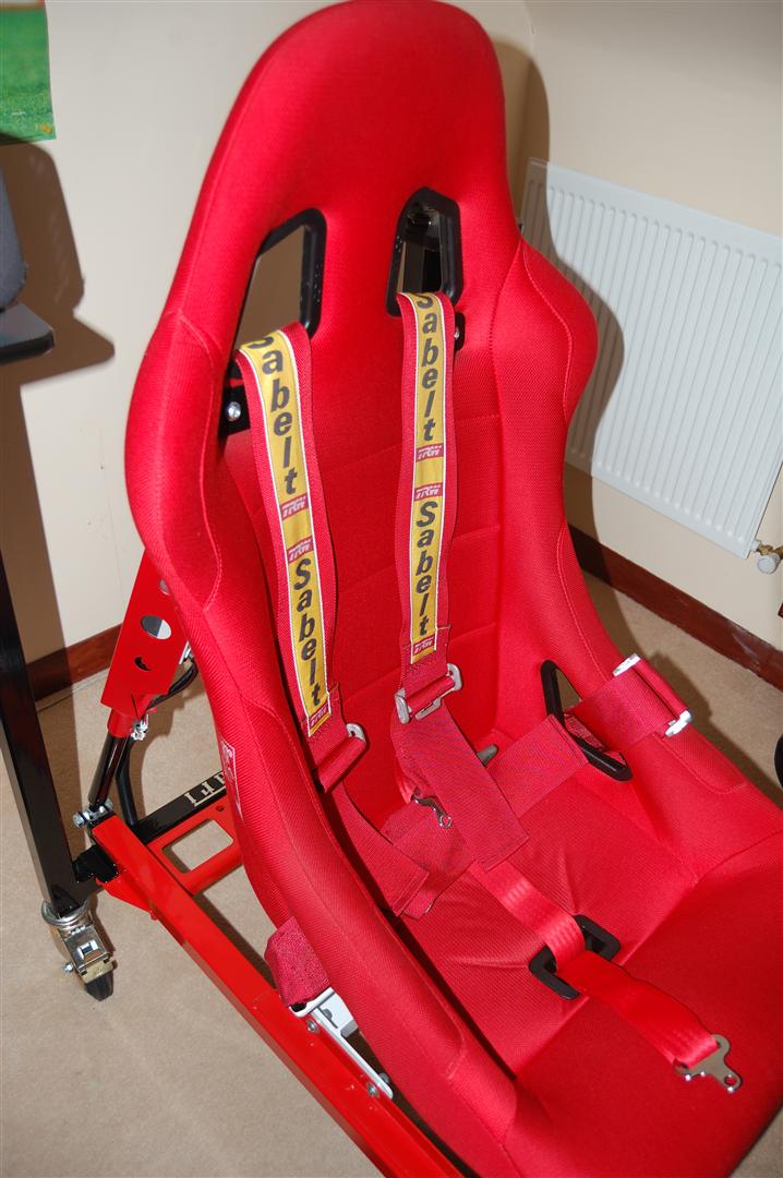

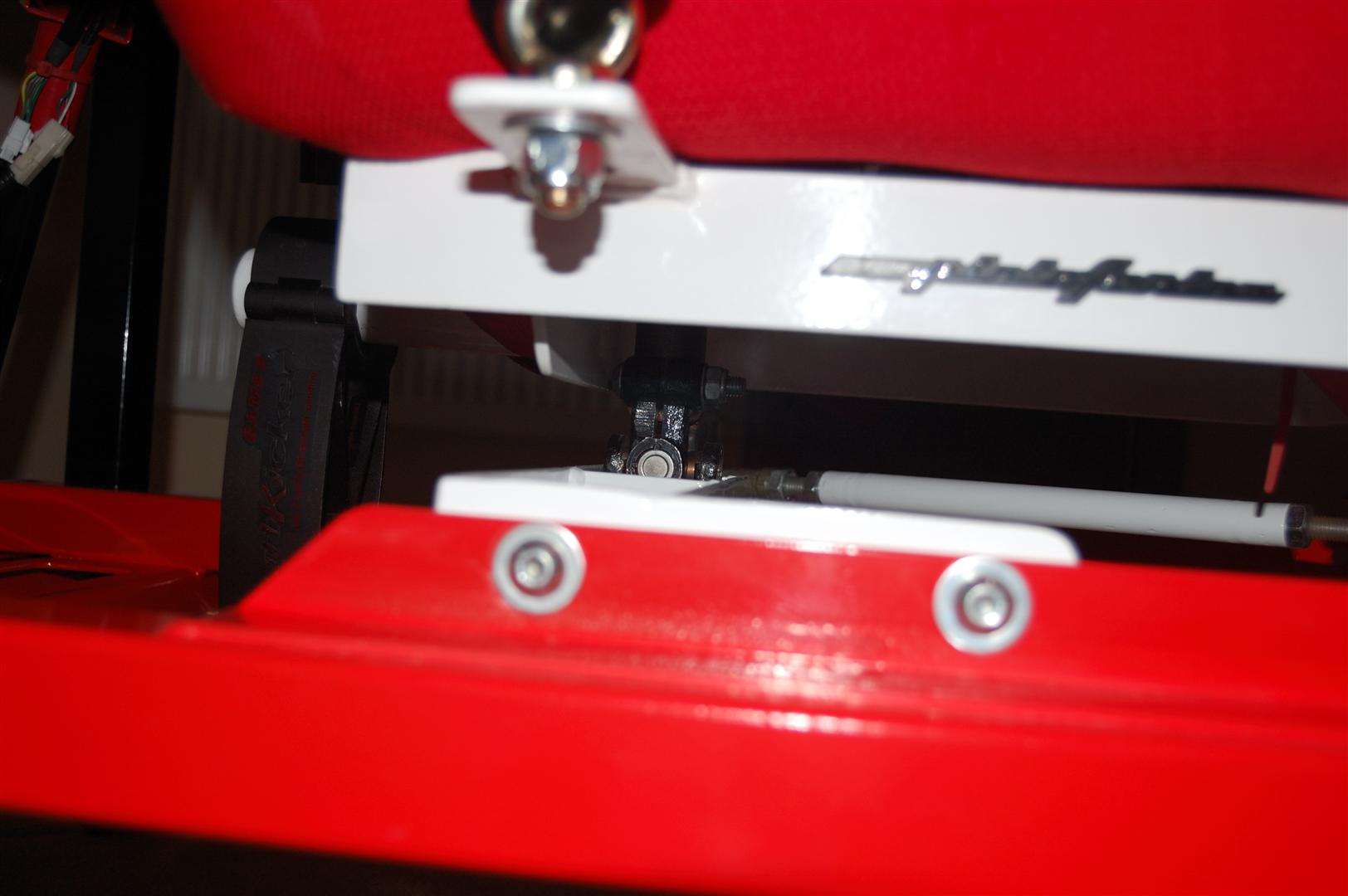

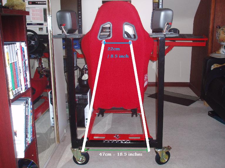

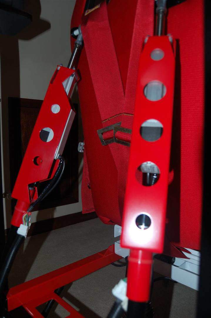

    Is this positioning okay (and also pivot placing) for 100mm scn5 actuators.
  7. RaceRay
    Nov 8, 2006
    4,656
    Hamburg, Germany
    23,862Coins
    +1,999 / 13 / -0
    the right distance from your pivot centerpoint is dependable from the whole weight of seat, driver and angles of the actuator arms to the seat. You can try to calculate everything out, but easier it is when you grab a friend to help you moving the seat when you sit in. So you can try different distances of the pivot until you find the balance of the seat, the point where you actuators can move with least stress moments.

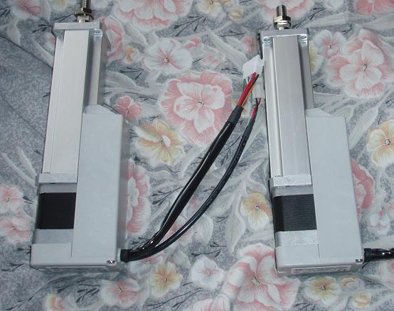

  8. Fahim
    Fahim Member
    Dec 11, 2008
    424
    235Coins
    guys,

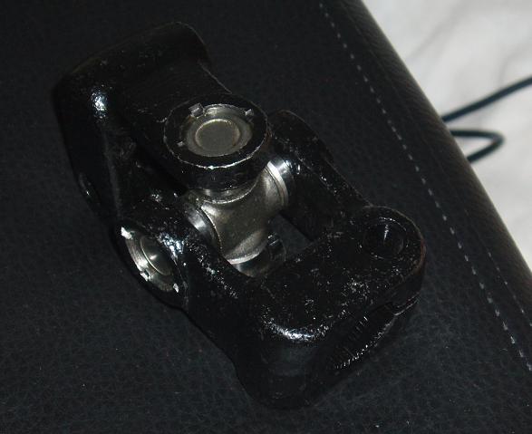

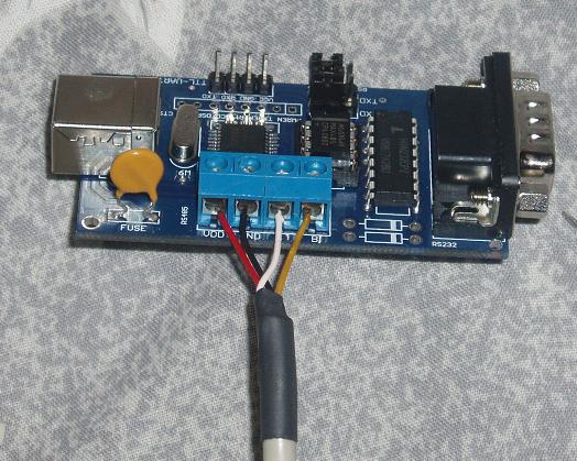

    1) Universal land rover joint - can buy from Ebay - £10-15 english pounds.
    2) actuators collected yesterday - seem small in size
    3) usb adaptors which I've wired up. ( clever me)
    Cheers.

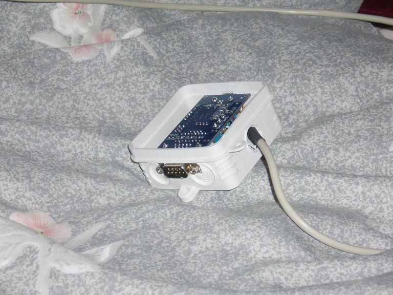

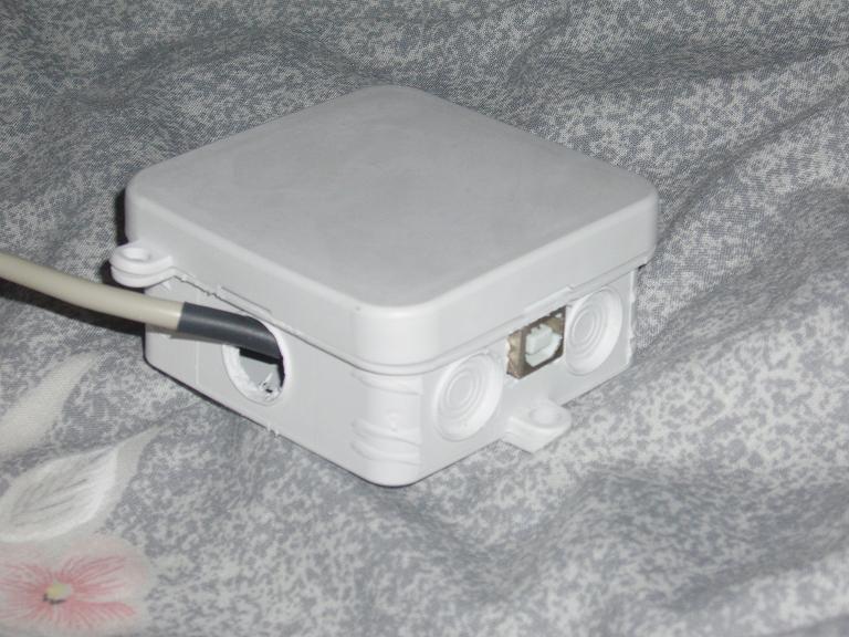

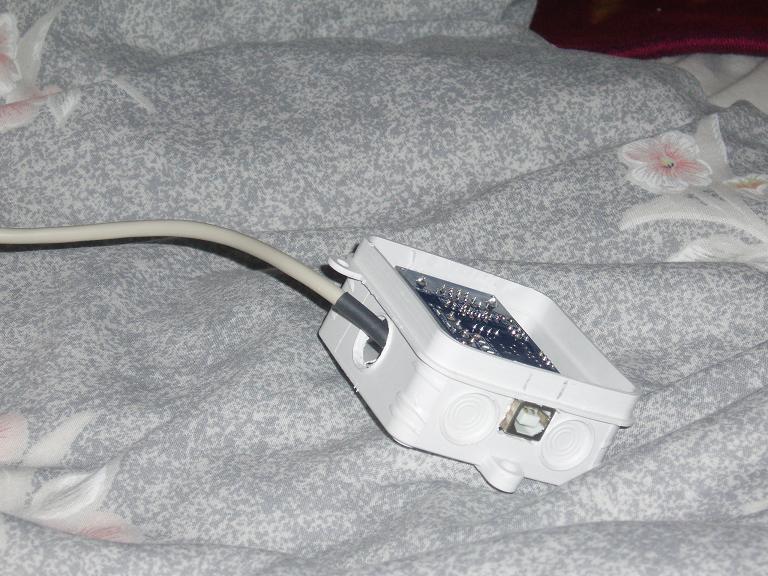

    My dad made me this case for the rs485 usb adaptor. He said get it trademark patent. :lol: Just a simple junction box for wires made from cheap pvc plastic so it is easy to cut with stanley knife. rs485case2.JPG rs485case1.JPG rs485case3.JPG
  12. RaceRay
    Nov 8, 2006
    4,656
    Hamburg, Germany
    23,862Coins
    +1,999 / 13 / -0
    We should make some X-SIM stickers to decorate such simple boxes. Looks clean :)
  13. Fahim
    Fahim Member
    Dec 11, 2008
    424
    235Coins
    Yeah I would love to put x-sim logo on and then show you guys the picture.
    I want to make the simulator then do a Video with a big X-sim banner thanking you guys for the help.
    I am nearly finished. I just need confirmation if the ilk circuit is right which I have posted on the scn5 Hardware thread.
    This is my stumbling point. Once I have done this all I need to do is install X-sim2 on my PC, then I will put the scn5 actuators on the table like you guys first did and show it working.
    I do not want to operate the scn5's until I have done the ilk circuit properly. Egoexpress has explained to me about 6-7 times how to do it but I cannot understand as firstly I do not understand electrics even though I studied it at college :rofl:
    But yeah if we could determine a suitable adaptor for all people then we can use these boxes and put x-sim logo on them and it can be standard. It is better than adaptors just being stuck on the side of something.
    This looks a little neater. Cheers guys.

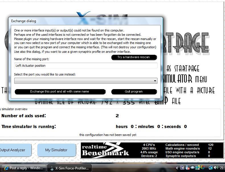

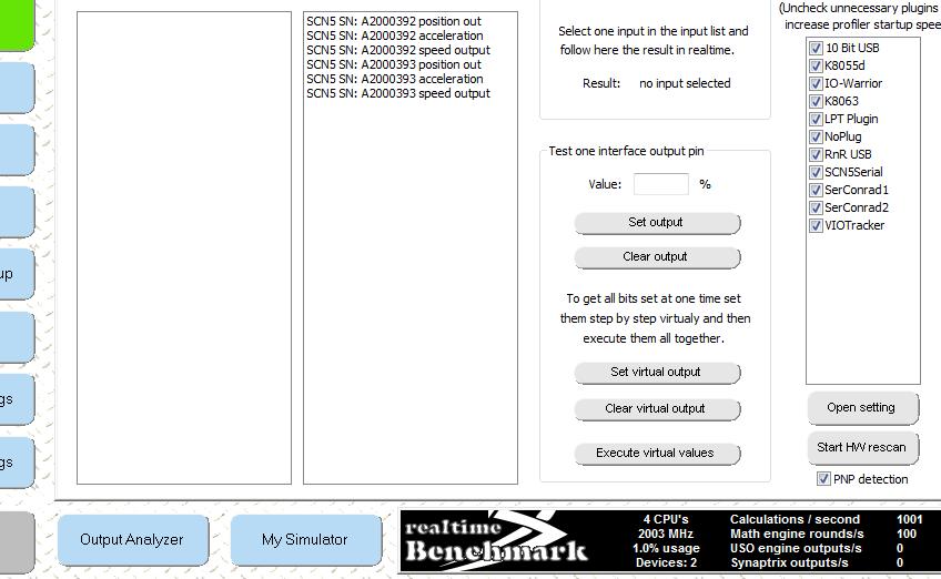

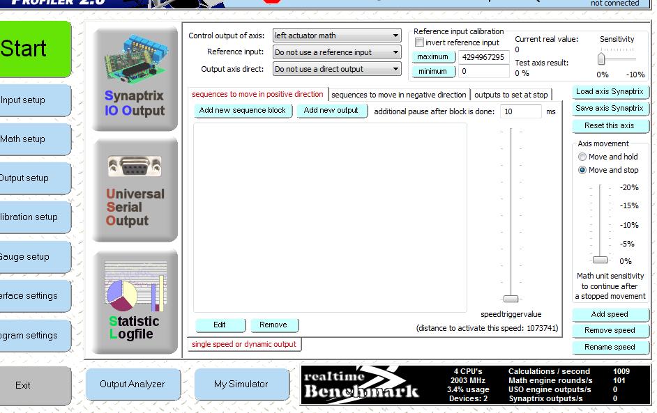

    Hi guys,
    I managed to power up my scn5 actuators. Thier sat on the table.
    I started up Profiler and the scn5 actuators came out to middle position at the same time. I then loaded up MasterYoda Profile.
    It then came up with the box: I have attached the picture: prob1.jpg
    Interface section - Output table = it shows both actuators.
    Also force sender. DO I need to download a plugins for it to operate with profiler program?

    You do not need to download anything additional. Also, please disable all plugins except for SCN5Serial. Also, disable PNP Hardware detection. This may help X-Sim to crash less often for you under Vista.
  16. Fahim
    Fahim Member
    Dec 11, 2008
    424
    235Coins
    I've done what you said.
    Look at the second picture. In the INPUT table - nothing is listed. Maybe the rs485 adaptors USB not been detected.
    My actuators work, they show in output table. But I do not know what to do from there.
    When I open force sender program which game excable do I choose.

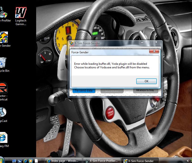

    When I select anything and try send data to profiler. it comes with error like buffer.dll & Yoda will be disabled

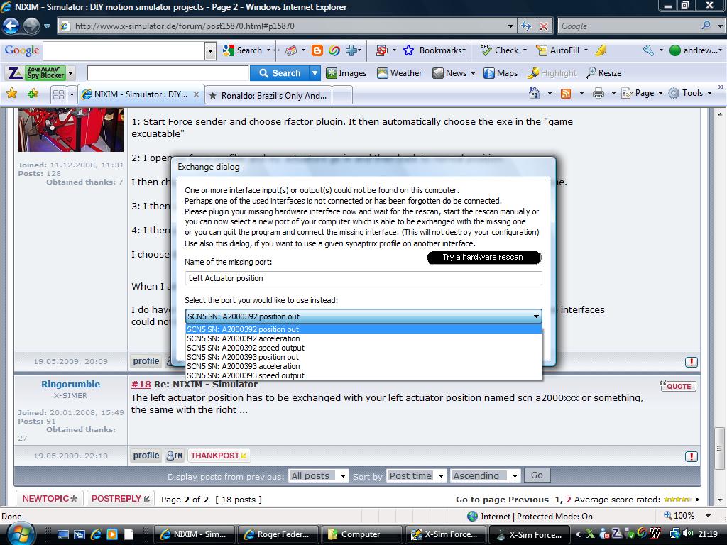

    I do have to add when ever I load up the Masteryoda profile it comes up with the one or more interfaces could not be found

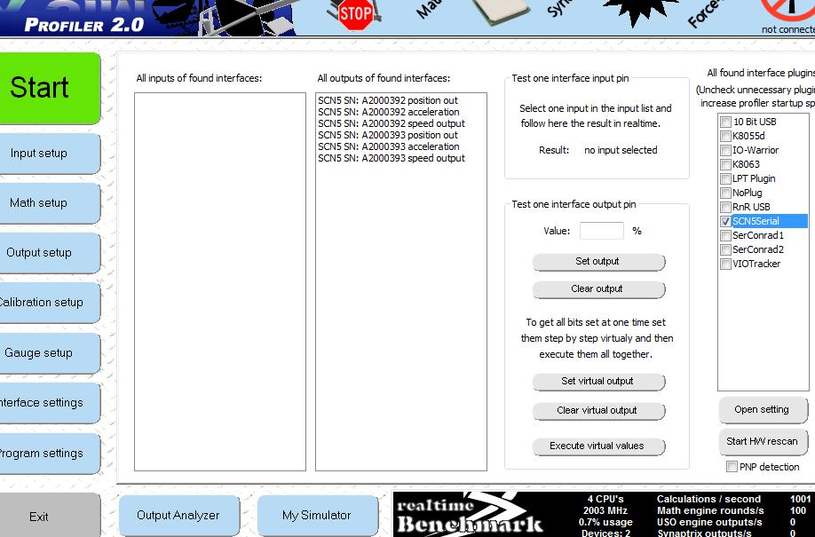

  18. Ringorumble
    Ringorumble Active Member
    Jan 20, 2008
    178
    190Coins
    +48 / 1 / -0
    The left actuator position has to be exchanged with your left actuator position named scn a2000xxx or something, the same with the right ...
  19. Fahim
    Fahim Member
    Dec 11, 2008
    424
    235Coins
    I understand what you mean: Look at the picture. It shows me 6 options prob6.jpg
  20. Fahim
    Fahim Member
    Dec 11, 2008
    424
    235Coins
    That is strange. The problem seem to have sort it self out.
    All I did was rename the actuators: Left actuator and right actuator.
    And when I load up Masteryoda profile, the interface not found message does not come up anymore.
