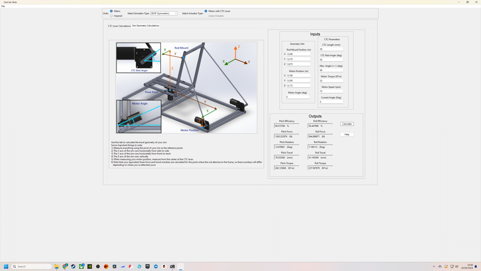

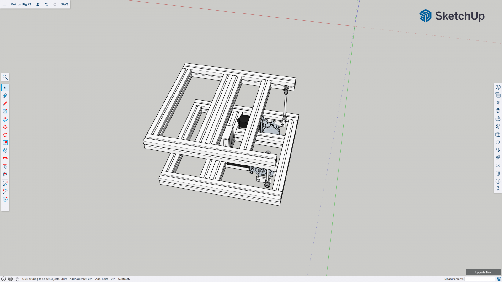

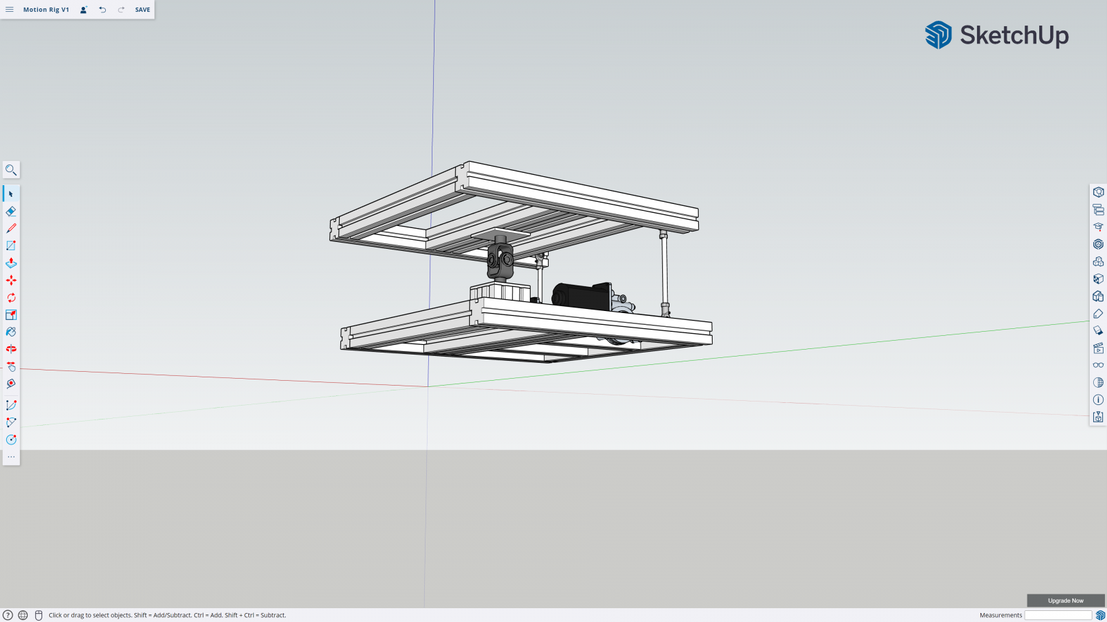

    Starting to look at the frame design to get some calculations to go into simcalc, would love to hear your thoughts on this if you would be so kind please.
    20,710
    146,110Coins
    +10,809 / 52 / -2
    My suggestion would be to adjust Max Angle to 80, as with a compact design torque matters most and over 40 degrees up and down effective torque utilisation drops off rapidly.
    The rest angle will be 0 in a compact design.
    Other members have found benefits in running IBT2s under 24v.
