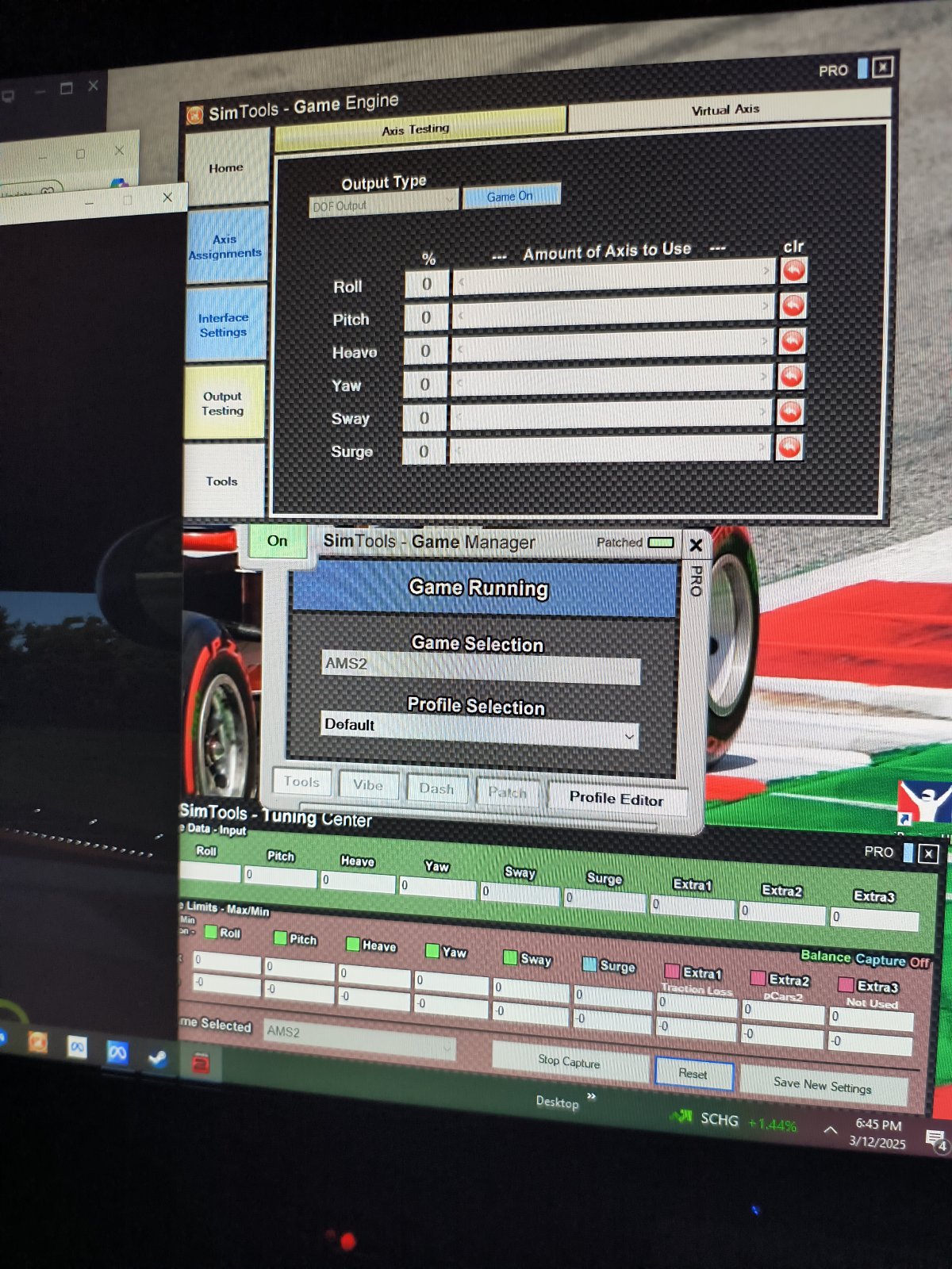

    I can't get any motion on my Prosimu. Output testing works fine and moves everything but can't seem to get telemetry to game engine. Read the manual but can't figure it out.
    Repatched both games R3E and Ams2.
    Both have always worked fine but been away for a year or so and now there is no telemetry even to virtual axis.
    Kind of lost at this point

    Better picture

    It's hard to see from your photo, but if you have all zeros in tuning center, you won't get any movement. If so, make each one 10 and adjust from there or capture and save new data. You should see the data coming through when capturing and the game is running.
    AMS2 needs configured in the menu to allow telemetry (Project Cars 2 mode - can't remember if UDP or shared memory works best).

    UDP did the trick, it was set to off. Set it to 1 and have motion. Thanks. :cheers
