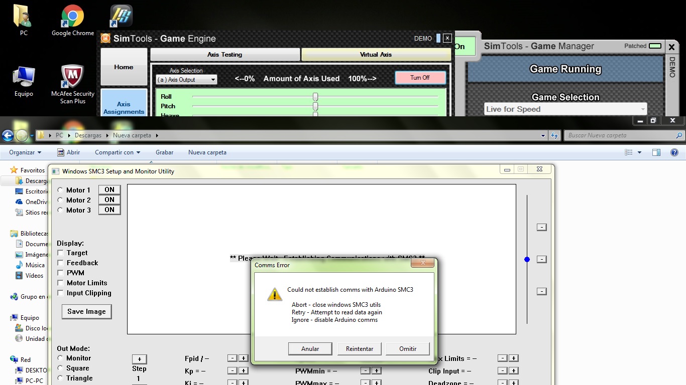

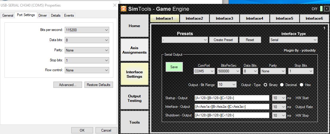

    ANYWAY - now that I have jumped back on the DIY motion horse, the horse doesn't want to stand up. I am able to get movement through the SMC Utility Tool but I cant get anything after that. To make it clear, all I am trying to do is go through AXIS TESTING in SimTools, i am not even interested in introducing a game environment yet. HELP PLEASE - Where am I going wrong? What have I not set up? What have I set up wrong?

    this my problem with smc3, for that I'm no using that. I only configurate with simtools in the output section, but I only can make the test, with game not yet, there no movement with the game, neither there are vallues or slider movement when the game is running, I thinking something about interruption, or overload of the program demo.

    Start by switching to English local for language settings: https://www.xsimulator.net/community/faq/simtools-language-setting-bug-change-to-english-local.233/
    Then follow the SMC3 setup steps here: https://www.xsimulator.net/communit...3dof-motor-driver-and-windows-utilities.4957/

    I CHANGE THE LANGUAGE WITH THAT LOCAL EMULATOR. I OPENED MANAGER AND ENGINE AND AS ALWAY NOTHIG WORKS. THREW THE SAME ERROR OF THE WINDOWS FRAMEWORK, AND MANGAER GET CLOSE.
    AND THE WIPER WITH WINDOWS UTILS WORKS FINE, BUT ONLY TEST, WHERE THE LINE GREEN GO FOWARD THE BLUE. I'M GOING TO BE DOING CHANGES AND TESTING THE WINDOWS UTILS PROGRAM TILL GET MOVE THE ENGINES. CHEERS. AND LUCK.
