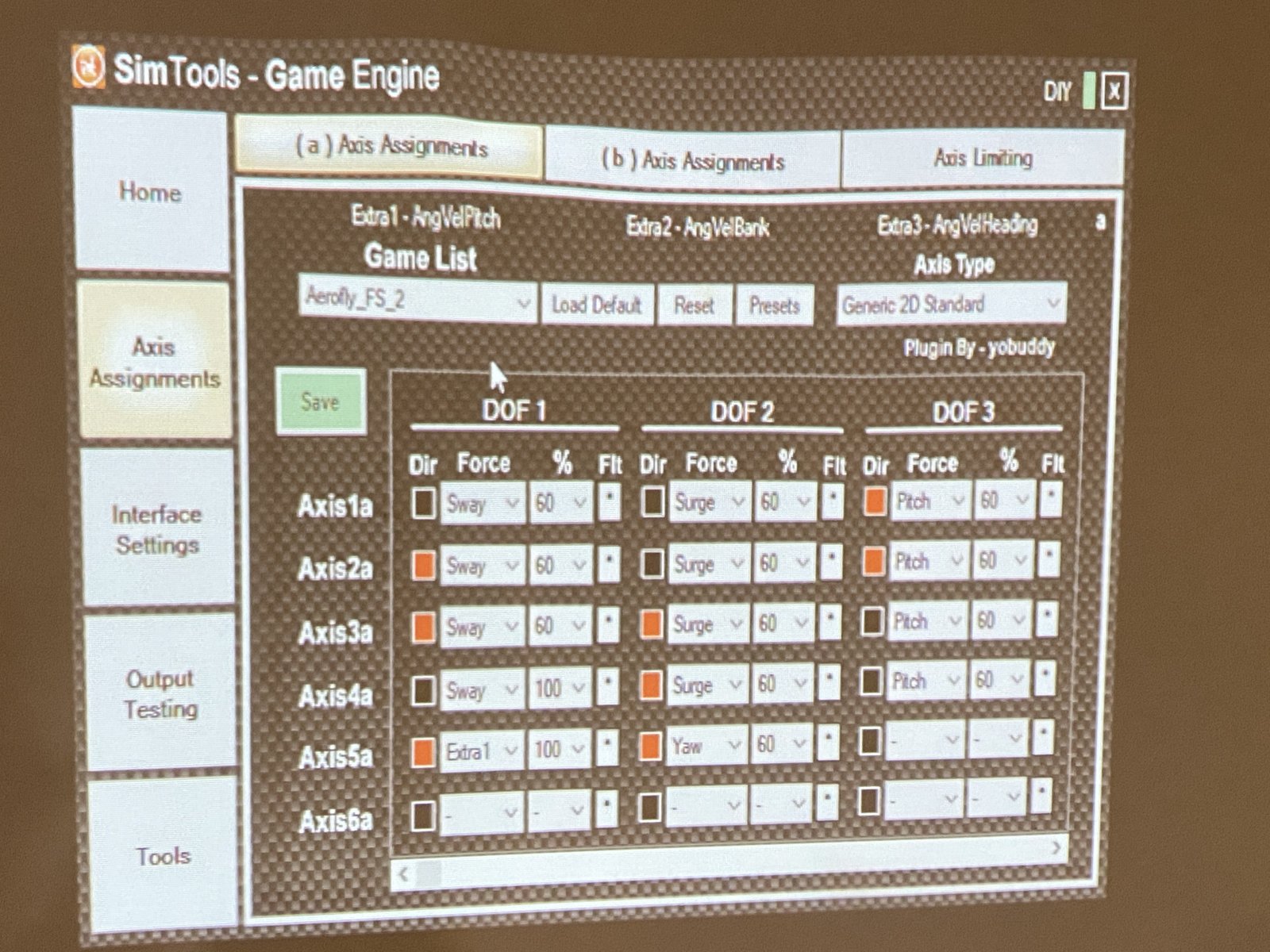

    I have my T1000 working great with Assetto Corsa, but I'm getting no motion with AF2. I'm not sure how to assign the various Axis, as i'm a real newbe to this kind of stuff. Any help would be appreciated.

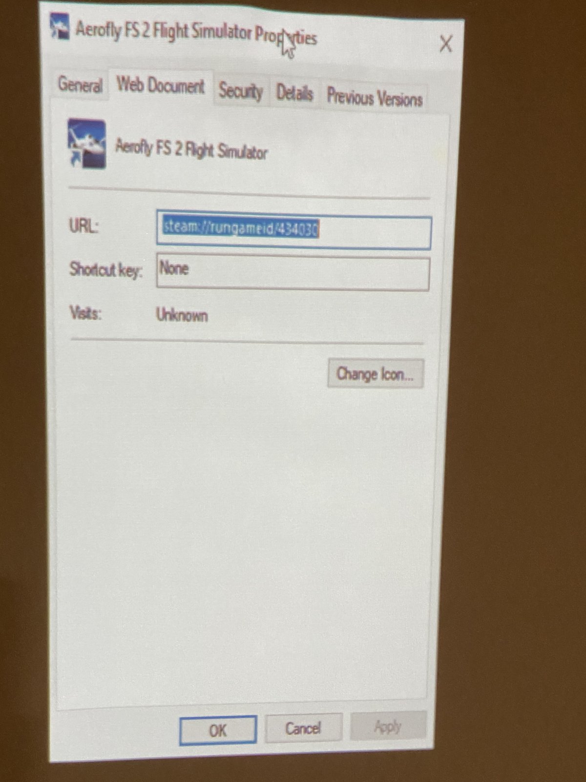

  3. 9xclubchamp
    9xclubchamp New Member Gold Contributor
    Dec 28, 2016
    14
    Woodbury
    311Coins

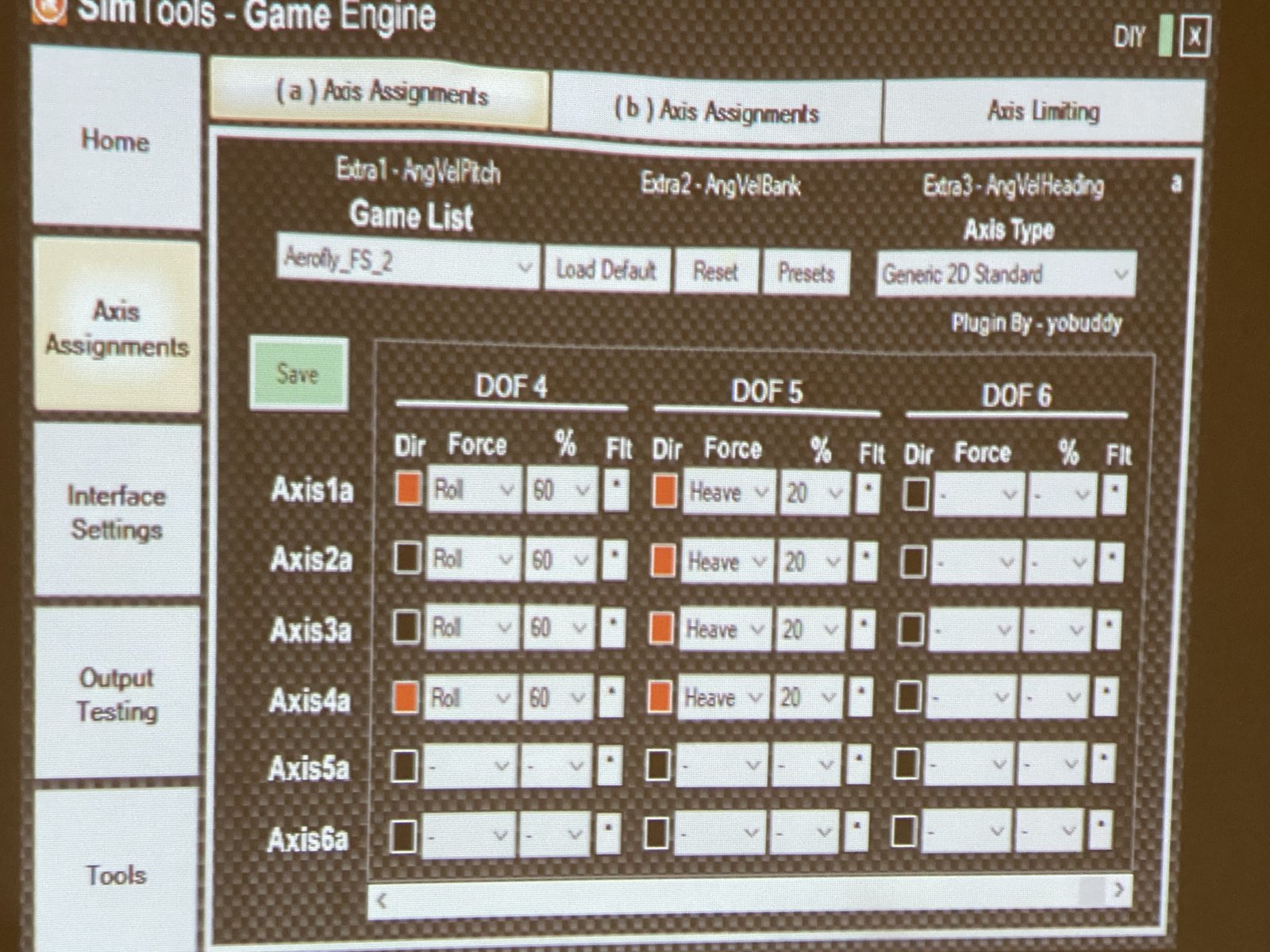

    Thank you for your willingness to help. I’ve attached the pictures you requested. Here’s what I’ve done so far. 1. Tested motion on T1000 to make sure everything was working
    2. Confirmed Game Engine and Game Manager had AF2 selected
    3. Started AF2, was in flight, but no motion on T1000

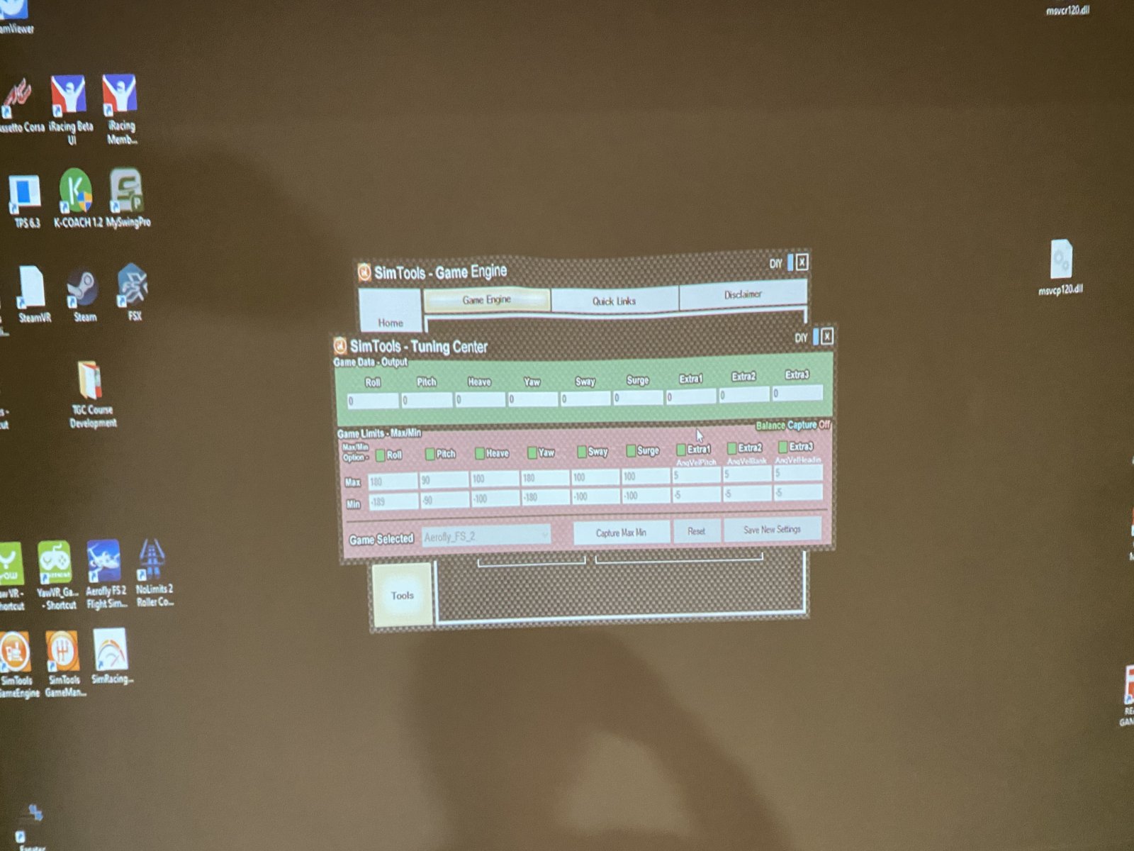

    4. Picture of Tuning center

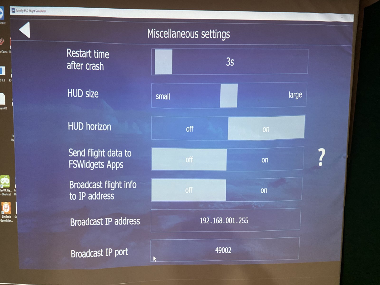

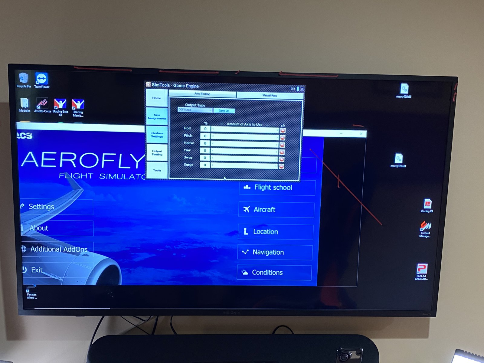

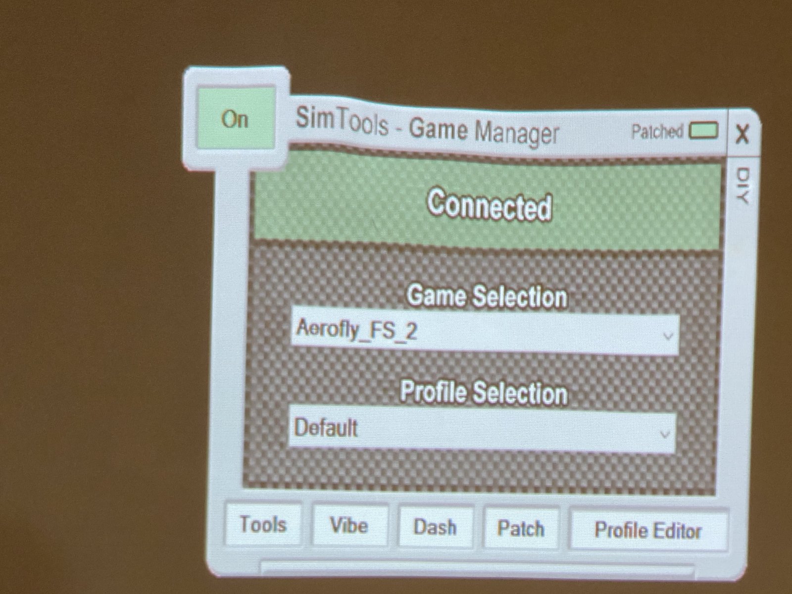

    Here are pictures of Game Engine with AF2 running. Before starting AF2, I was able to access Axis assignments, as soon as I loaded AF2, the GM screen changed, and I had no access to Axis assignments until I closed AF2

    There is no data getting to the Tuning Center Game Data - Output, try temporarily turning off your firewall and anti-virus, and see if that makes a difference.

    Thanks, but I don’t have anti-virus, and firewall was off, could it be a port assignment issue?

    Thank you for your willingness to help, the good guys at ProSimu resolved the issue with an updated plugin, 2.1.1.0, thanks again.
