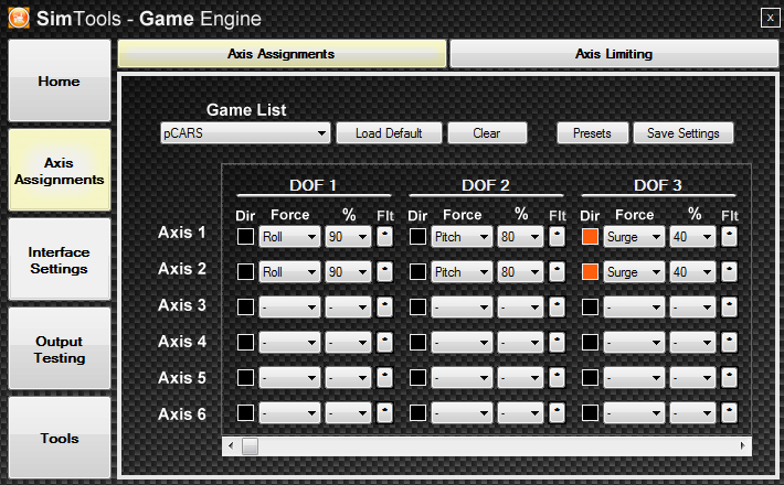

    Ive attached my settings. I have a frex simconmotion converted using the guide on this site. Movement is working in game engine but there is no movement in game.

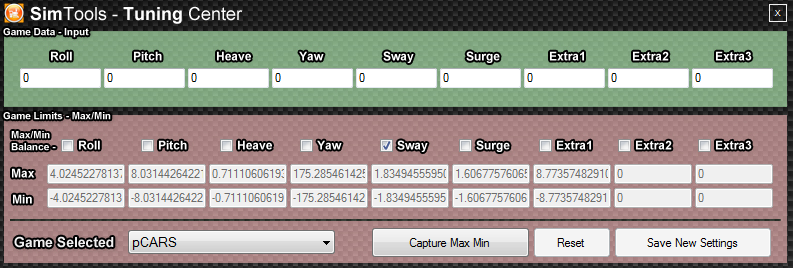

  14. jamiebird76
    jamiebird76 New Member
    Mar 30, 2015
    11
    36Coins
    2DOF, SCN5
    sorry for the delay in replying been busy with work. The tuning centre has helped but the side to side motion is lacking. When using the Frex software the feeling of changing direction was large and quite similar to the feeling in a real car, as was the feeling of chicanes. The simtools motion is lacking so id like to try and replicate the sideways G again. Ive ran the tuning centre in a bunch of cars from a mx5 to f1 car.
    On the good side the simtools is doing a great job replicating going up and down hills. Frex could never do that.

  16. noorbeast
    21,030
    147,878Coins
    +10,879 / 54 / -2
    Can you please post your full Axis and Tuning Center settings.
    From the limited info so far you seem not to have sway configured. Go back to your axis settings and turn everything off except surge, set that to 20% and test, adjust if needed until it feels right. Then turn it off and do sway by itself the same way, then heave. Try around 10% for heave in the axis settings and 0.5 in the Tuning Center. Then do roll and pitch last, keeping in mind that things like surge and pitch can somewhat cancel each other out when all axis are mixed. Refine in the Tuning Center when all axis are enabled.

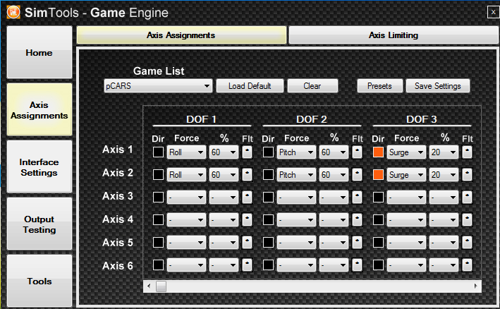

  18. jamiebird76
    Mar 30, 2015
    11
    36Coins
    2DOF, SCN5
    here are the settings. I have two SCN5 actuators. Im not sure the difference between the axis and the DOF and how they limit movement. When you refer to axis set to surge and sway should that be done on the same axis or on each DOF?
  19. noorbeast
    21,030
    147,878Coins
    +10,879 / 54 / -2
    Set them like you have, make DOF4 sway and DOF5 heave. Then followed the instructions I already gave, set the percentage at 20% for surge test and adjust in The Tuning Center with the others off, then sway and so on.
    You can go slightly over but you want to be as close to 100% when you total the % allocations together. Some people do not use roll and pitch, which does allow a greater % allocation for surge, sway and heave, but it is personal preference, I use them all.
