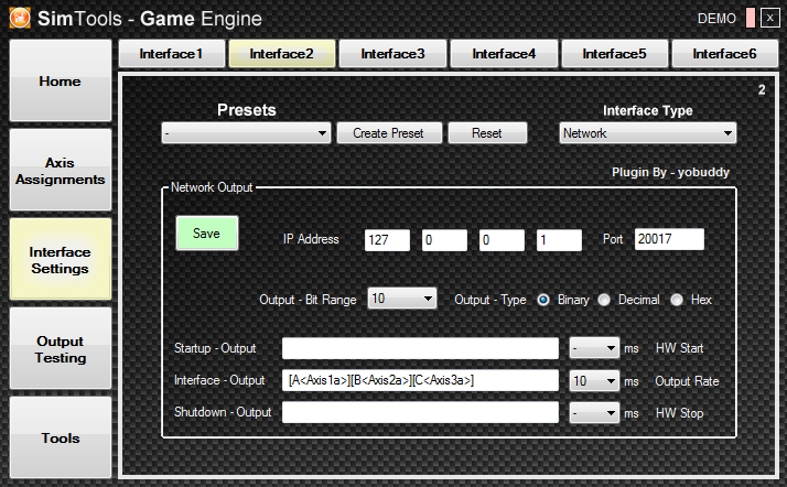

    Setup details:
    2DOF DIY
    Arduino SMC3 with single MM board
    SimTools 2.1

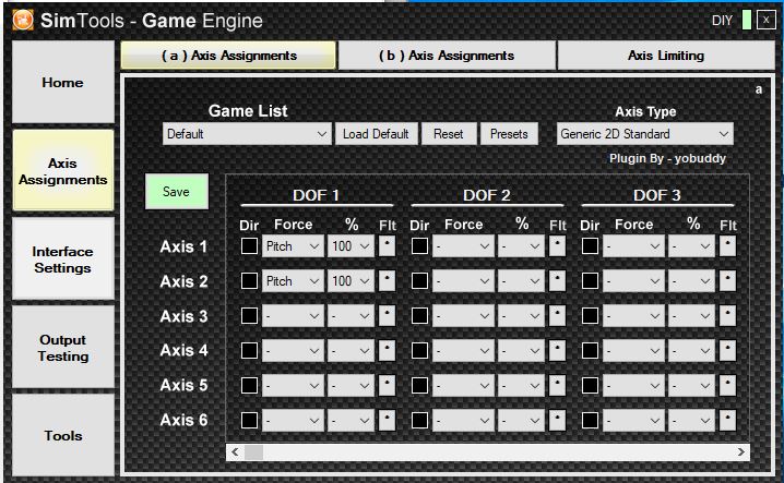

    Short story - I am able to get movement through the SMC3 Utility Tool BUT when trying to assign and then axis test in SimTools, I don't get any response or movement.
    To make it clear, all I am trying to do is go through AXIS TESTING in SimTools, i am not even interested in introducing a game environment yet. I have not set min/max values or anything like that in the game engine.
    HELP PLEASE - Where am I going wrong? What have I not set up? What have I set up wrong?

    You have defined 3DOF in the Interface Settings when you only need two, like this: [A<Axis1a>][B<Axis2a>]
    Can I check that you are using the Save button in Axis Assignments and hence only testing Pitch in Output Testing?
    I also want to verify that you are only running SimTools, and not the sMC3 utility at the same time.

    Ok, I will make that change. I had not seen whether it was required to have 3 axis defined in the software incase the arduino sketch was expecting to see 3 input commands.
    Correct, only output testing. I was just trying to induce some movement and instead of complicating things - 1DOF at a time to prove things. I have tried with Roll (1 x in reverse) in the same manner but no difference to outcome.
    Correct. Test with SMC3 utility, shut that down, open SimTools, test there.

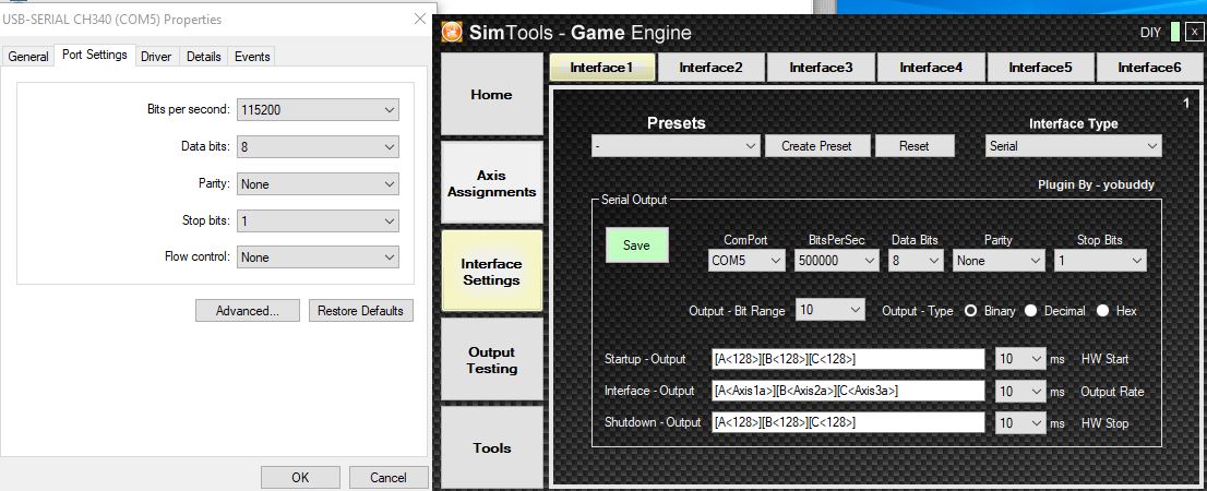

    Hi @yobuddy, thanks for the response and a massive apology for the delay in response. Life got in the way and a PC rebuild was required for another reason...
    So I have started from scratch effectively and everything is freshly installed. Confirmed that SMC Utility Tool is showing response from the motors BUT still the same issue of no response from motors through SimTools.
    In answer to your question - no, I don't get anything from output testing when in "(a) Axis Output" mode.
    Can you confirm if I need to go through the arduino code and comment out anything relating to a 3rd motor? I am only specifying 2 x axis in sim tools as suggested by @noorbeast

    Your settings look right.
    I'm not sure if you need to comment anything out.
    It's been a while since i played with SMC3.
    What antivirus and firewall are you using buddy?

    Try Add Interface 2 with settings:
    And run SMC3Utils in UDP pass tough mode
    Try Output test with running SMC3Utils

    Hi, @Radioproffi, thanks for your response.
    With regard to the Utility software, do any of the settings matter when its set to UDP pass through mode? Utility settings.PNG
    I have tried what you have suggested with the above attached settings and I'm not getting any visual changes in the utility software nor am i getting any movement

    There must be your settings. Pls increase PWMmax = 200
