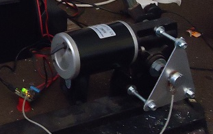

    I am trying to set up a 2 DOF simulator using Pololu 12v12 cards.
    I haven't had much luck in the past using potentiometers. I don't have a good sense about how to limit the range of motion. Somehow the motor arm always swung too far and ripped the pots apart or popped the glue holding pot to the motor hub.
    To get around this I made Hall sensors. Since there is no physical connections to ruin, I can tweak the Hall sensor manually to limit the range. I actually moved the sensor head within the magnetic field to get the range right. This worked well for the first motor-Pololu pair. I can control the motor via mouse through the Pololu software or X-Sim.

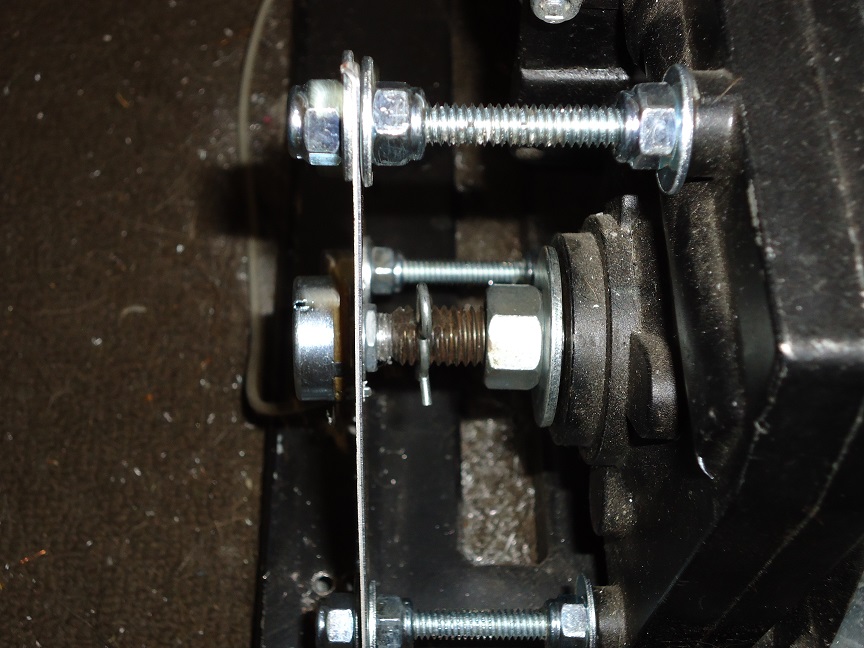

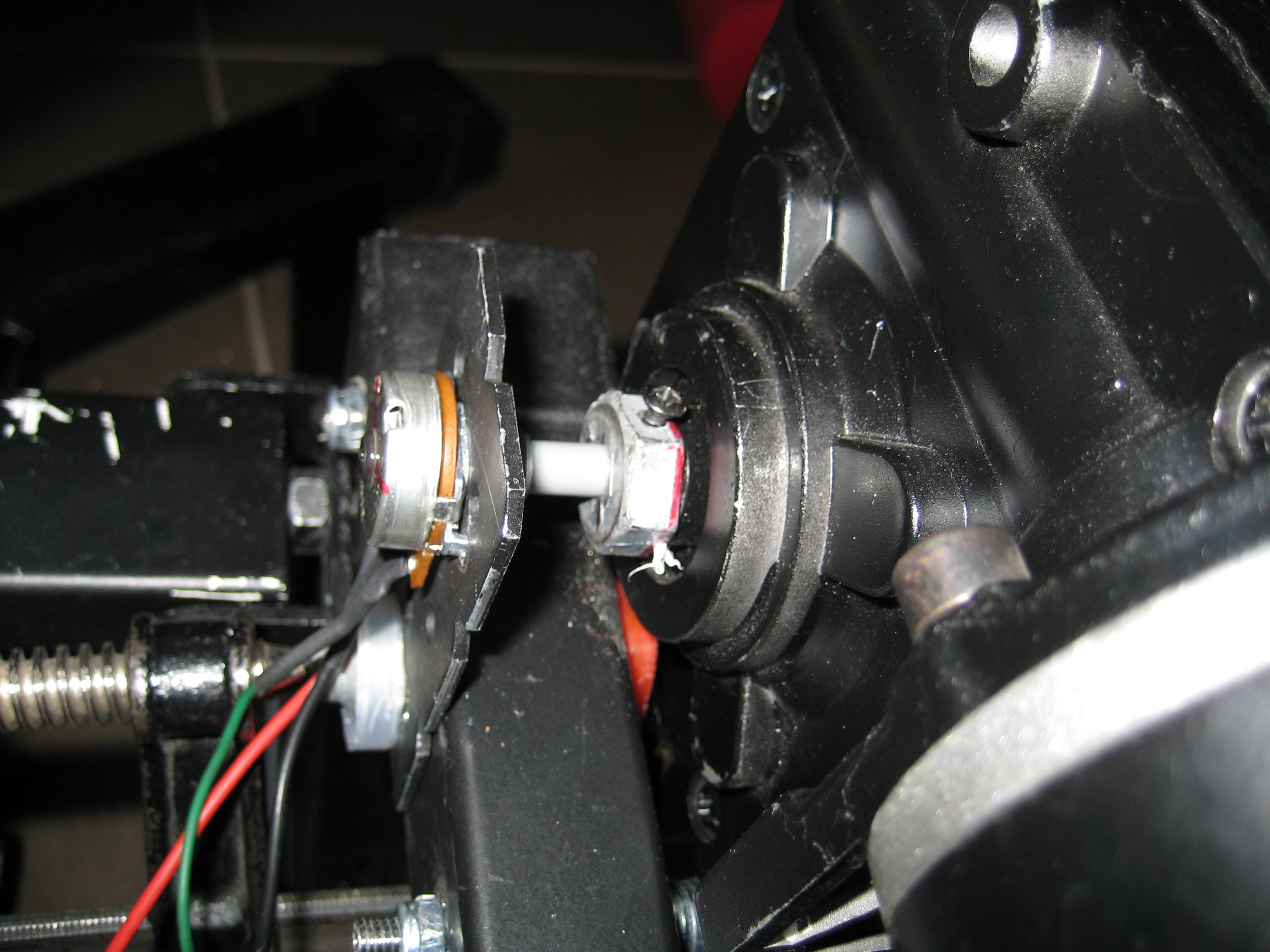

    I use pots successfully here.
    On a seat mover running Jrk12v12.

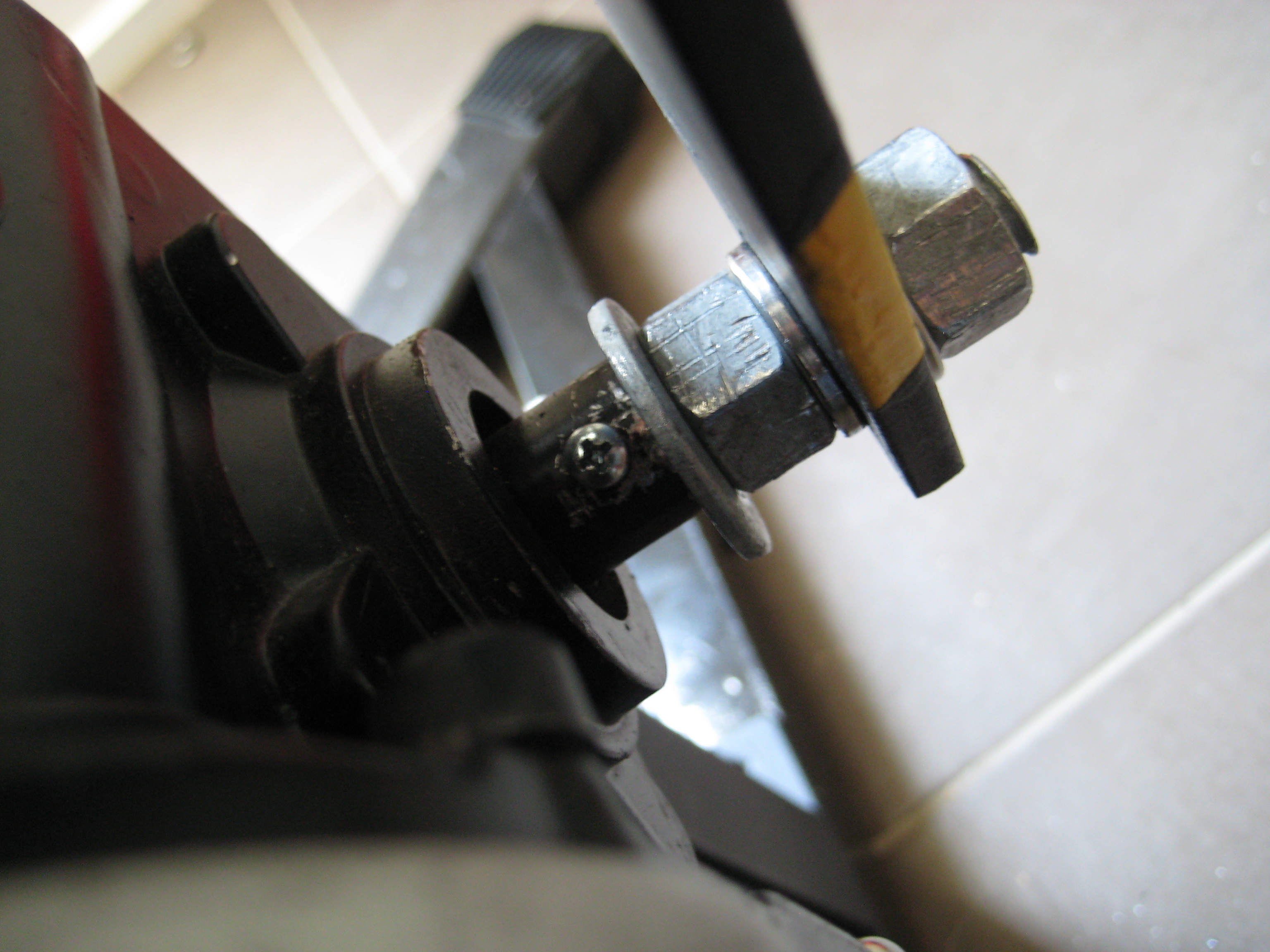

    1. My homemade hall sensors worked well on the bench but their angle of rotation was quite narrow compared to an old fashioned rotary pot. So I changed back to pots.
    2. The epoxy I was using to cement the pot arm into the motor cracked repeatedly. The best way to mate the pot arm to the through-bolt in the motor is to fasten it with a screw. See Eaorobbie's picture above. He's drilled out the through-bolt, slid in the pot arm and run a linchpin through both.
    3. Don't forget the same trick for the through-bolt and motor. I forgot to do this. The motor rotated but the through-bolt was just clattering about. There's a tiny 4mm hole in the axle sleeve for this. Make sure you have a strong linchpin for this. I was just using a nail which sheared off due to the torque.

    Thats the right idea, myself I turn the bolt the other way around so I can weld the lever to the back of the bolt head and drill out the other end to mount the pot through, just beware the torque of change of direction these motor will produce might undo the nuts.
