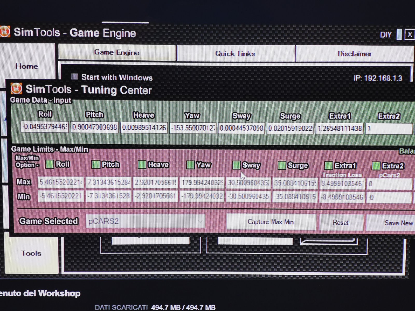

    Hello, I have builded a 3dof simulator. The third motor is for yaw or traction loss...
    All works, but the surge power don't move motor, but in test level there are the telemetry parameters.
    In another game, dirt 2, surge works well.
    There is a problem with pc2 plugin?

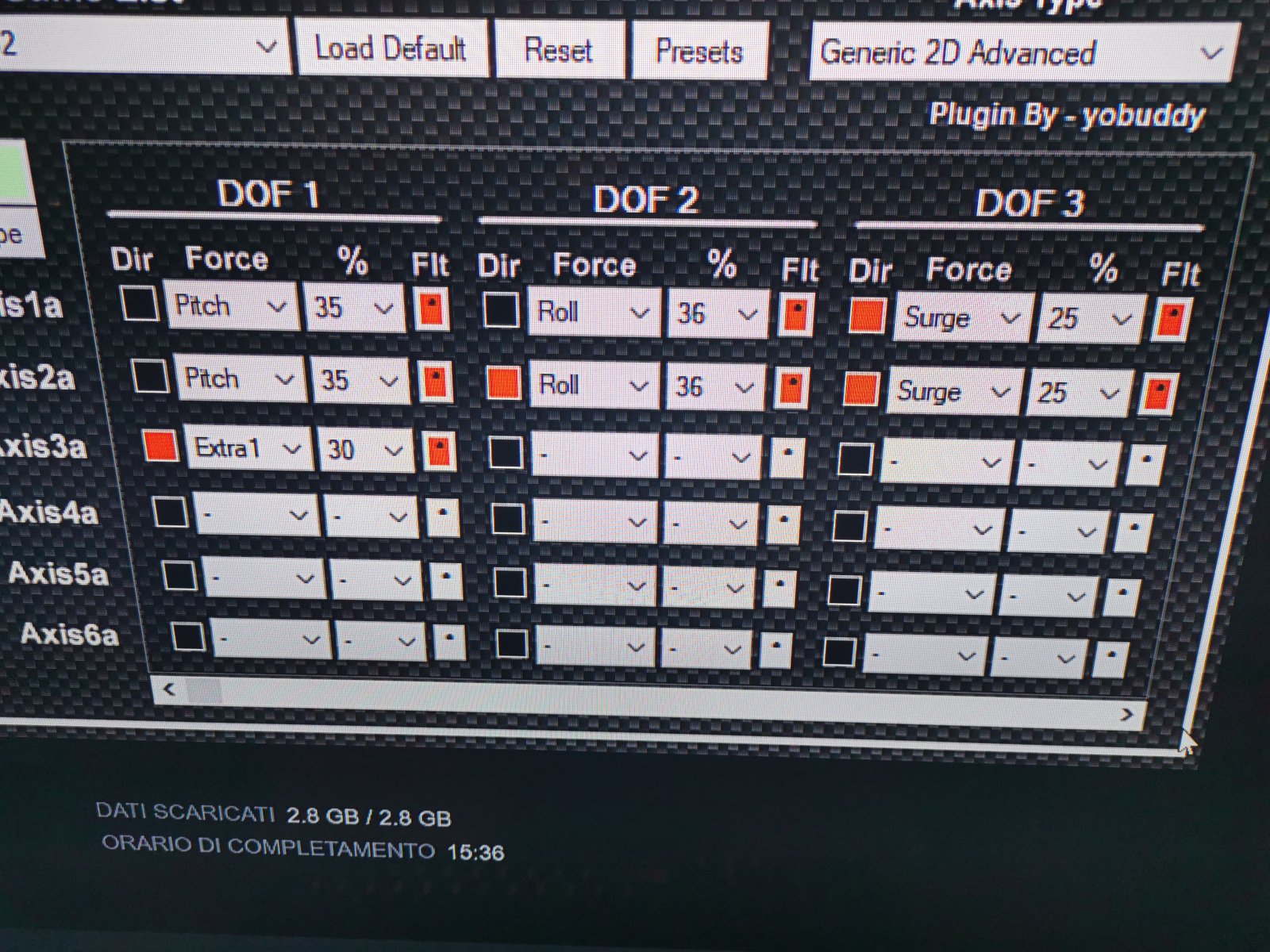

    Please post pictures of all of your settings, including Axis Assignments and Tuning Center.

    This is my settings

    Your Tuning Center values are way too large for surge, and I would suggest sway also. In some games I even have surge values less than 1.
    Follow the tips here, especially capturing Max/Min values in the Tuning Center as a base, then initially tweaking each axis individually: https://www.xsimulator.net/community/faq/steps-to-create-a-motion-profile.228/

    Thank you noorbeast. Sorry for the late answer. I have tried but now i have a very very low motion on surge. i have to put the gain high to have a motion.....low....but motion.

    Did you capture the Min/Max in the TC?
    What TC value do you now have for surge, as it was originally way too high? Try 0.5, that should liven it up, then tweak from there.
