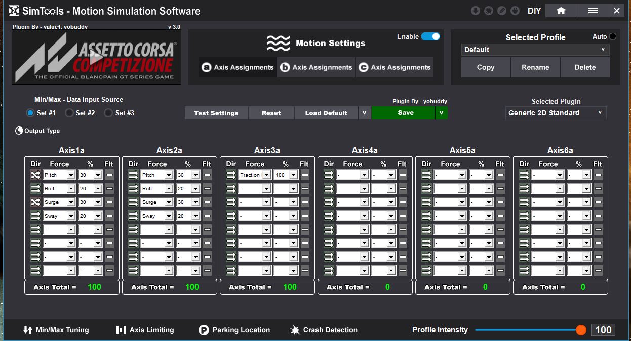

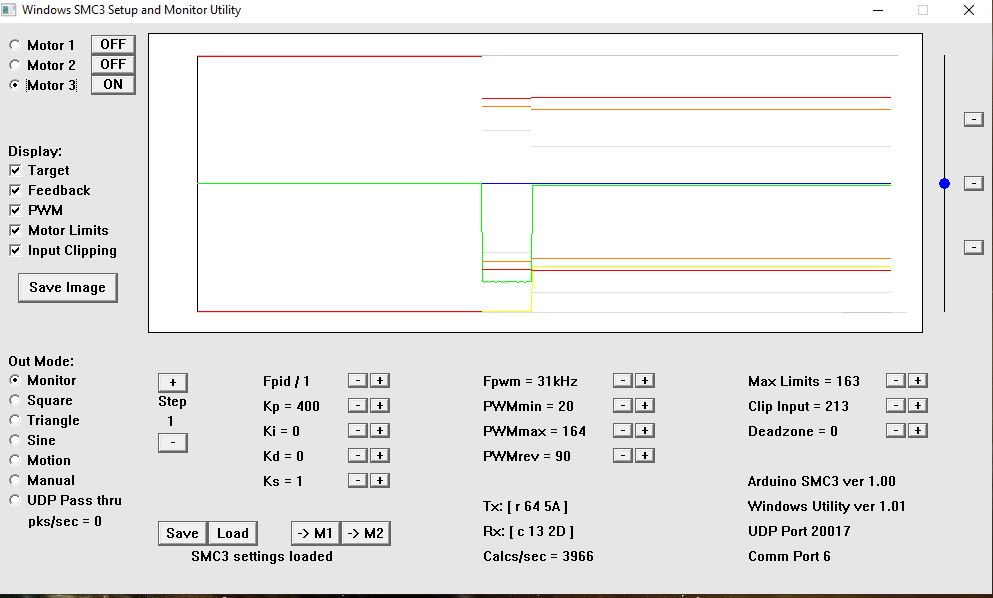

    I am having trouble with my 3rd motor when trying to test my settings in simTools. Right now, when I go to SMC3 and test motion on the 3rd (traction loss) motor, i get lots of movement.
    But when I test motion in simTools for this motion which I think should be set as Axis3a traction 100%, I get no response from the motor.
    Is there a setting I am missing?

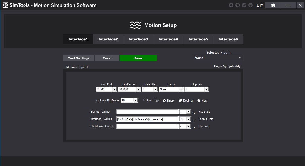

    I have my Interface output set to "[A<Axis1a>][B<Axis2a>][C<Axis3a]"

    Maybe the 3rd motor needs to be set under "B axis assignments" instead of A? They are all being controlled with the same arduino thoough so all on the same COMM. I am at a loss

    I got it!! And it was "user error" haha.
    If you look at the screen shot of my Interface i have:
    Well, this should be:
    "[A<Axis1a>][B<Axis2a>][C<Axis3a>]"
    not the missing ">" for the 3rd axis. Oh man! I am so pumped haha.
