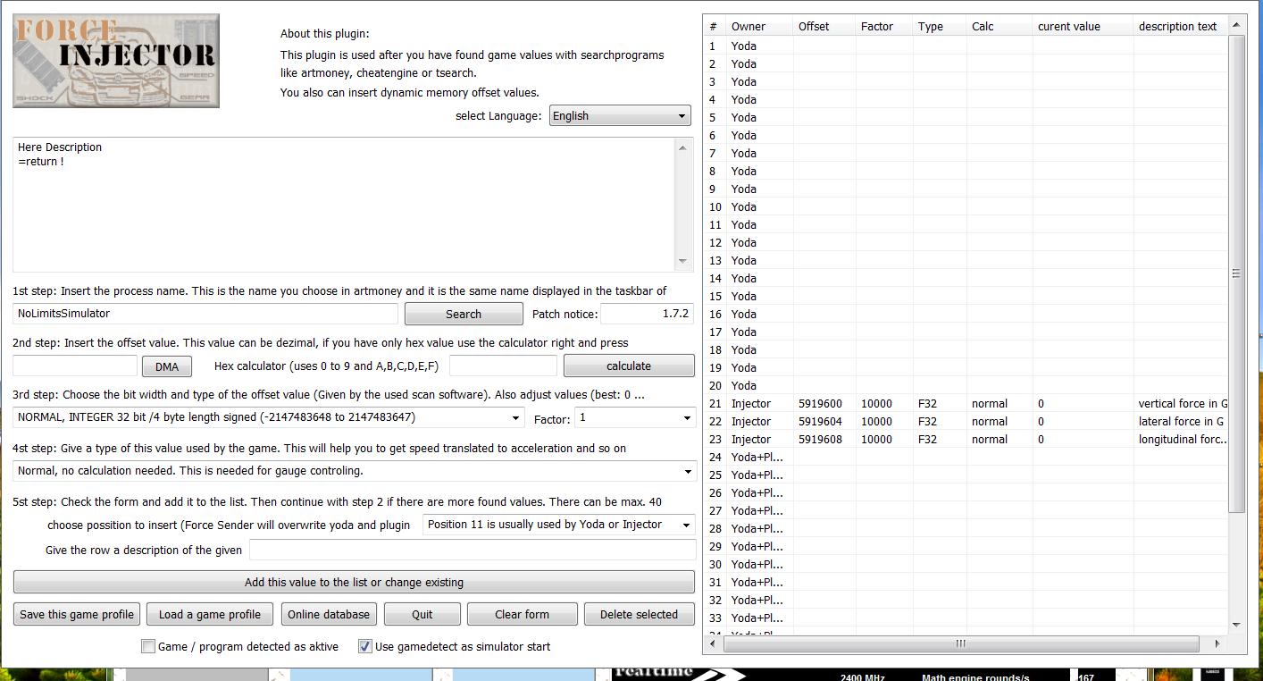

    @Charly
    I assume that you have loaded the Force Injector via the Sender checkbox and have retrieved the version of the NoLimits profile that matches the version that you have installed. Also, I assume that you are using X-Sim 2?

  13. bvillersjr
    bvillersjr Active Member
    Oct 11, 2008
    1,174
    Ohio, USA
    437Coins
    +23 / 1 / -0
    Please verify that your settings in the Force Injector Look like those in the image below. Also, not to state the obvious, but please be sure to press the send button in the sender. If you duplicate the settings on the screenshot below exactly, you will not need to press start in the profiler.
    Try setting the screen to windowed mode in NoLimits and choosing a low screen resolution, like 800x600 temporarily so that you can see what is happening with the sender, profiler and injector while NoLimits is running.
    Also, you can try the profile that I uploaded for NoLimits as well. It is here:http://www.x-simulator.de/forum/simxperience-ii-nolimits-profiles-t1343.html
  14. charlypro
    charlypro New Member
    Jul 19, 2008
    46
    California
    0Coins
    Thank you for your help I solved the problem I unistall the X-sim2 and install the new version and start to work so may be was something wrong with my old version so now is working thank you again.
