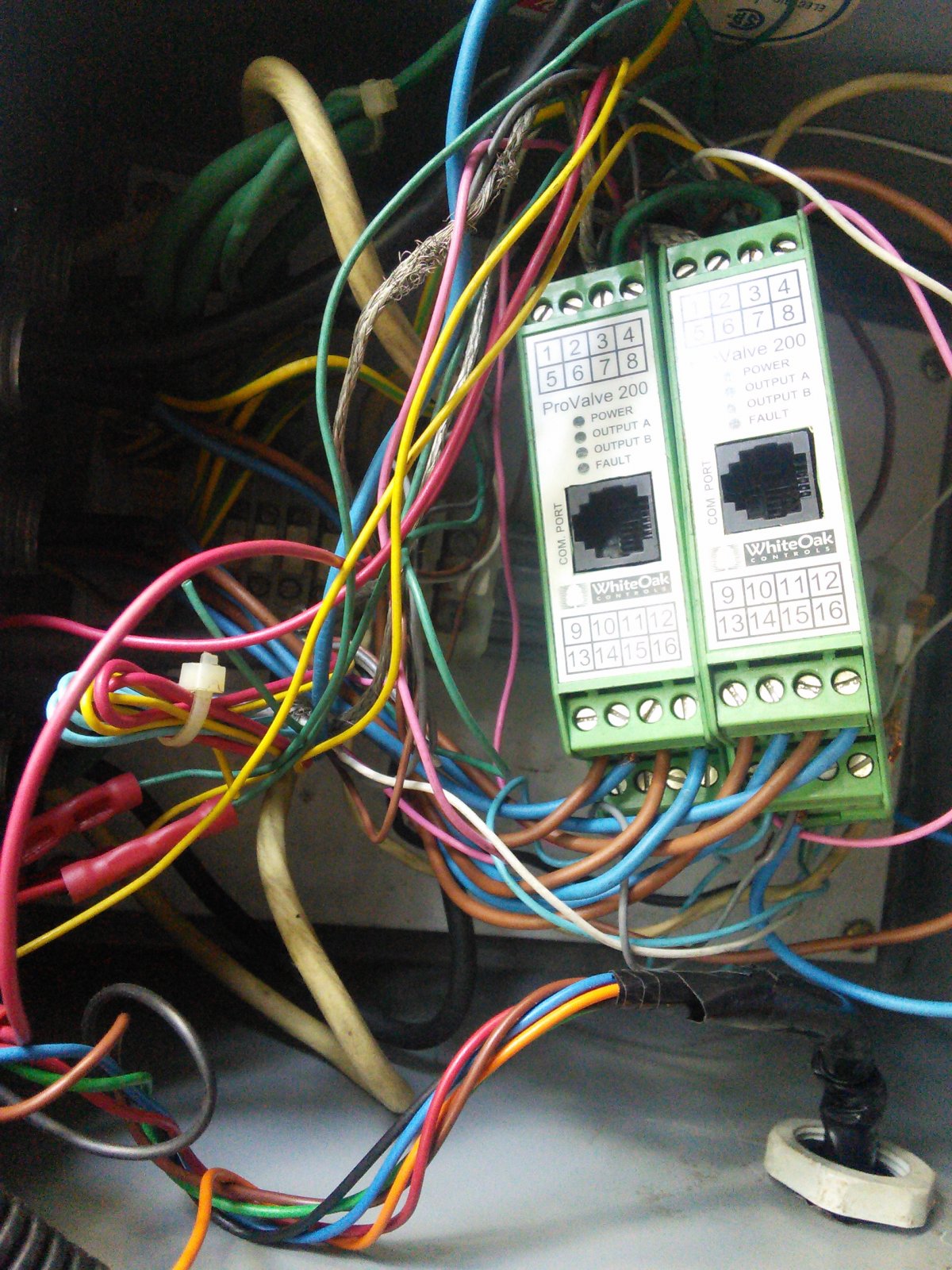

    These are the ProValve 200 valve controllers:
    I have pics of the hydraulics and feedback components on my phone which I will upload in another post from the phone.

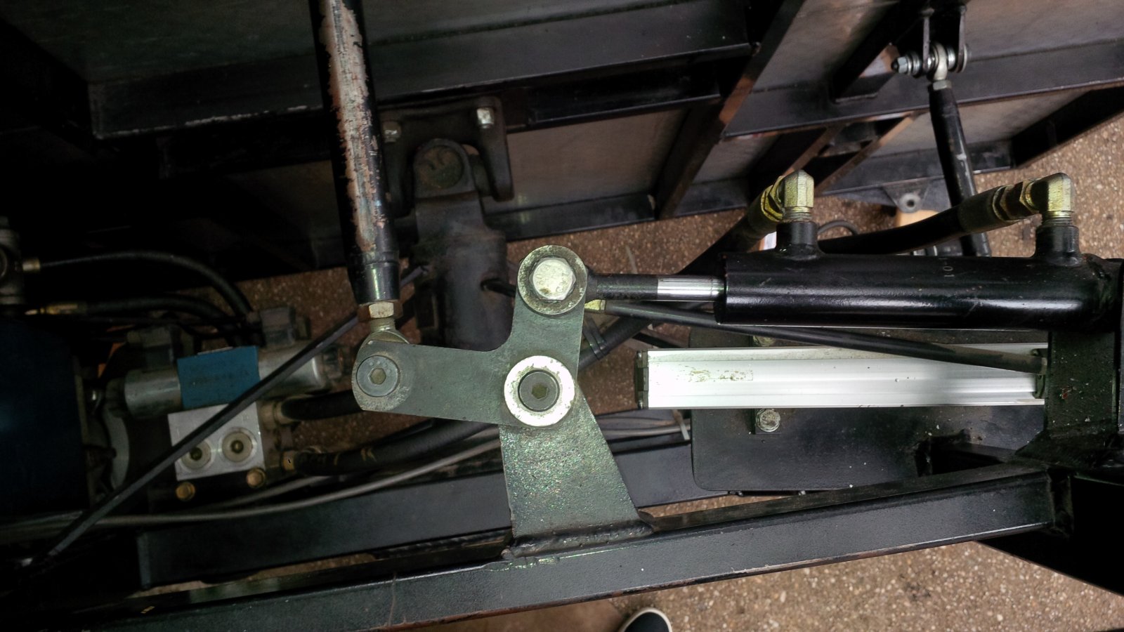

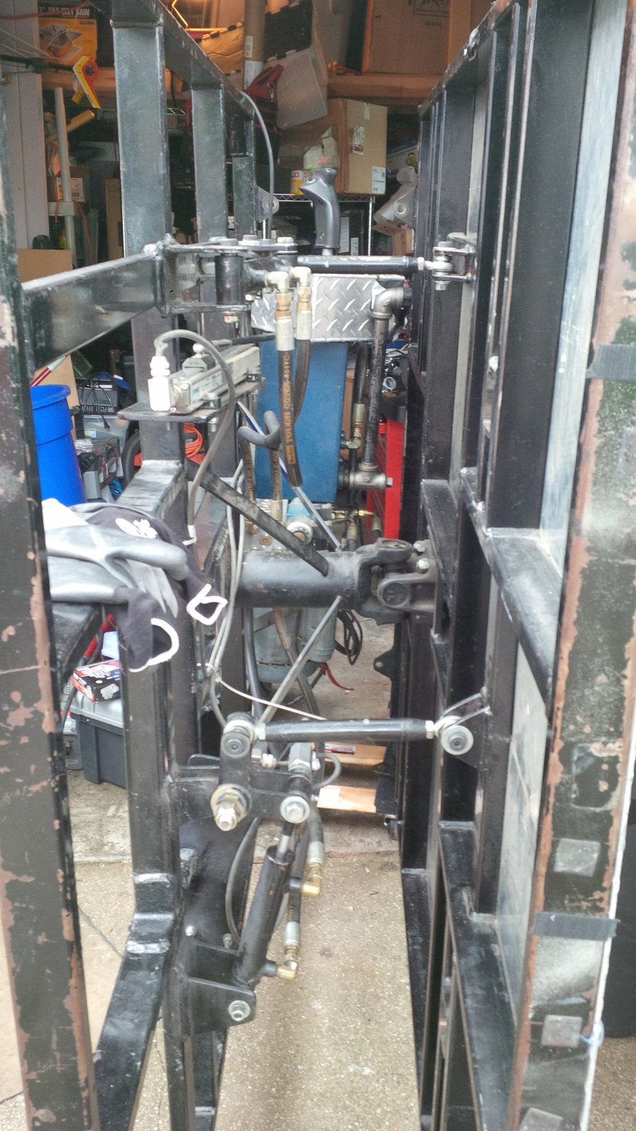

    Platform design has universal joint in center, two pistons; one for tilt and one for roll. Each piston is rigged to a bracket that transfers motion to both the platform via connecting rod and to the linear feedback pot via another connecting rod.
    Pump is a large hydraulic motor that runs continuously, of course, while platform is in use. Each piston has two valves ( one for in, one for out) that are both controlled by a single ProValve 200 which combined with the linear pot creates a servo mechanism.
    PV200 is designed to control a single piston in two directions by switching on and off, the dual valves. Analog input is compared to the feedback resistance and the PV200 activates to correct valve till the piston ( and the feedback pot) move to the correct position.
    This particular setup is somewhat self-contained thanks to the PV200s. My input need only to be a voltage... I do not need the arduino to handle feedback... I just need it to know where the platform is "supposed to be" and send that corresponding voltage.

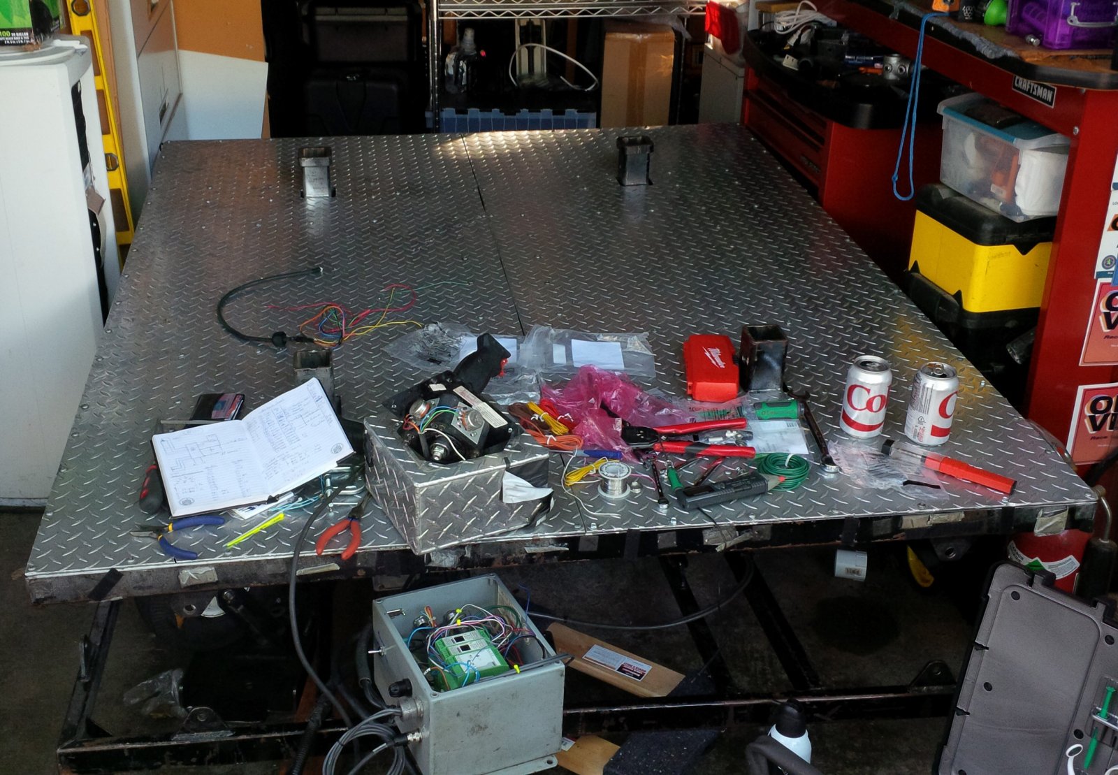

    Here are some more photos and details as promised.
    This first picture is an overview of the platform from the top.
    This is an overview of the mechanism(s) on the bottom of the platform. The platform was turned up sideways when I took this picture. (the top of the platform is on the right of the photo) You can see in this picture the u-joint in the center, the tilt piston and connecting rods on the foreground-right and the roll piston and connecting rods in the background-left.
    Here is a closeup of the roll piston - you can see where it connects to the swivel bracket where it transfers the direction of motion. Also, under the piston, you can see the linear potentiometer (position feedback) - you can't see it, but there is a connecting rod worked into the linkage that allows it to slide up and down the linear pot when the platform tilts or rolls (respectively).
    I have fully gone over and analyzed the current setup. The valve controllers (ProValve 200) have a built-in feedback loop system. According to the specs, the input is supposed to be 0-5v or 0-10v - I tried connecting my computer to the PV200s to see their configuration settings (done through a COM port) but I couldn't connect - I may have made a bad cable - so I can't see what analog voltage it is currently setup for... however there are some issues with the current setup.
    Issues with the current setup (besides the fact that it is manual and I want to control it with a computer)
    As I mentioned earlier, the current setup is completely manual - there's an analog joystick and the platform moves in relationship to the joystick. The electronics in the joystick are simply 2 100K pots - one for tilt, one for roll. The major problem is that whomever wired this thing initially, ran +24v (directly from the PV200 power supply) to the pot and then the sweeper is connected directly to the PV200 analog input. As you can imagine, the range on the pot is VERY SMALL. (if GND is on one end of the pot and 24v is on the other - only the first 20% of the movement is useful.)
    Since I can't log into the controllers to see their current settings, I don't know if they are set for 5V or 10V, however in testing, I noticed that it is all the way in one direction at .4 volts and all the way in the other by 1.5v. Basically, it takes only a small fraction of movement on the joystick to complete the full range of movement on the platform. An even larger problem with this situation is that I think the linear feedback pot's response (though connected to the same 24v power source) is a bit longer than the range of movement on the stick... thus attempting manual movement with precision is nearly impossible currently.
    Clearly there are limitations with the current setup. I am not sure if the limitations are in the PV200 or the fact that this whole thing is (I believe) wired incorrectly because of the 24v input to the pots. - Plus, I don't know how old these components are, so the joystick pots could be warn, too. - But my plan is to automate the thing.
    So as I said earlier - My hope was to just use the Arduino to feed "position voltages" into the PV200 and let the PV200 do the work of making sure it is in the right spot. However... there is another possibility: The ProValve 200s also have a Forward and Reverse override input. Basically, you supply a voltage to these inputs and it simply turns on the appropriate solenoid.
    Now I am wondering if I should just use the Arduino to perform switching and feedback (run the linear pots directly into the Arduino instead of the PV200) and just use the PV200 to take the low voltage input from the Arduino and control the valves - the same way someone might use an h-bridge to control a motor.
