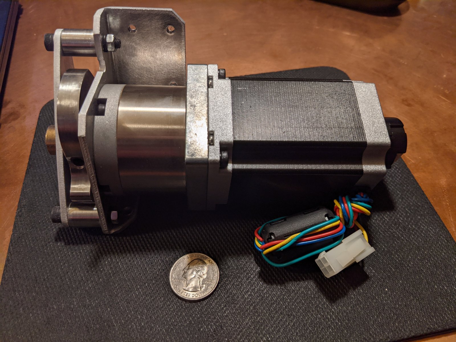

    I recently purchased a GS5-G seat and G-Belt system that I added to the 5 dof SCN6 rig I built. Unfortunately, it seems that flight simulator support (X-Plane & DCS) for these things is non-existent, and I can't say I'm thrilled with the simcommander software. I was able to figure out the interface for the SCNs because there's plenty of info out there. The G seat & G belt not so much! I'm determined to figure this out myself, and I'm not afraid to cut this thing up, void the warranty, or any of that garbage. It's just a pile of motors, controllers, and wires, so there must be a way to make this thing work.
    Here's my total noob punch list:
    1. Figure out what type of motors are on these things
    2. Figure out what type of motor controllers are in these sealed black boxes they gave me
    3. Learn whether or not simtools can interface with the provided controllers
    I can't seem to find anything useful out there, as so few guys dropped the coin for these things, and it seems like they are all iracing types and so are happy with the simcommander interface. Any help anyone can provide is appreciated, I plan on tearing into this thing over the weekend.

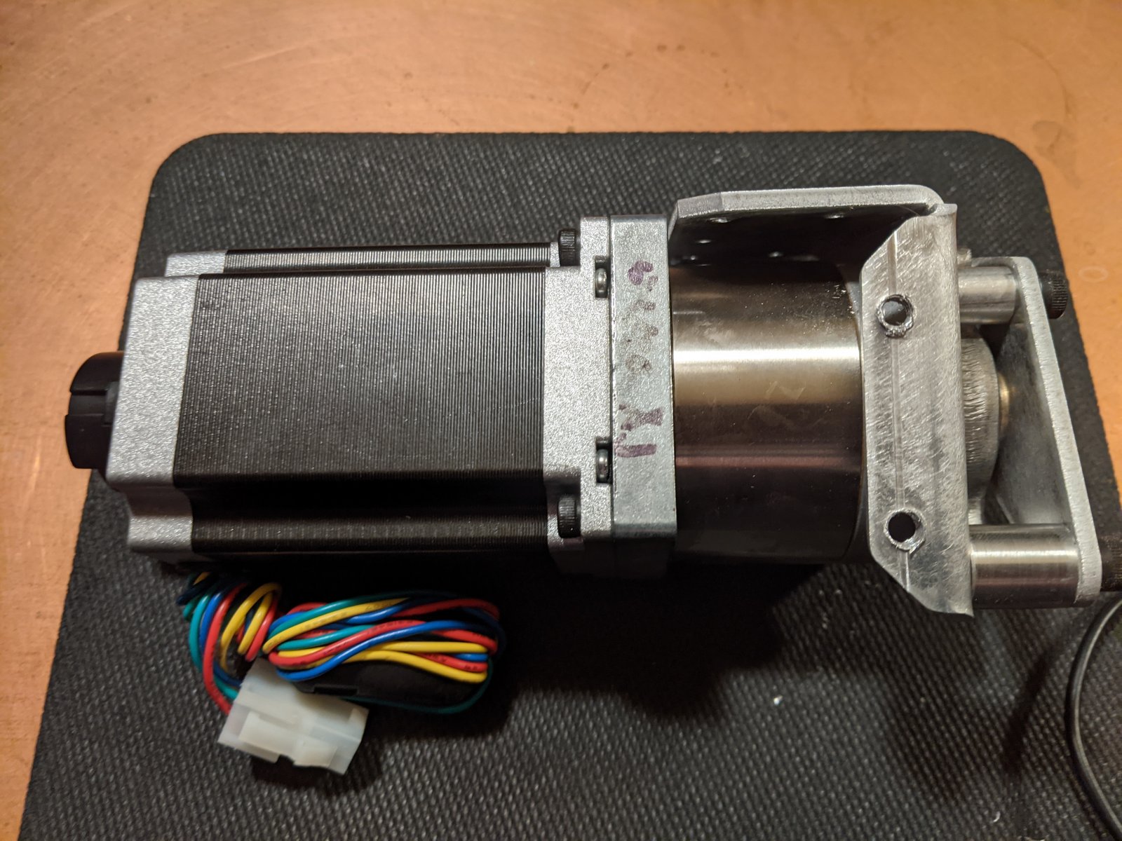

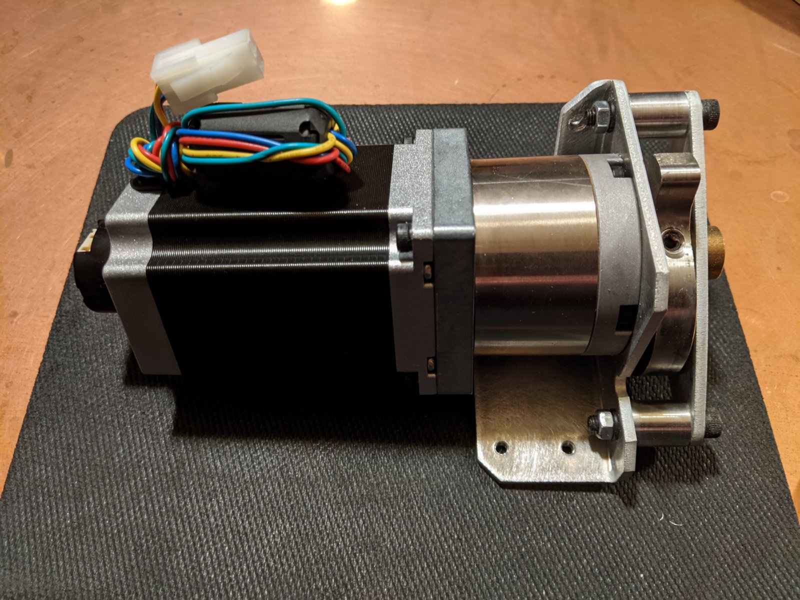

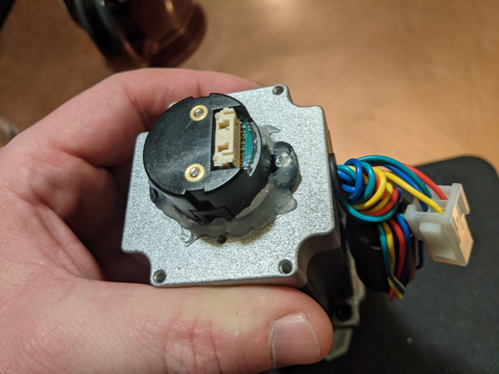

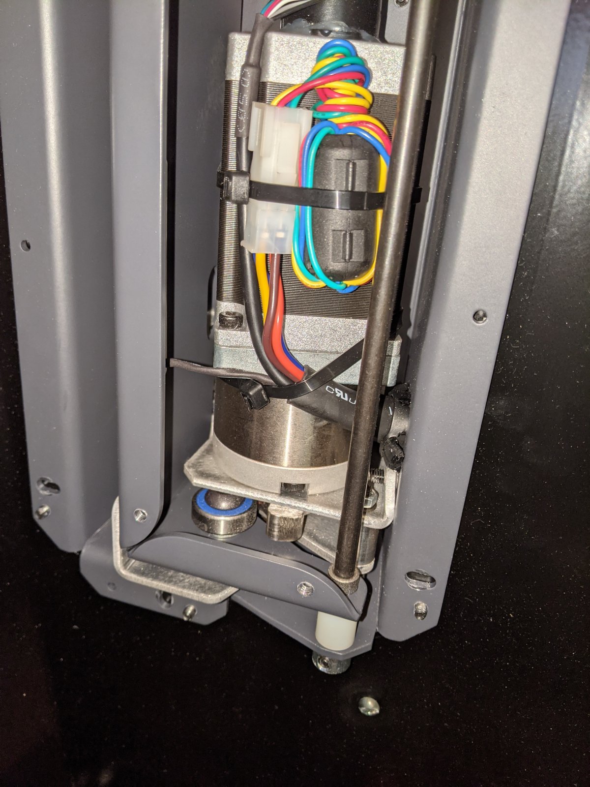

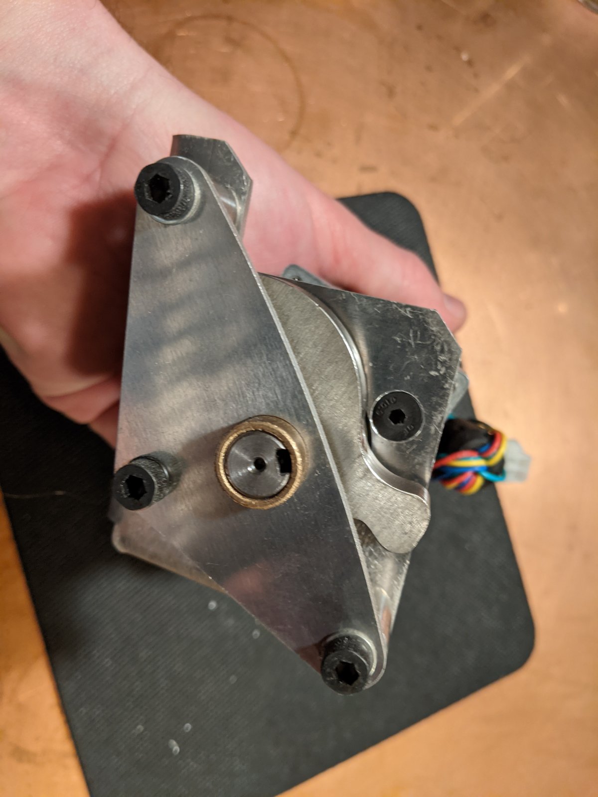

    So say we throw out the simxperience/simcommander interface and start from scratch. Below are the motors, 4 of these guys in the seat, 2 in the belt tensioner.
    No markings on the motors, but I'm guessing someone here could id them. Keeping in mind that I'm more caveman than programmer, what can I do to drive these using a simtools friendly interface?
    I have a Thanos board on order, as well as the materials to build 4 SFX100s and a traction loss. My current home built 5dof is SCN60 based, and I've overloaded it with the 100lbs of added G seat and G belt.

    So it sounds like its running 6 motors total, i only guessed for 4.
    We could probably do it just like the guy did with the v4 seat thread.
    Get a serial port sniffer and capture what gets sent to the seat.
    Save the output as a text file.
    Top line would probably be what to send for startup.
    Bottom line would probably be what to send for shutdown.
    Any one in between would be a movement command.
    Anyway, that's where i would go next i think.

    if not, here is my thought. You can ditch the whole control module from GS-5 and buy 4 of this stepper driver. STEPPERONLINE CNC Stepper Motor Driver 1.0-4.2A 20-50VDC 1/128 Micro-Step Resolutions for Nema 17 and 23 Stepper Motor
    and use arduino or whatever microcontroller you want to send pulses to the stepper drivers.
