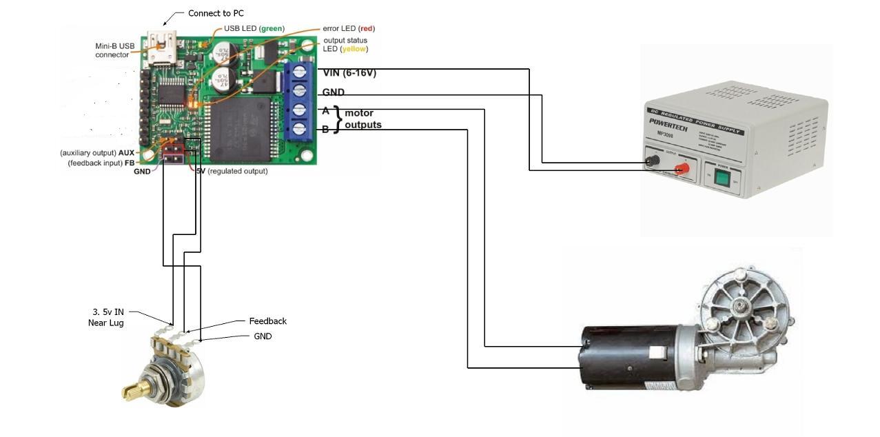

    Ok if you are not the best with electronics like I am, use these control boards
    http://www.pololu.com/product/1393 one for each motor. will handle 14v at 30 amps continuous all day with heat sink and cooling. Several of us run them on the larger DC motors like you are looking at.
    Wiring diagram

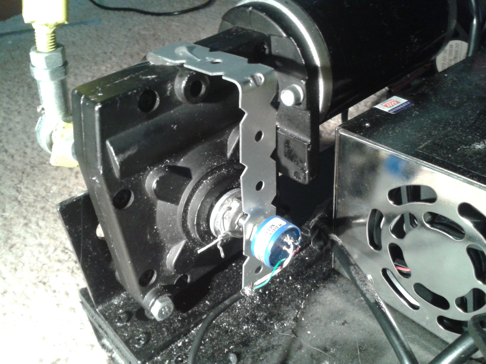

    get some 5k ohm single turn 360 deg turn pots like this
    http://au.rs-online.com/web/p/potentiometers/1642661/
    mount it on the back of the motor shaft bolt.
    best thing I found is drill a hole into the centre of the bolt to fit the pot shaft, then drill and tap a 3mm bolt hole on one side and screw a bolt in to hold it.
    In the picture I ran a piece of wire through though. i found it quicker to just tap a small bolt in to hold the pot shaft.
    Power supplies are about right, allow 12v 40-45 amps each motor.
    @Nick Moxley uses re-wired server PSUs, so he can advise there.
    I found these successful http://www.ebay.com.au/itm/110V-220...68828?pt=AU_Lighting_Fans&hash=item1e8fc8035c
    and I use one per motor.

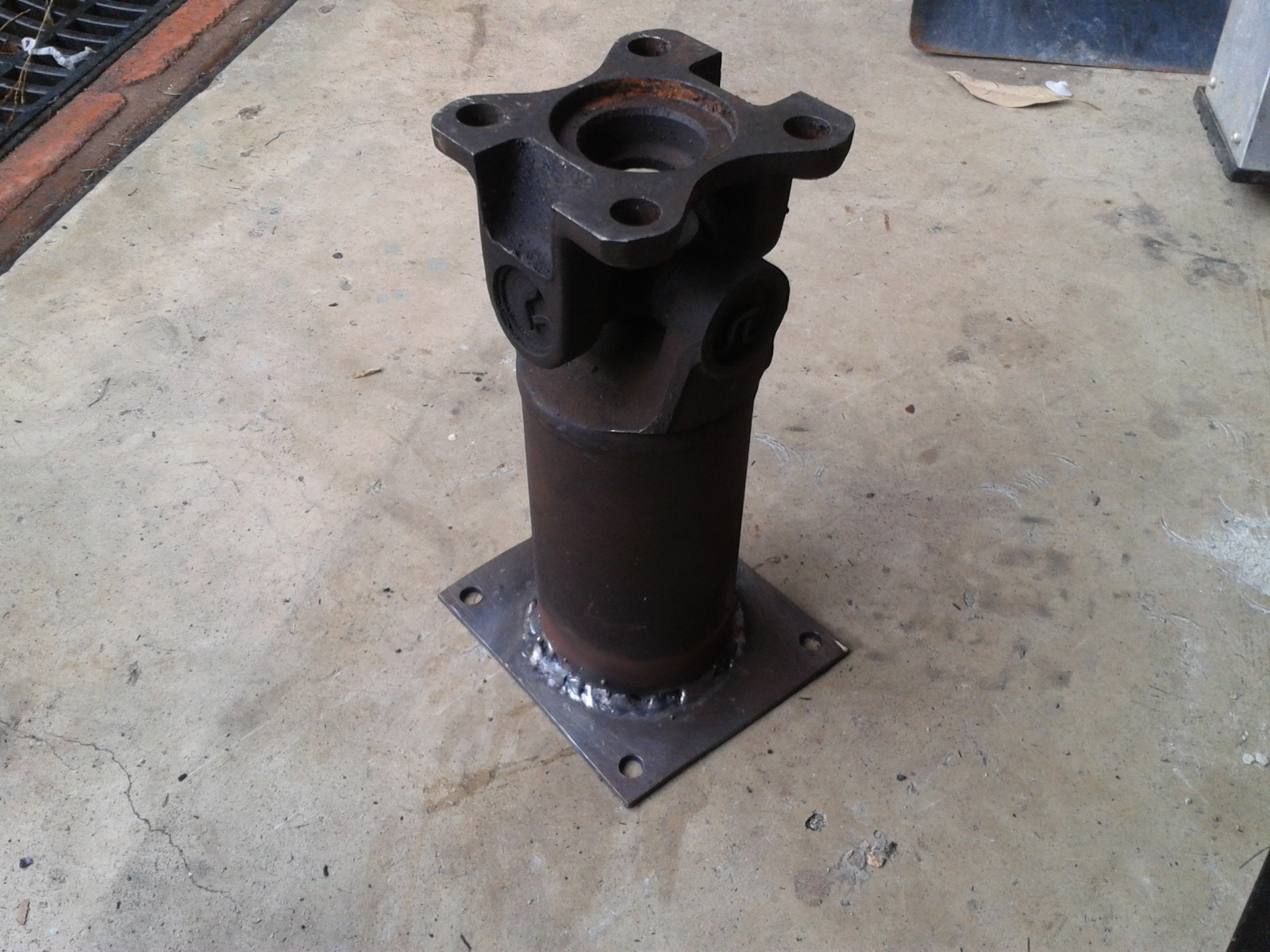

    Pivot to make a 2 DOF frame is best use a cut down rear wheel drive shaft with a half decent uni joint in it. I bought a whole shaft for $20 from the local wrecking yard so shop around. I asked for rust and cheap. Unis were ok, so that does the job.
