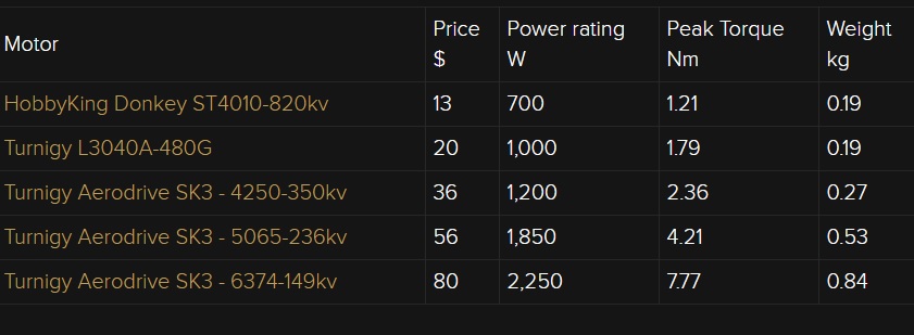

    I asked the guy what do I need to use it with Simtools:
    "There is a USB Serial port that should be able to receive commands (position, velocity, and/or force). You may need to make a simple protocol to interface with your PC software, but that should be quite easy."

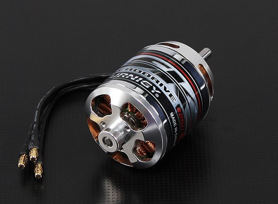

    Some of the motors suitable for this controller and also for our application:
    Turnigy Aerodrive SK3 - 4250-350kv
    Turnigy Aerodrive SK3 - 5065-236kv
    Turnigy Aerodrive SK3 - 6374-149kv

    Sorry, I don't understand what you mean, maybe has to be something with this? :
    The guy sells not only the driver (U$S120) but also a motor and encoder Kit for U$S80 (the motor is quite powerful at more than 2NM and even more considering its maximum speed of 8400rpm so you can actually make a 2x1 gear to duplicate that and still get over 4000rpm).
    I don't have any relation to this project, I just think it would be great is this kind of motor can be used as they are not only cheap, but also lightweight enough to import from anywhere.
