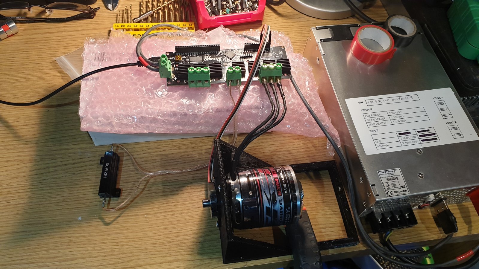

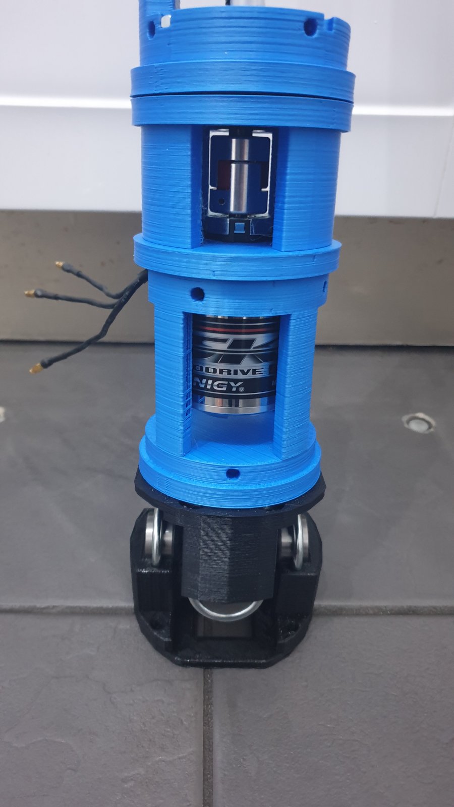

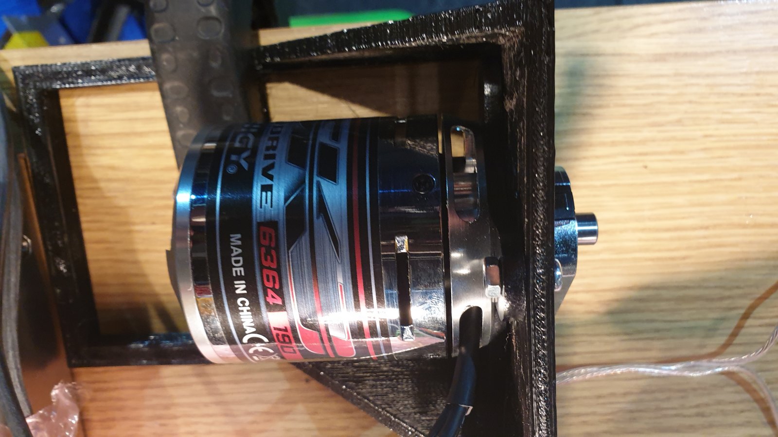

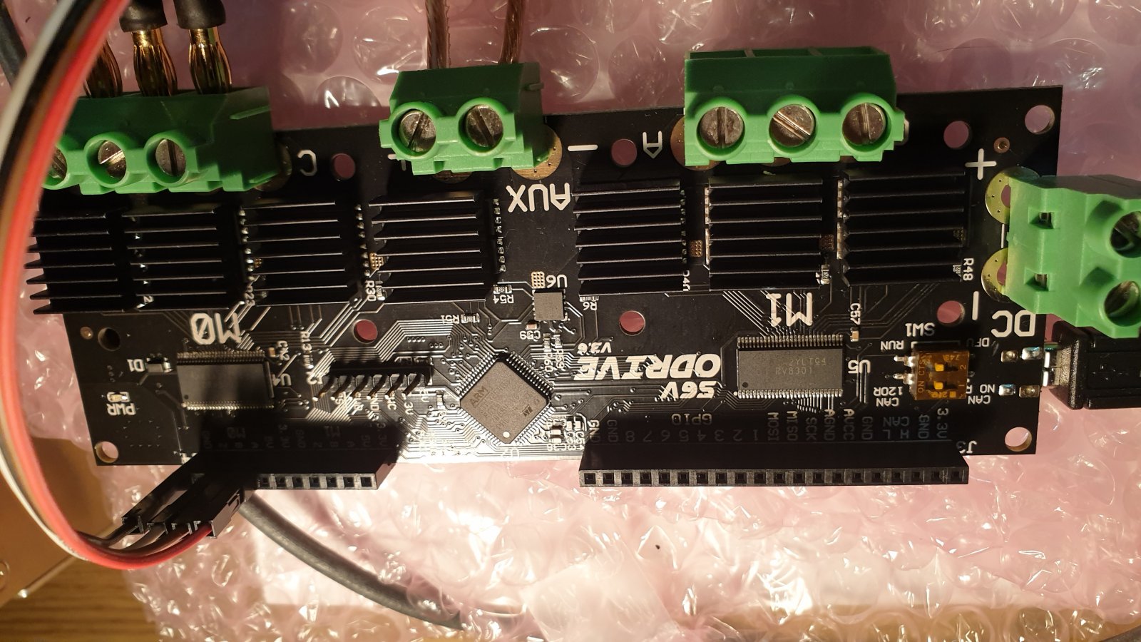

    Time for me to upgrade so I have been watching and reading to see who I can copy next :D and it has to be the ODrive path.
    I was going to go 24DC but after seeing @PeterW and @Carelsbergh_Stijn projects my mind was made up.
    So I'm in the early stage and just wanted to get my head round the ODrive and how all this shit works and I have got it working with FlyPT mover (video below)
    Reason I chose these is they are very small and I can make a very small compact actuator for my limited head room.
    I thought about the SFX servo motors and Thanos AASD but that's just not for me and that horrid whine would drive me crazy.
    So here's what I have so far and a plan in my head which I will have to make in sketchup at some point because I will be 3D printing a lot of my parts.
    20191012_211242.jpg 20191012_211237.jpg 20191012_211020.jpg 20191012_210910.jpg 20191012_211353.jpg 20191012_211348.jpg 20191012_210945.jpg 20191012_211012.jpg 20191012_211004.jpg
    Cheers all and here's to the next one !!

    Man, you really did it!! :thumbs I can hardly believe how fast you got this far!
    You will see the great potential in the BLDC motors and in the Odrive and I am glad that someone that is as famous as you would like to go this way.
    With the setting of the Odrive parameters I can help you and maybe also Stijn and Zennix (in the Odrive forum) .
    I already walked through the Valley of Tears - and think you don't have to do same. The basic work is already done.
    I once created a table with some important Odrive settings that can help a lot understanding the syntax of the setting-commands:
    https://www.dropbox.com/s/0j904viqwh77yyb/Odrive-commands.ods?dl=0
    If you want to use limit switches - and I think so, you have to use a Odrive-Software branch that supports the Endstops. I could forward you a version I got from Zennix that works stable with the endstops.
    Wickie

    I have just seen that you ordered 190kV engines. Weren't you going to order the 290kV engines? The 190KVs are little slower but could work anyway
    Wickie

    Yes I will need the end stops I have read the forum over at Odrive is it Watermelon whos branch that has the end stops built in ? I'll be sure to give you a shout as soon as I'm somewhere near having to flash the new firmware
    I changed my mind and went for more torque and higher voltage so I have a 42v PSU which I will turn down hopefully to a max of 37v to match the motors. I will still have a over 6000rpm to play with which is more than enough but I will have more torque, I think will be close to 3N.m a motor. Maths never my strong point lol

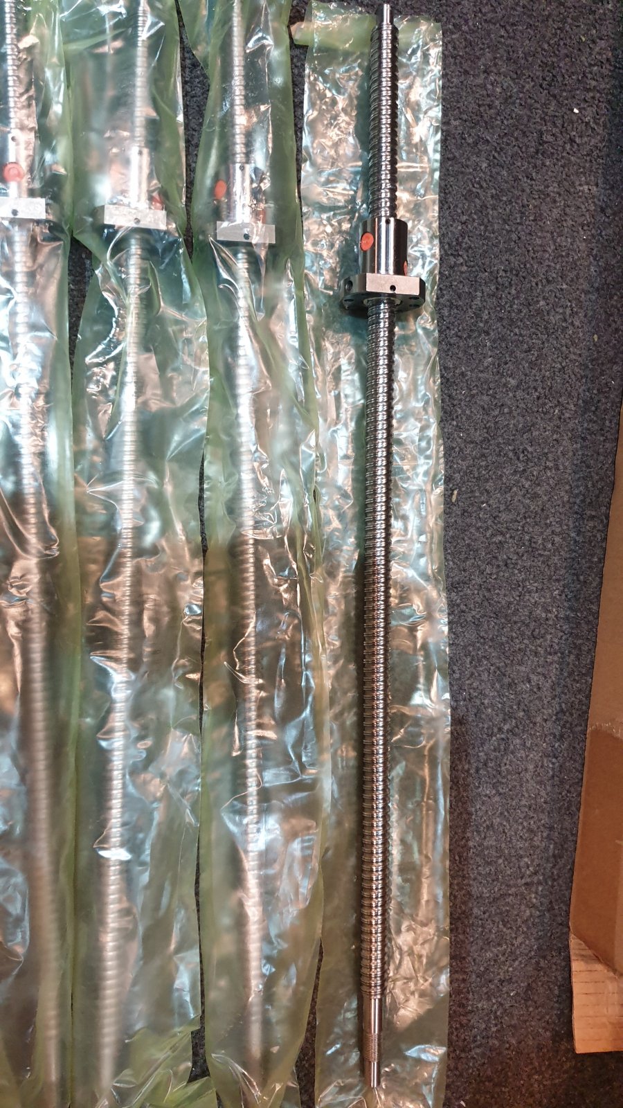

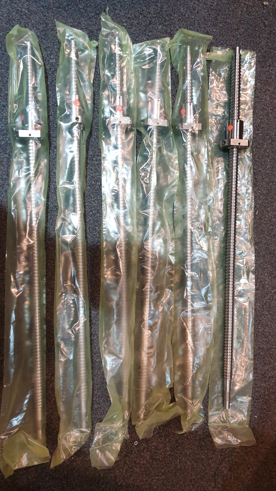

  10. Gadget999
    2,005
    12,235Coins
    +494 / 11 / -0
    love to see your dedication to the sim ! this is your third go at actuators
    what is it about your current actuators that made you decide to change
    are you using a 1605 pitch ball screw ?

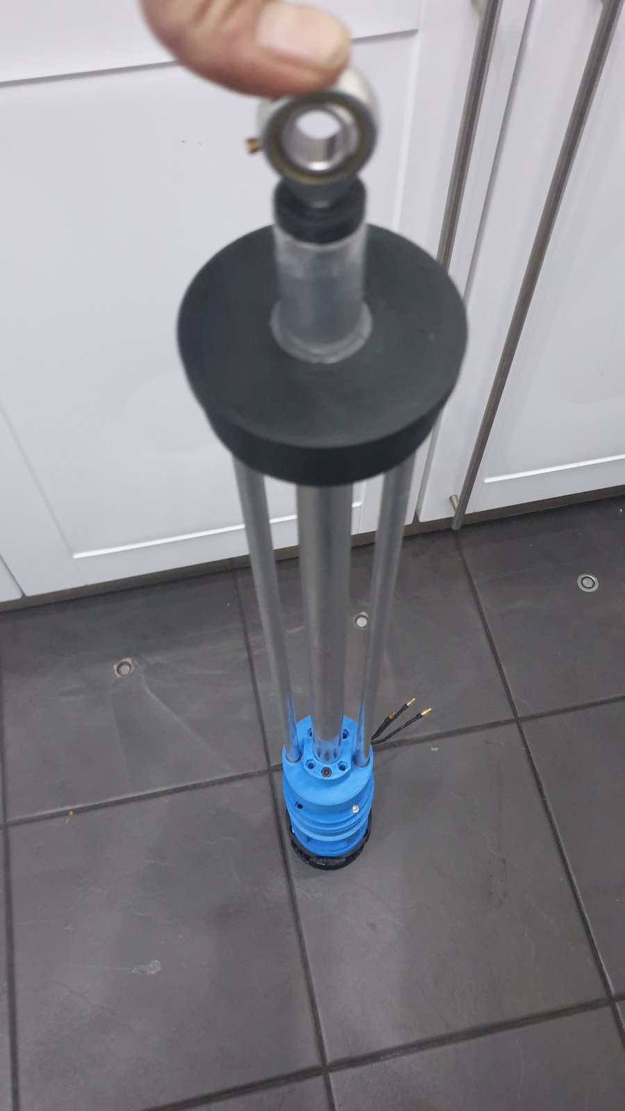

  11. SilentChill
    2,645
    20,601Coins
    +3,570 / 34 / -0

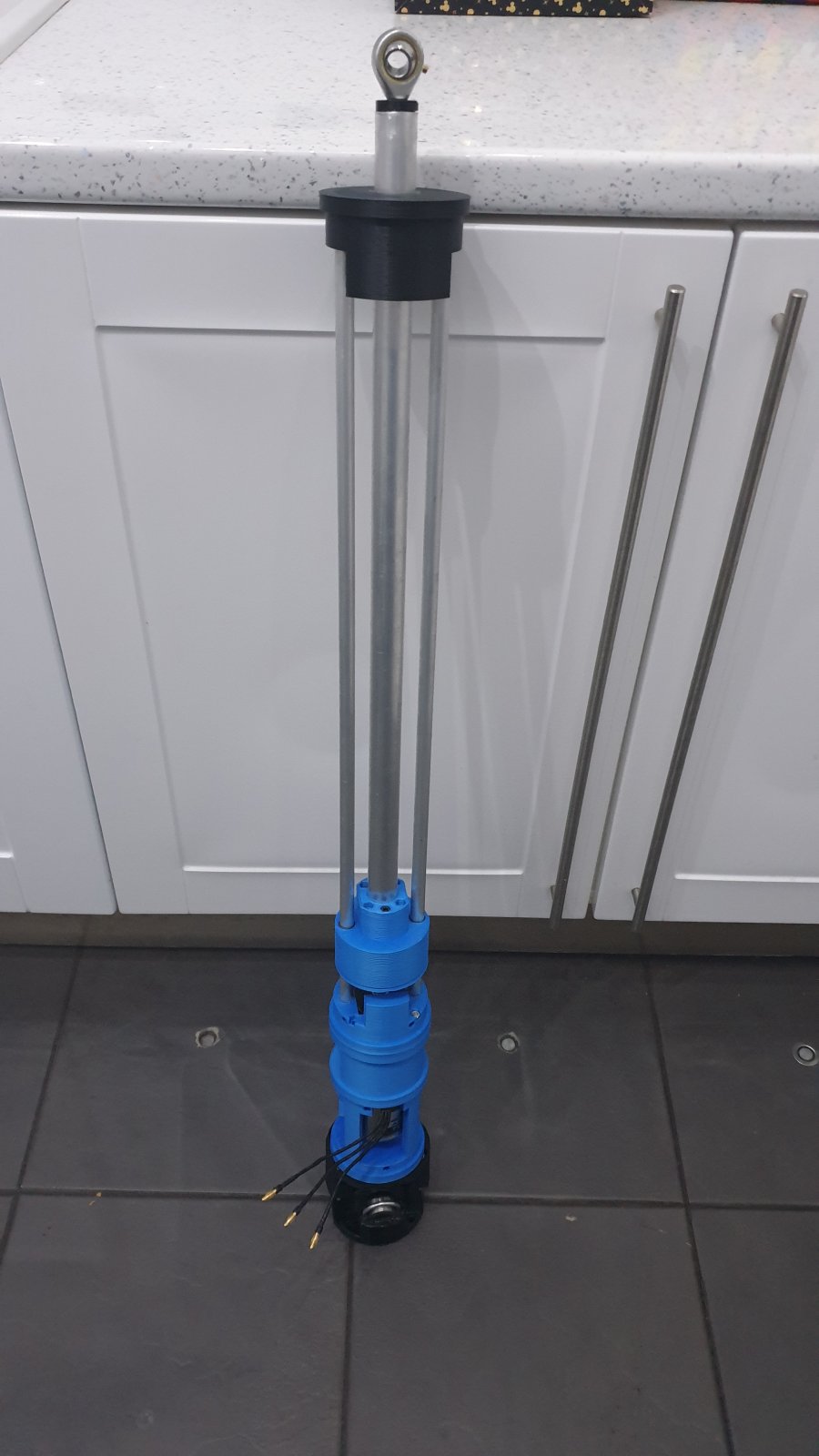

    So I've been slowly slowly making progress, no speed records this time.
    Everything has been printed at 30% infill and with PLA+. I'm quite impressed how solid and strong the parts are.
    Most will be covered by 90mm ali tube for more strength.
    Just nee to flash my odrive and get it moving
    • Like Like x 10

    600mm 1605 Ballscrew https://www.ebay.co.uk/itm/Ball-Scr...hash=item341652b57d:m:m9gCsn7qsinTsn915nO7Xmw £123.90

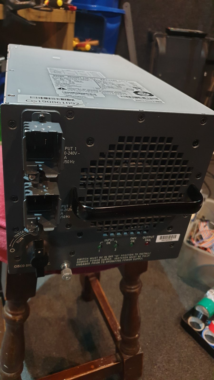

    Wow thanks silentchill for the shopping list. Just today I've created a new thread asking information about this project.
    One question :eek:nly one psu is enough for six motors?
  14. SilentChill
    2,645
    20,601Coins
    +3,570 / 34 / -0
    Yes it is total overkill its 6000watts !
  15. gigi
    gigi Active Member
    Nov 16, 2013
    467
    919Coins
    +141 / 1 / -0
    2DOF, JRK, 4DOF
    and output voltage?
  16. SilentChill
    2,645
    20,601Coins
    +3,570 / 34 / -0
    All the details are I'm the picture in first post
  17. gigi
    gigi Active Member
    Nov 16, 2013
    467
    919Coins
    +141 / 1 / -0
    2DOF, JRK, 4DOF
    I just see 42v 137,4 A
    I see sk3 turnigy brushless. it can work at 37v but it also specify with 10s lipo battery. 10s full charged should have an output voltage of 42A (4,2v x cell). so it’s ok. but i also see that this motor have a max current of 65A . 65x6 = 390A . what I wrong?

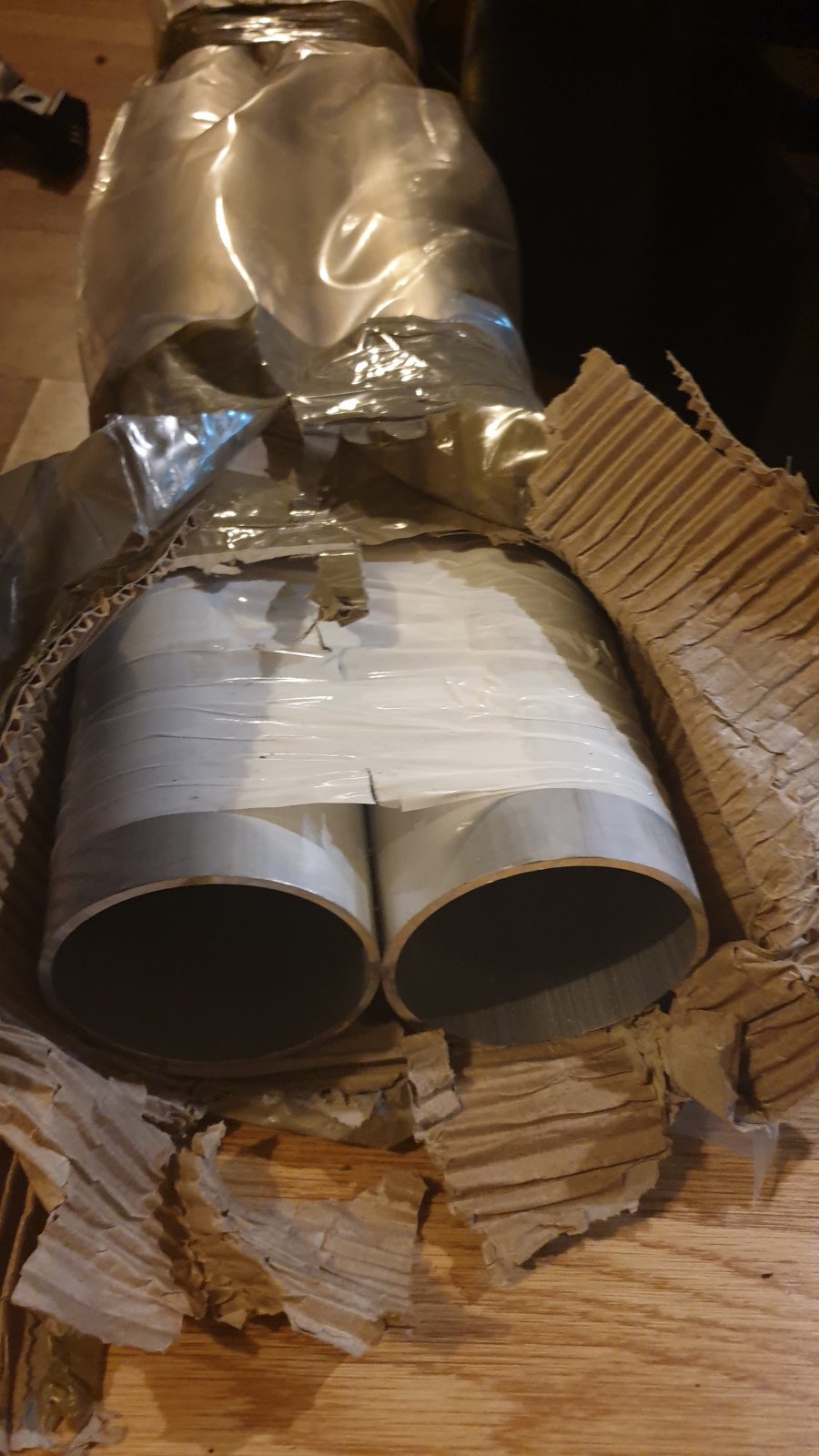

    How are the IGUS bearing slides working out for you?
    I guess the bearings are supplied with good tolerance and ID is within stated spec. I see on the suppliers website the ID is -0 +something
    but i thought the OD of Alu tube is all over the place and could be supplied with + or - something and perhaps cause the bearings to be too tight if a touch oversize.
    Have you found all the bearings and tube you recieved to play nice with each other?
  20. SilentChill
    2,645
    20,601Coins
    +3,570 / 34 / -0
    Yeah they are slightly out but on the wider side so hopefully they should be ok, a tiny bit of play on the main shaft 25mm , the 12mm Igus seem to be a great fit
