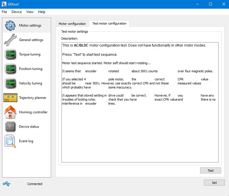

    Hello guys, I am running the really old version of OSW with the VSD-E, small Mige motor and the STM32F4 Discovery board and seperate power supply.
    It has served me great for a long time but after a long pause in simracing because of real life stuff i tried to use it again and realized the discovery board was not responding, so i flashed it again with the mmos firmware.
    During the setup where i tried to set the motor center offset as per usual by clicking the checkbox on the mmos interface, i powered down the whole system, vsde - motor - discovery board. After powering it on again its supposed to have a blue blinking light where u need to move the wheel to the center in order for the board to initialize. I move the wheel, the led turns off as per normal. If i move the wheel to the left by about 45 degrees, the wheel starts spinning like crazy and never stops.
    I tried wiping the STM32F4 Discovery board chip and this stops happening. So it is the STM32F4 Discovery board's fault but i have no idea how ot troubleshoot it.
    Anyone got any ideas on what may be failing here?

    I have double checked all cables and connections to make sure everything is OK, so i think its either something with the motor (encoder perhaps? do they even fail?) or the VSD-E.
    I connected to the VSD-E via the GDTool and i ran the step response test.
    It completed the test, the wheel actually STOPPED after the test and didnt start spinning wildly.

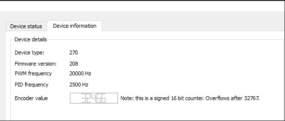

    BUT i can see it spun for only half turn, the message bellow counted 4 magnetic poles (mige has 8 , the CPR suggests it is 5000, but for this motor its 2500.
    Checking the encoder value reported in gdtool, i can see some weird numbers like bellow, if i turn the wheel too much it starts spinning again without end.
